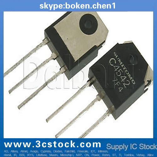

      Something else interesting, I noticed the HOT was arcing with the screw that mounts it in place. I have the mica pad and paste in place which I find odd. I may order a new insulator, plastic washer, paste, and screw to be proactive.

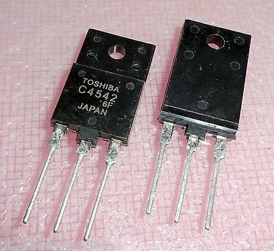

        Which transistor are you using? 2SC4542 has two styles, one is all plastic and needs no insulator and one needs the insulator but the screw should already be insulated from the transistor

          Crap, you're right. It is uninsulated... could that have been the issue?? Okay.. need to seek out the insulated HOT right away. I'll still do some inspections on the board to make sure the arcing didn't fry anything.
          And recommendations on where to source an insulated 2SC4542? Thanks a ton for pointing that out.

            If the heatsink is grounded, and the transistor tab is exposed metal (it is connected to the collector) it must be insulated. I don't know where to get these parts anymore, most places like digikey etc. no longer carry them. A 2SC4747 is also a substitute.
