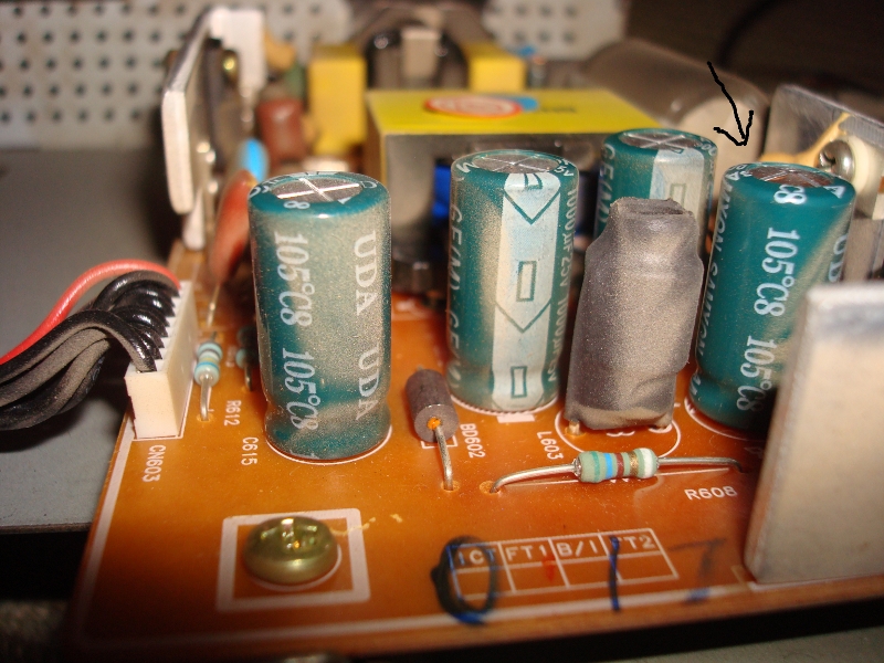

    I bought 15 faulty units today all this model number. All have bulging Samxon 15v 1000uf's. All will fire up and work perfect after replacing the single bad cap. Although I am replacing all four on each board.

    Samxon had a series the GF series I found on monitors and they would always bulge.
    Samxon is a good brand but even good brands have bad runs.

      Hehe now I see in one of the pics GF .
      For future reference treat the Samxon GF series like Fujiyuus replace any on sight.
        Change them all. Same brand, same series ---> same death. You are there anyway, man. I've been dealing with those GFs all morning on Westinghouse units. One was so "blown" that I found only the pins soldered on the board, and the plastic seal that goes under the cap : nothing else.
