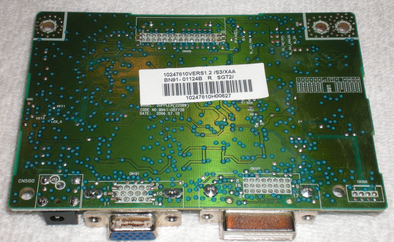

Is it necessary to replace all the caps, or can I just replace the bulging ones?
P12386-ND CAP 330UF 25V ELECT FM RADIAL
P12391-ND CAP 820UF 25V ELECT FM RADIAL
Also anyone got a recommendation on what other equipment I need like a soldering iron, and solder? Can I make do with something cheap from radioshack?
. I was all set to order from digikey but the panasonic 680UF cap item is out of stock, another one I see posted is also out 565-1551-ND. Anyone got recommendations on an alternative, can I mix different manufacturers. Like 493-1554-ND or 493-1829-ND?
