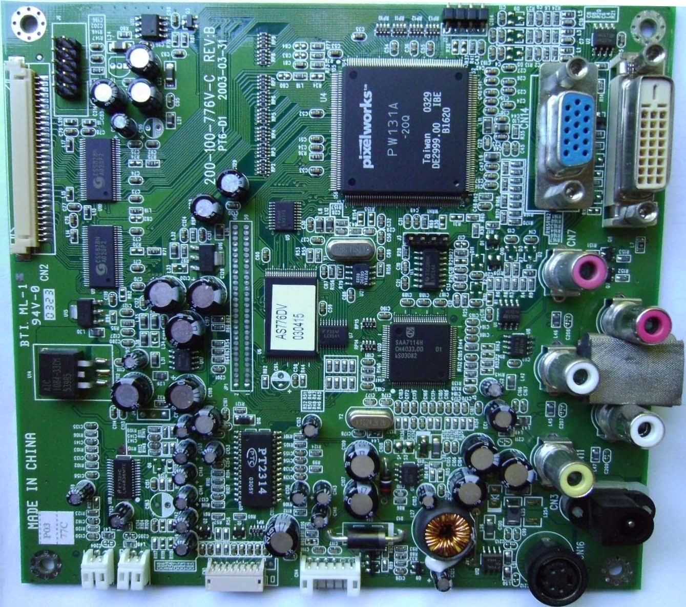

    This monitor uses a separate power brick to provide 12V input
    Turned On using its power button, the display shows an Acer logo followed by a quick glimpse of which input it's scanning, before going black again
    Although the power button will stay lit until pressed Off again
    So I disassembled it, hoping for obvious bad capacitors somewhere
    No such luck
    The board pictured is where 12V comes in, along with video & audio inputs, but seems faultless to my inexperienced eye
    Except that its caps are all Suscon
    Am I barking up the wrong tree here, or are Suscon on this board likely to be the root of the problem?

    if this is a ccfl set i would start by checking the inverter transformer then maybe test the ccfl tubes
    link to the service manual for this monitor
    https://www.manualslib.com/manual/26...cer-Al732.html
