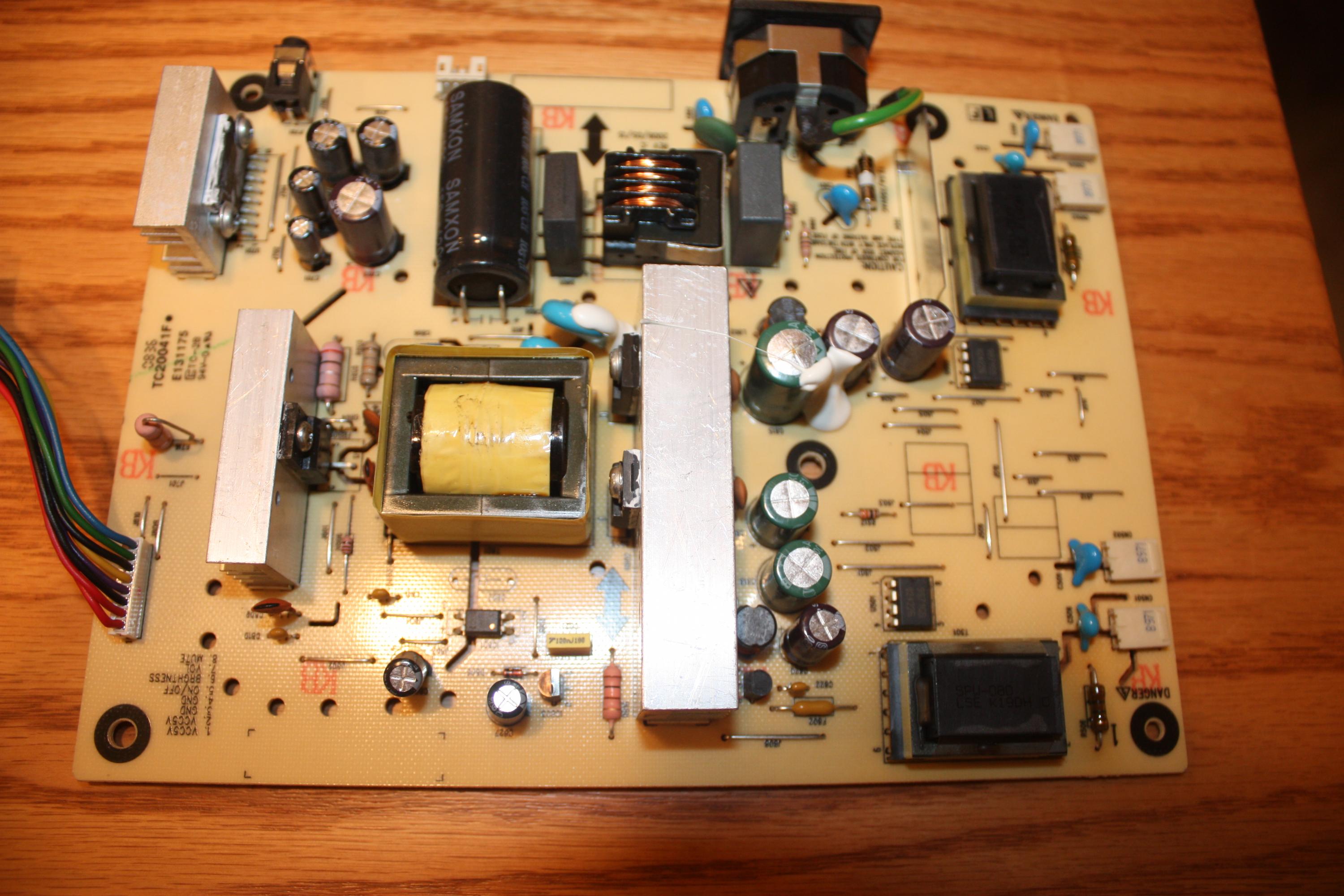

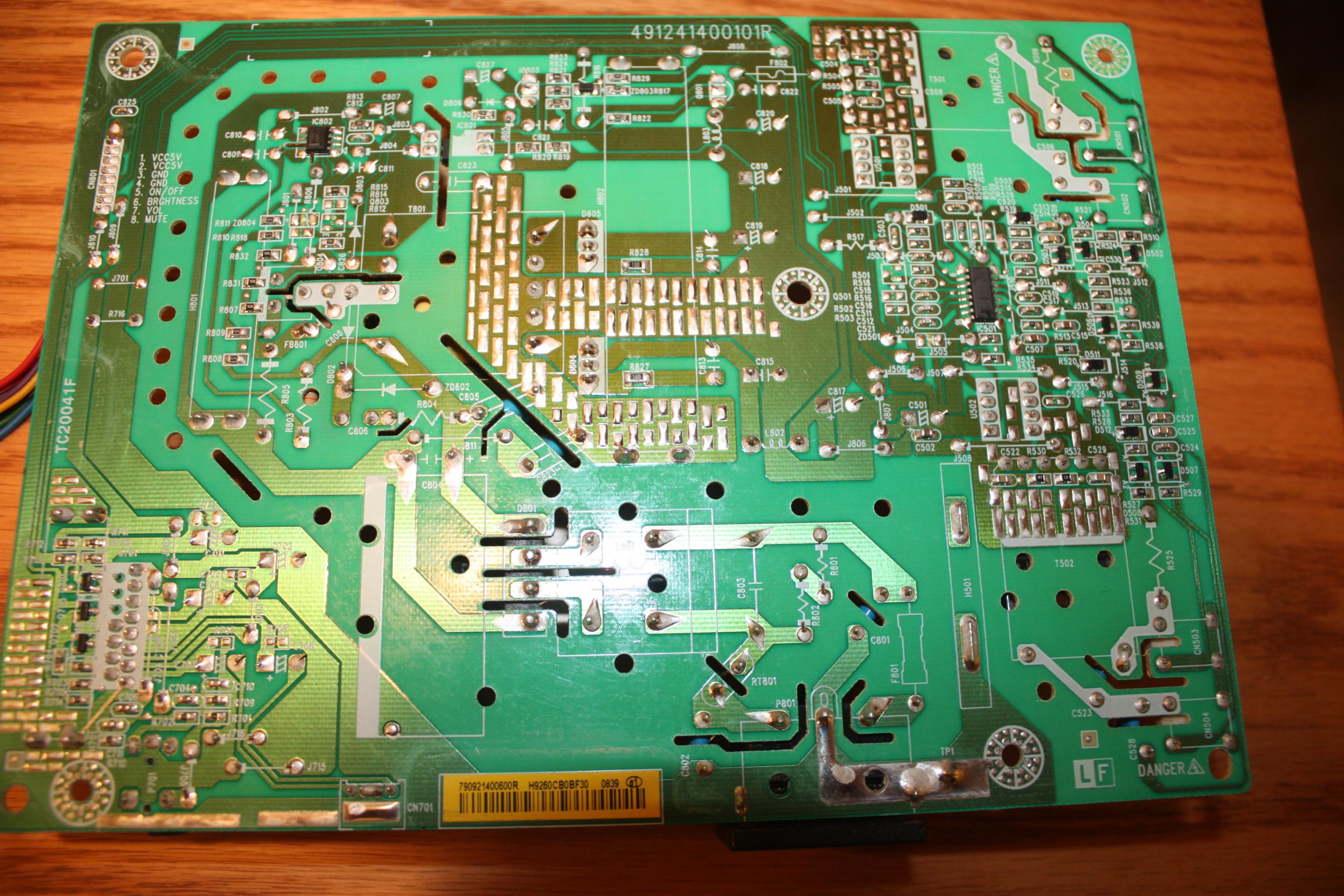

    Hey there guys, truly hidden gem here on the internet. Not sure how 'hidden' it is, but I just hadn't stumbled upon this forum yet. Sorry, that could've gone in my intro post.
    Anyhow, I have a V7 D22W12 LCD monitor which I'm pretty sure just needs a little TLC, and it may become usable again. Once connected, it will display a desktop for ~2 seconds, then go blank. My internet research on such matters suggests fried capacitors. I have fixed circuit boards previously with my tremor riddled hands, and figured, why not give this one a shot?

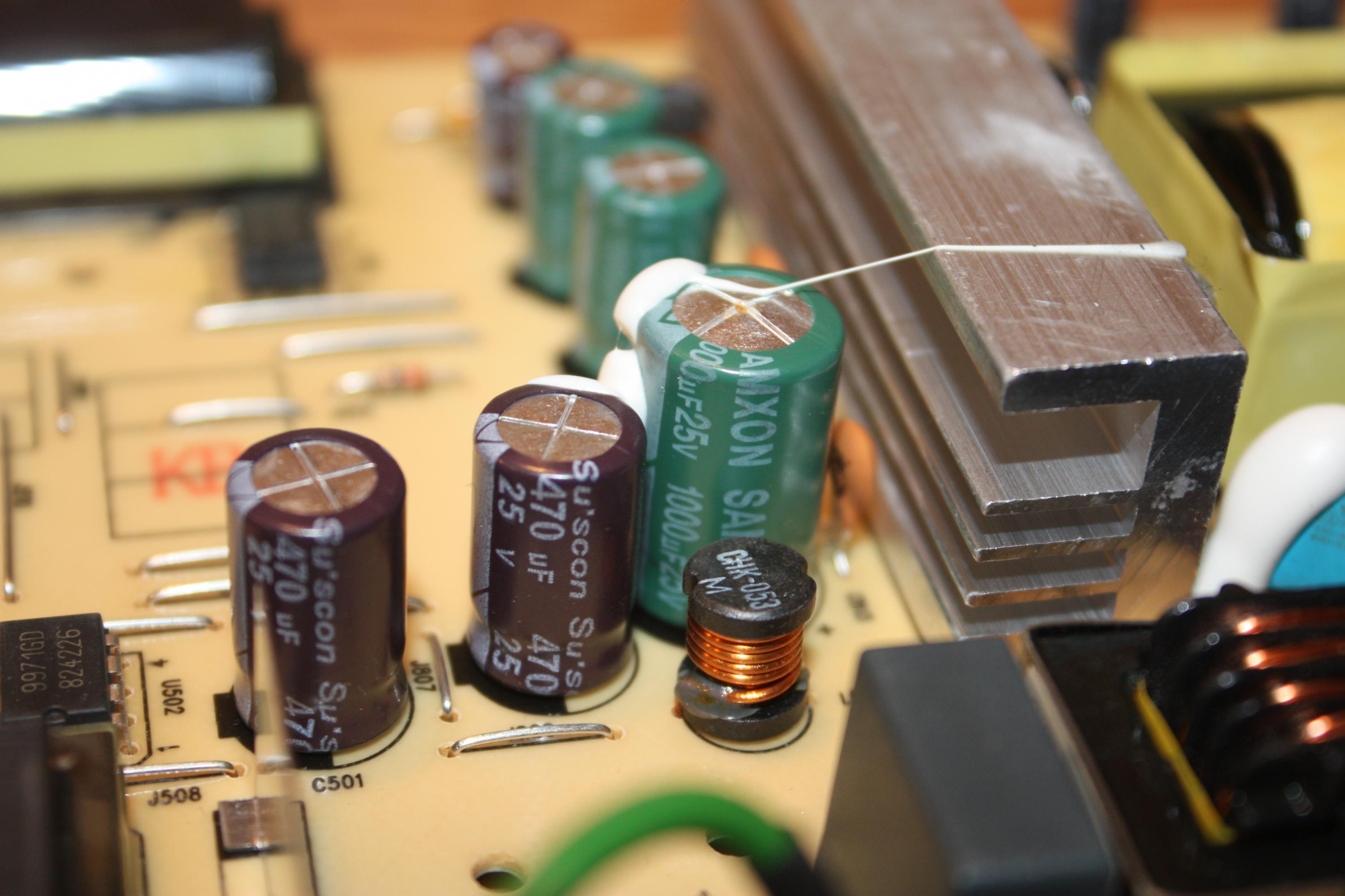

    I pulled apart the LCD down to the power inverter board. I do indeed see one 1000uf 25v cap with a buldging lid and white goo. Another blue coin shaped cap has similar goo. Interestingly, every pic I've found of this board shows that blue coin shaped cap with white goo. For instance:
    https://m.aliexpress.com/item/32274872296.html
    Dead center of the pic is the white goo on the cap. Directly left of that behind the heatsink is a taller, green cap. That is the bludging goo covered cap on my board. That pic actually appears to show a bit of white goo too, perhaps the goo is normal?
    If the goo is normal, then maybe I just need to try to replace the 1000uF 25v cap. Without a RadioShak nearby, which website to you guys favor for caps?
    Assuming the goo is abnormal, could somebody help me identify that blue coin shaped cap? My eyes can't make out the TINY writing on it.
    ILPI-033 1
    REV: C
    2008/05/15 is the board identification.
    The caps in question are C815 (bludging tall green one) and C823-1 (round blue coin one)
    I found somebody else refering to the ILPI-033, and thought the PDF there might help, but I couldn't make heads or tails of it.
    https://www.badcaps.net/forum/showth...light=ilpi-033
    Post 9 & 12
    I can submit pics if needed. But the top pic is my board.
    Thanks in advance for your help.

    Re: V7 D22W12 Monitor 2 seconds to black ILPI-033 Caps
    Yep, please post picture of your power board.
    Anyway, this issue is indicating a backlight failure : either the CCFL themselves or the inverter. See the sticky thread https://www.badcaps.net/forum/showthread.php?t=10419
    The white stuff on the caps is glue, nothing wrong with it as long as it is not discolored. If it is, remove it.
          Chances are this is indeed the problem.
          This should be easy to replace, you don't even need to remove the solder (but it is often better). Add some fresh solder on the pins of the capacitor on the back of the board, heat them up and gently pull the cap. While you're still heating the pads, insert the new capacitor and add some fresh solder after the cap is in place.

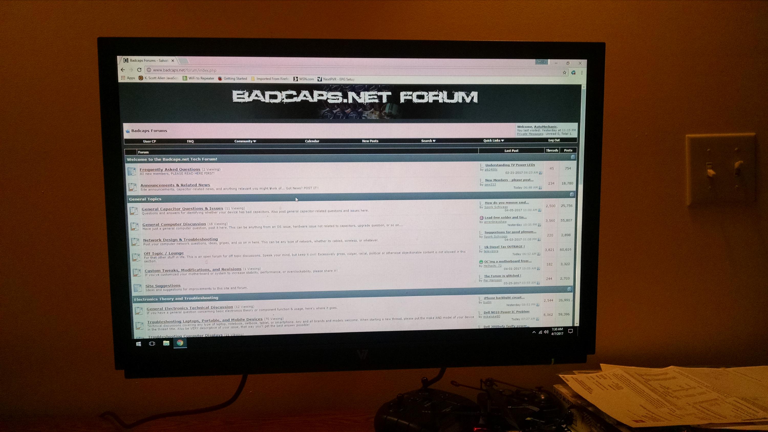

              Oh BadCaps.net forum, how I've failed you! I finally got my replacement caps in the mail today. Did some pretty novice cap replacement, but I did manage to replace the obviously bad cap. Reassembled the screen, hung it on the wall...
              ...and...
              I haven't a stinking video cable to test it with. The monitor has VGA or DVI inputs. I've got HDMI cables, but no simple VGA or DVI. The CRT that I'm using to type this sob story has a fixed in place VGA cable. It cannot be removed from the back of the screen.
              I can confirm the monitor 'boots', says 'No Input Signal' then switches to standby, and the green LED turns orange. Pretty sure it did that at least before. So no clue if I'm good or not. Will have to steal a VGA cable from work tomorrow to test it out. So frustrating!
                  Success! I was able to obtain an VGA cable early this morning from an undisclosed source. Monitor is looking good.
                  (Picture was taken before color adjustment. The pinks are white after adjustment)

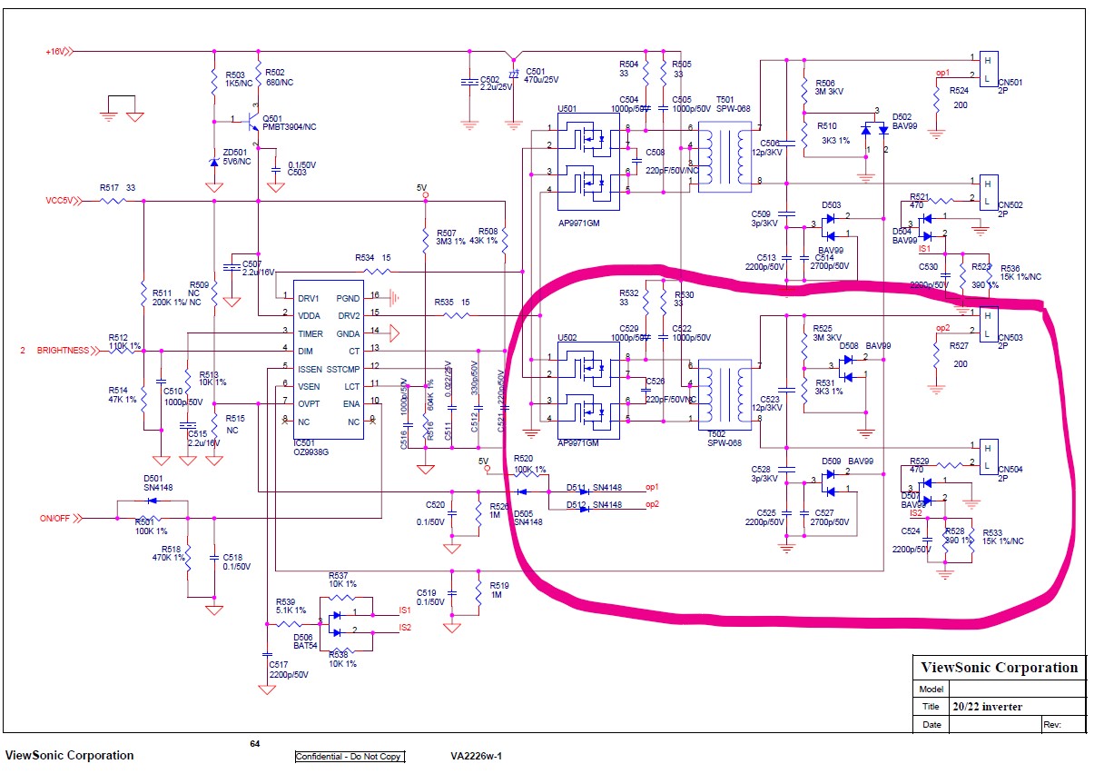

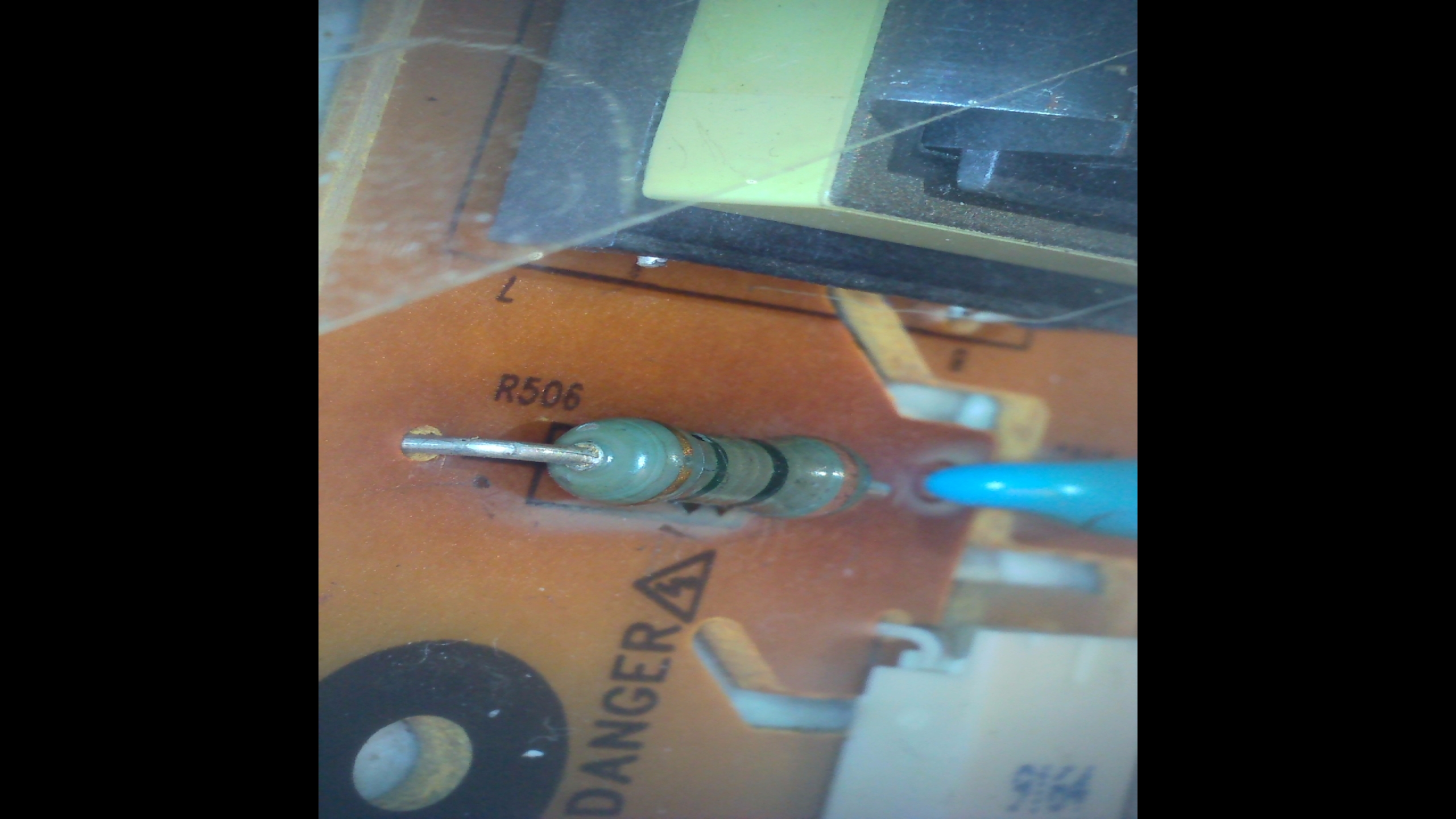

                    Kindly, could you tell me what is the value of the R506 and R525 resistor? I can't understand the colors.
                    • R_J
                      • Jun 2012
                      • 9582
                      R525 = 3megΩ 5%, Can't make out R506 but it looks the same. These resistors are also rated 3KV
                      It looks like just the outer coating is cracked, I suspect the resistors are ok.

                        However I discovered that one of the inverter stages is not working, and probably after a few seconds it goes into protection and the black screen appears.What should i check?
                        • R_J
                          • Jun 2012
                          • 9582
                          Check the resistance of the secondary windings on the t501 and T502 transformers and see if they are the same, or is T502 higher or lower in resistance. Try switching the ccfl lamps from CN503 and CN504 to CN501 and CN502 to see if the shutdown is caused by a bad ccfl.
                          Also inspect the 2 blue ceramic caps in the output, on some models they can be bad and short when there is high voltage present.

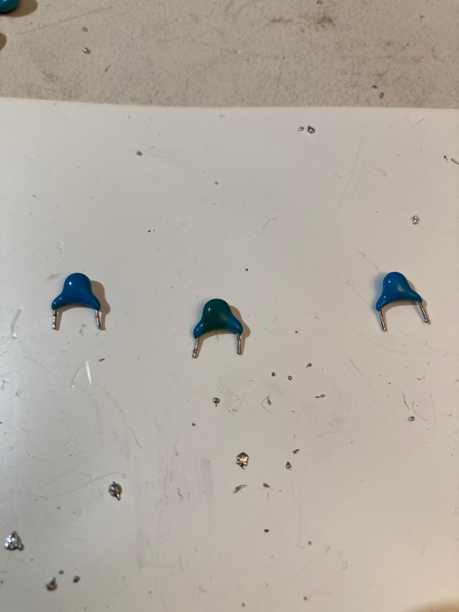

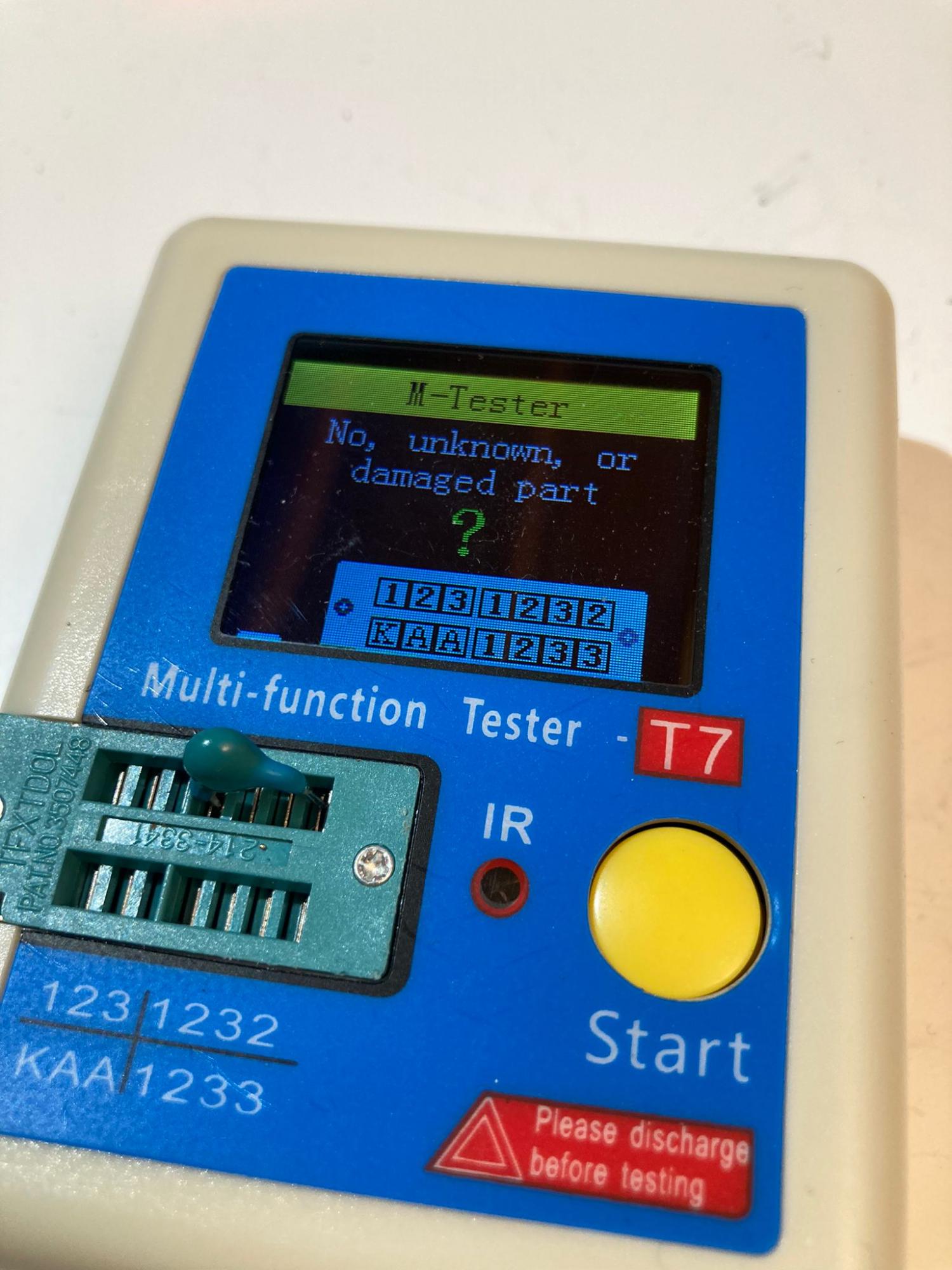

                              Ok, I checked the transformers and they are efficient, same homs, then I checked the 4 blue ceramic capacitors and strangely the tester does not read them. They are the C506, C509, C523 and C528. All four are not read. I've tried other capacitors I have in stock and the meter reads them all.
                              • R_J
                                • Jun 2012
                                • 9582
                                The capacitors are likely good, the value is too low (3pf) for those meters to check them. The transformers seem to be ok as well.
