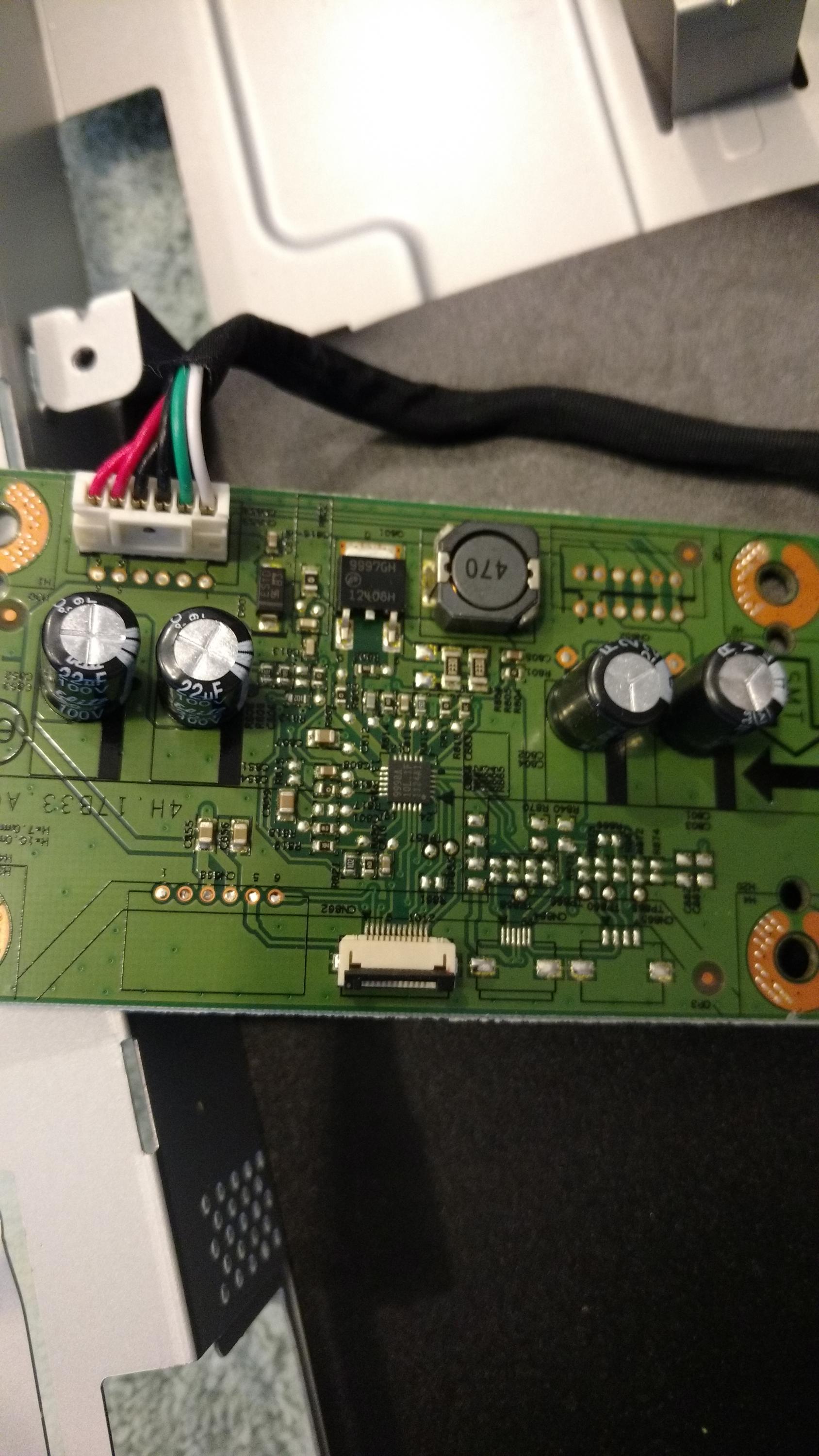

    Hi, I found this broken monitor.
    It`s starts up and turn off about 5 seconds after.
    There is also a small red vertical lines.
    All the caps and soldering look good.
    Should I change the caps anyway?
    Here is the caps list
    On the main PS 330uf 35v x2,680uf 16v x2,22uf 50v
    On the driver 22uf 100v x2,220uf 25v x 2
    On the video board 220uf 16v x2, 22uf 25v x3,10uf 25v
    Thanks.
    Frank.

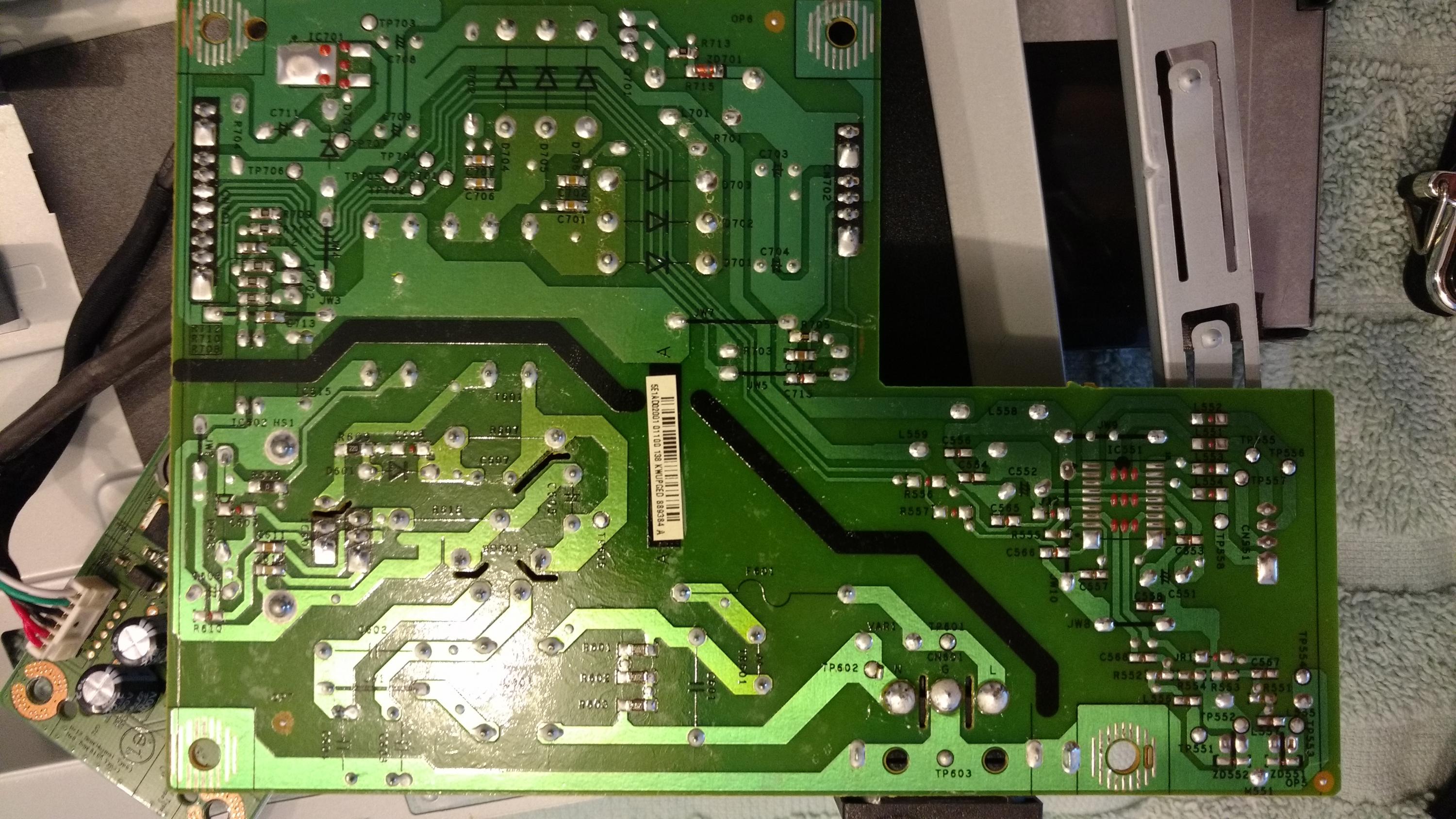

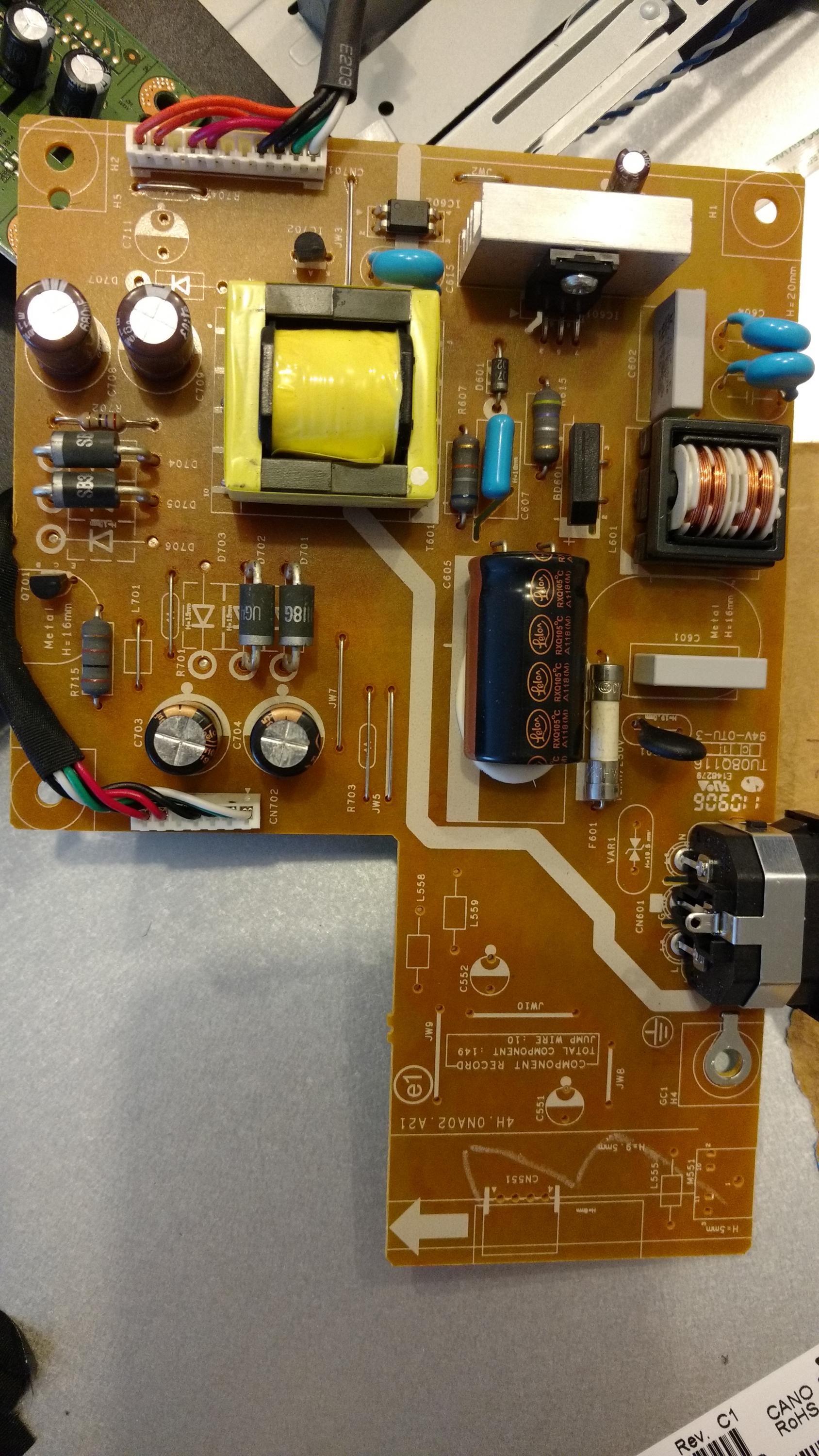

    Re: Asus VE247H problem
    check the diodes in 2 pairs with the empty space next to each pair.
    putting diodes in parallel is a stupid trick that often fails - just search this forum for "vestel" to see lots of examples.
      Thanks, I guess I have to desolder the diodes to test them right?
      I tried to test them on the board and I get an voltage from both ends.
        • 31087
        test them on the board for resistance - if they arent short-circuit then they are o.k.

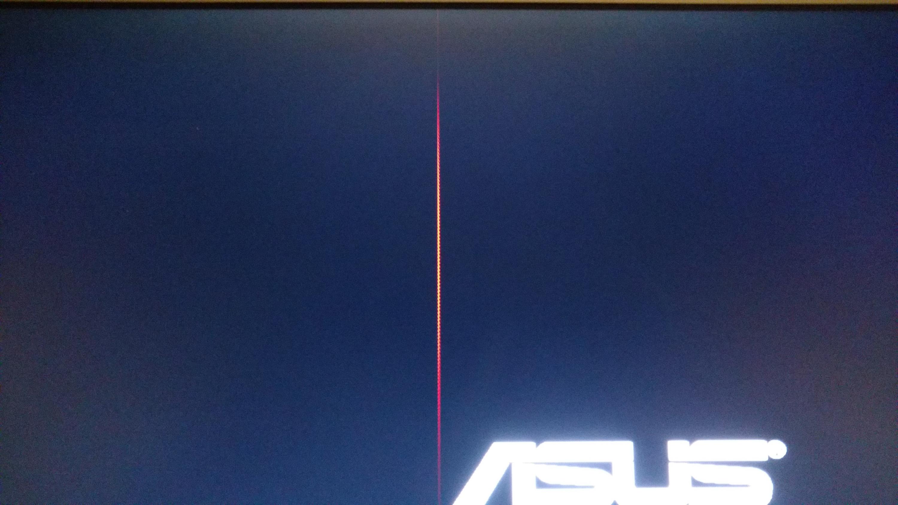

                  Hi, I check all resistors diodes and caps, they test all good.
                  I also check and clean the ribbon cable.
                  I have this vertical red line.
                  Video Board issue?
                  Thanks.
                  Frank.

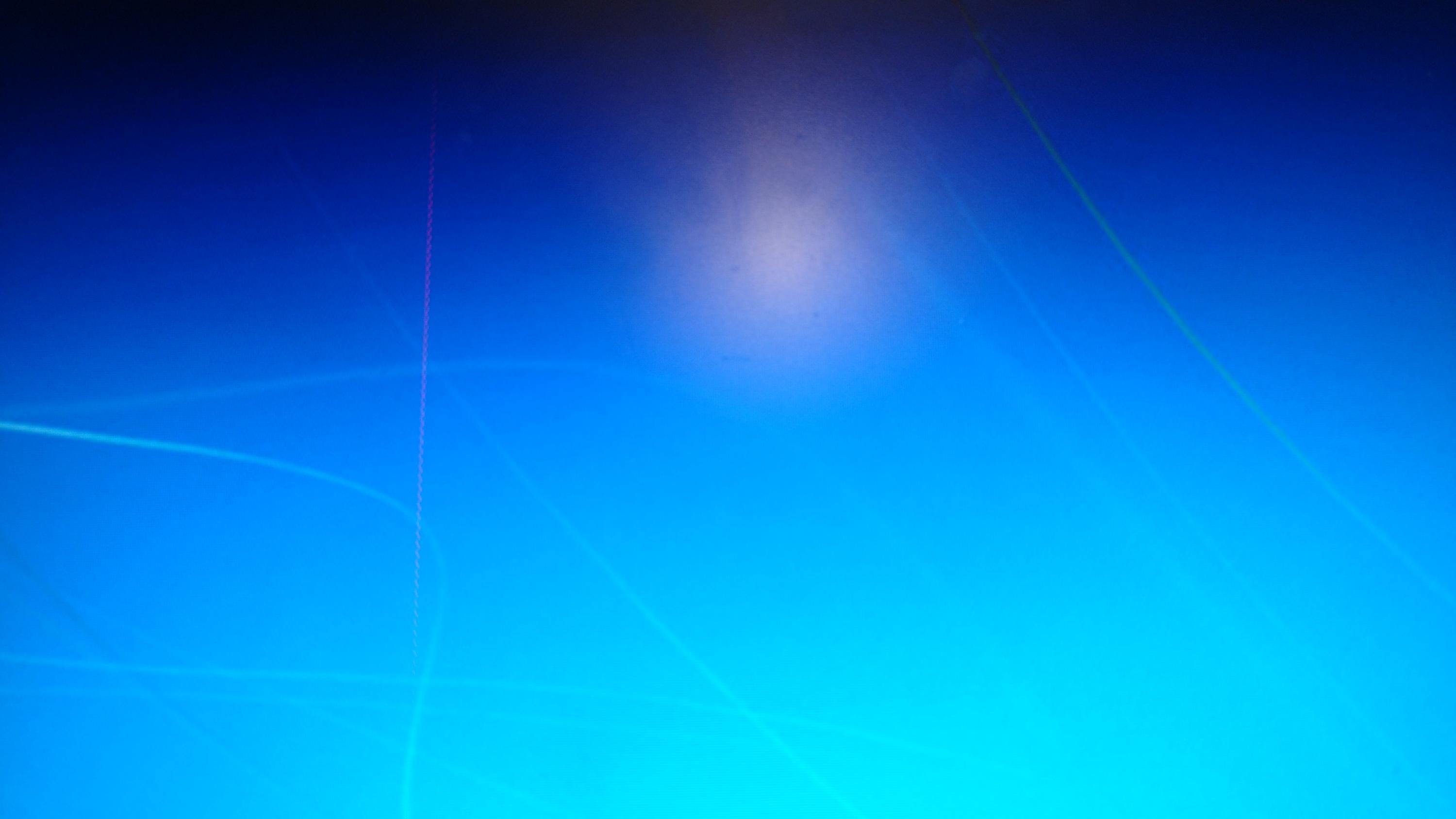

                    • 31087
                    red line???
                    i see a white "cloud" only
                      Here is a better picture.
                      Frank.
                        • 31087
                        if it's always in the same place, it could be the panel.
                        • FrankMtl
                          • Sep 2015
                          • 36
                          Yes always at the same place.
