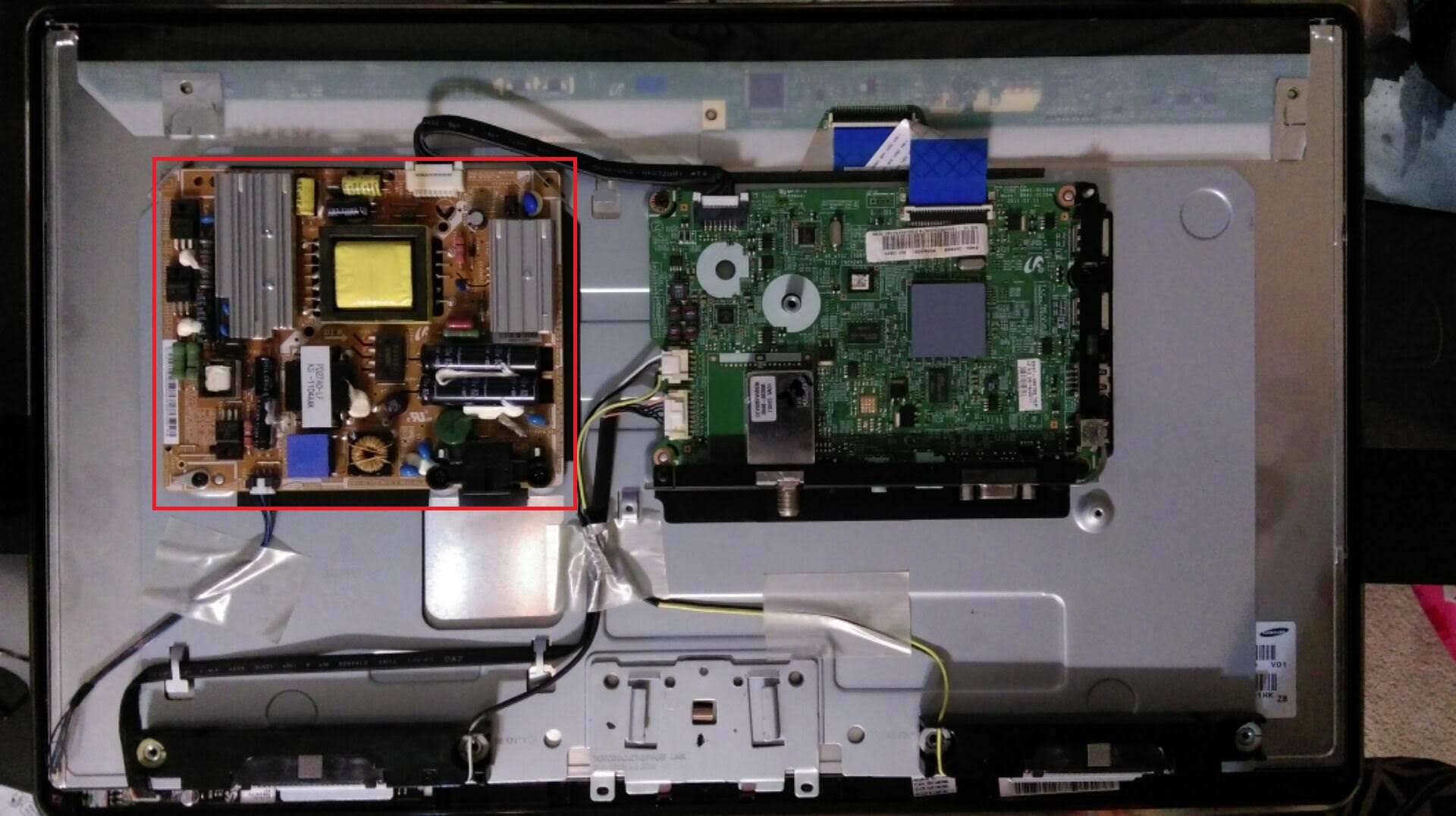

    Unit began powering itself on and off
    Troubleshooting:
    Went through process, determined it was most likely related to hardware. Based on what I had read I had suspected bad capacitors, however found some scorch marks caused by a possible short.
    Images of Findings:
    1) Opened up back panel, and took a look at the power supply (not sure if that's what it's called?). Highlighted in red in "Open Panel.jpg"

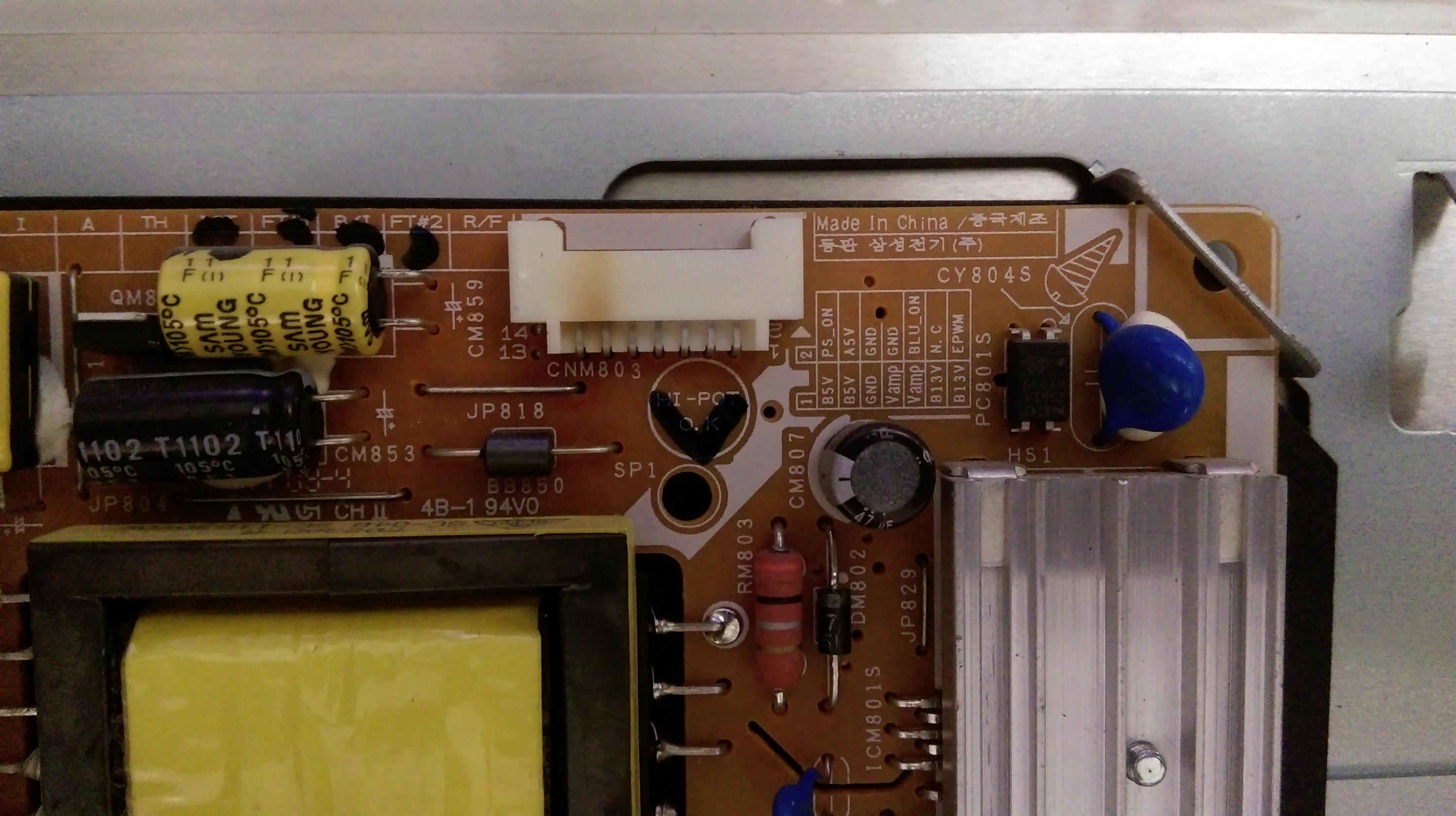

    2) Found burn marks on one of the connectors. "Burn Marks.jpg"

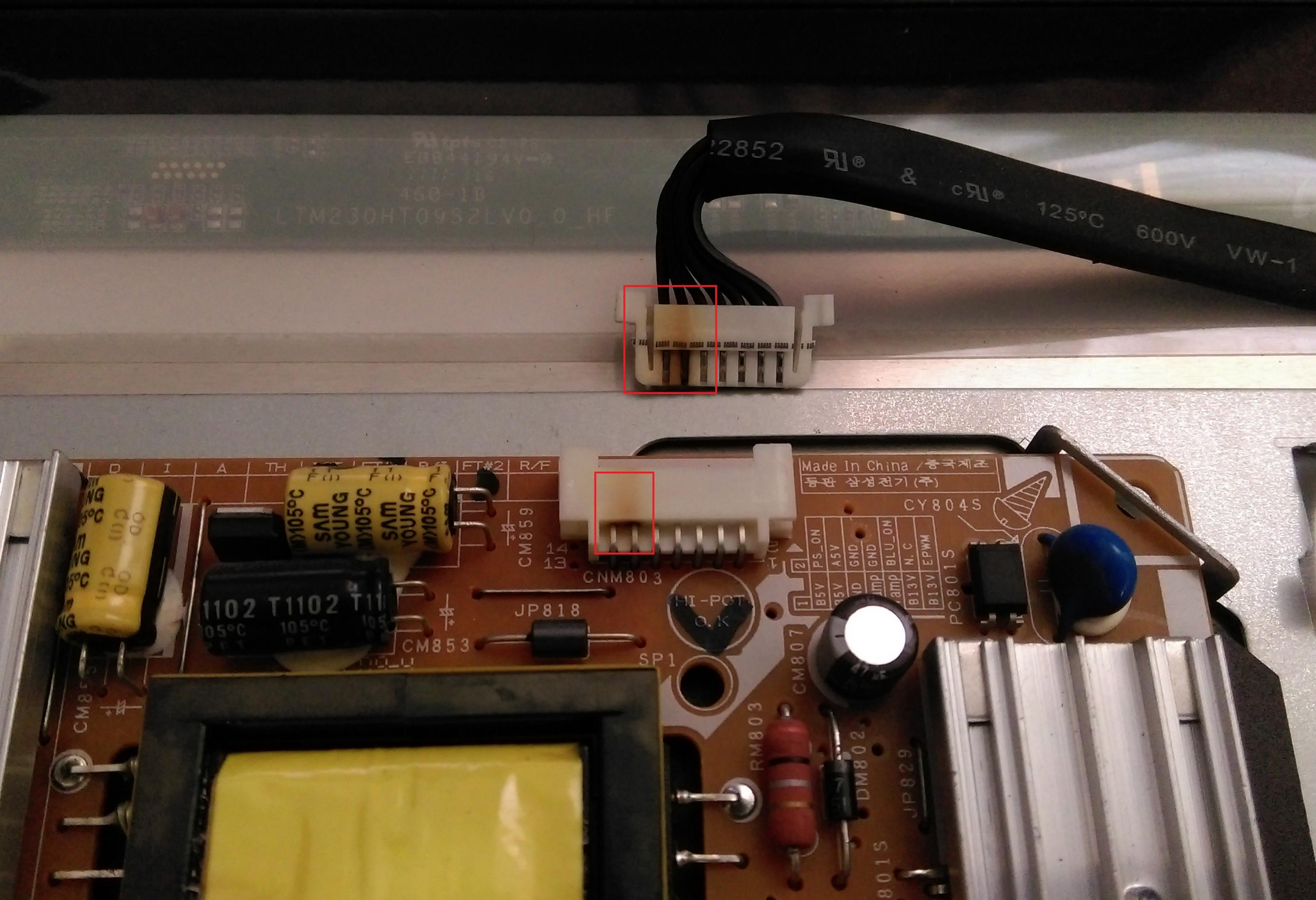

    3) A closeup of the female connector on the power supply board (again not sure of nomenclature). "Insert Closeup.jpg"
    So, it appears that there was a short in the board, and it's possible that the wire is just fried. I didn't see any damage on the reverse side, all capacitors look normal, everything else seems good.
    The Question:
    I'm considering just finding a replacement wire and possibly a replacement female contact to replace the burned stuff. Would anyone else have any other recommendations, or should I just go ahead?

    You could ghetto mod it too: Just cut the cable, desolder the connector and then solder the wires directly on the PCB.
    You will still have a connector left on the other side...
      Re: Samsung SyncMaster TA350 - Found Some Scorch Marks
      That's actually a great idea... I'm having a heck of a time finding the cable to purchase, anyway. I may have to go that route...
      You wouldn't happen to know what the cable is called, would you? :-P
