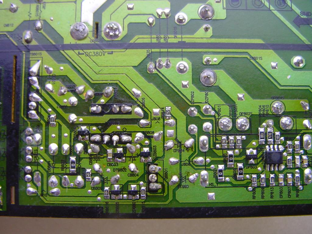

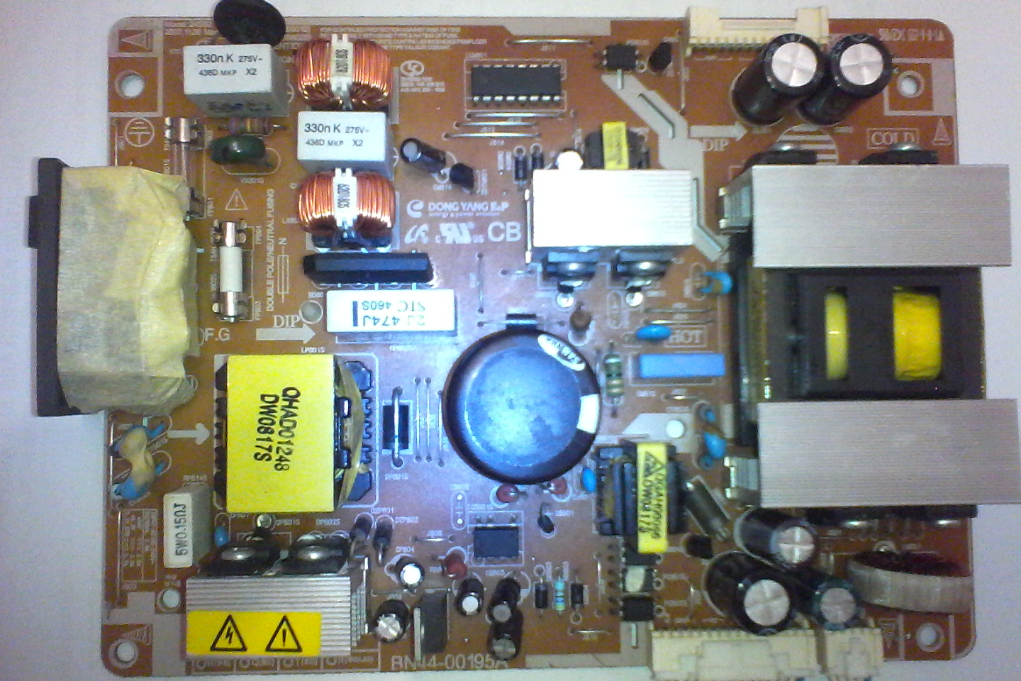

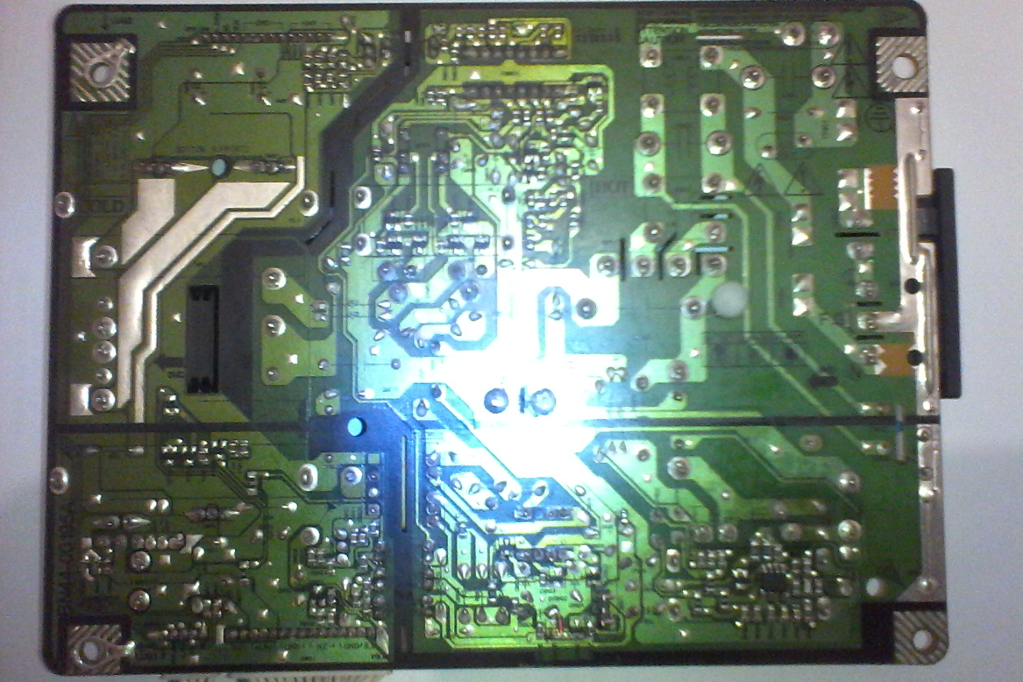

    Hi All,
    I've this Samsung 2493HM screen with PSU: BN44-00195A for a while now.
    Well, i've read all the threads / responses on this model/PSU inside out and more than twice -- so, i've done all the necessary recommendations but to no avail.
    The blue light is ON and the standby voltage (5V2) is OK as well as the PS_ON (3V3). However, there is no power to the inverter -- there is no 24V and 5V3.
    Using equivalent PSU BN44-00192B schematic, I found the transistor QB802 faulty (i de-solder and measure the B-E to be 30 ohms either way which i've replaced with equivalent 2SD526). The collector now has ~ 18V (which was ~10v5 before) but the Base after the 2K2 resistor drops to ~3.5V and off course the emitter to ~3V, which seems to be the issue now -- i've re-tested the replacement NPN transistor out of circuit and seems OK).
    ICB801S (STR-A6159) works well -- its Vcc measures ~16v5 and the drive voltage to PC801S (PS2561) transistor section measures about 19V at the input and Output; but drops to ~3v3 just after 2k2 resistor to QB802 base?
    I've further isolated the QB802 and PC801S circuitry from the rest, by disconnecting the M_Vcc output to the other circuitry and still having the same issue -- the M_Vcc voltage (from the Emitter of QB802); still reads ~3.3V, the Base voltage reads ~ 3v7 and the Collector ~ 18V.
    My question is, what voltage must M_Vcc be or what must the voltage to the Base and from the Emitter of transistor QB802 be? Which in my case, it's around 3v3, low enough to turn ICP801S (TDA4863) ON, as well as ICM801 (MC33067) -- since the Vcc (M_Vcc) to respective chips reads ~3v3 and Pin 10 (the fault pin) of ICM801 reads ~0.25V.
    I've tested all the diodes/resistors and everything seems OK as well disabling the Over Voltage Protection circuitry around QT851 but to no avail.
    Any more hints on why M_Vcc voltage is about 3v5 and what must be the right value?
    Attached are the bottom and top pics of the PSU.
    Re: Samsung 2493HM (PSU:BN44-00195A): No 24V 5.4V Drama
    There are 15V Zener diode and regular diode connected in series and then connected between the Base and GND of Q801 (802 in BN44 xx192 diagram). Are they OK?
    Also check the resistance on the Emitter (output) and GND of that LINEAR regulator circuit to make sure it is not the loads that are causing the problem and took out the transistor in the first place.

        The picture in my post 2 is from BN44-00195A board, Q801 is on my board, the diagram has it as Q802.
        The 15V + 1 forward bias diode is series is to set the output (at the Emitter) Voltage to be at 15V, it is just a simple Transistor/Zener linear regulator circuit, what DCV you have between Base and GROUND will be what you will get at the Emitter minus the VBe drops of about 0.6V that is why there is a diode in series with the 15V Zener so the Voltage at the Base and GND will be at 15.6V so the out put will be = 15.6 - 0.6 = 15V.
        The Zener and the diode in series is being bias by the resistor that gets the DCV through the OTPO to set the Voltage to 15.6V.
        So you need to check the OPTO, the bias resistor (2.2K, the 7.5K is just the light load), and also check the load resistance (you may have bad PFC IC, or the SMPS IC for the 12V/24V power supply which may have cause the Transistor to go bad in the first place).
        'i did remove RB805 (tested OK: 7K5) and measure the output resistance to be ~320 Ohms with and without RB805 (7K5)' 320 Ohms is not normal. So you may have bad IC.
