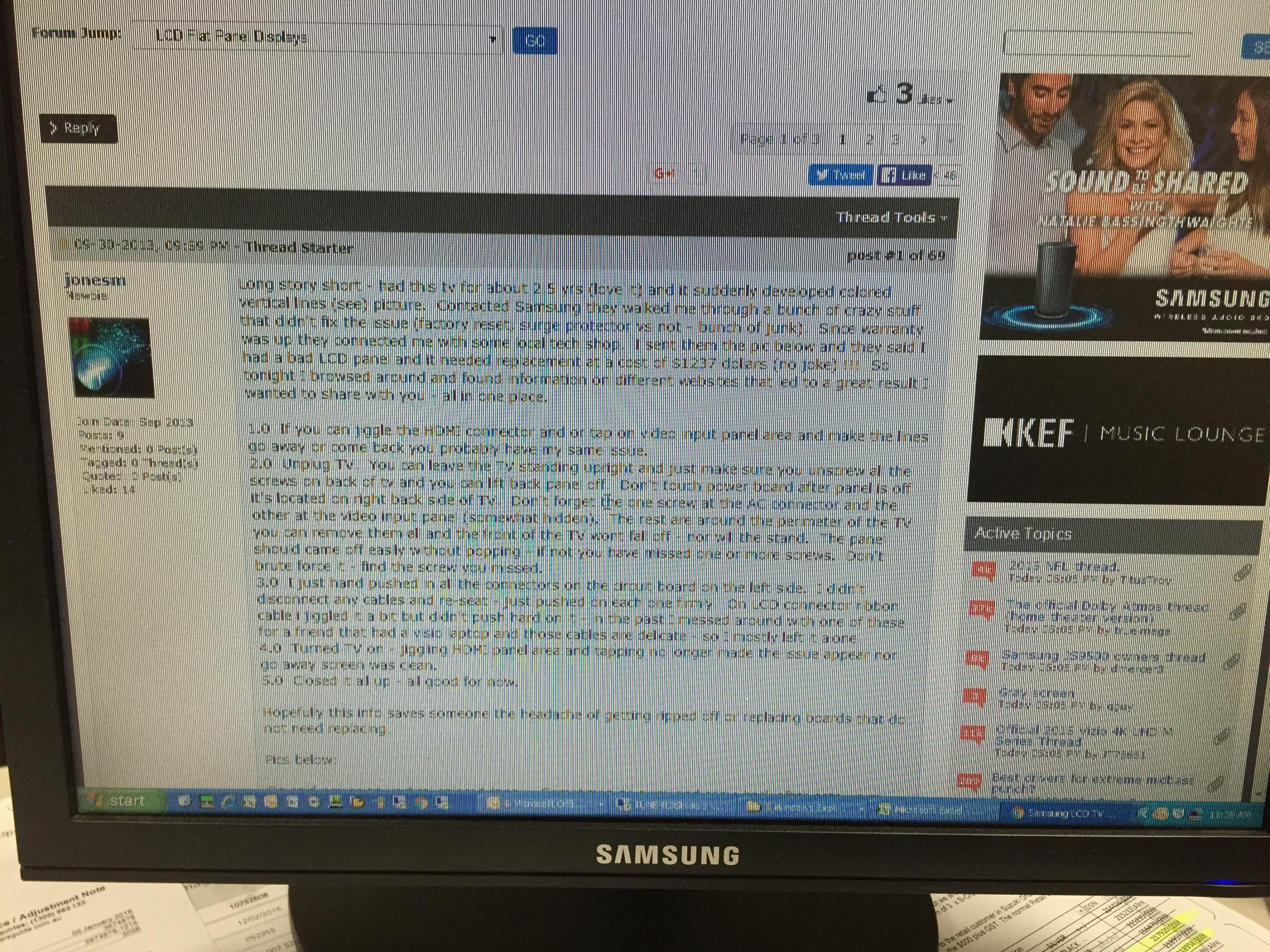

    This is my first post. I have a Samsung 19inch monitor with a display problem.
    The display is visible, but it is grainy, there are white vertical stripes making the image looking like the old EGA resolution!
    Please help.

    Here is a pic

        Open case check for bad bloated capacitors clean cable contacts that goes from mainboard to screen panel with alcohol.
