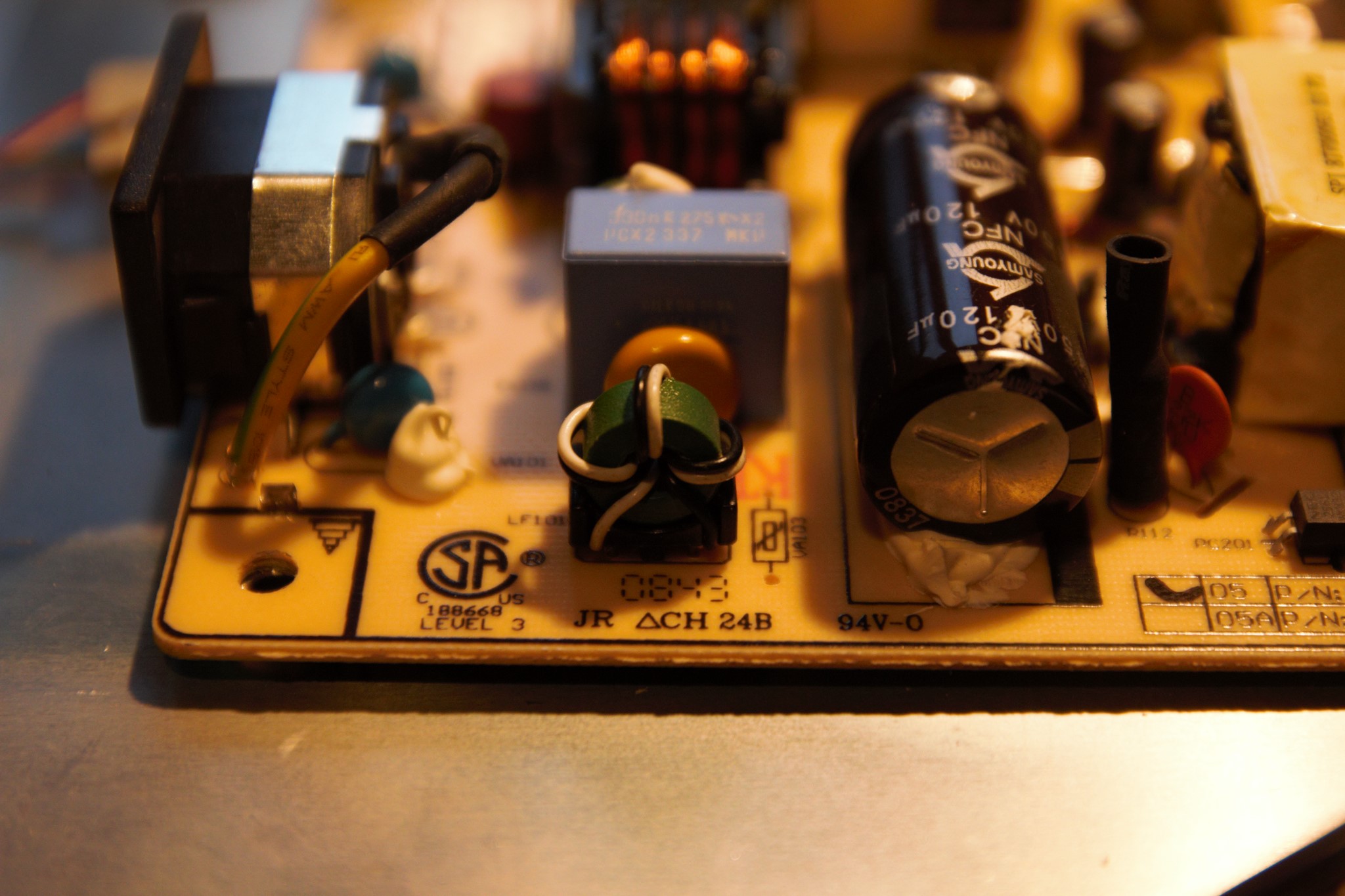

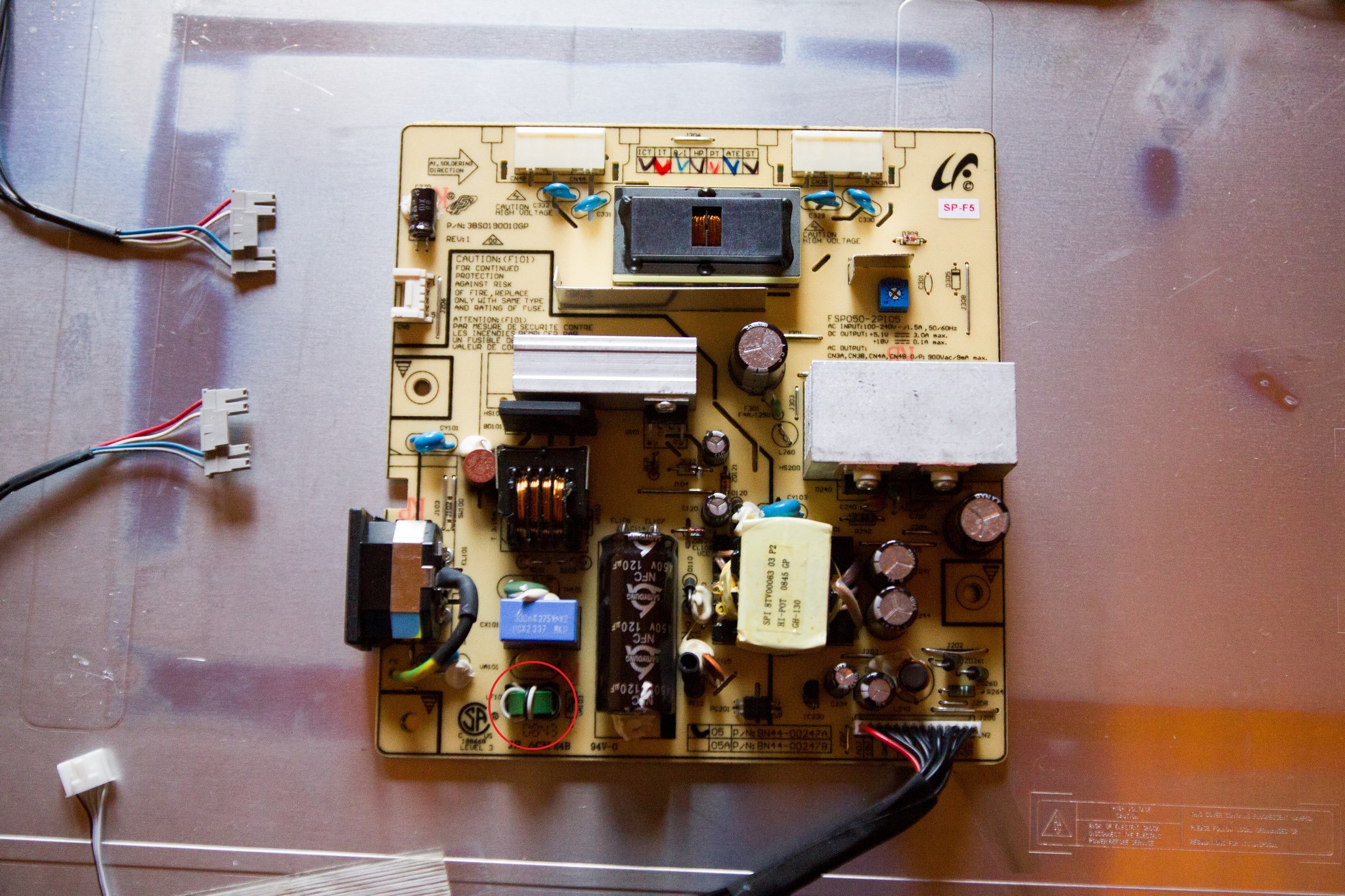

    - little bit of charring on the bottom of what seems to be a very basic inductor coil (circled in red in the pictures, only identification I could find was the nr LF101 written on the pcb)

    - can somebody identify this specific coil and point me in the right direction to find a replacement (if this is even possible)?

    That is a just an AC line filter, are the wires burnt? Do you get resistance < 1 Ohm between the white and Black wires? It looks like it has bad solder joints so it over heated.
    The main AC fuse (red cylinder) is OK? Do you get about 330VDC between the two legs of the main filter cap.
    BTW, that line filter can be bypassed for testing the rest of the circuits.

                              https://www.badcaps.net/forum/attach...0&d=1450194111
                              OK, it uses SMPS IC mounted on the heatsink to the right of the bridge rectifier, that IC is the main switching power supply that drives the main power transformer.
                              Get the P/N to get the pinout.
