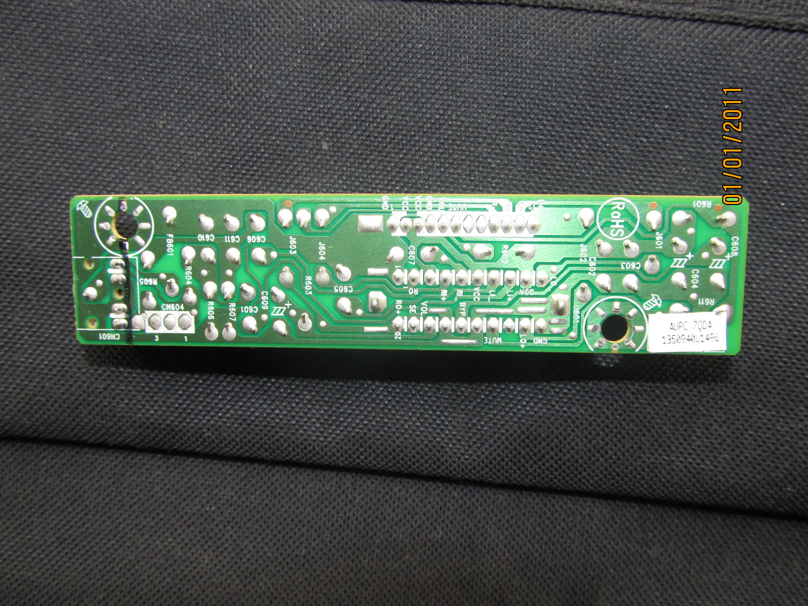

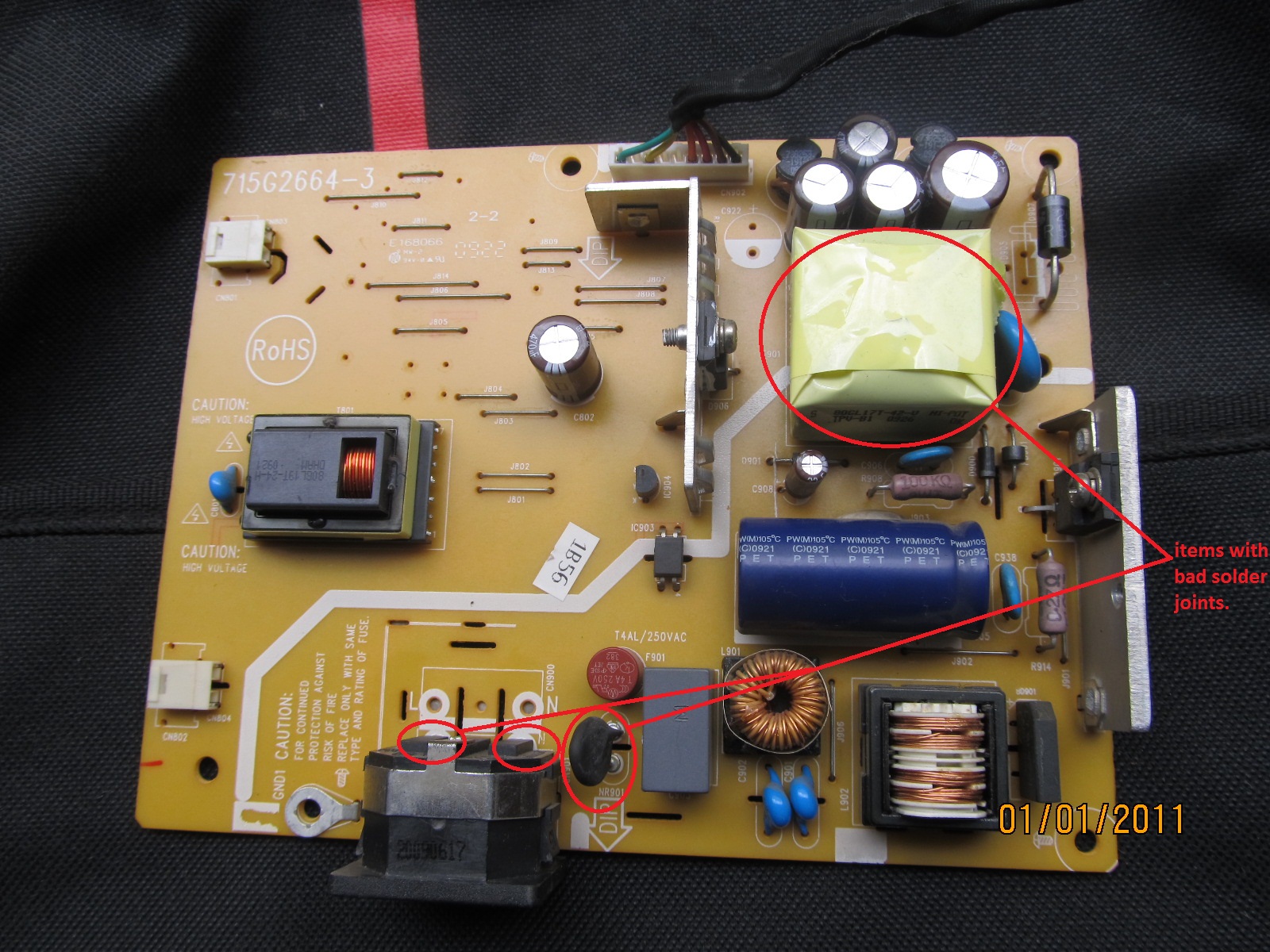

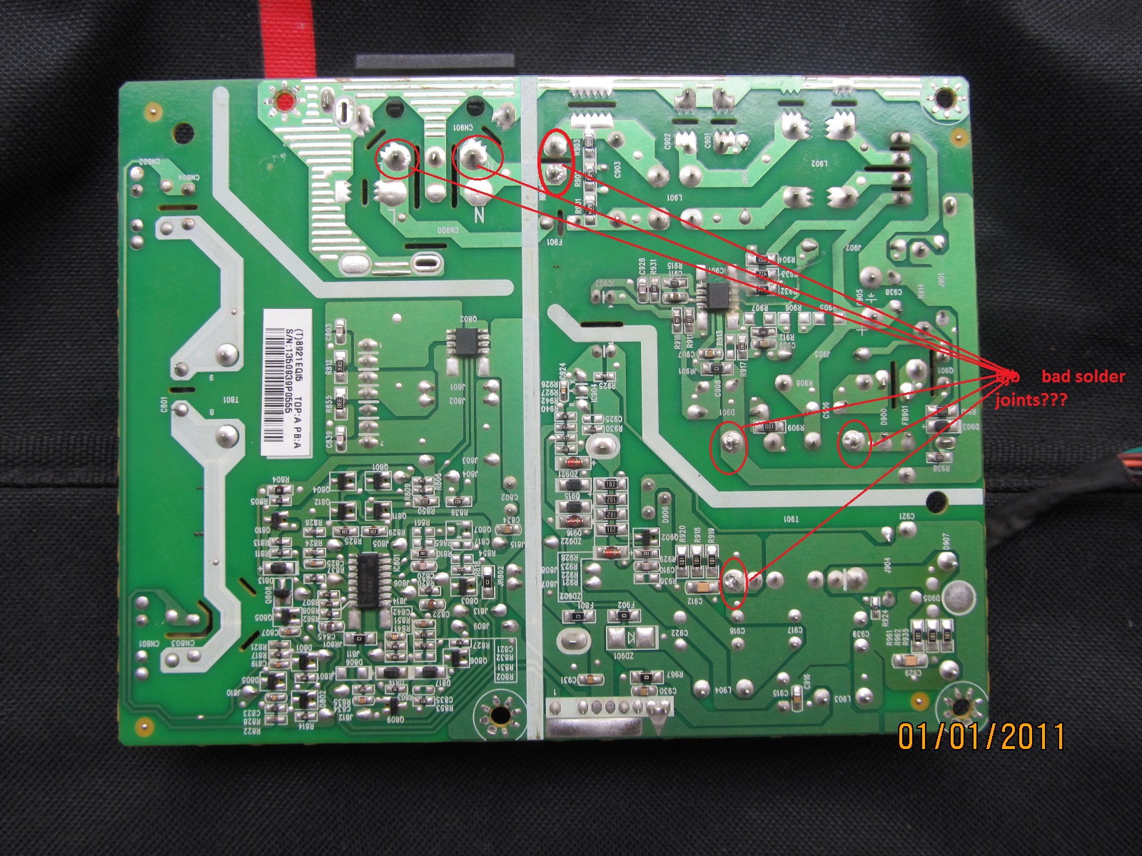

    5. some solder joints in powerboard not seems to be ok. it looks really bad with holes in it. check the pics for details and let me know is that bad solder joints.
    6.checked all the cables including cable from lcd for improper connection (with small led buld and AA battery). everything seems to be ok, no broken wires.
    kindly check the image guys. looking for help.

      Touch up those bad solder joints and see what happens

          Re: Acer x193hq lcd, no display but backlight and acer logo working
          hey bro , reheating solder joints not working. its showing cable not connected message with power light turning blue... someone plz help

            On the backside of power supply check SMD fuses F902,F801 they have a letter D stamped on them
                    Bro , checked that SMD F902 , F801 fuses for connectivity with a help of a small led bulb . blub glowing, hope it shows connectivity. Thanks . Guys need ur help . Monitor always showing cable not connected msg , vga cable is fine.
