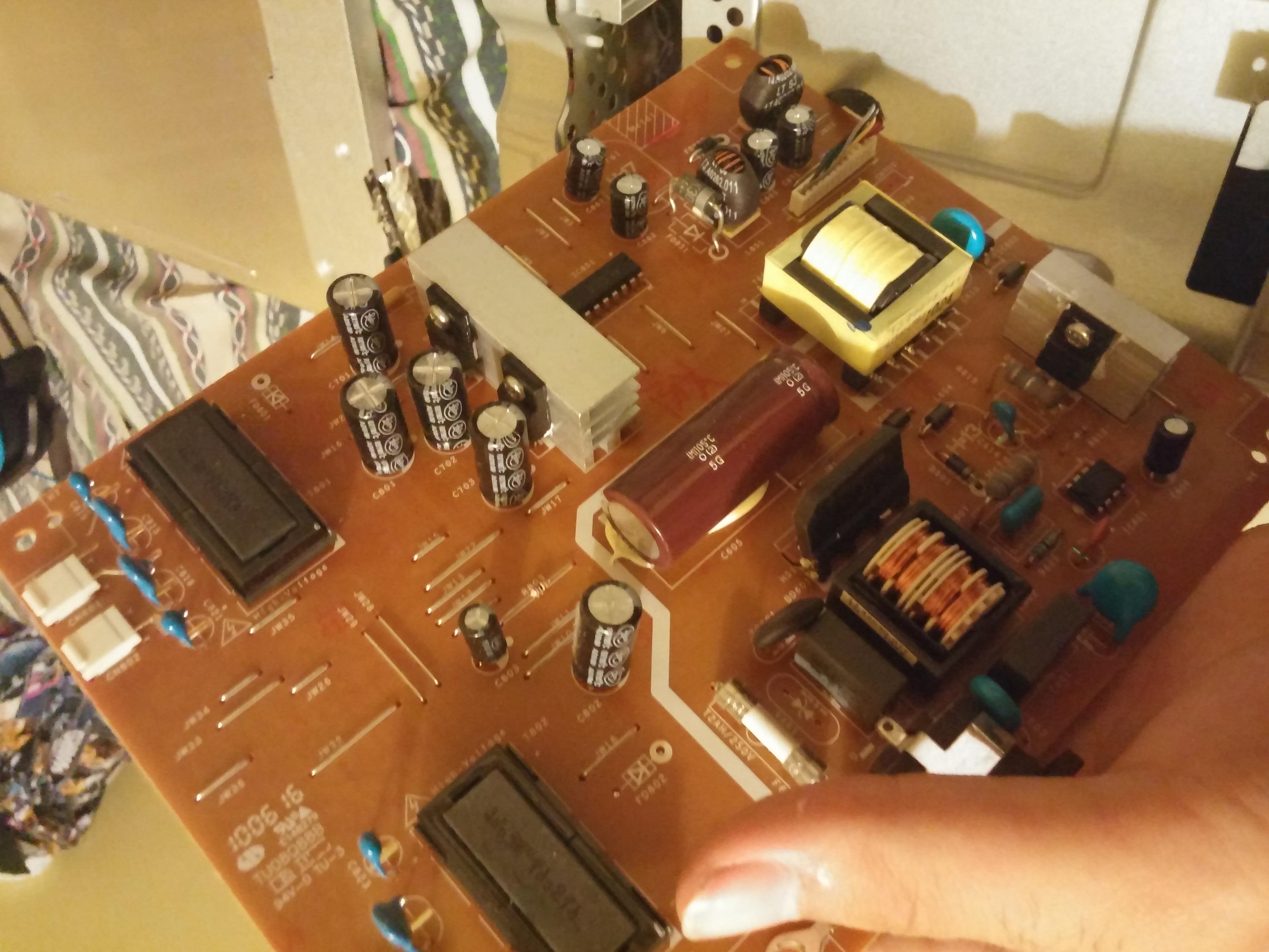

    This is gonna be my first thread so cut me some slack if I get any info wrong haha! So Ive been tinkering with my 27 inch monitor that had recently gone defective. I came to the conclusion that the problem were old capacitors that needed replacing ( 2 of them were also bad). I am now in the process of buying new capacitors for the power board. Now here comes my little problem.
    I actually don't know how to buy them haha. I have the Uf and Voltage for each individual capacitor but I just dont know how/a reiliable website to buy them. I know there are many different types of capacitors as well but I dont know the type that goes on the monitor power board. Please teach me the ways of the capacitor!
    (or just send me a shopping cart with all the parts I need! Ill provide the Uf and Voltage specs.)

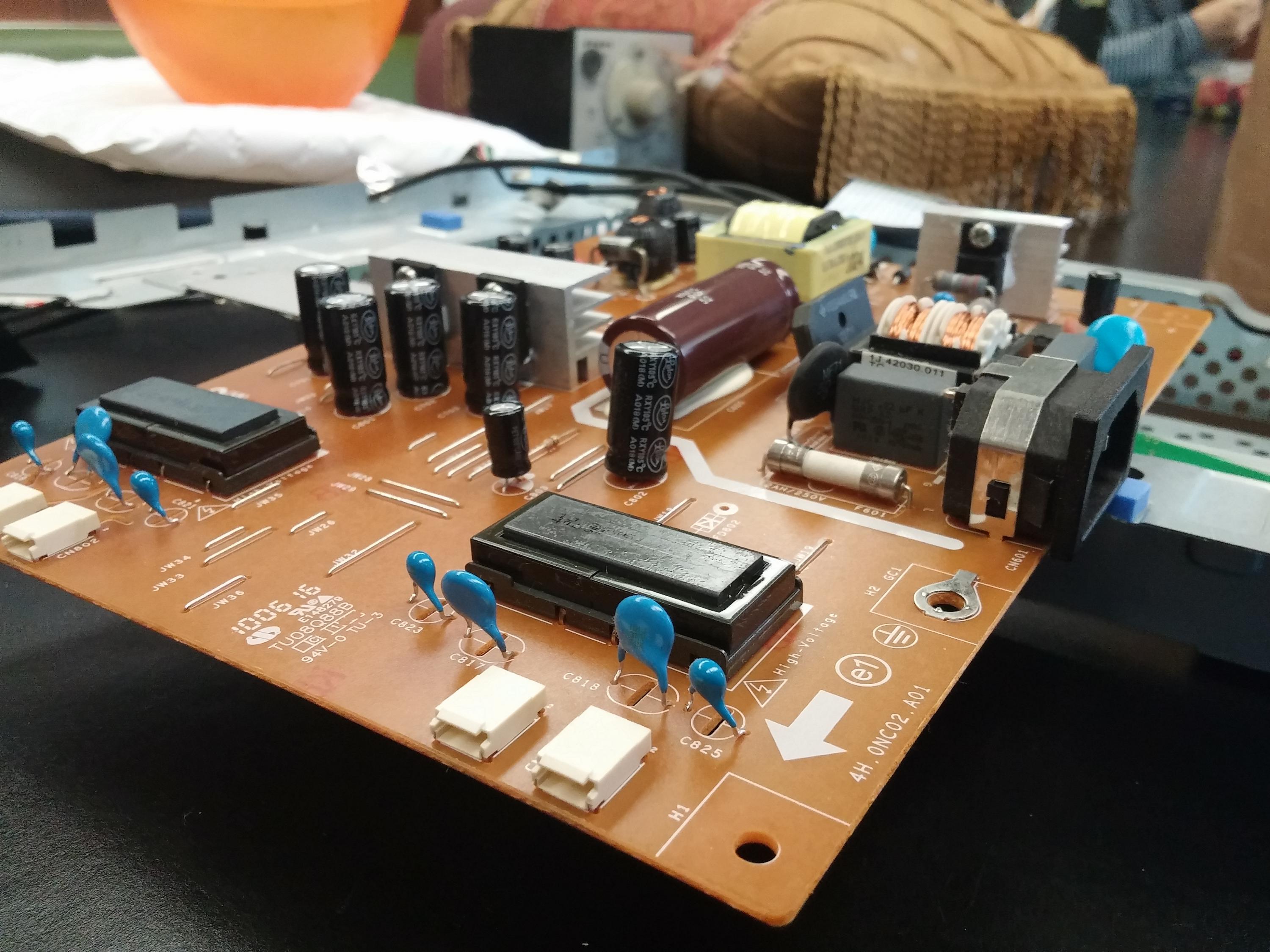

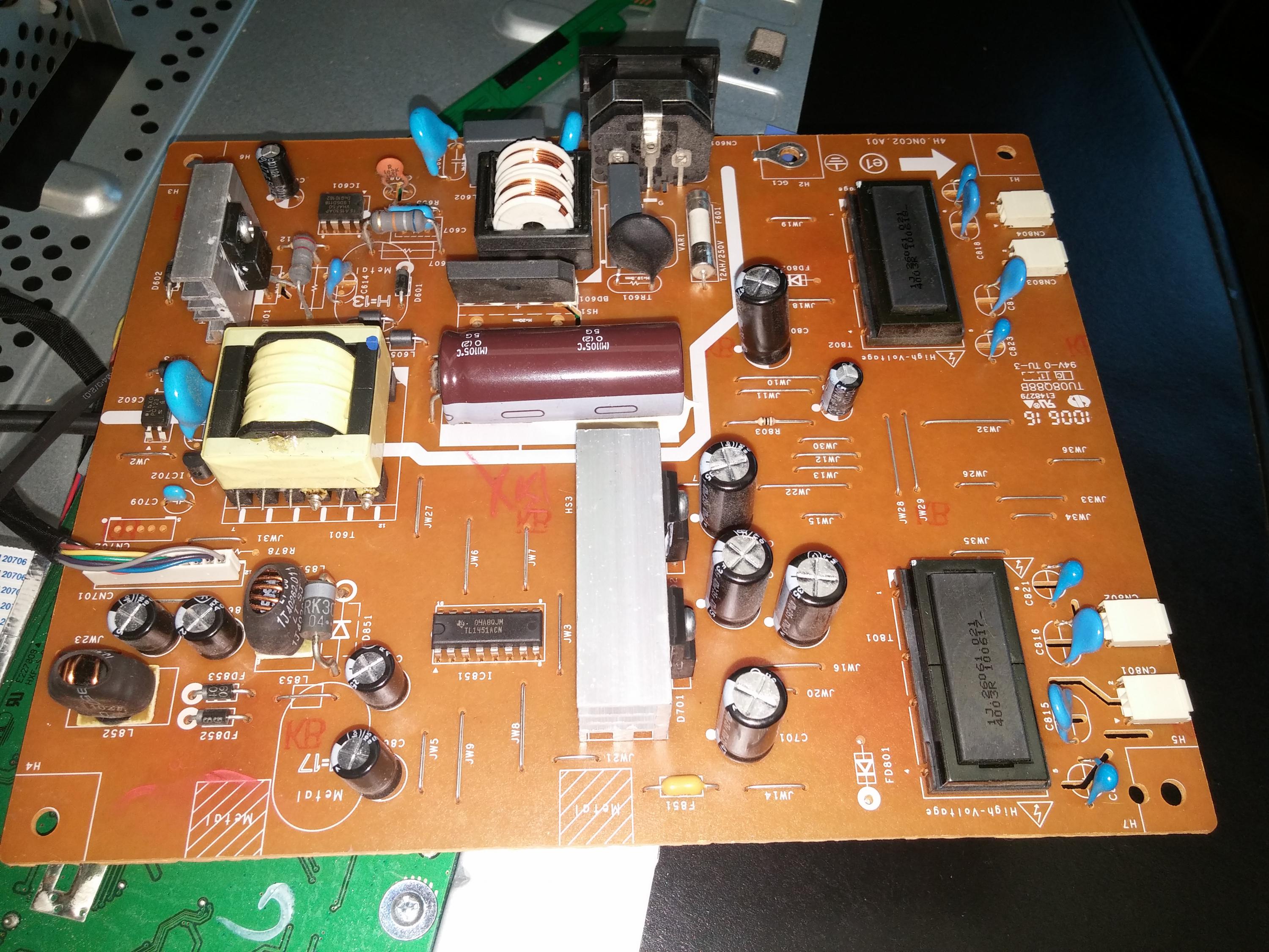

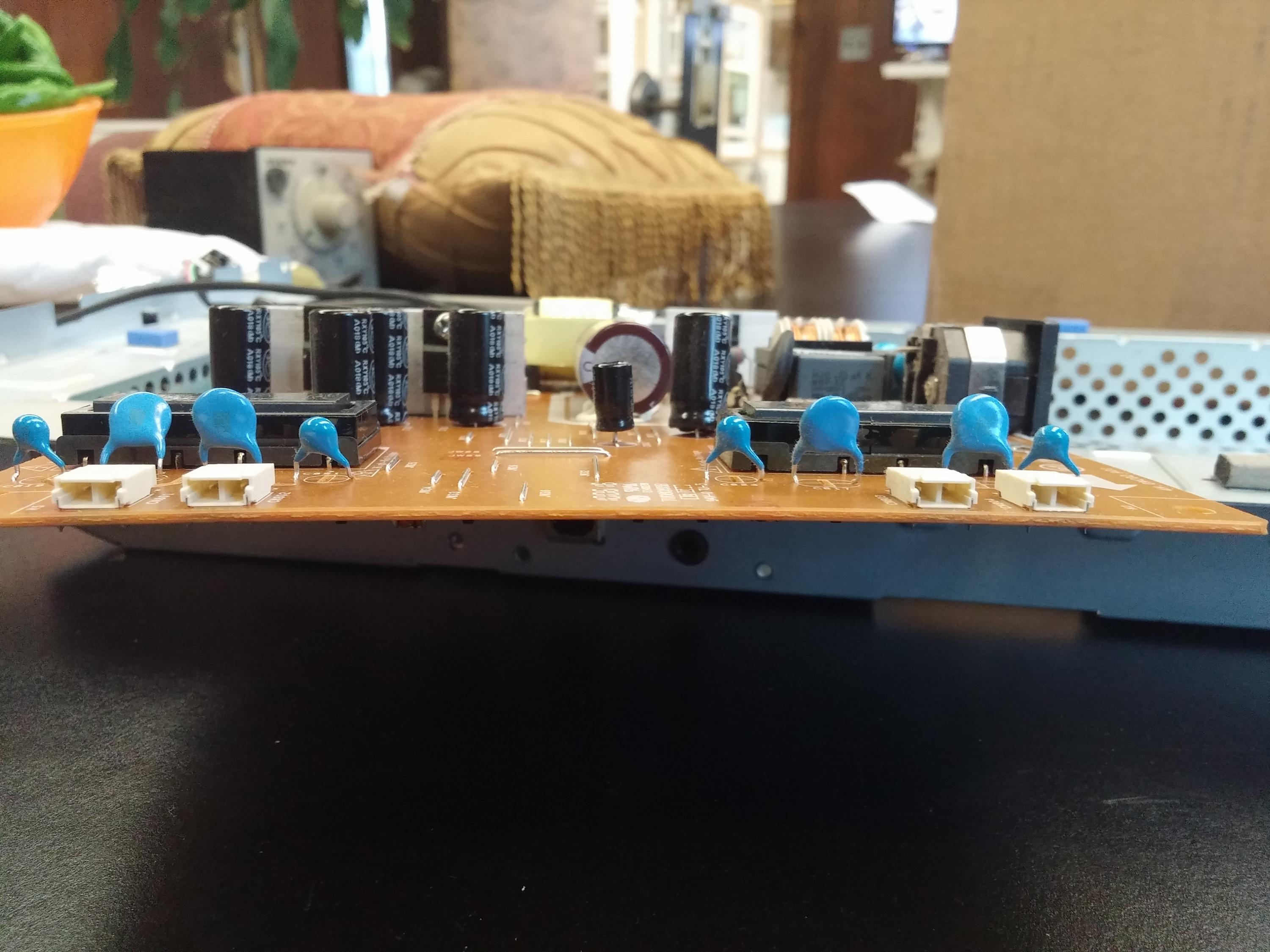

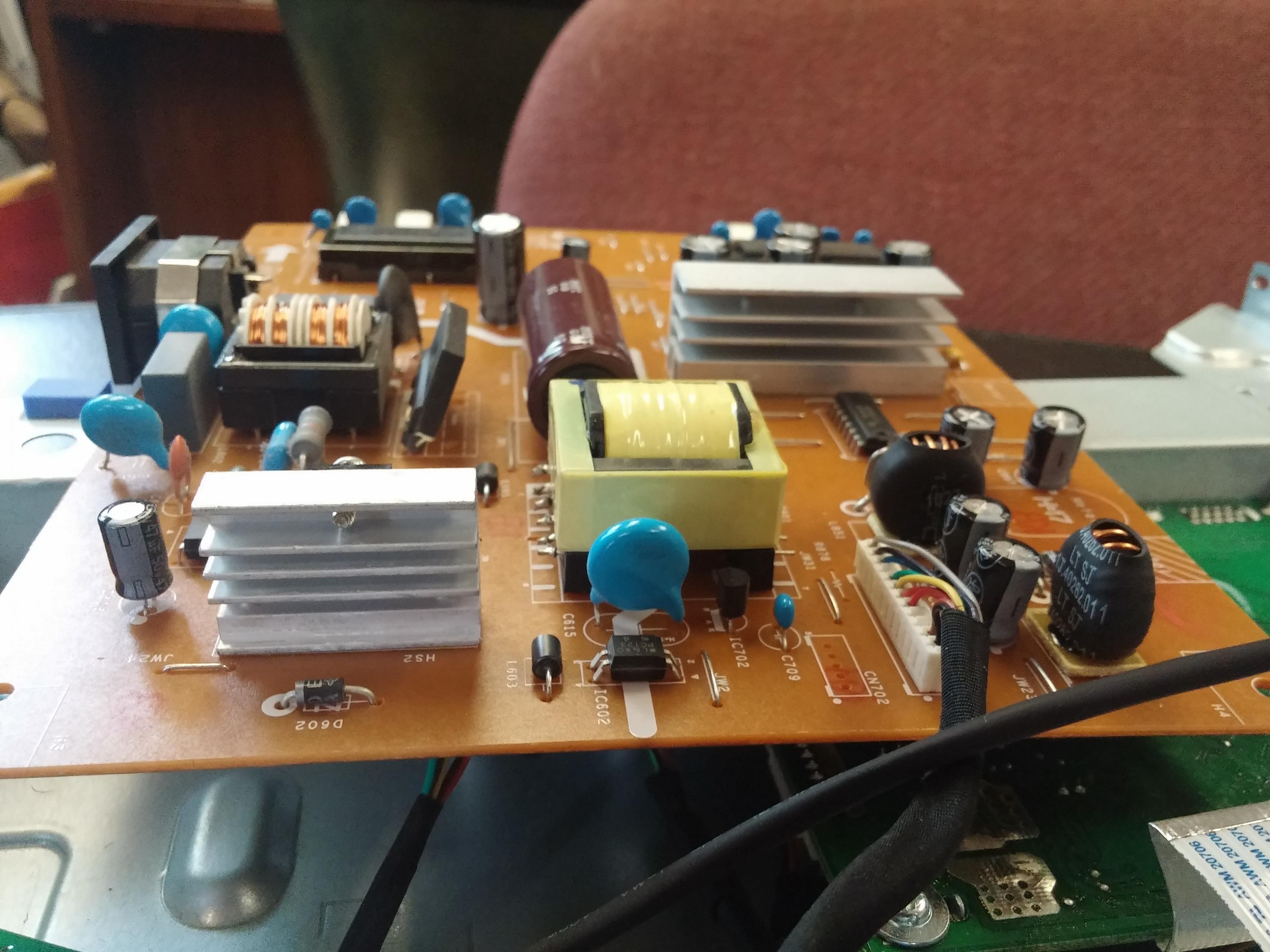

    Here are the specs! I have also attached some pictures.
    470 uf 35 VOLTS x5
    47 uf 50 Volts x 2
    220 uf 25 volts x 3
    If guys could guide me on where/how to buy them, I will truly appreciate it! Thank you.

      Re: ASUS VK246H 2 Seconds To Black: What to buy?
      firstly use panasonic FR series.
      now about your specs.

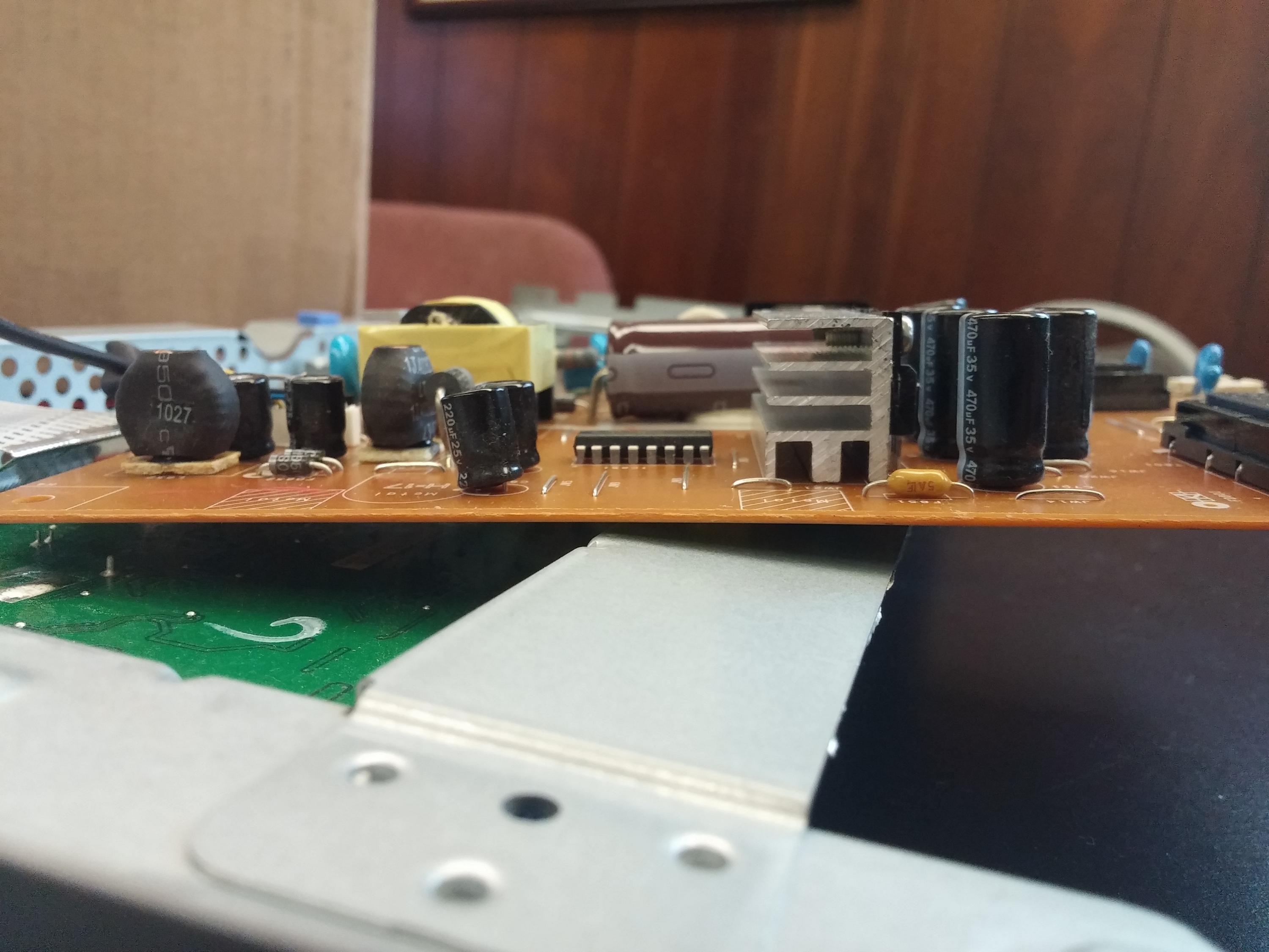

      you also need the diameter and height.
      and your photo shows 5 of one type and 4 of the slightly smaller ones - why are you only listing 3?
          Thanks for the response STJ!

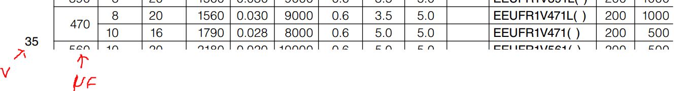

          I have a few questions! So what type of termination style would these capacitors fall under? Radial or SMD/SMT?
          Also, I was looking at the sheet and none of the capacitors fit the same UF and Voltage (I provided it below) of the capacitors I had. Maybe Im just looking at it wrong? But I will now provide the update specs with measurements!

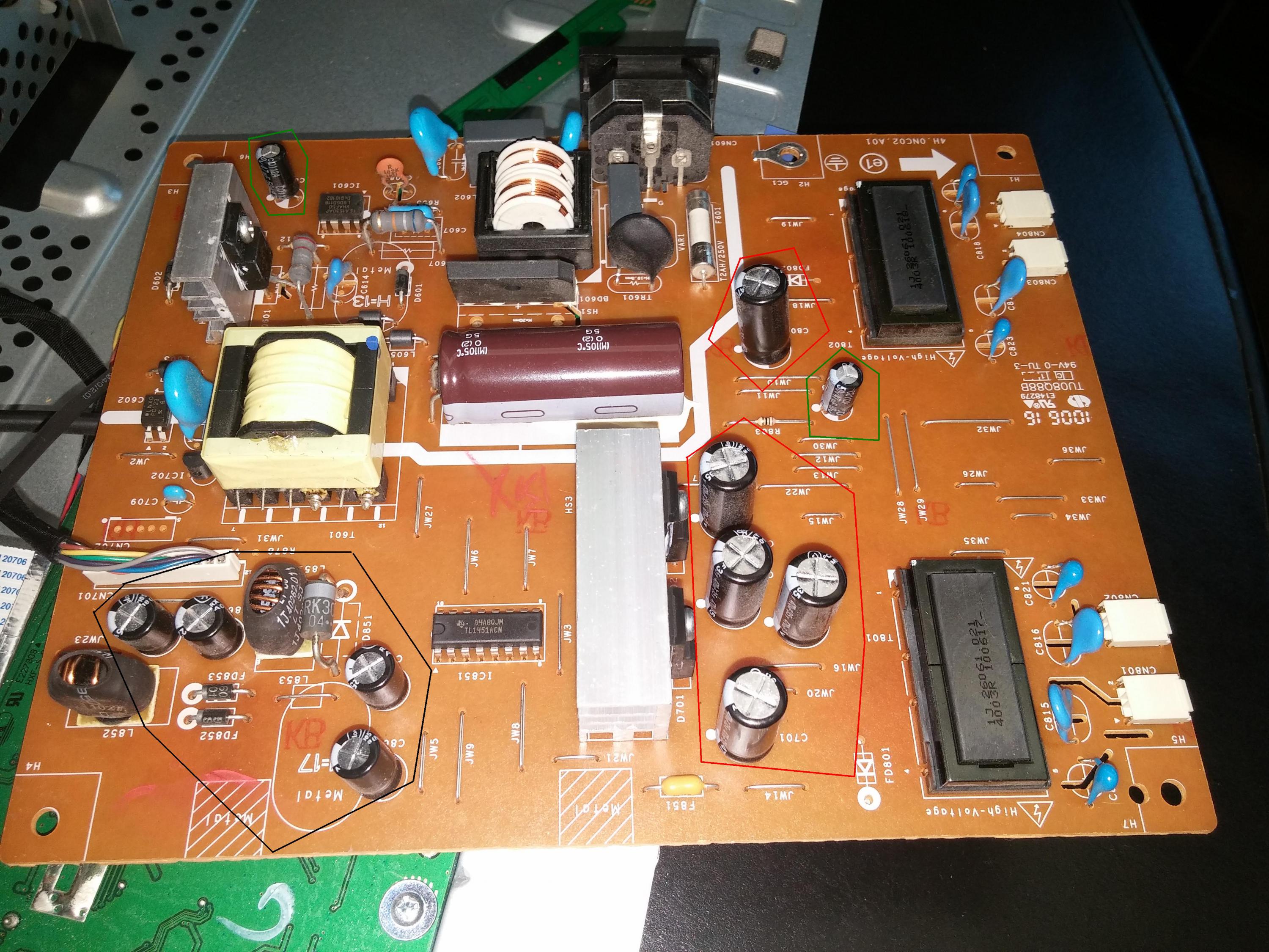

          470 uf 35 Volts x5 - 12.7 mm x 19 mm - RED OUTLINED
          47 uf 50 Volts x 2 - 6.35 mm x 12.7 mm - GREEN OUTLINED
          220 uf 25 volts x 4 - 12.7 mm x 12.7 mm - BLACK OUTLINED
          (note: To answer your last post, the picture probably did not distinguish them too well but Ill circle out to you which one are which. I also made a typo on the quantity. I provided an attachment below.)
            They are radial. If you open the datasheet, the voltages are down the left hand side in bold with the capacitance just to the right. See the example attached. Sometimes the sizes aren't the same, go for the closest.
              they are radial.
              can with both wires at the same end = radial.
              i see the problem with matching FR series - let me check for a newer datasheet.
                • 31214
                newer datasheet.
                so.
                47uf 50v 6.3 x 11.2 - EEUFR1H470
                about the 12mm diameter ones - if you look under the board, are there holes to use 10mm ones?
