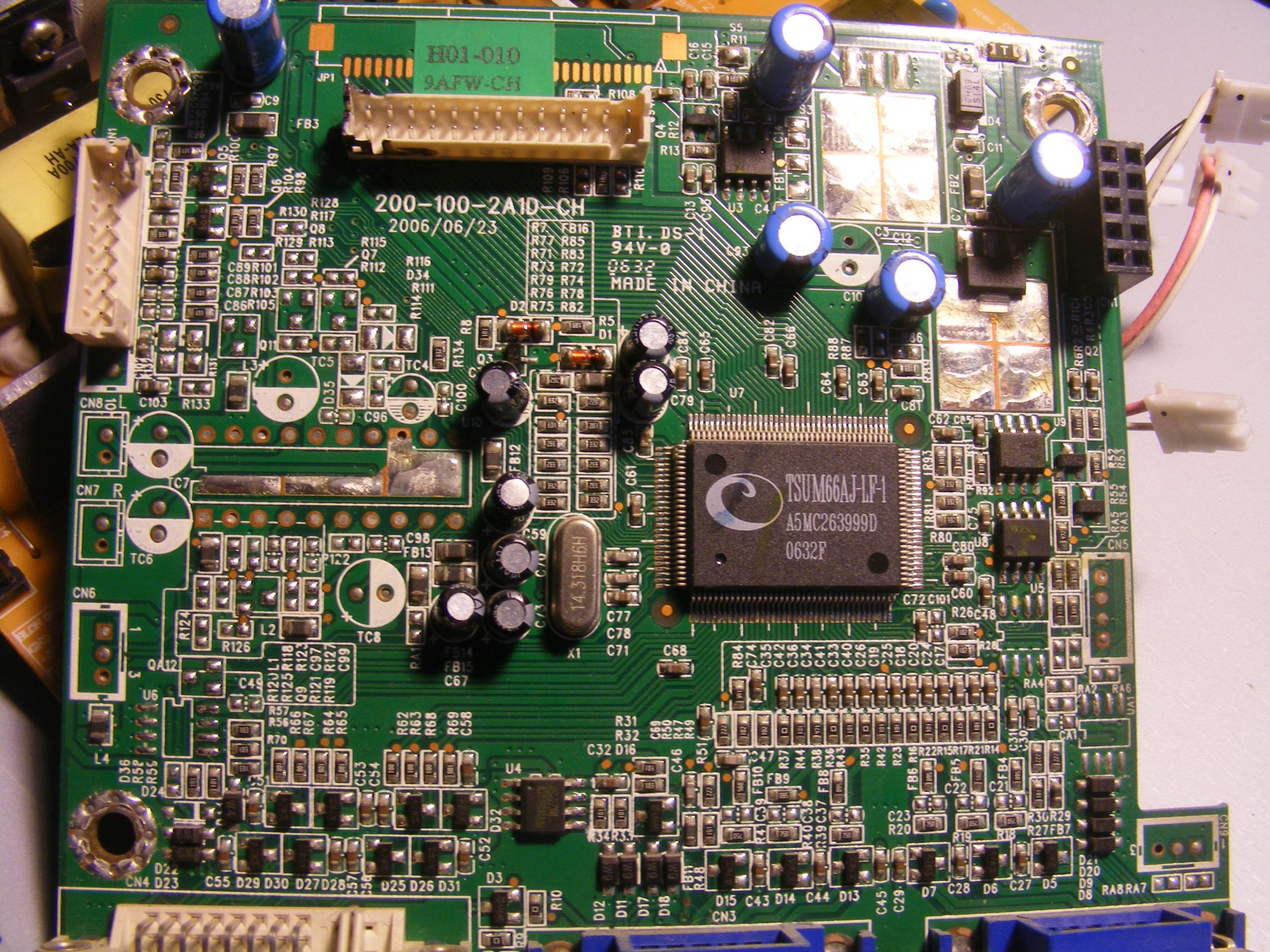

    LCD monitor 19" man. 2006. Two VGA and one DVI sockets.
    The power on LED never comes on.
    When I first got it this week, it worked fine for 5 minutes. I turned it off, and when I came back to it a few minutes later, it started to malfunction, see numbers 1 & 2 below for description.

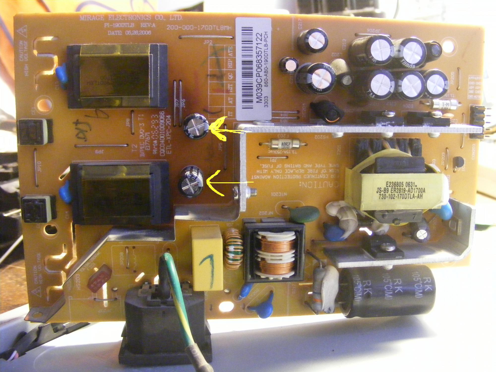

    I opened it up, and found two bad caps. (They're marked with the yellow arrows.) After I replaced the two caps it now gives me the following behavior:
    1. If no cable is plugged into the VGA sockets, or if plugged into VGA "#1", I get a black screen. If I press ANY of the control buttons, for as long as I press on it, I get a grey screen. If release any button, the screen reverts to black.
    2. If I plug into VGA socket "#2", I get a black screen. This time, if I plug into any of the buttons, I get either:
    a. a black screen; b. a grey screen; c. a grey screen with very fine vertical colored lines.
    I've searched for this one, but I can't find it.
    The board is browned out near to where I replaced the caps, but other than that nothing looks unusual. Except on one chip, labeled IC 201, there appears to be a white substance (runaway glue?). It's marked in the pics, again with a yellow arrow.
    thanks a million!

    Have you tested the fuses I see 2 but thought there should be 3 on this board
    Later- I see it now - 2 white small cylindrical and one red block

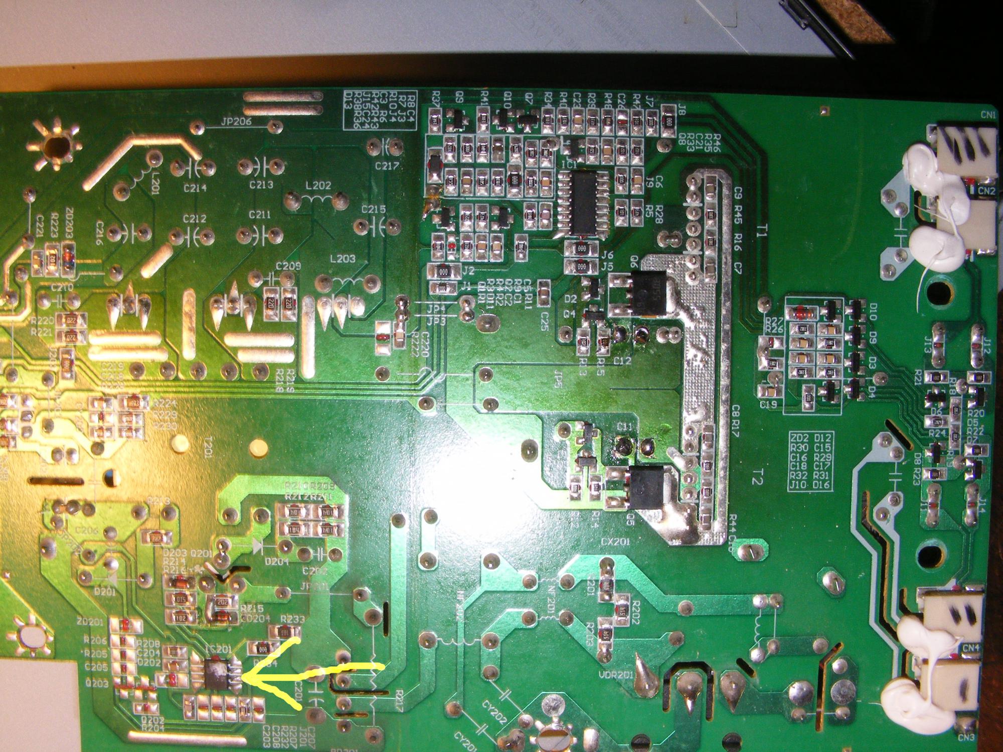

    Also on the logic board top right in your picture there is a small smd fuse with a T on it.
    Later still - can I assume you replaced the caps the right way round - they have polarity.
    also what make/series caps did you use - from a reputable seller?

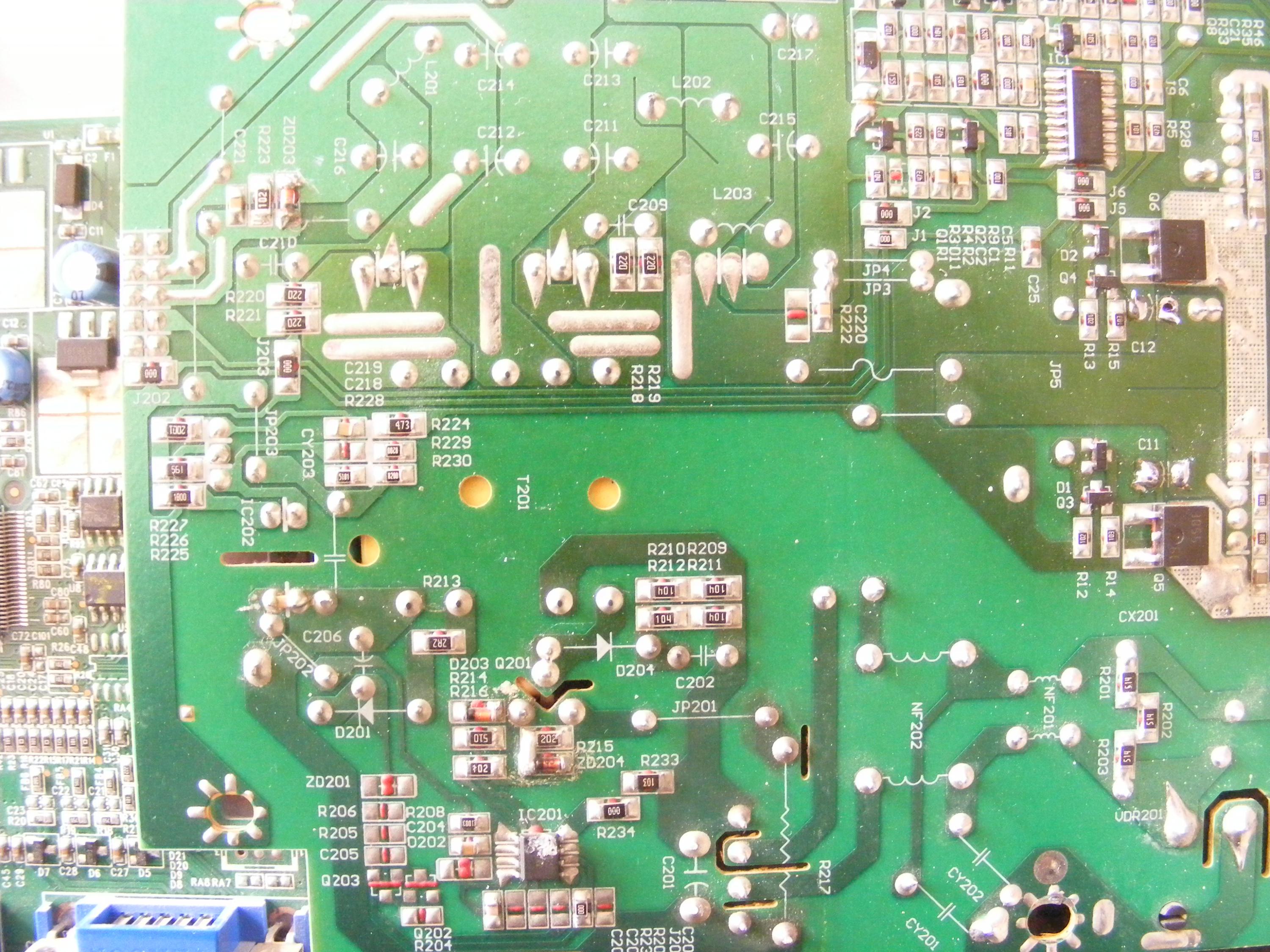

      Also check zener diode ZD203 (last photo/ left side) for a short. For this board, it's across the 5V output and is known to short out.

        1. the 2 white fuses and the black SMD with the T on top check out OK. The red block reads 76 ohms. (That's the one next to the power cord jack, right?)
        2. the new caps are CapXon brand. (the old ones are xunda, and one small su'scon)
        3. yes, I installed the new caps polarity correctly
        4. zener diode test using the diode tester on my voltmeter, black lead on black end of diode (red lead on red end of diode) :
        0.136V; leads reversed: 0.439V
        hmm.. ZD2 reads 0.739/0 V;
        ZD204= 0.575/0.920; (leads normal/reversed).
        so I'm confused. Is ZD2 the only good one?

            Do as selldoor suggested and remove ZD203 and test in ohms mode.
              Re: MAG T906W Black Screen, Grey Screen, Vert. Lines, you name it!
              now the red block fuse reads full continuity.
              ZD203 is 292 ohms one way, no continuity w/leads switched.
              just for fun,
              ZD2 reads no continuity in either direction
              ZD204 reads no continuity in either direction

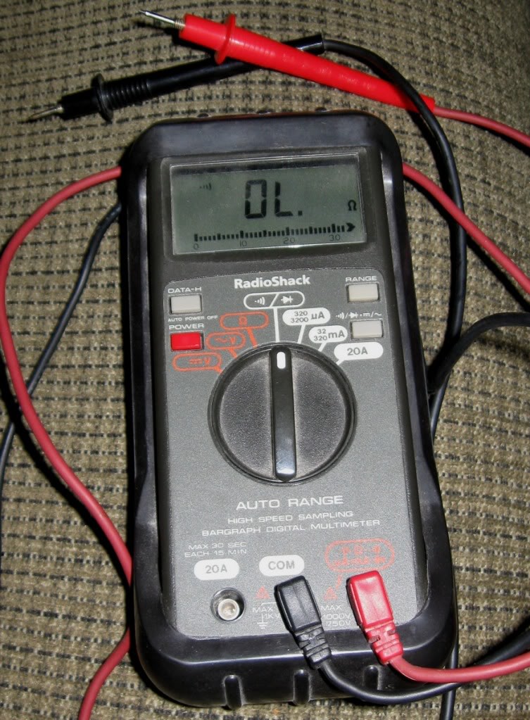

                What does it say on the meter when you are saying no continuity OL "1" on the left hand side or something else - what ohms scale are you using - should be 2000.
                Are ZD2 and ZD204 off the board as well?
                  although it's not at hand, my digital VOM doesn't have a 2000 setting, just regular, k, and M ranges.
                  I've been reading it at regular, not high, ohm settings.
                  When I say no continuity, that means 0L. Continuity means 0.5 ohms or less.

                    Can you post a picture of your meter and if its not clear from the picture tell us the make /model The test results are inconclusive as we dont know what scale you are testing on. It will report OL if overscale.

                      Again, in circuit, with the VOM on the "k"Ohm scale, (thousands of ohms), ZD203 reads 0.73 kOhms in both directions. That means 730 Ohms either way.
                      If the ZD is bad, what can I do? Is there a way for me to know what value it is?

                        Ok I have the manual for your meter and setting seems ok.
                        Are the batteries in it good - I ask as each time you test something the value
                        seems to change.
                        This result means it is is probably OK

                        But why is it so different - Need to take it off the board to eliminate nearby components messing up the test
                          OK, so I got ZD203 off the board. It's not my problem.
                          It reads 23.x M ohms leads one way; 0L with the leads reversed (on the "M" ohm scale).
                          It also passes the diode test, 0.753V leads one way, 0L reversed.
