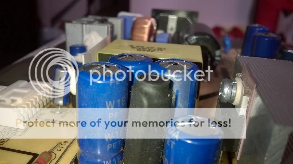

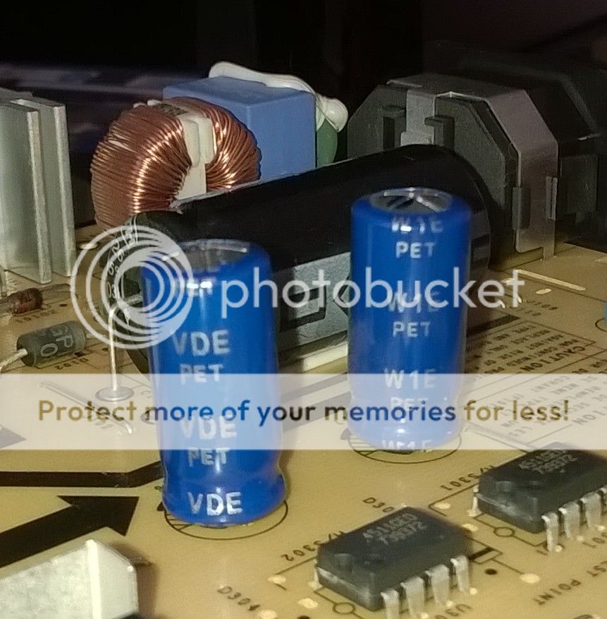

Samsung Syncmaster 223BW
  • ceryni
    • Aug 2014
    • 4
    • United Kingdom
    Samsung Syncmaster 223BW
    Hi everyone,
    I'd like to repair this monitor myself, I got it for free but its got crap caps
    Theres 2 photos of the caps on the power board. How much am I looking at for new decent caps for this board? so far seems like around £6
    5x 25V 820
    1x 25V 330
    Can I manage with this that I bought about 6 months ago?
    http://www.ebay.co.uk/itm/Soldering-...item19e2b1e284
    The only soldering experience I have is simple e-guitar fixes.
    But not a electronics question I need to replace the ARAG film on the monitor as it's scratched to pieces and i have subsequently removed the film.
    I now need new film. But I can't find it anywhere!
    AMD Phenom II X4 OC'd @3.7 :: Gigabyte UD5P:: Phantek PH TC14CS
    8gb DDR3 RAM: 2 x kingston hyper X, 2x corsair XMS3
    Lian Li :: BDD :: 120GB SSD, 1TB HDD
    Radeon HD6850 :: Corsair GS600
  • selldoor
    Slow Learner
    • Dec 2010
    • 7870
    Re: Samsung Syncmaster 223BW
    We dont really like offsite pictures on here - please edit your post and
    re post them using manage attachments Jpgs less then 3mb work well
    Without the pictures the thread is meaningless and of no help to future members
    Too late for that now I will upload them
    The caps you need are PANASONIC EEUFM1E331L &PANASONIC EEUFR1E821 or nichicon or rubycon eqivalents - checkthey will physically fit where they have to go. CPC have a minimum £5 order for free post and they only come to around £2-50 so you may want to get a bigger order and do the rest of the board. We do not recommend ebay for caps.
    That soldering iron should be ok - try and get in a bit of practice first.
    I dont know where you can get that film from.
    Last edited by selldoor; 08-16-2014, 09:56 AM.
    • ceryni
      • Aug 2014
      • 4
      • United Kingdom
      Re: Samsung Syncmaster 223BW
      Sorry I only just came back. There isn't an edit function...
      And I just found the sticky talking about this. Apologies...
      Last edited by ceryni; 08-16-2014, 09:54 AM.
      AMD Phenom II X4 OC'd @3.7 :: Gigabyte UD5P:: Phantek PH TC14CS
      8gb DDR3 RAM: 2 x kingston hyper X, 2x corsair XMS3
      Lian Li :: BDD :: 120GB SSD, 1TB HDD
      Radeon HD6850 :: Corsair GS600
      • ceryni
        • Aug 2014
        • 4
        • United Kingdom
        Re: Samsung Syncmaster 223BW
        Thanks for the great info!!
        I'll find out what I need for my Samsung le40m86bd HDTV too before ordering!
        Will post again if I run into problems
        AMD Phenom II X4 OC'd @3.7 :: Gigabyte UD5P:: Phantek PH TC14CS
        8gb DDR3 RAM: 2 x kingston hyper X, 2x corsair XMS3
        Lian Li :: BDD :: 120GB SSD, 1TB HDD
        Radeon HD6850 :: Corsair GS600
          09-07-2024, 05:50 AM
        • soopacrucial
          Samsung Syncmaster 740BF repair
          by soopacrucial
          Hi folks,
          I'm new here and was wondering whether you might be kind enough to give me some advice on troubleshooting the following problem:
          Quite a few years ago now, a couple of years from new, my Samsung Syncmaster 740BF LCD monitor starting playing up by making a buzzing noise and then the display would go blank. I seem to remember the blue power led would also go off when this happened but that I'm not 100% sure of. By pressing the power button I do remember I could at first get it working again but eventually the problem would come back. At the time I had read about...
          10-29-2024, 02:40 PM
          09-06-2024, 11:40 PM
          09-06-2024, 11:40 PM
          09-06-2024, 08:40 PM
