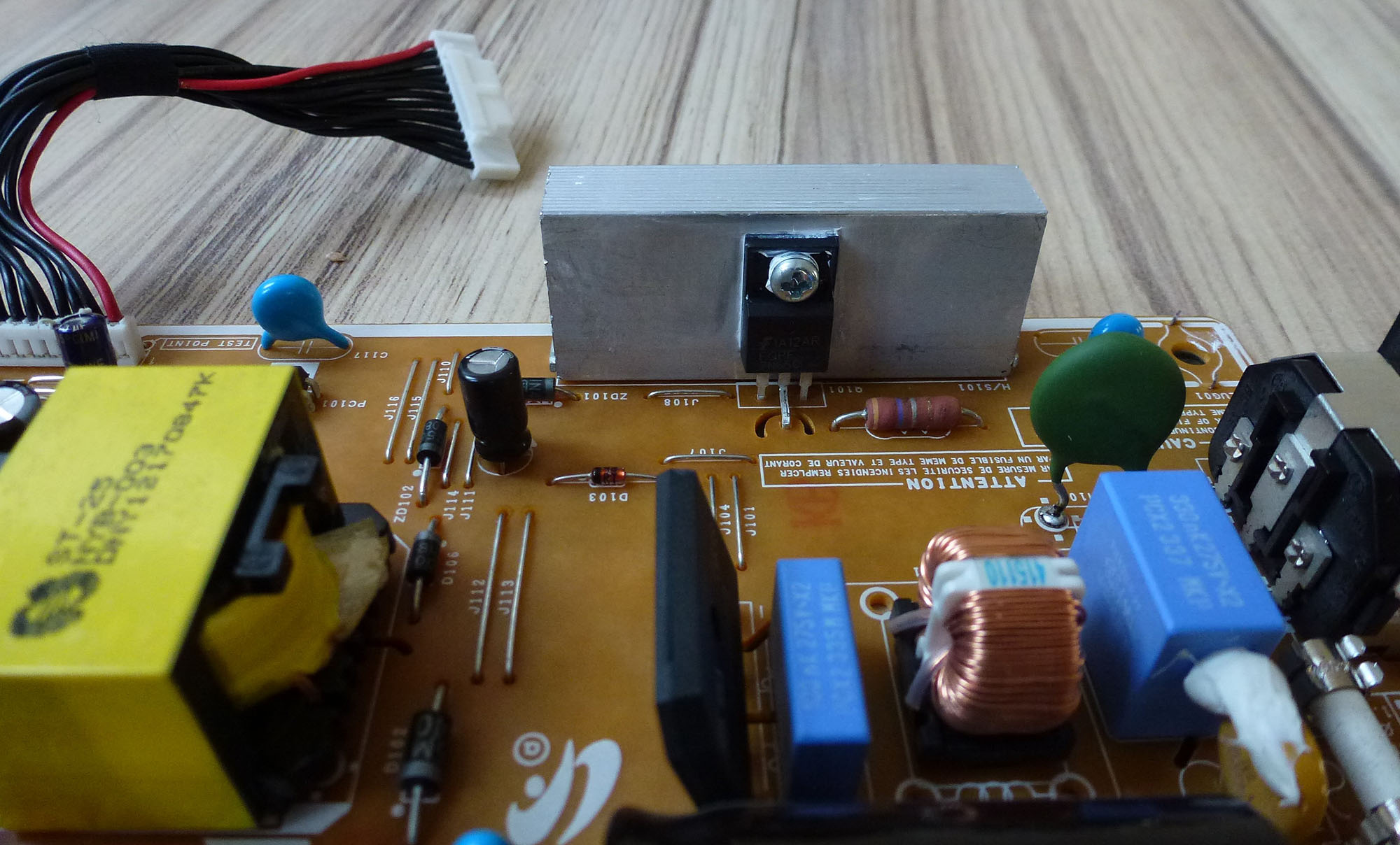

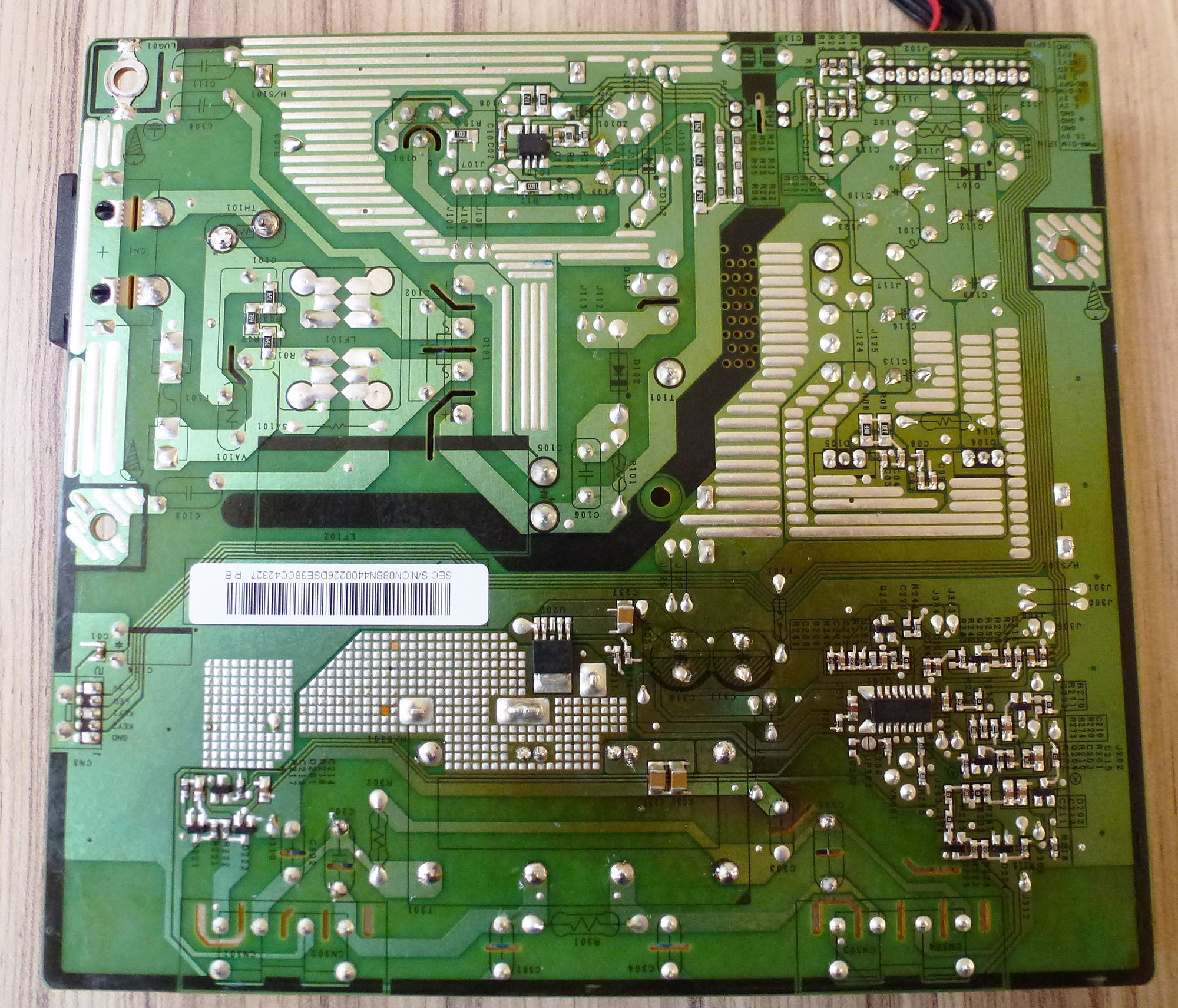

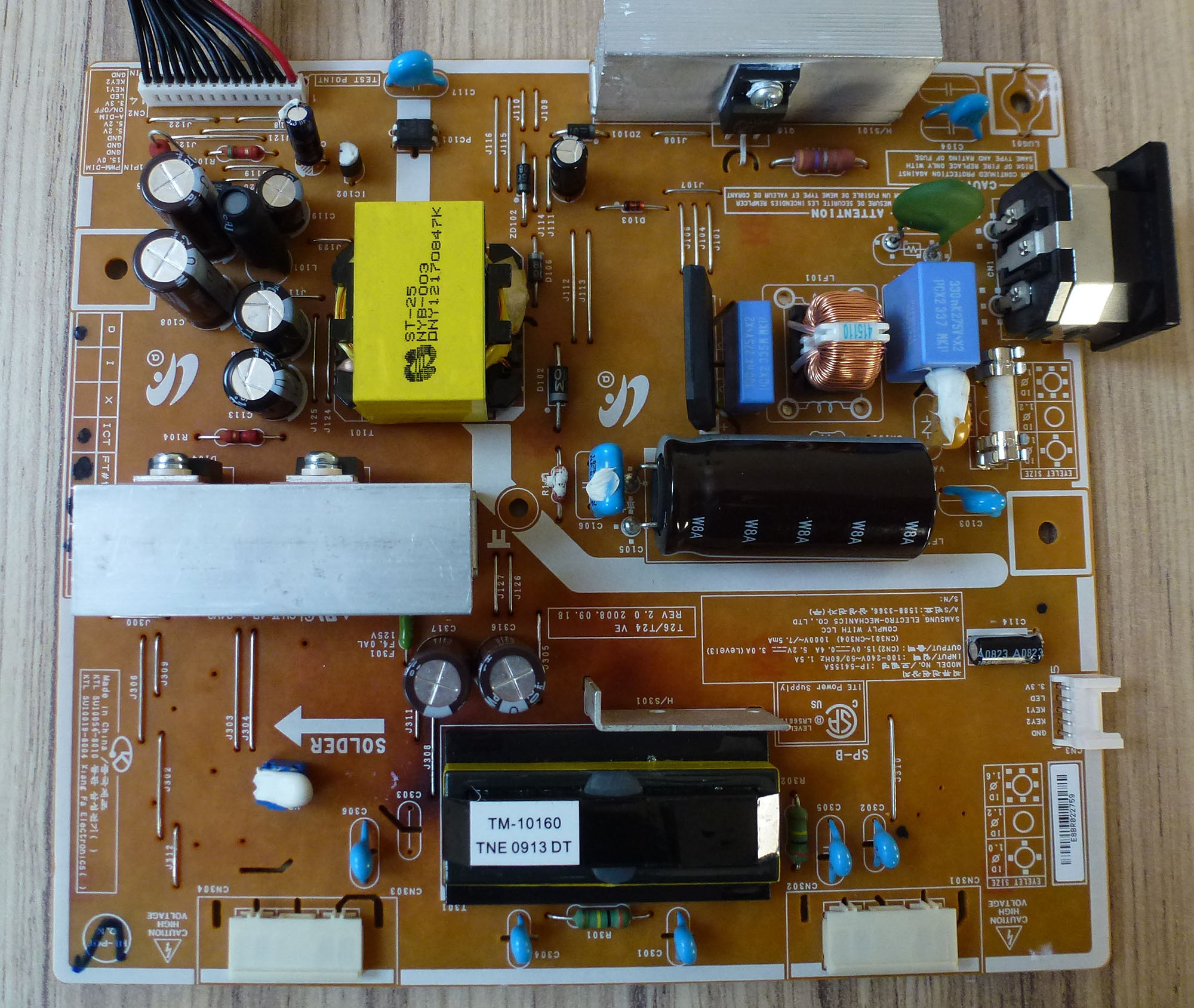

    Hi, got a Samsung Syncmaster T240 that appears totally dead. When I got it it had a blown fuse F101 3.15A. I replaced it and it immediately blew again and took out the Thermistor TH101 (SCK 056). Further investigation revealed Mosfet Q101 (FQPF 7N65C) was blown. I have replaced the mosfet, all the electolytics and the SCK 056 (with a SCK 057) I also replaced the inverter transformer with a new one from Ebay although the old one reads OK.
    Following the above the monitor is still totally dead, not even the power LED lights. Measuring voltages gives no output on any of the pins of CN2 or CN3. I do have 343 volts on C105.
    I measured (with a fluke 12 meter) every semiconductor I could find on the board and they all appear to be OK
    Plugging the monitor into a computer causes the computer to switch to 1920 by 1200! There is nothing visible on screen even with a powerful torch and the backlights don't come on.
    I tested the tubes with an external inverter and they all light up.

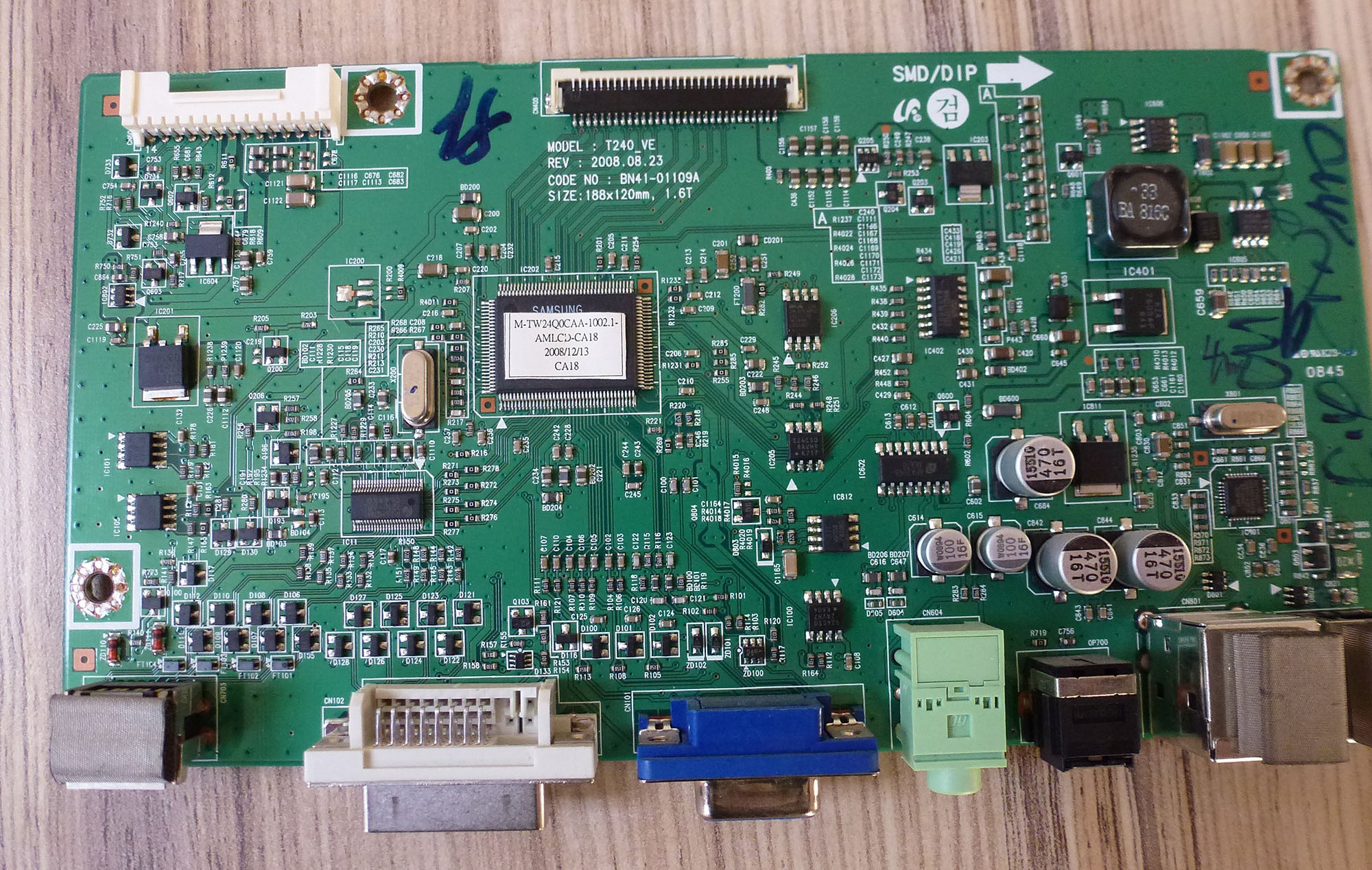

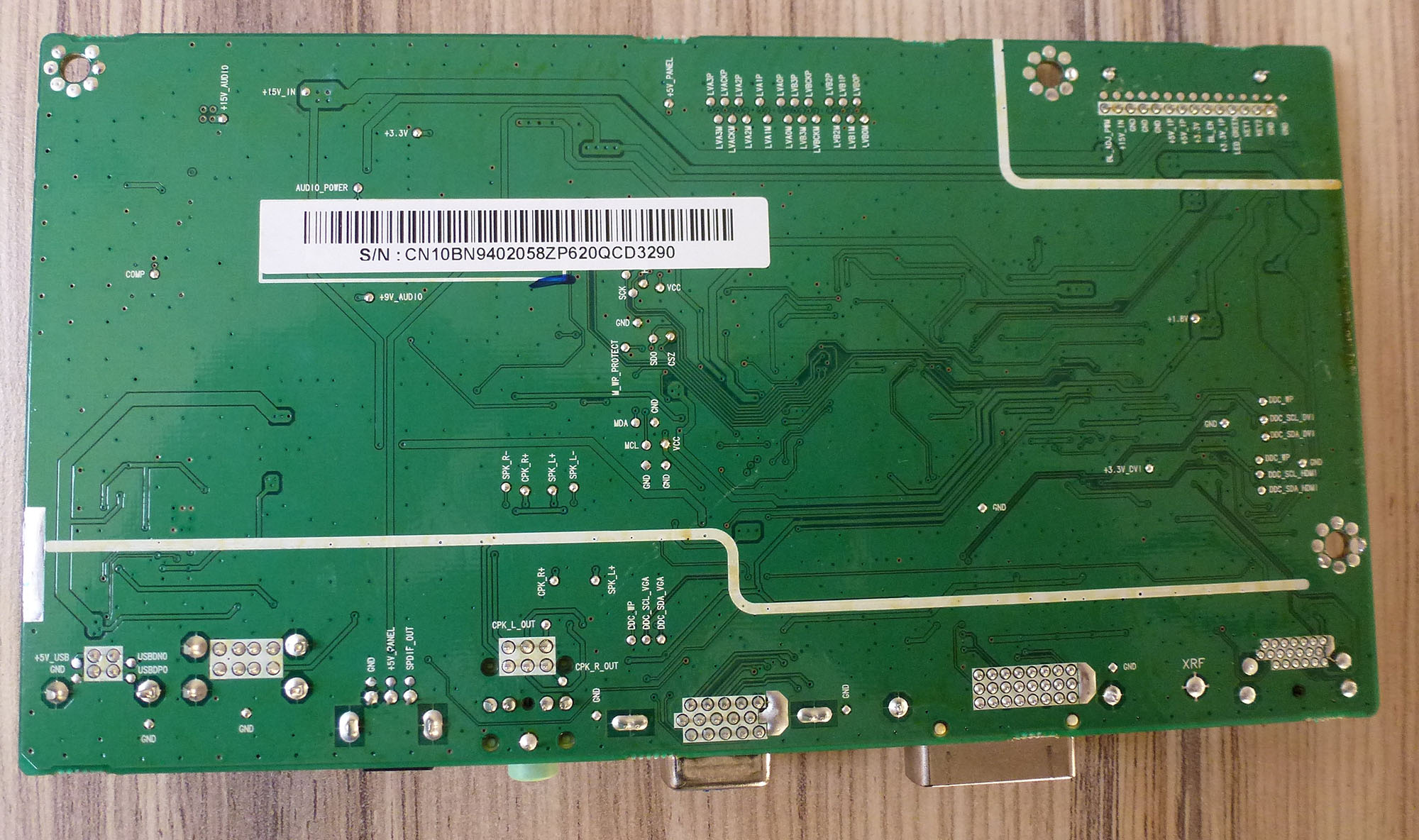

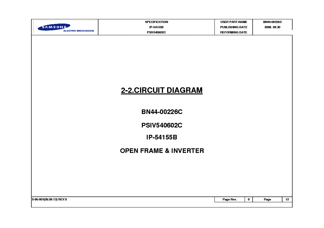

    I'm stuck now - any suggestions welcome. Pictures of boards attached and schematic of the C version of the board (mine's a D) but it appears identical.

    When that MOSFET Q101 shorted out, it probably took out the SMPS IC IC101 (8-PIN SMD) that drive the MOSFET with it, luckily you did not damage the new MOSFET.
    Please get the P/N as printed on top of the IC so we can look up the spec sheet.

        Also the big brown resistor to the right of the MOSFET (picture #1) may have blown open also, it should be <1 Ohm.

                    The inverter section where the Inverter transformer and the SMD POWER MOSFET on the bottom side got hot enough to turn the board dark brown, you should check to make sure the MOSFET is also OK.
                      Re: Samsung t240 Totally dead
                      The browning on the board isn't as dark as it looks in the photo and the tranny doesn't read shorted. It's an AP4506GEH on the board (STU312D on the circuit diag).

                            Monitor fixed with replacement power board. (arrived much faster than expected from China and looked new - no signs of heating on any components or board.)
                            Old board IC101, FAN7602B has different readings from new board compared to old so will look to replace that and see if old board can be brought back to life to keep as a spare.
