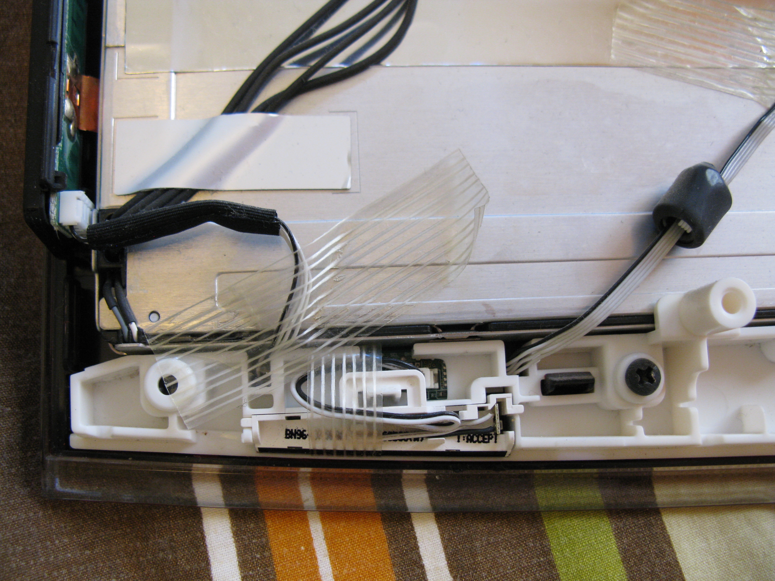

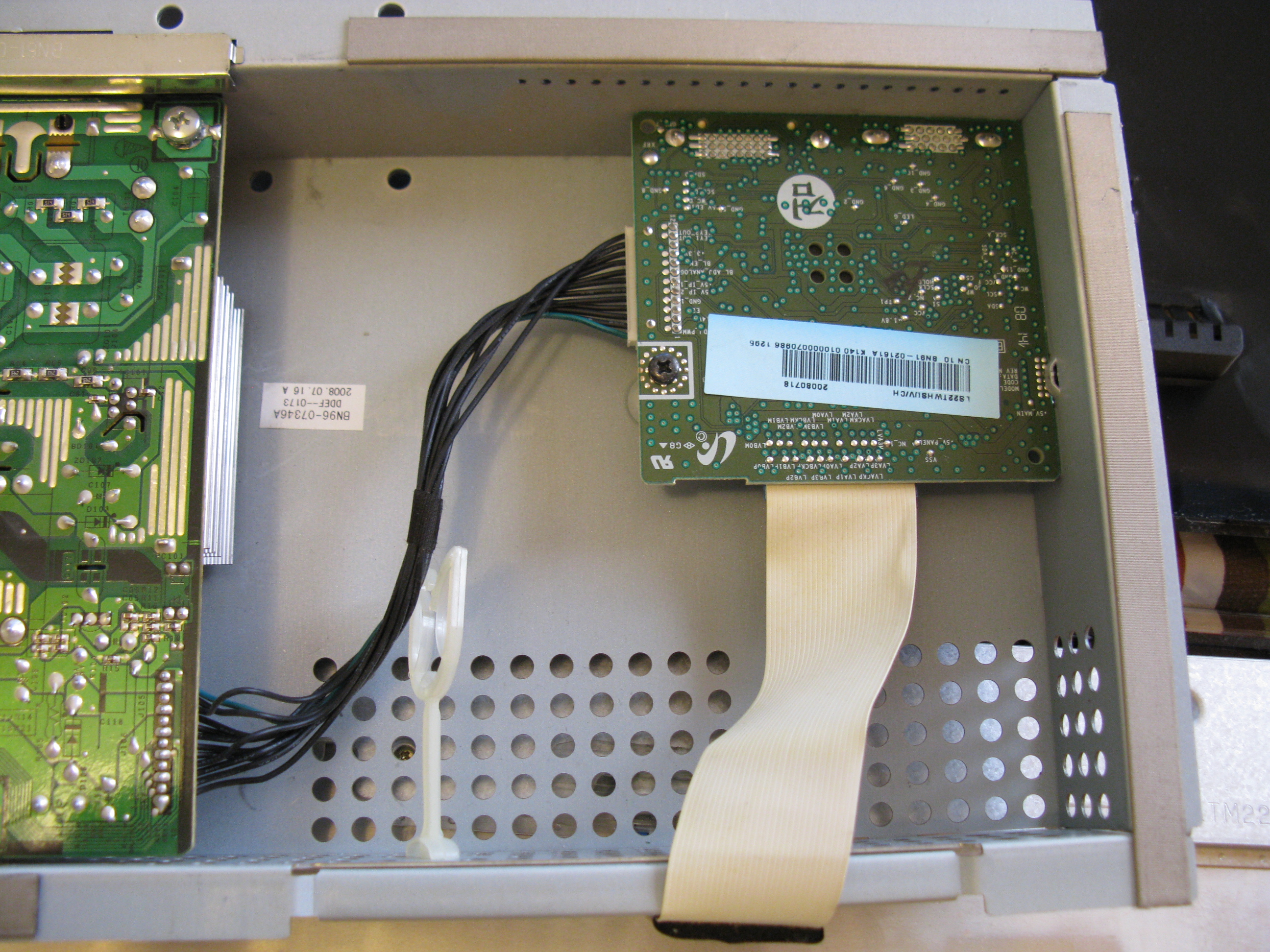

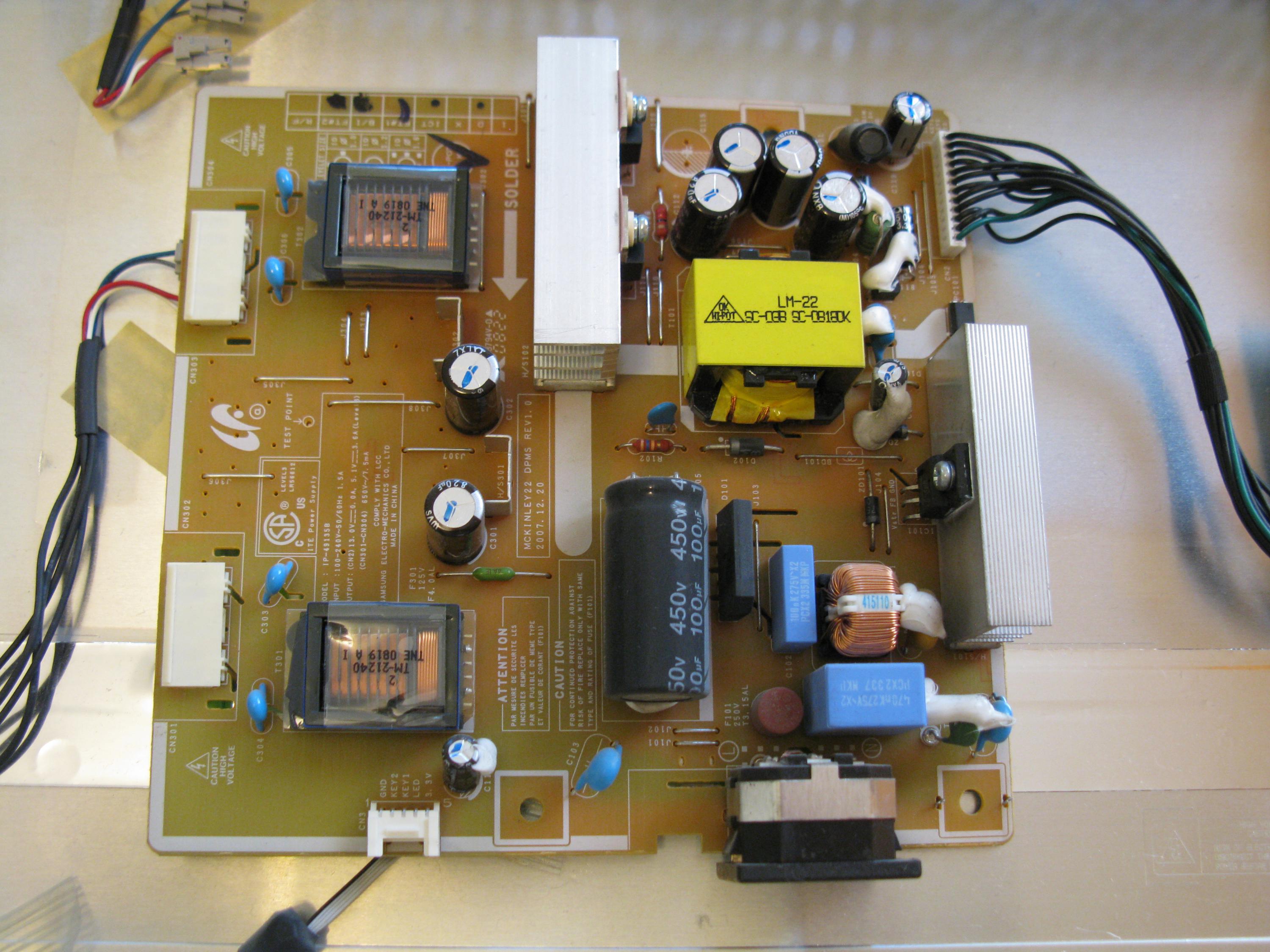

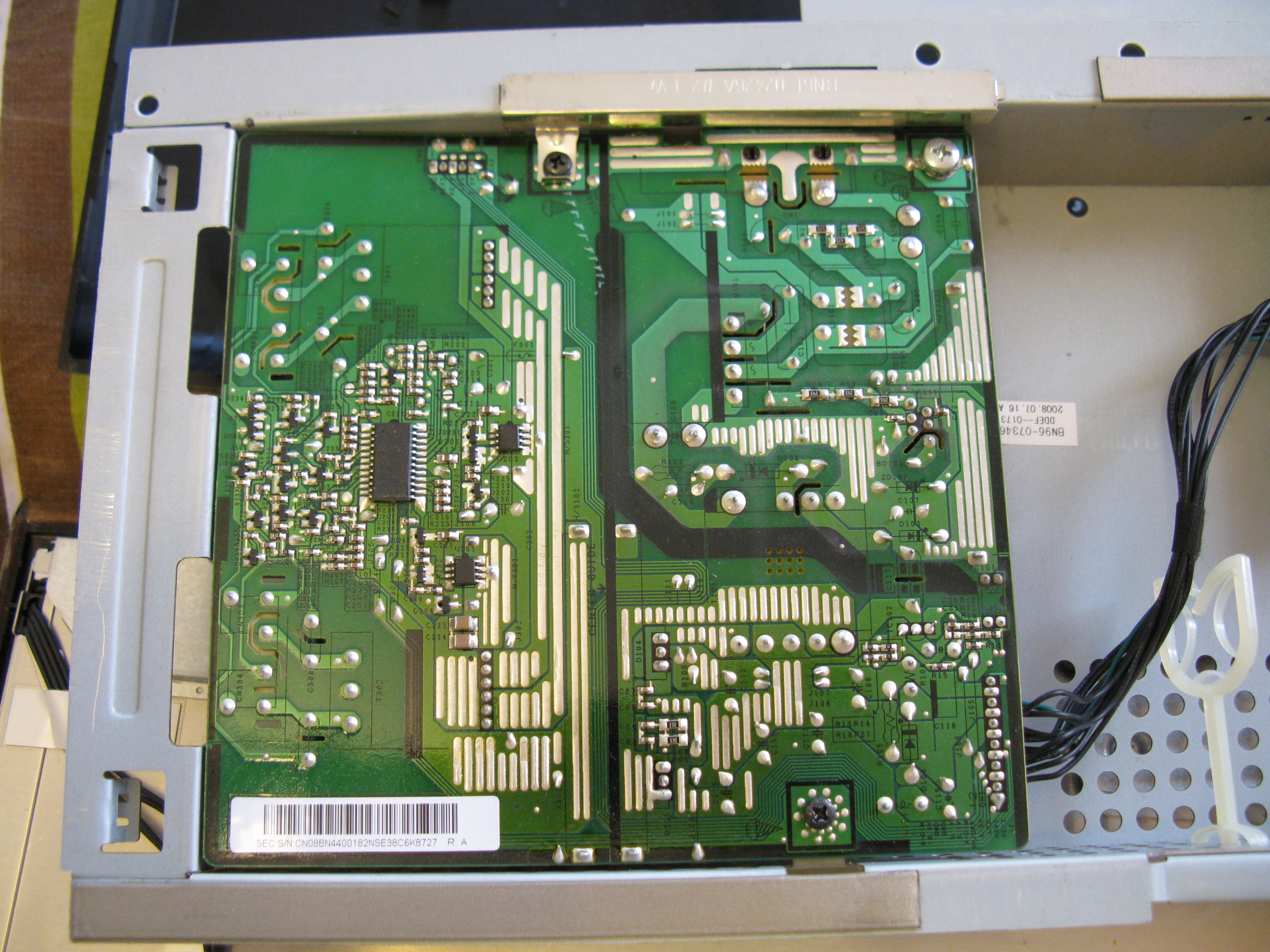

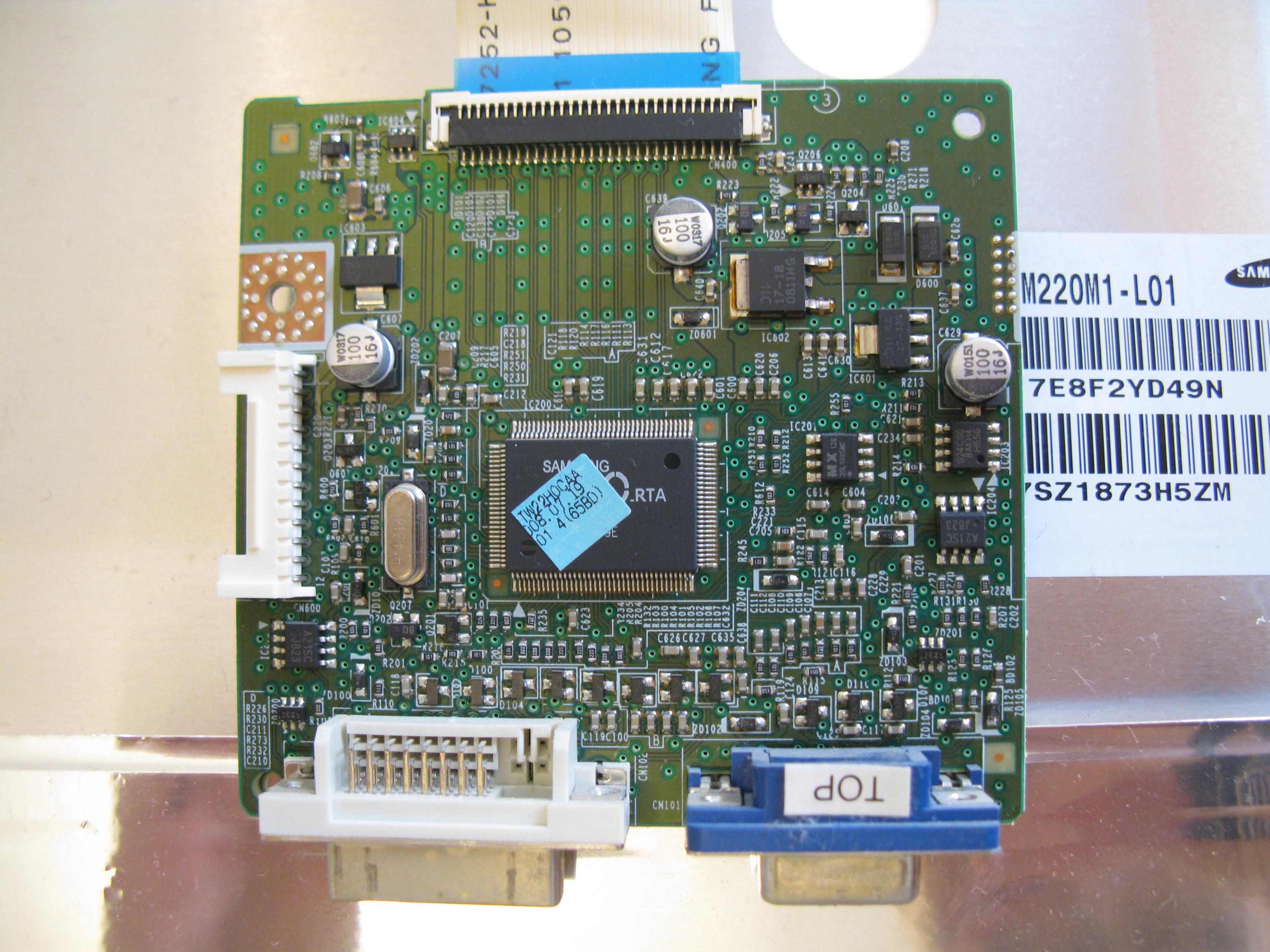

      I've attached selected photos, additional close-ups are available here.
      Can you elaborate on how I check the basic components?

        You Need a meter ??? measure the resistance of F101,located immediately behind the AC Mains socket a Red One....then F301 a Green fuse to the left of the big capacitor.The resistance meter should be on the lowest range,and you are looking for approx the same reading as if you just touch the Meter probes together.

          F101 should have near-zero resistance too?
          Edit: of course, it's a fuse... What does the "T3.15AL" written next to it mean?

            Take out the power supply and the display board from the monitor (disconnect the display board from the monitor by that white strip).
            Put both on a few sheets of paper to insulate them from the desk, connect the power supply and display board together by those black wires and also plug the smaller cable into the power supply (cable which goes to the "buttons" on your monitor).
            Carefully plug the cable into the power supply board (don't touch any metal part with your hands now, you have high voltage on that board).
            For safety, take out the cable from the mains socket, plug the cable into the power board, then plug the cable into the mains socket.
            Put the multimeter on voltage DC (if not autoranging set to highest voltage) and put the probes on the large capacitor.
            You should see about 350v on that capacitor. If you don't see any voltage, the fuse is probably bad, or the bridge rectifier before it is gone. If you see less than your mains voltage the bridge rectifier may be partially bad.

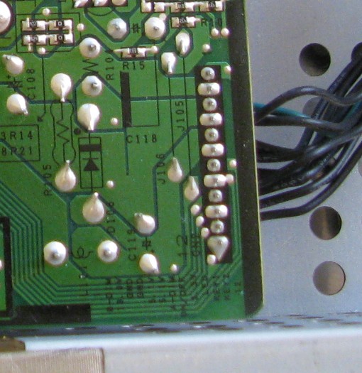

            Flip the power board to get access to the bottom. Now look at the corner where that connector with 12 wires is and you should see a "legend" that says what each of those wires is supposed to be:
            You can see that 12 written which tells you the pin at the top is pin1 and the last one is pin 12. If this wasn't written on the board, you could also tell by looking a bit to the left: you see there a C108 and you have the + side going to pin 2 (or maybe pin 1 and pin 2) and the - (ground) goes to pin 3 and 4. So you see in the legend that the third and fourth wires are ground.
            So you can see there that
            pin 2 is 12v (or some other voltage > 10v, I can't tell from picture),
            pin 3&4 are ground,
            pin 5&6 are 5.1v,
            pin 7 is backlight brightness,
            pin 8 is backlight on/off
            pin 9 is 3.3v
            pin 10 is probably the power on led (there should be 5v or 3.3v on it when monitor runs, probably)
            pin 11 and 12 are the wires through which the display board receives button presses. Depending on design, these should show 3.3v or 5v and go to some voltage between 0 and that normal voltage when pressed.
            You're interested in measuring the voltages, the most important ones are 5.1 v and 3.3v - if one of those is off by more than let's say 5-10%, the display board can't start working and may not even detect you pressing the power button
            Now, put your multimeter on dc voltage again, if not autoranging put it on a lower scale, let's say 100v
            Carefully plug the monitor back in the mains socket and put the black probe on Ground, any one of those pins, 3 or 4.
            Put the red probe on pin 2 , then on pin 5 or 6 then on 9.
            You should have at least 4.95v and at least 3.2v and the other voltage on pin 2 should be within 10%.
            If you don't measure anything, keep the probes on a voltage with one hand, and hit the power on button with other hand. See if that changes.
            Come back when you do these and let us know what you measured.

                                  So I received a replacement display driver board from aliexpress, plugged it in, and now the display works!
                                  Only it flickers - pretty rapidly and tiresome to the eyes.
