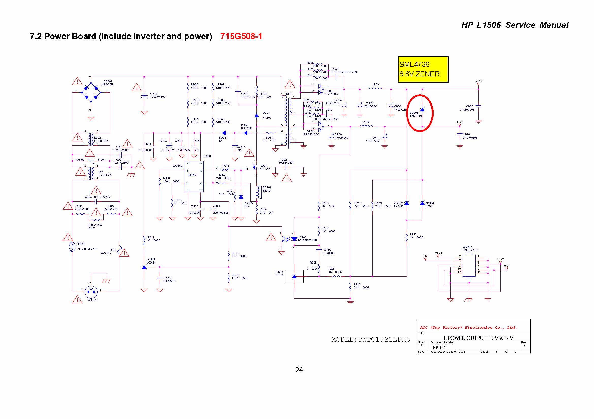

          So my search for specific part numbers was futile. So I tried using the search options for TVS diodes. I'm not at 100% with understanding the specs so correct me if I'm wrong.
          What we care about is:
          -Operating voltage close to 7.5V
          -Breakoff and Clamping voltages close to the ones in the pdf you sent me (under the assumption that the pdf does indeed define a component very similar to mine... which is a pretty good assumption).
          -Max peak pulse surge current needs to be able to withstand at least what the last one could (or at least what the specs show in the pdf you sent me).
          So the SMA6F7.5A TVS diode would work if I'm not mistaken. It has the right operating voltage, it's breakdown and clamping voltages are close to the ones in the spec sheet, it can take a LOT of surge current (more durable right?), it's unidirectional, it's surface mount... I haven't looked at physical dimensions yet. Is there something I'm missing?
          EDIT: I looked into the spec sheet of the link above and now I'm thinking that the SMA6F6.5A would be better because its standoff voltage and breakdown voltages align themselves with your pdf better. This PDF as my source.

              I would not use lower voltage, the diode is connected between 12v and the 5V so the difference is about 7V which you measured, I looked through a bunch of HP service manual and see they use that typical setup with the TPSMP (post34) and some just use Zener diode. The key point is that the diode should not go into conduction unless the voltage goes up way up above the voltage the circuit can handle, it is a secondary protection in case the power supply failed big time, power supply already has control feedback to maintain out put voltage and over current draw protection.
              I would try to match the clamping voltage of what I think the TPSMP7.5 is. or you can try 8.5V or 9V 2Watt (or higher) Zener through hole device since you do have the room to install. If you go lower voltage, the diode will conduct all the time which we do not want, it should only conduct if there is big problem.

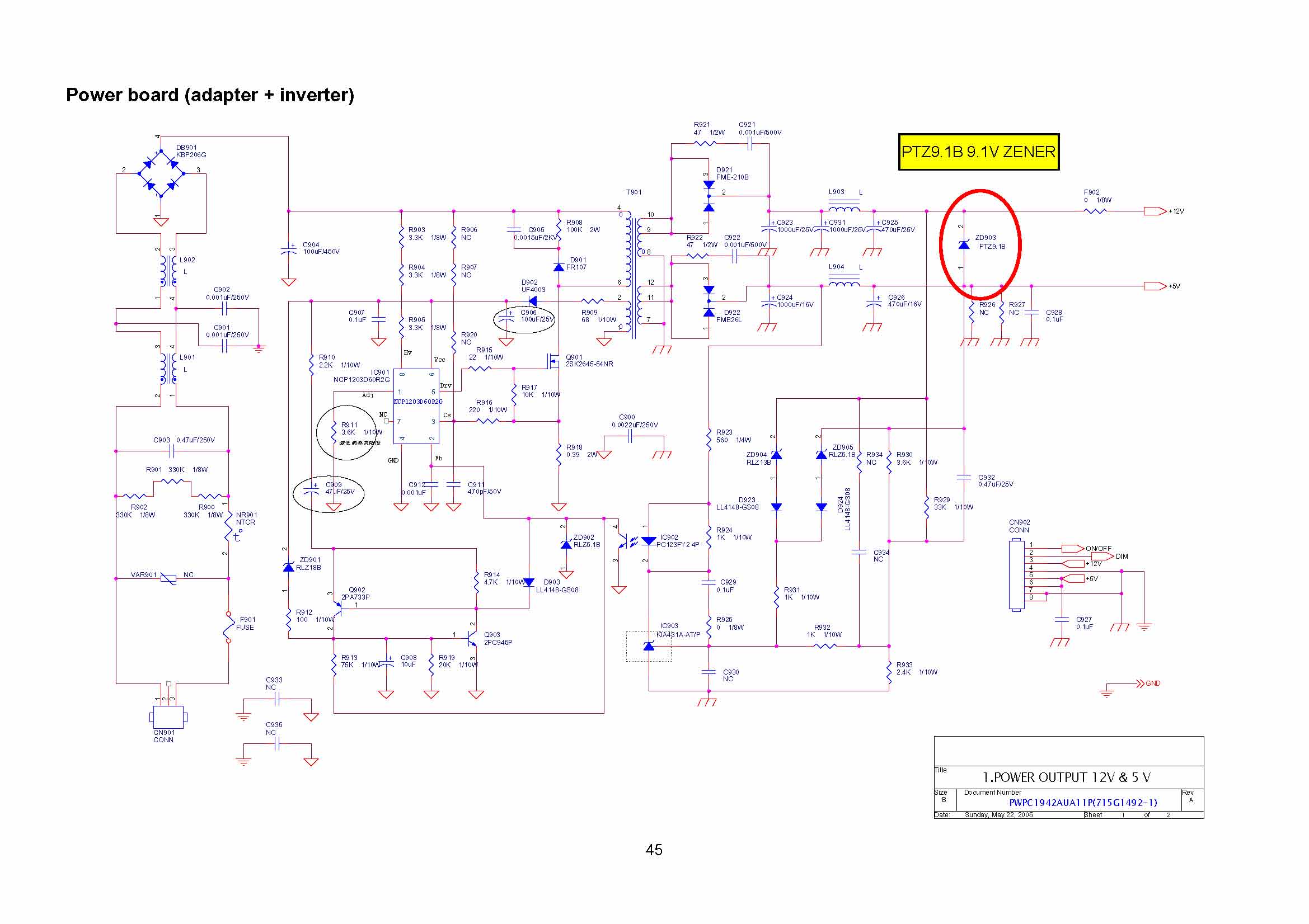

                    Higher Wattage can handle more current but with bigger body, the use in this case is for it to conduct only if there is problem such as the 12V goes way too high, on normal operation this diode should never turn on. The inverter circuit itself can easily operate at 18~20V (see the spec of the PWM IC of the inverter circuit), so there is lots of head room. If you look at other monitor circuit design, most do not even has this diode in place and the monitor still works fine.
                    This SCH of this HP 15" uses 6.8V ZENER (SML4736) instead of TVS, power supply has 12V and 5V. You can also see that ACER uses 9.1V so as you can see it is around 7~9V range.
                    The lower the voltage, the more chance of it being conducting all the time instead of when it is only needed during power supply failing mode.
