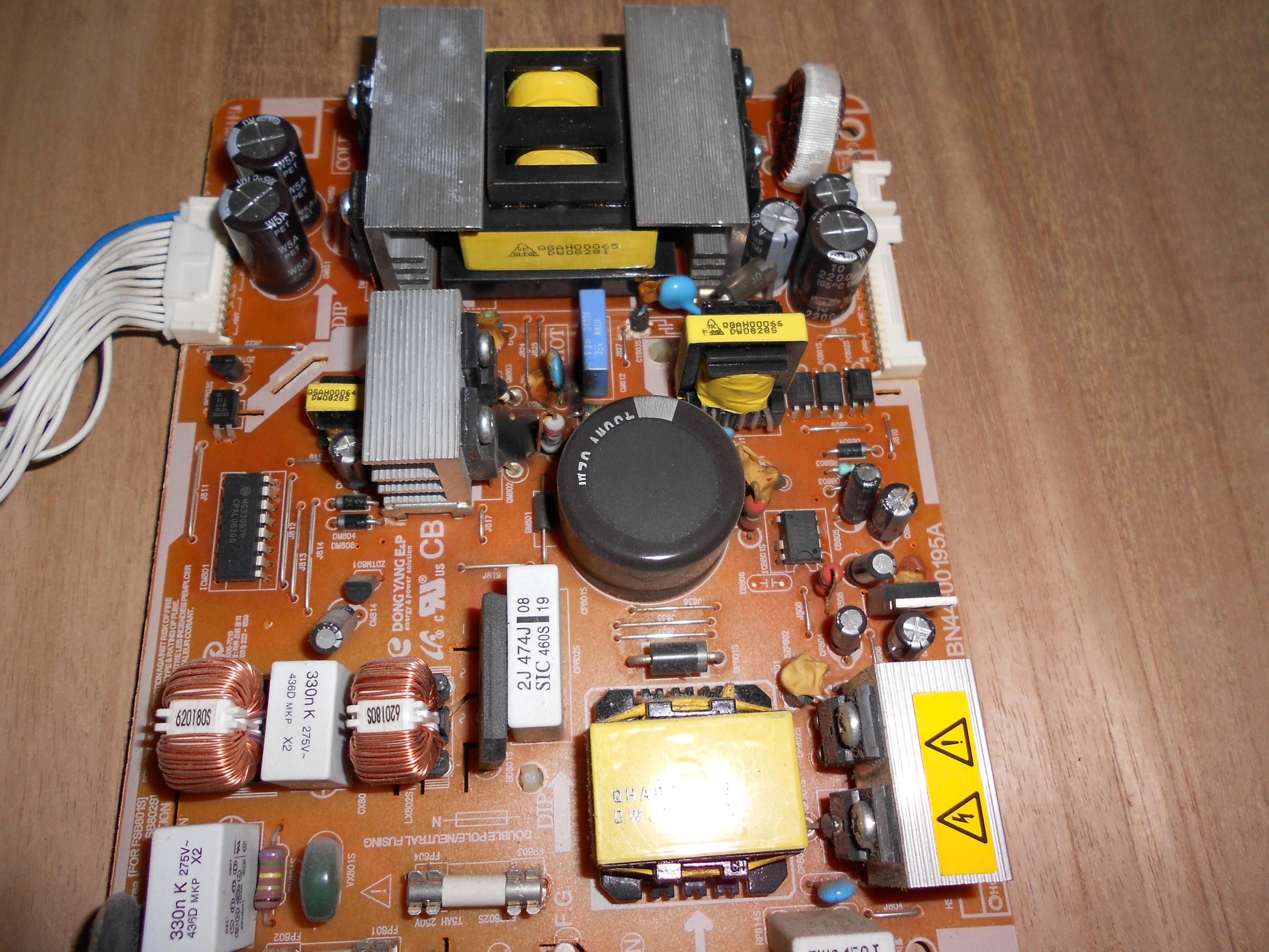

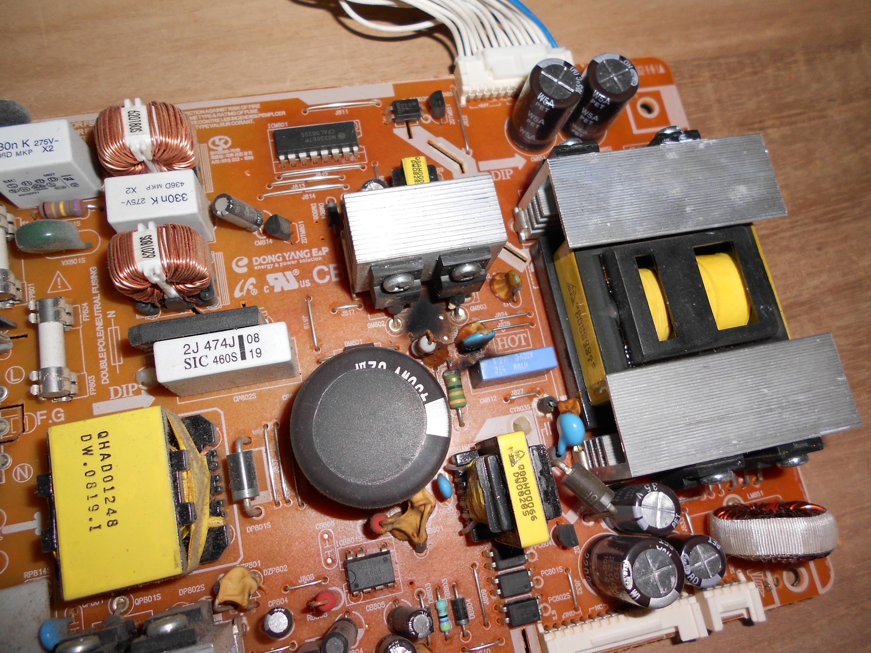

    This morning when I turned my monitor on, it flickered and gave a bang. Also some smoke came out of the monitor. I opened up the monitor to detect the problem but this is as far as my knowledge goes. I enclosed 2 pictures of the power board, where something clearly burned. Is this an easy fix? Thanks!

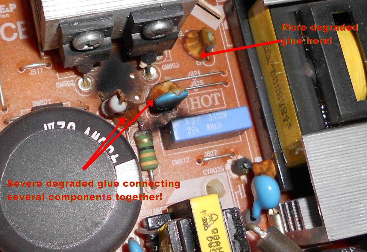

      Degraded glue rears its ugly head again (yes, I'm talking about that brownish goo adhering to those discrete components). From those pictures, very likely that big resistor plus several other components around it (possibly some SMD devices under the board as well) have burned and/or blown up. Its not going to be an easy fix. Some experience and diagnostic knowledge required to trace the "path of destruction" and find failed components.

        What you're going to end up needing to do is remove the components in the affected area, and follow the traces on the board to other components and test those to see if they've been affected. It looks like at the bare minimum, you're going to need a resistor and two transistors.
        There are probably some other components that failed.

              Yups, exactly referring to the "path of destruction". Also if any of the components leading to the PWM controller I.C (e.g. usually diode and resistor controlling the transistor as well as the components at the current sense feedback section) became faulty/spoiled then very likely the PWM controller I.C itself was affected.
              Originally posted by Behemot
              I am dealing with the same problem. Blasted MOX resistor and both primary transistors. I think in my case the problem is somewhere between resonant transformer and main transformer as driving IC is giving saw-teeth signal.
              Not to forget that degraded glue (which likely became conductive thus messing up the circuit leading to the failures). See attached image...
