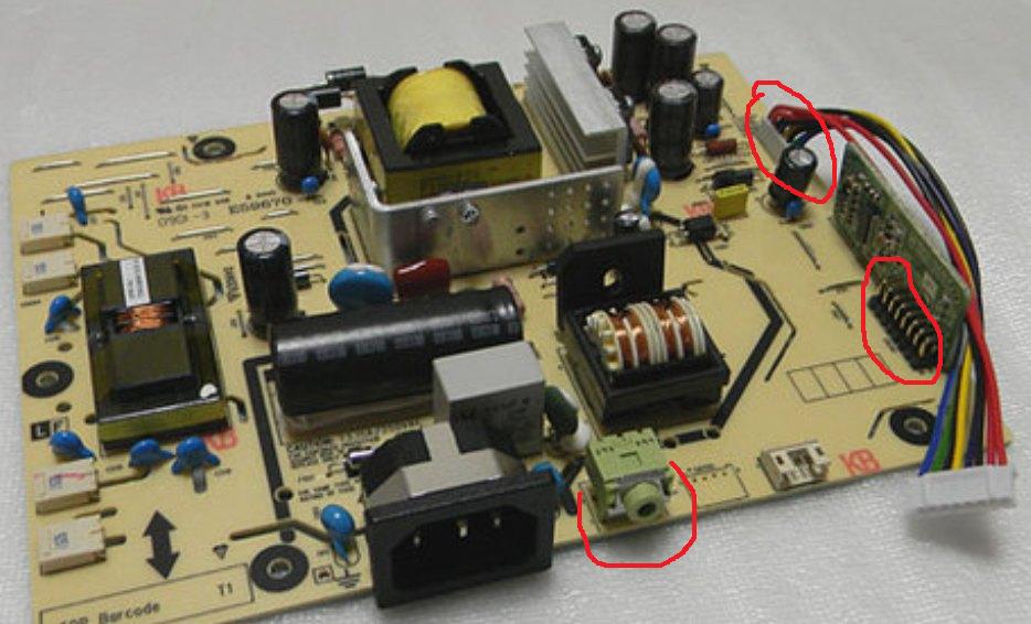

    Had one of these come in today with no sound .
    Having already replaced all the caps and transformer on the psu previously for a 2 second to black repair i turned my attention to the sound board.
    Finding no shorts i checked the solder joints and found none cracked .
    Reflowed all the solder joints (see pic ringed in red) and sound is working again.
    Just some info on the site in case anyone else encounters this
