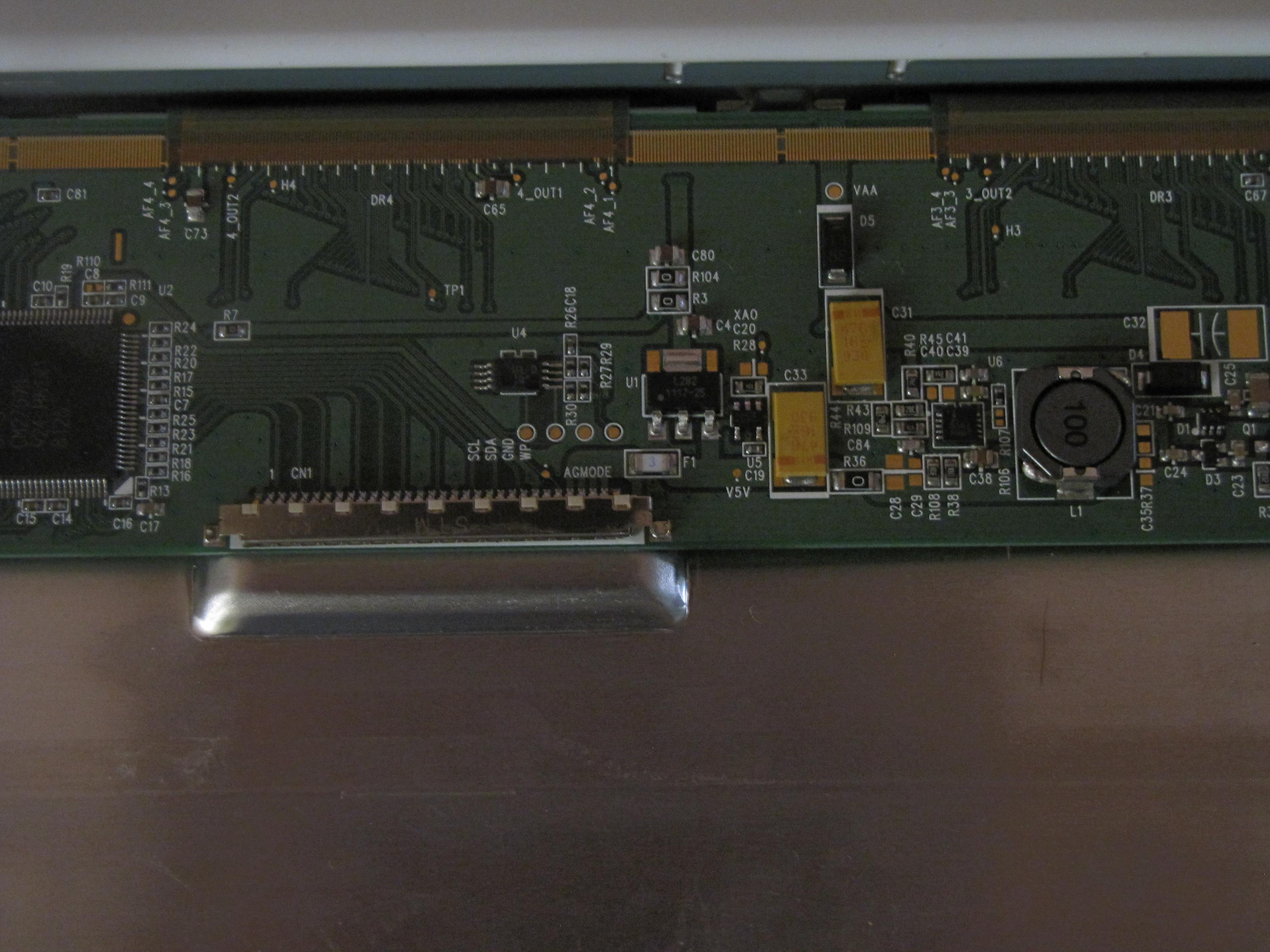

    The controller board on the back of the CHIMEI lcd panel has a surface mounted component with an id of F1. I am assuming this is a fuse of some type but the component only has the number 3 written on it so i thought it might be a capacitor of some description. The 5v input voltage from the main pcb goes in to a plug then is sent through F1 and another circuit to get it 3.3v as this is the standard lvds voltages for panels. So the faulty panel may just be a blown fuse.
    I have read up on lvds loads and found the lcd panel circuit board has an lvds receiver and this is powered by the voltge from the circuit the mysterious F1 us from.
    Could a blown fuse be the issue or would it be unlikely the component is a fuse?

    F1 is almost certainly a fuse and "3" means 3A or 3.15A probably.

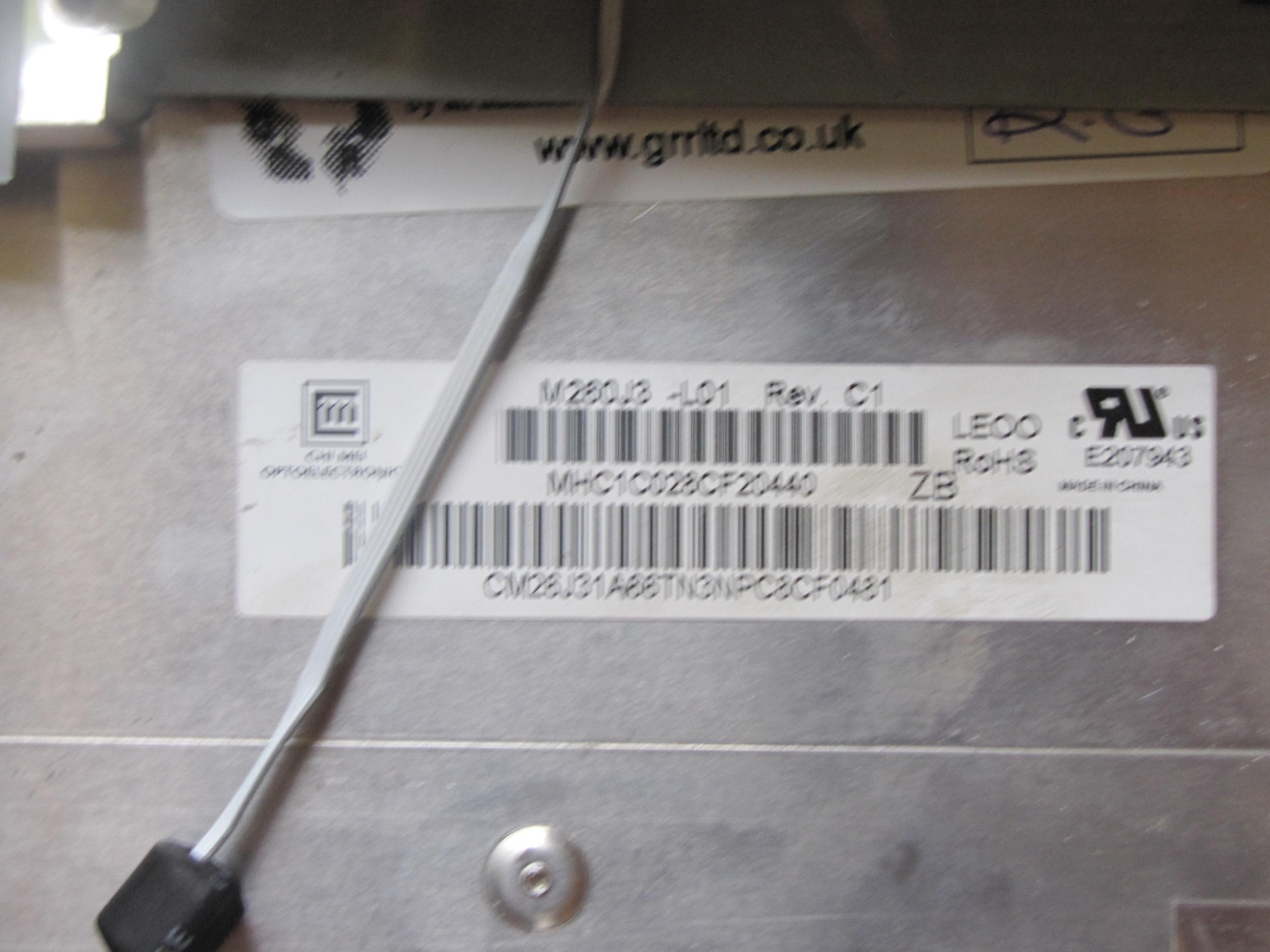

        Did you get a panel with EXACTLY the same model and reference number as the old one.

          Yes i tried the test of F1 its open circuit.

          The replacement panel is EXACTLY the same except the broken one is rev 2 and the replacement is rev 1.

            Yes it is a fuse - if it is open circuit , that is , reads the same as holding your probes apart then yes it needs a new fuse.
            Only problem might be we dont know what caused it to blow so it may blow again so buy 2.
              Re: Samsung T260 no display
              Test from the right end of the fuse to the casing of the screen on ohms, should read infinite. Note several tantalum caps - yellow/orange things - these can fail short but they usually burn themselves when that happens.

                  how do i figure out which one to replace it as the 3 marking doesnt help me much, all the markings i can find relate to letters not numbers?

                    Just get a 3amp smd fuse could be 24 or 32 volts doesnt really matter but
                    needs to be same physical size.
                      Or use a 3-5A automotive fuse as a temporary fix.

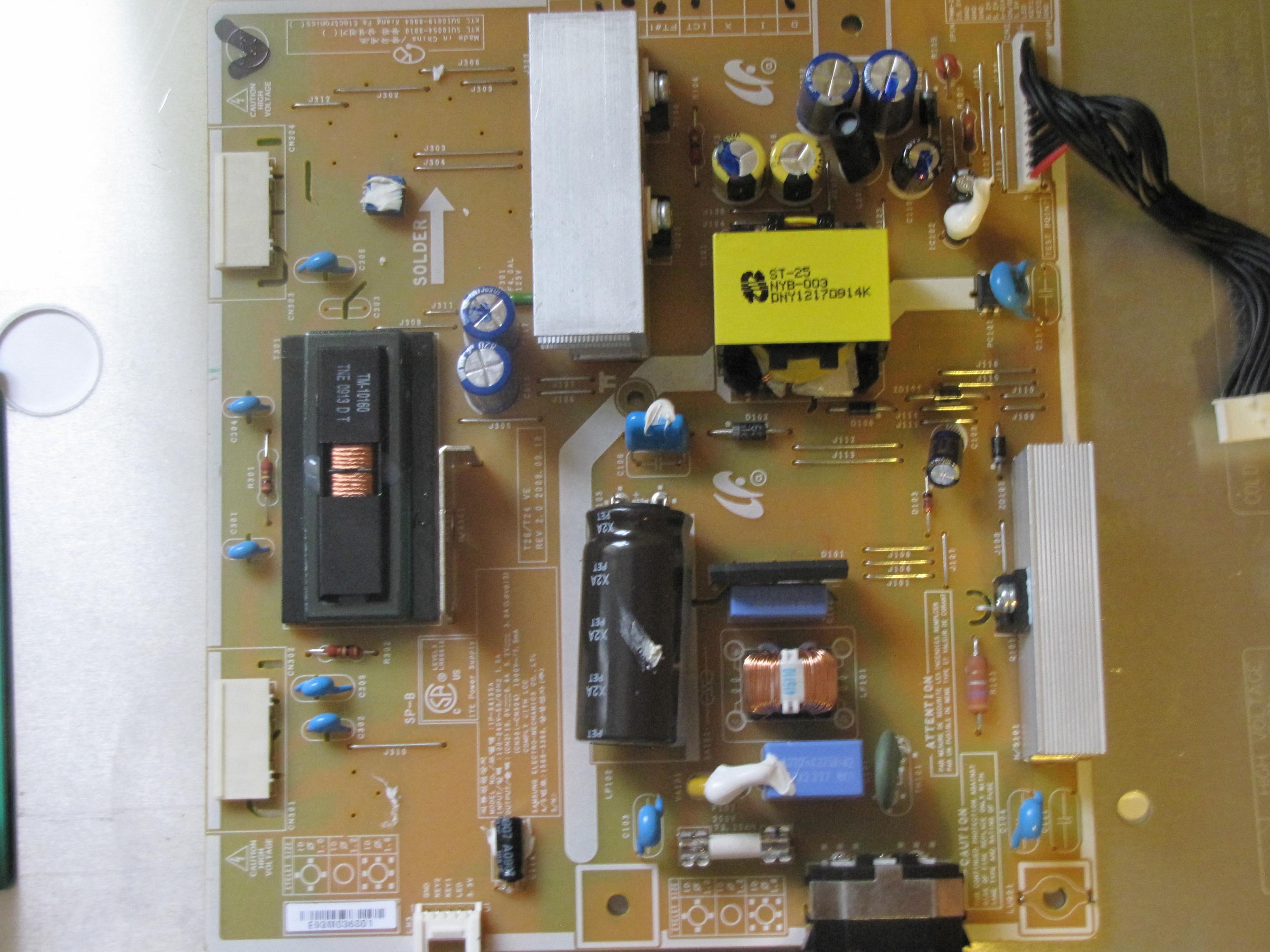

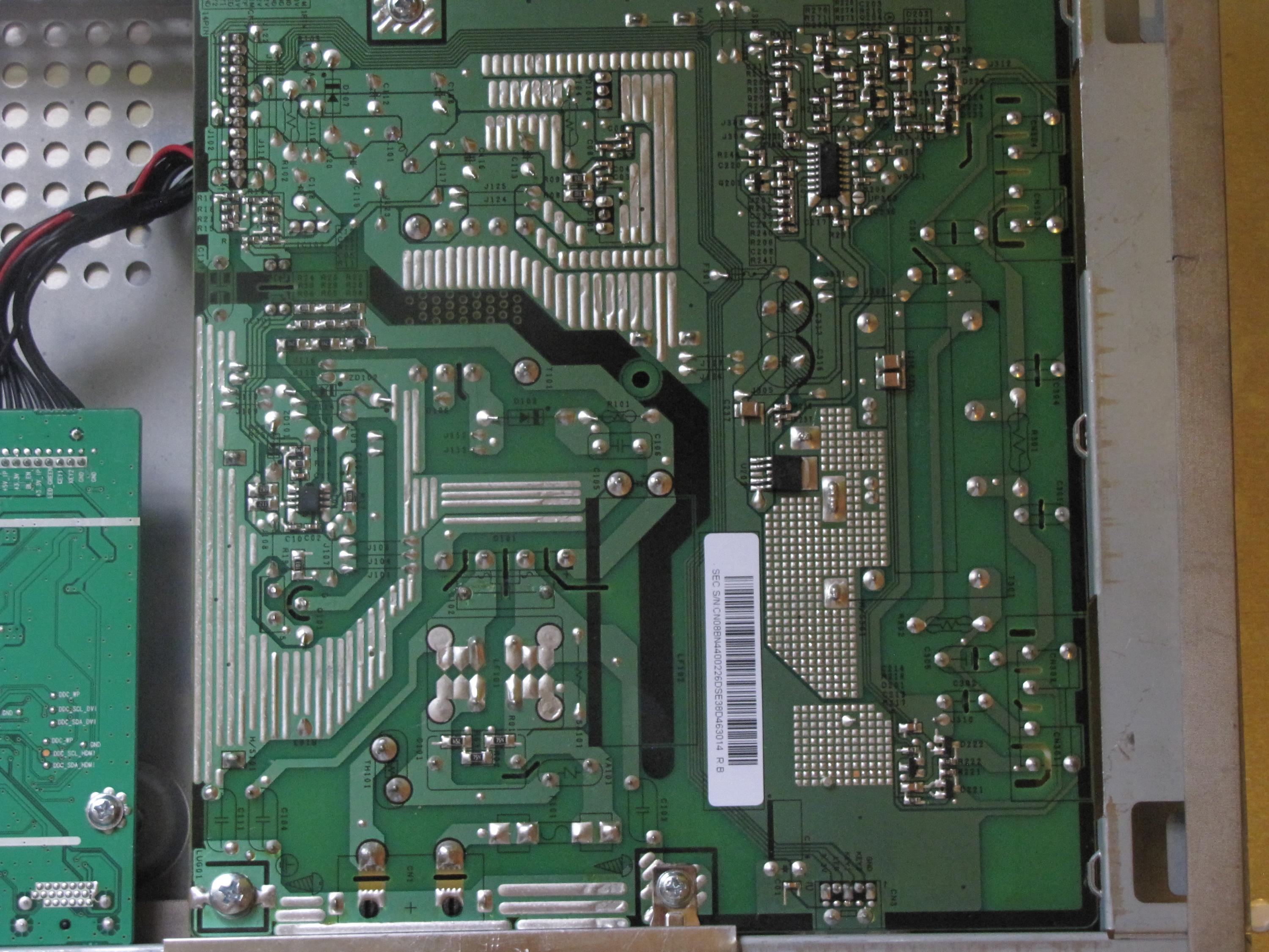

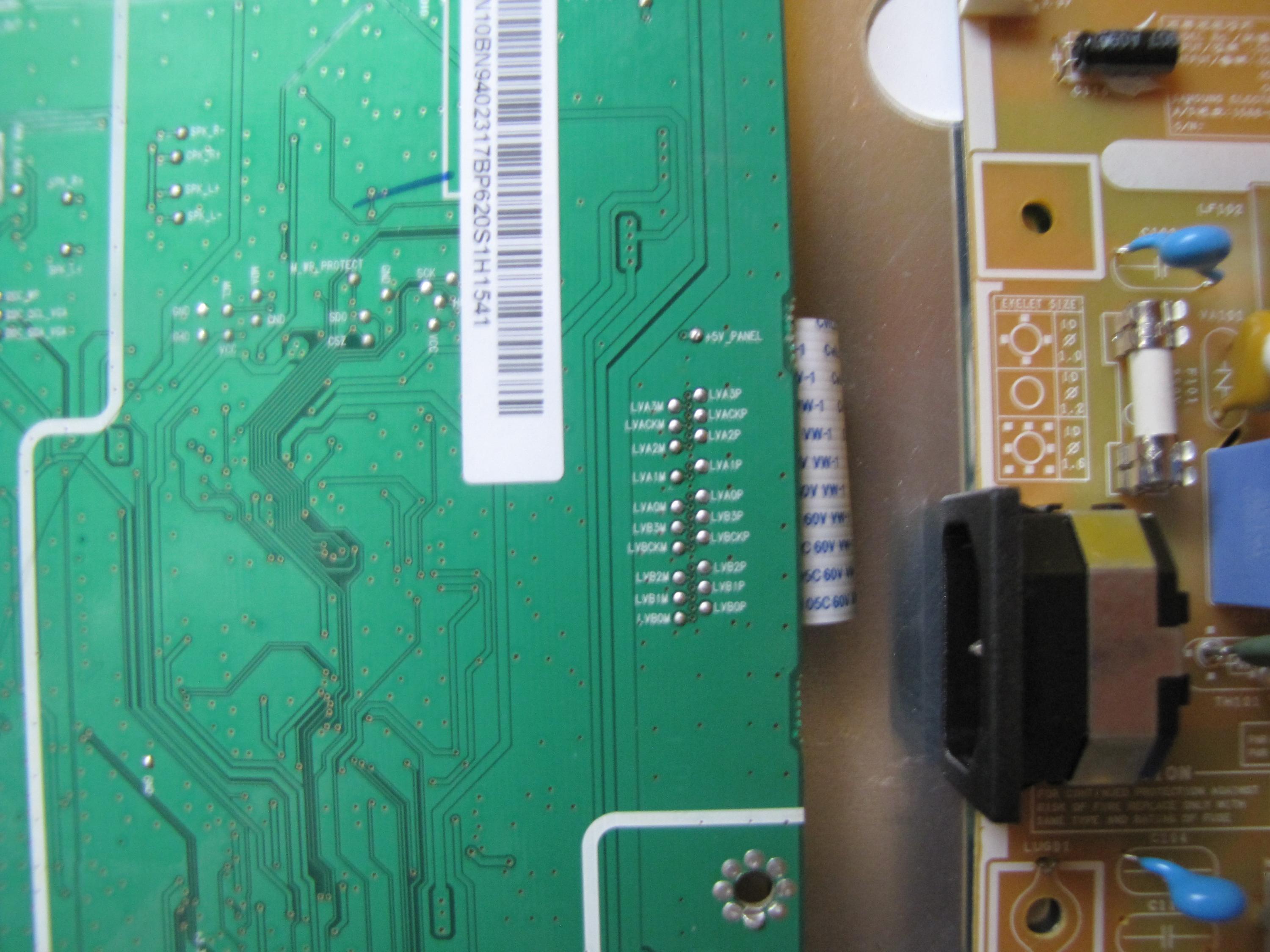

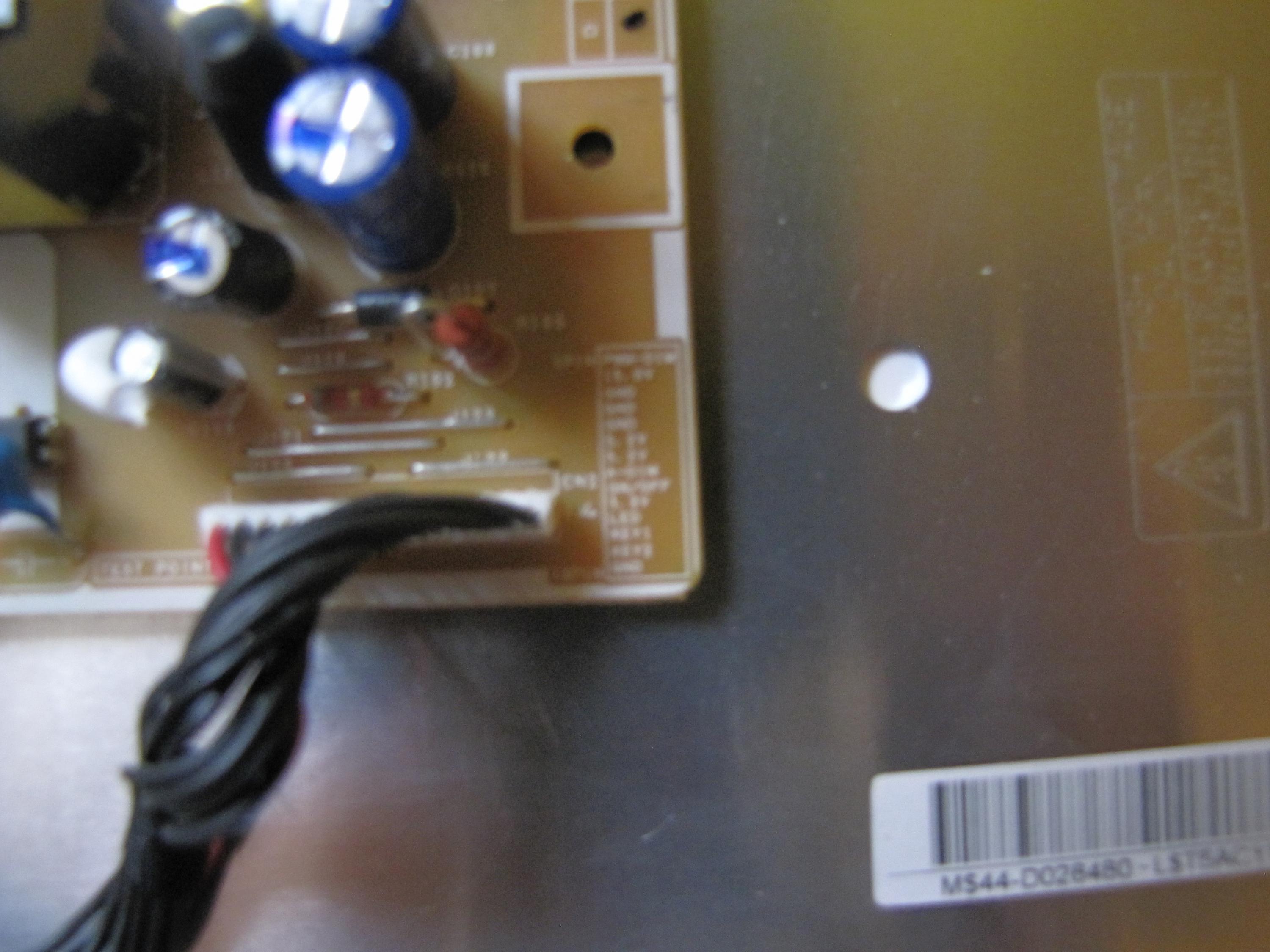

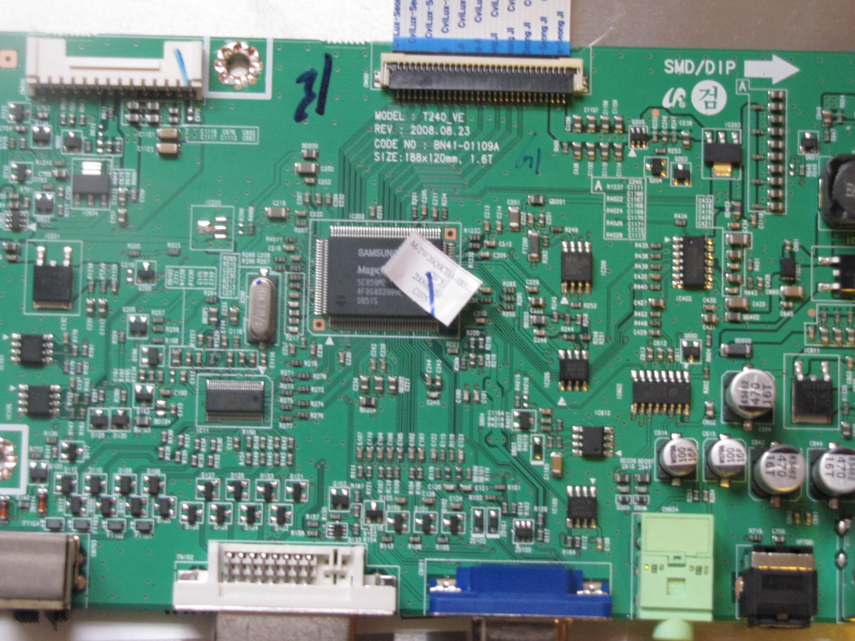

                          here are some pics so we know whats what
                          bazz

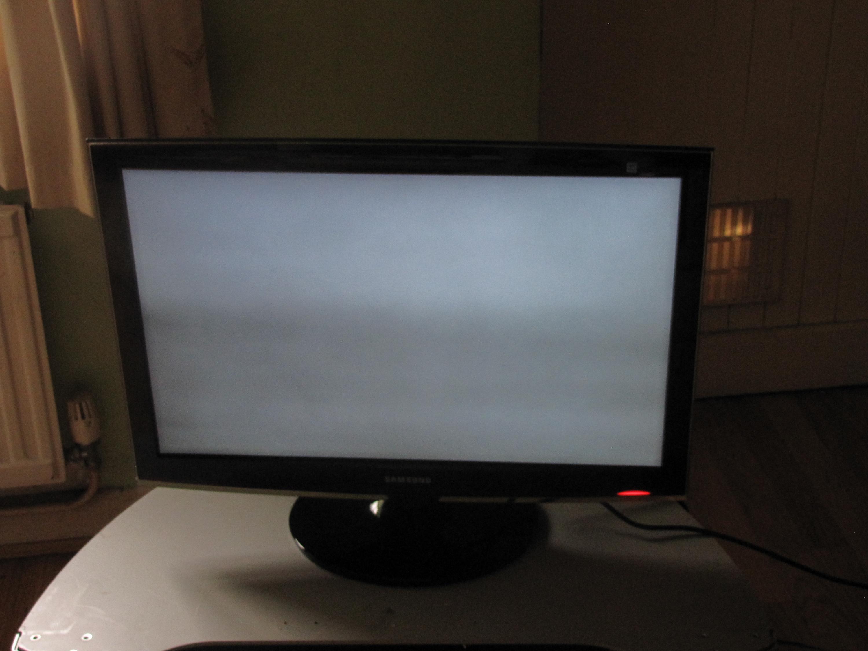

                            Pic 1 does the monitor stay like that for 5 minutes with just the back light on?
                            can you get the osd menu on
                            Do any of the controls work including on/off.
                            Not sure I understand your opening bit about the pc. Do you have the pc on and connected to a working screen then simply unplug the vga cable and plug it iinto this?
                            If using vga have you tried hdmi or Dvi input
                            • bazzuk
                              • Jun 2012
                              • 10
                              • uk
                              Hi Selldoor
                              Yes the moitor stays on like the pic all the time, none of the menu keys make any picture come up and yes i unplugged from a working monitor using the analogue and DVI connectors. The only control on the monitor which works is the on off button.
                              Bazz

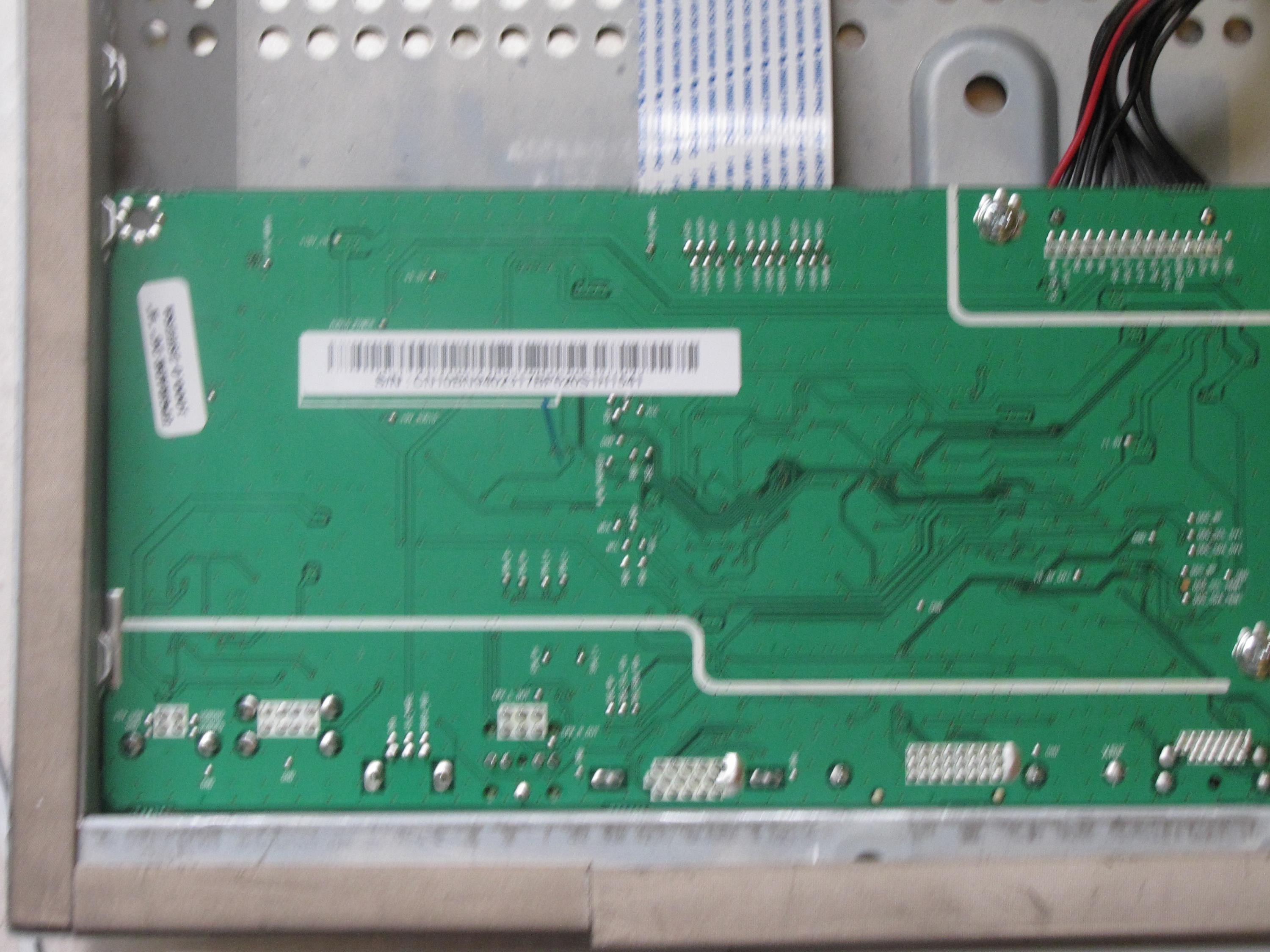

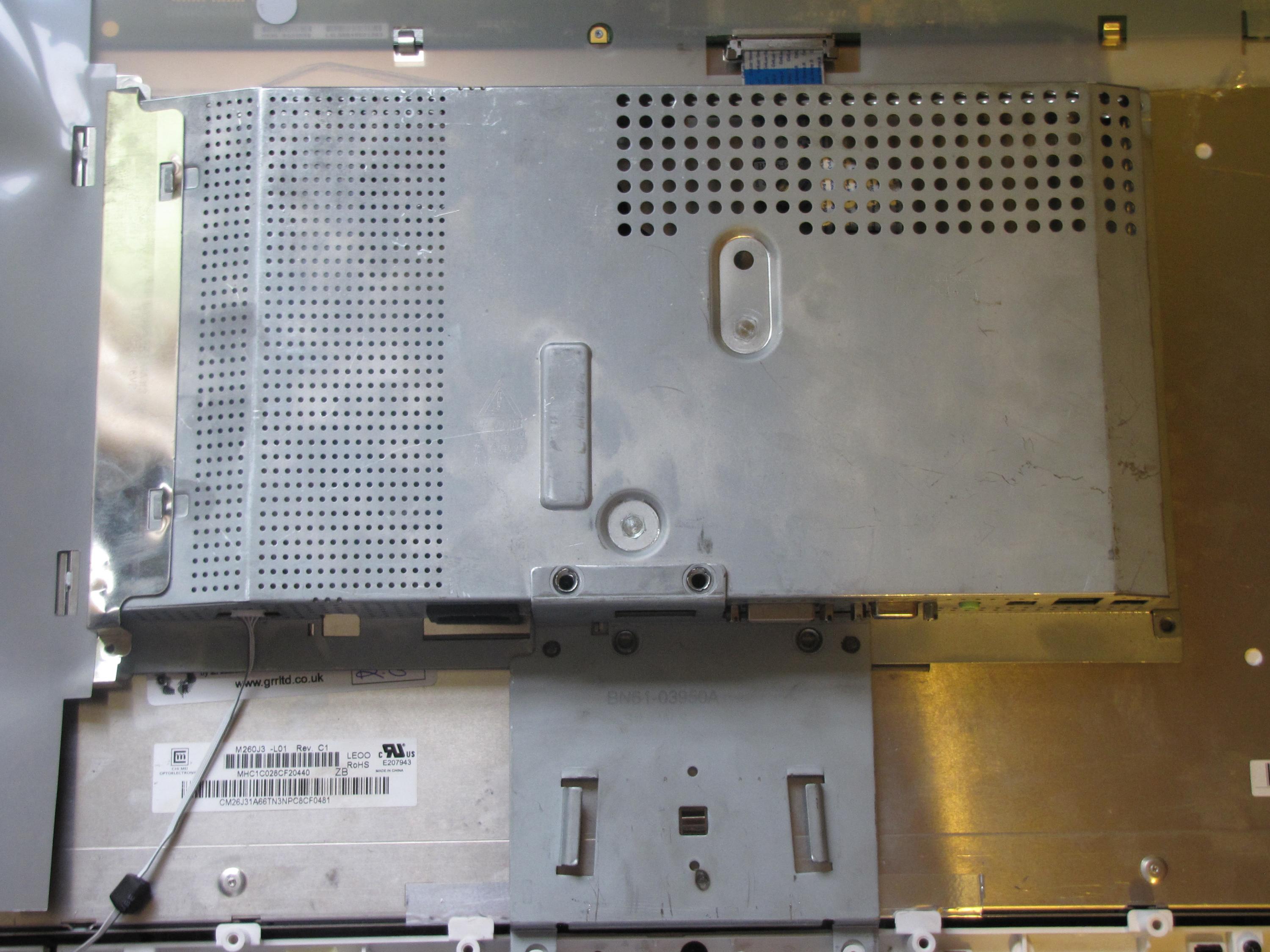

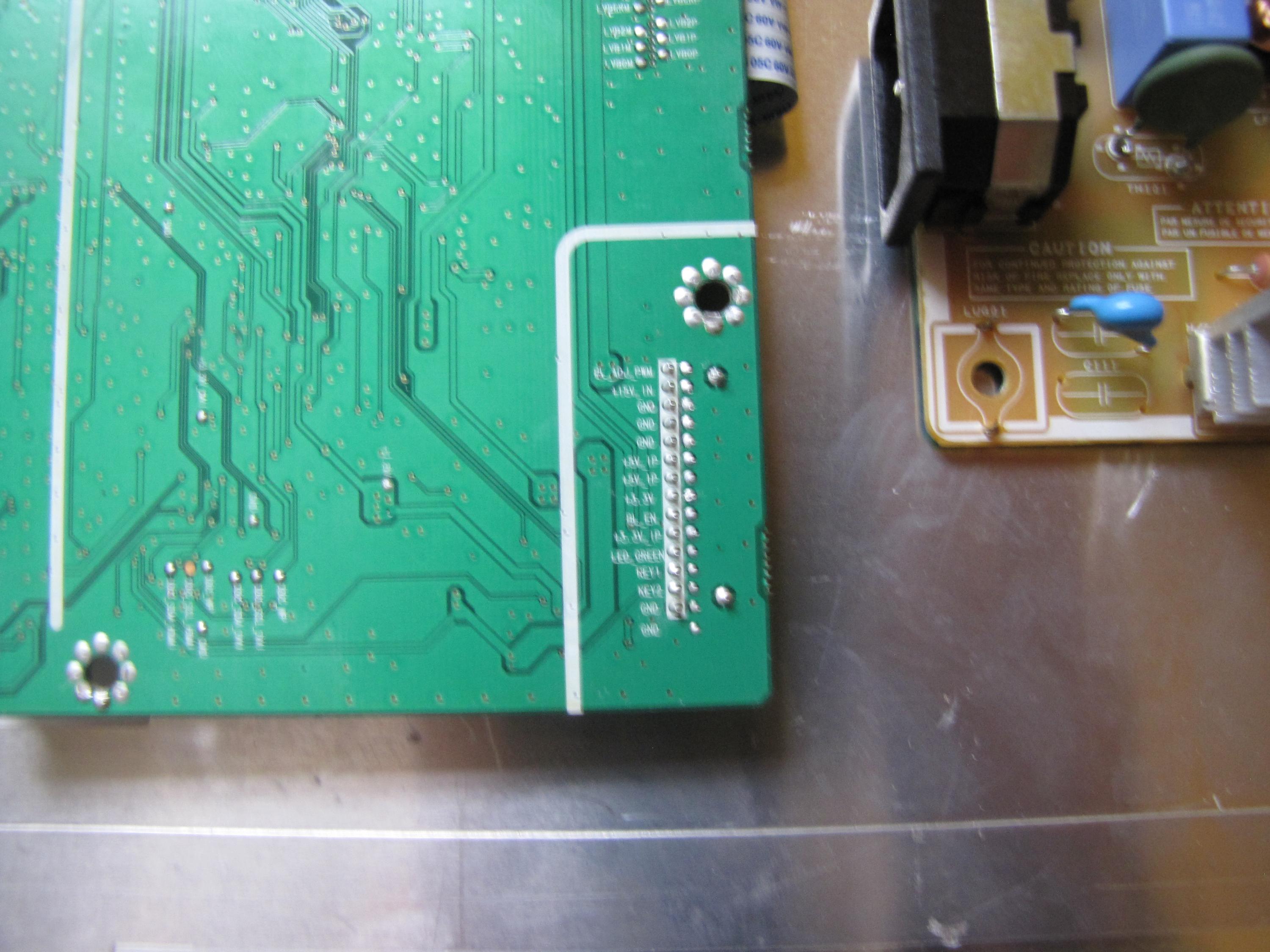

                                When you say you still have the SAME problem Did the old panel light up as this one does.
                                Most of the pics are too blurred for troubleshooting and important bits at the edges are cut off.
                                Next step would have been to ask what voltages you were getting on the various connectors but cant make out what they say and one is cut off at the top.
                                To follow the SM you would need special test equipment and an o-scope, but much testing can be done without, providing we can see what we need you to test.
                                    Possibly but I cant see the pic clearly - if you want to troubleshoot it post good clear pictures.
                                      Another update the monitor is recognised by my computer but still no picture, i still think the main control board has had it.
                                      will try something else and post better pics but that aint easy with my camera
