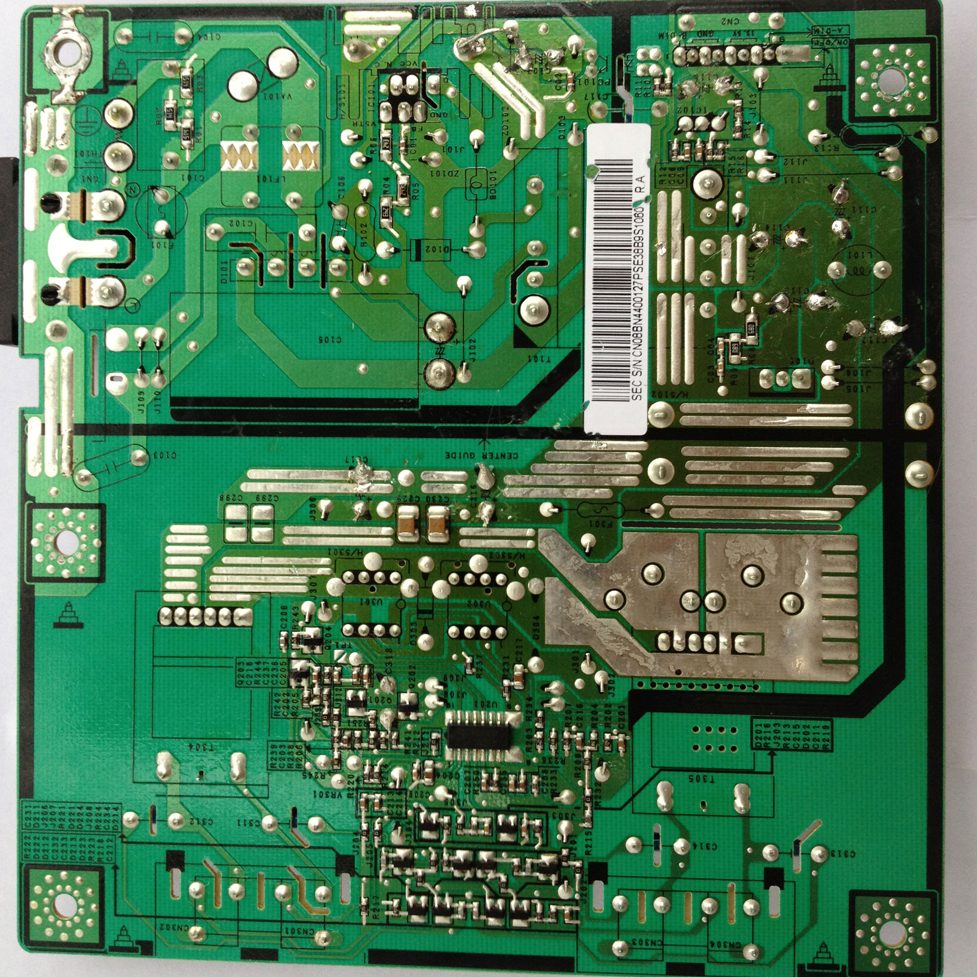

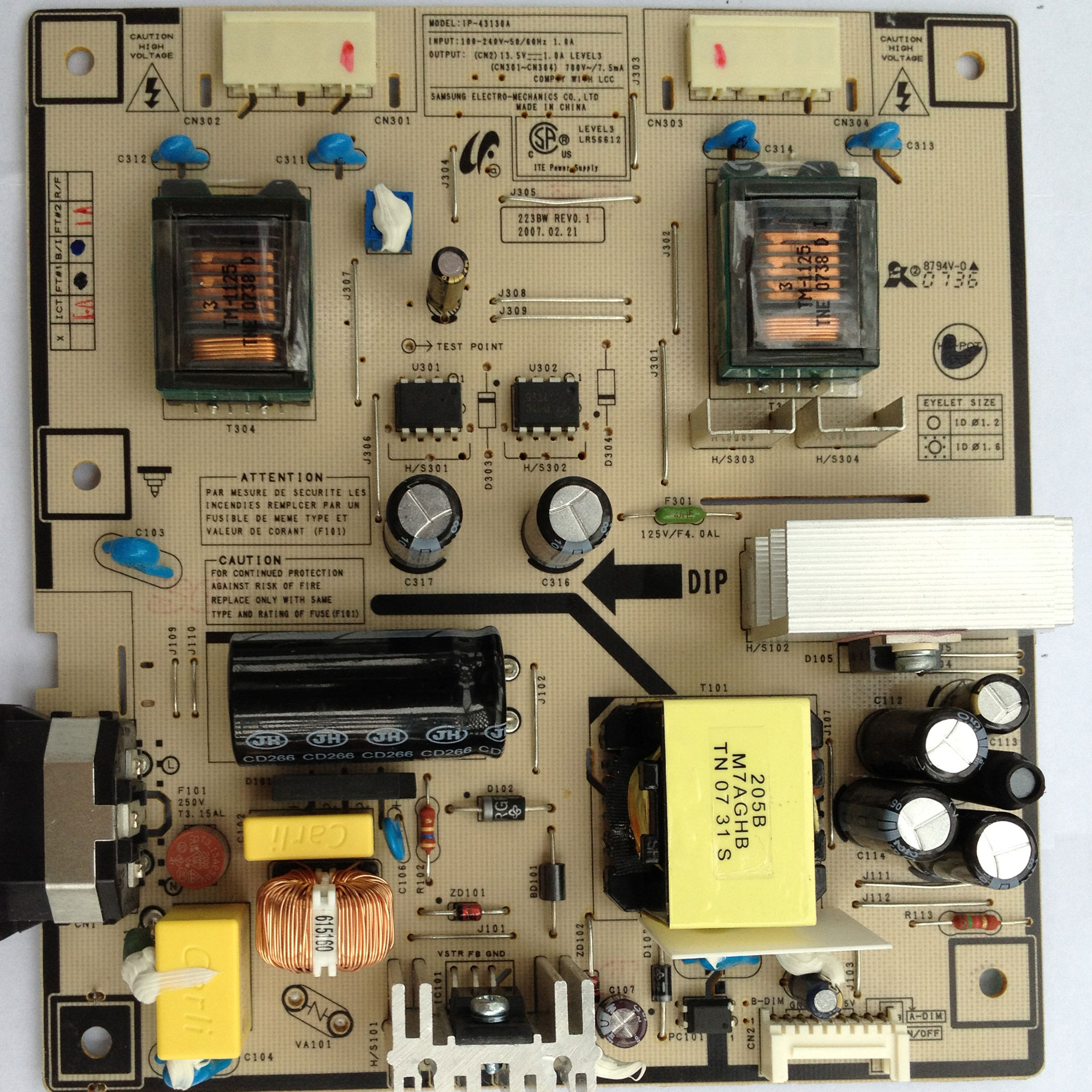

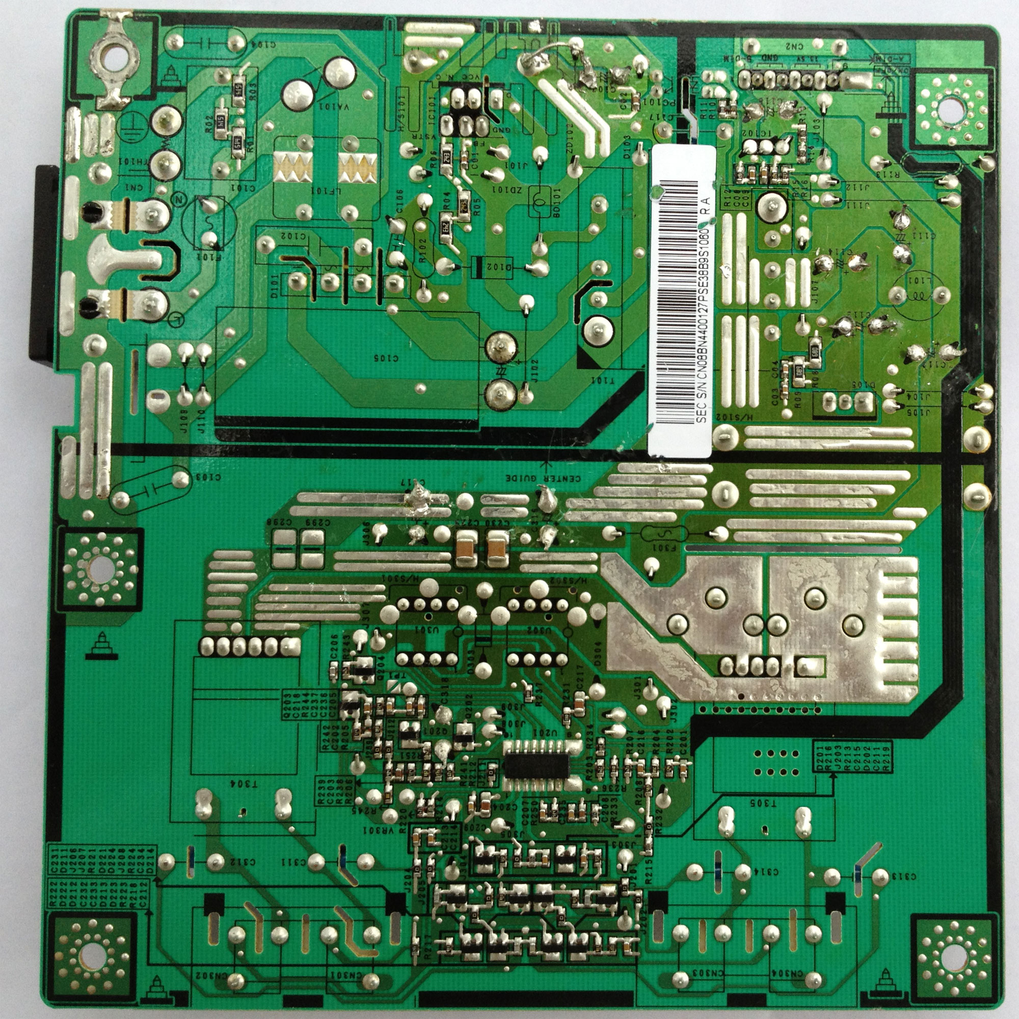

    Hi everybody, reposting this because I'm stupid and didn't pay attention. Apologies.
    Last year my Samsung 216BW died on me. The typical, it seems. It would turn off after a few seconds, over and over. Eventually after a few minutes of 'warming it up' it would stay on. I can't recall 100% how long it was good for or exactly how often I had to do this. Eventually it didnt turn on at all. I took a bunch of pictures back in the day, but they are not the best quality or angle or anything. I didnt know exactly what I was doing and didnt look into getting help on the net back then.
    Here is a link to a photo album that contains the pictures. I didnt resize them because I didnt want them to be utterly useless; you might need the larger sizes just to be able to glean anything useful from them.
    I have since purchased a repair kit from http://lcdalternatives.com/Samsung-2...aspx?sid=19447, and gone to work trying to repair the capacitors.

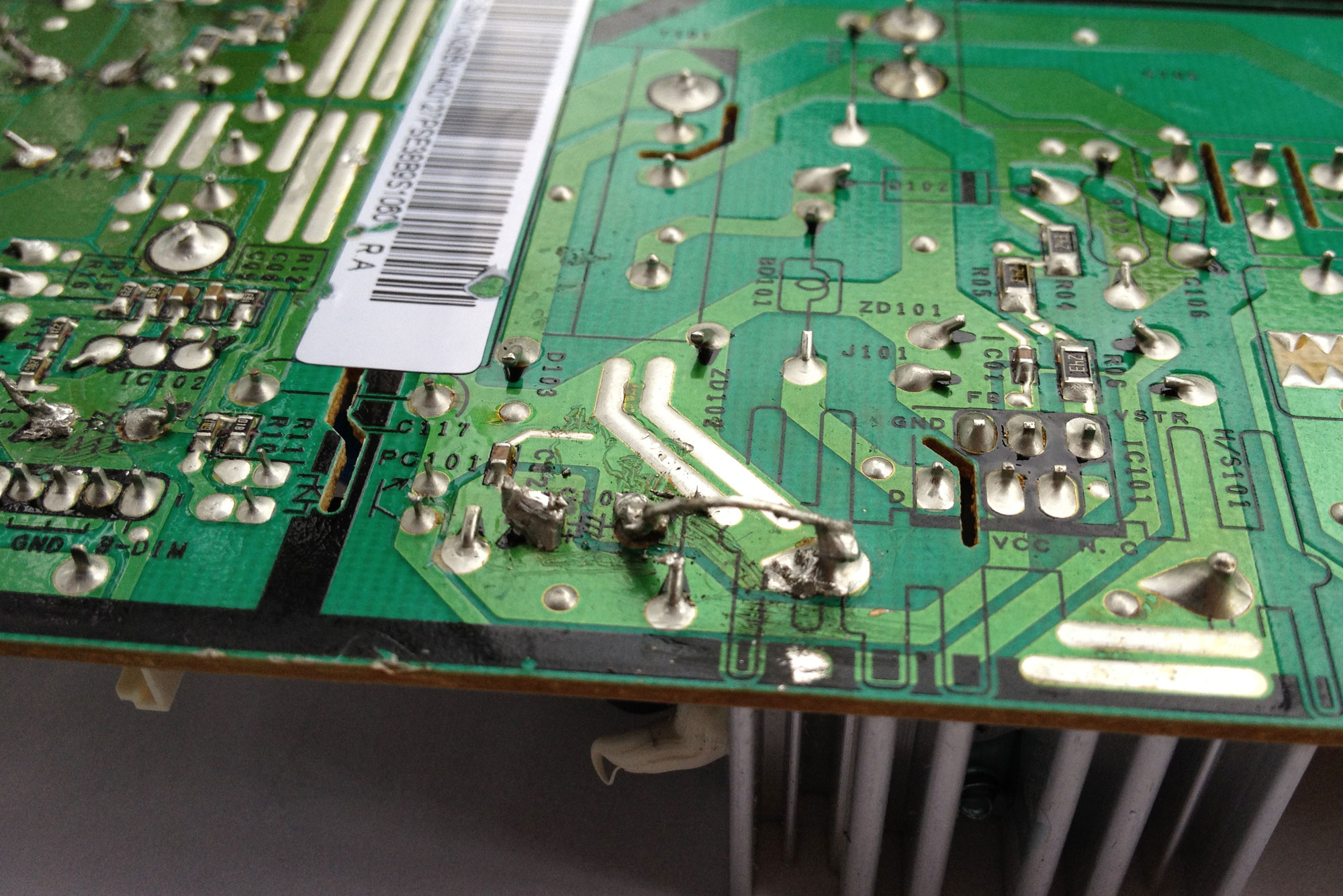

    I at first replaced only the 3 originally puffy capacitors, but when that didnt work I replaced all of them. In the process I messed up. The last (duuuh) capacitor I had to remove came off with the little connection ring that connects it to the PCB... I did a little googling and found out that this can be rectified by attaching the lead to to next component in line. Here is where I found that advice, although I believe I also saw it elsewhere online as well.
    I think I did an ok job on most of the capacitors, but at the end after I messed up the connection, I ran out of wick and was having real trouble getting my iron to consistently melt the solder properly... I kind of gave up on the last one, at least until I get some more patience and maybe some more desolder wick. I swear there is no wiggle to the 'bridge' or the shitty connections around it that you'll see in the last picture, and i tried to coax the solder into the hole around the lead as much as possible.
    Basically, the monitor isn't turning on, although at this point I'm not surprised. Am I totally screwed? I don't yet have a voltmeter, or other equipment like that, although at this point I'm willing to go pick one up (for cheap preferrably), as well as anything else I might have to do, like potentially rebuy capacitors.
    Thank you for any help you may have, I hope I've kept this in line with what you like in a first post. Try not to laugh too hard at my soldering, first timer

    Have you checked the two fuses red barrel and green torpedo- yes you will need a meter!

            Fuses, Voltages Regulators, voltages at connectors, voltages at capacitors.
            Testing batteries.

                I have looked around at a few FAQS, tried to follow along a bit with regards to measuring a voltage regulator... and I'm pretty lost. Is there anything more comprehensive you can tell me about what I'm supposed to measure?
                Do I do any of this while the device is plugged in or is it all strictly unplugged? Any chance of a quick guide to what's what on my board? Maybe some colour coded circles on one of my pictures above - voltage at these points, resistance across here, etc?
                I don't want to be a jerk and just have my hand held through the whole process but I'm so lost when it comes to identifying what is what right now and I just want to be able to provide you guys with the necessary info. I will try to adhere as best I can to the reporting format associated with each component, etc.
                Edit - I will be attempting to learn more tonight about the whole process by trawling the forums here, but for the next 7 hours I'll be at work. I figured it was worth making a post now and seeing what I'm told when I get home. Thanks for understanding.
