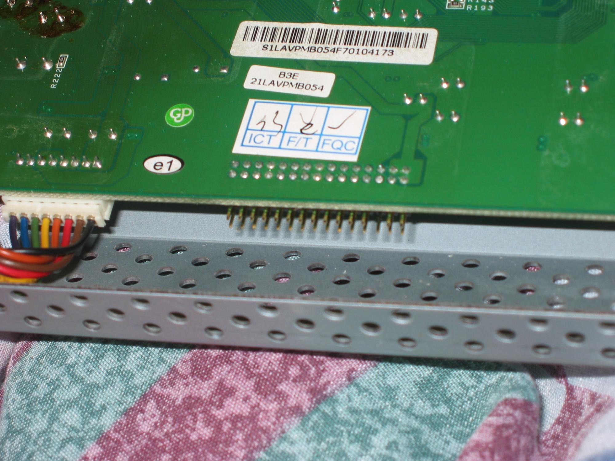

    Okay, but I've got my monitor completely disassembled, with power board and main board completely out and separated. Can I do this test on the pins with the power board alone, but plugged in?
    Yes, if you locate the GND wire.
    1. Flip board upside down.
    2. Set meter to DC 200 ohms
    3. Place black probe on screw mount for power board (should be conductive surface on it, maybe small so could be tricky.)
    4. Check each pin on rainbow connector, until you get nearly zero ohms (on your meter, 1.2 ohms is minimum due to lead resistance and meter calibration.)
    5. Pin that is zero is your ground reference.

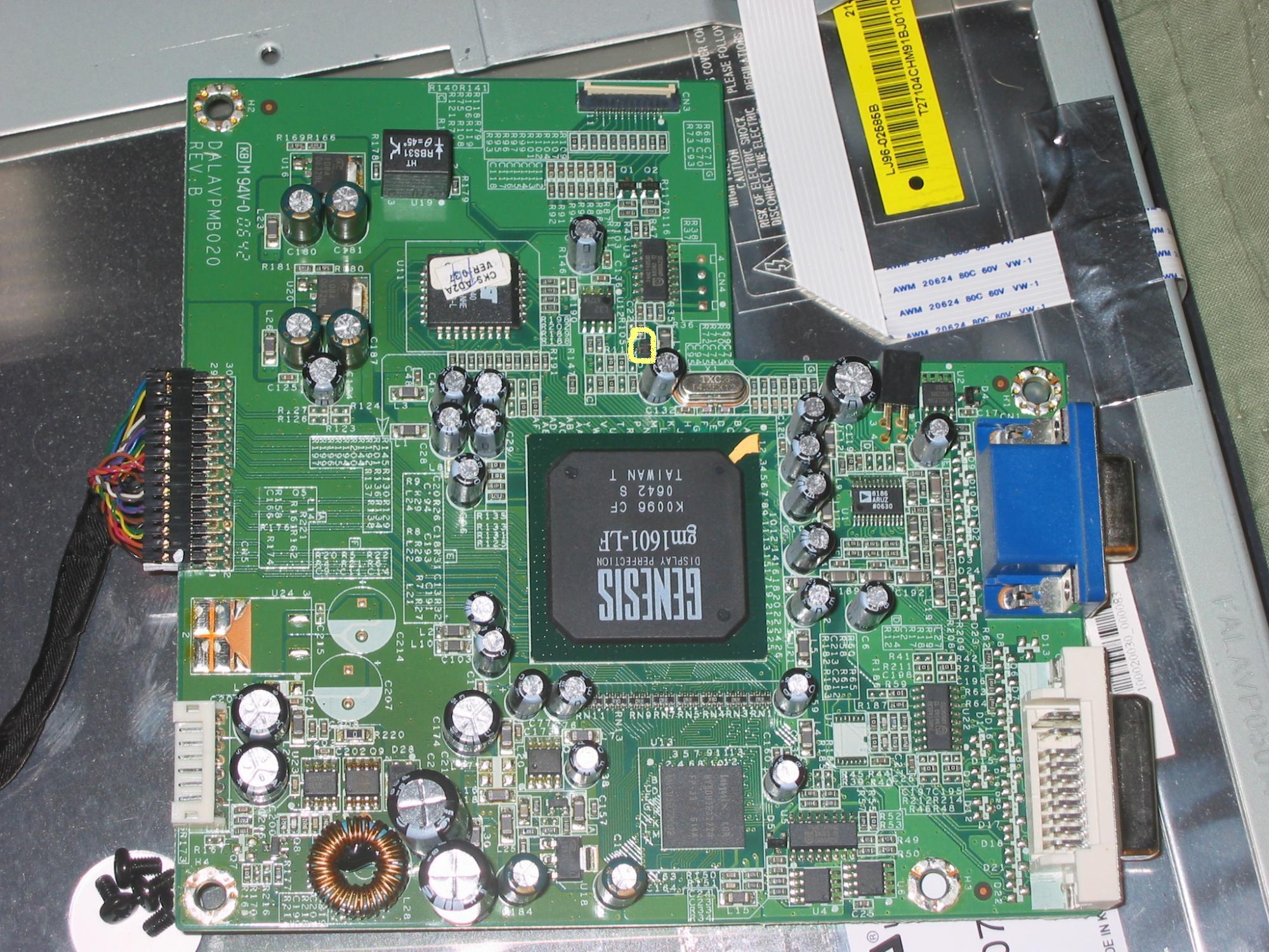

          Okay, I spot several regulators and one SMPS on the main board.
          For the circled devices, check the voltage on each pin, relative to exposed screw hole/case/GND with monitor plugged in.
          For the arrow, flip the board upside down and check the voltage across the two large caps.

            Re: Viewsonic vp2130b - Shut off and will not power up
            Okay, here are the readings:
            Uppermost regulator:
            top pin:~2v
            middle pin:~3.3v
            bottom pin: ~5v
            Regulator directly below:
            top pin:~1/2v
            middle pin:~1.8v
            bottom pin: ~5v
            Bottom regulator:
            top pin:~1.25v
            middle pin:~2.5v
            bottom pin:~5v
            Voltage across the two large caps = 5v
              I see a component marked "U" something circled in yellow. Can you please give me the full number? Is it U10? And what is the part number stamped on the component itself?
              • ljbrandt
                • Nov 2010
                • 32
                It is U10.
                And the # is P081 or POBI or something like that, (very small and hard to read)
                  Originally posted by ljbrandt
                  It is U10.
                  It appears to be a reset controller. It should have 3 leads coming out of it. Two at the bottom and one at the top. If yes, with power to the monitor disconnected, go ahead and remove U10. Piece everything back together, plug in the monitor and try turning it on.

                        Okay, can you read out the part #s on each of the regulators? They seem okay, but I want to confirm.
                        I should also mention that while handling the main board, I heard what sounded to be like a ball bearing or screw rattling loose. I checked the entire board for something loose, but couldn't find anything. I'm assuming it may be something inside the small metal case labeled "TXC"...but just a guess.
                        The device in the black box with 45° written on it - that device tells the monitor it has been rotated and to adjust the resolution. It has a ball bearing in it which blocks out the light between an LED and detector, the ball bearing falls when the monitor goes past approx 45°. Kind of neat feature actually - only seen in on some Viewsonic monitors...
                          Top two regulators:
                          AC
                          1084
                          0632BL
                          Bottom regulator:
                          6J1L
                          1117L
                          ...now to fine a fine point top for my soldering iron, a magnifying glass and some tweezers to remove that reset controller
                            Well, I have an update.
                            I removed the reset controller chip and reassembled the monitor to test it. At first, I noticed no difference. The power LED light was still not coming on and neither was the monitor. Then, I tried turning it off and on several times using the I/O switch next to the A/C plug. I noticed the CCFLs were now illuminating the black screen, and the green LED light came on, but still no picture. I tried a few more times with the hard power switch (b/c the power switch by the LED on the lower bezel didn't seem to do anything). A couple of times I got a weird picture of thin multi-colored lines up and down the screen. I'm not sure what that was! Is there any hope left for this monitor?
                            Update-
                            I left the monitor powered up for several minutes and now the power LED is turning both green and orange. When the LED is green, it displays faint, shadowy horizontal lines and then turns to standby mode and the LED turns orange.

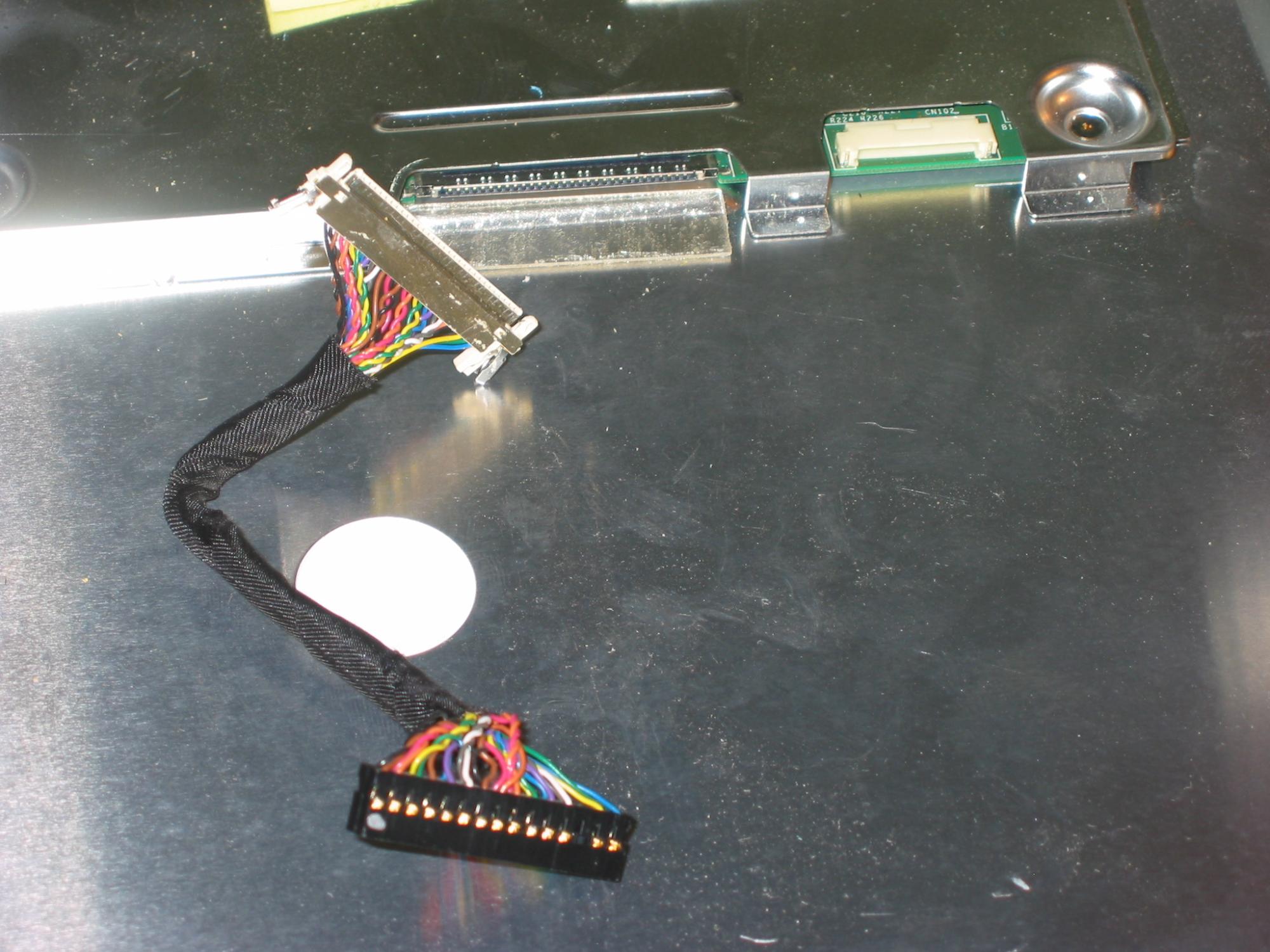

                                Tried reseating all of the connectors/plugs. One thing I noticed next to the CN5 connector was an empty connector receptacle which I don't remember if anything plugged into it. I looked all over and couldn't find anything else that might have plugged into that, but here's a picture. Does anything plug into CN102?
                                • jetadm123
                                  • 2169
                                  #36
                                  There should only be one cable from the logic board to the LCD panel.
                                  Having done some more research, it looks like your reset controller is a MAX809 versus the MAX810 that's been encountered in the past on this forum. With that being said, I've come to the conclusion:
                                  1) Either the main processor chip (GM1601) on the logic board is bad.
                                  or
                                  2) By removing the reset controller, the GM1601 is now in a confused state and doesn't whether to start or remain off.
                                  My suggestion would be to replace the reset controller. If you're in the USA, it should run you 64 cents plus approx $2.00 shipping.
                                  Before ordering, you will need to take a voltage reading. On the location where you removed the reset controller, there was a total of 3 legs. Take your reading on the side that has the single leg.
                                  If you read 3.3VDC order:
                                  http://search.digikey.com/us/en/prod...OSCT-ND/917961
                                  If you read 5VDC order:
                                  http://search.digikey.com/us/en/prod...OSCT-ND/917958

                                      #38
                                      or
                                      Measured 3.3v - I'm going to order 3 http://search.digikey.com/us/en/prod...OSCT-ND/917961 just in case I mess something up.
                                      As the famous quote from Samuel L. Jackson in Jurassic park: "Hang on to your butts!"
                                      P.S. - If this repair fails, what are the chances of procuring a new mainboard for this model monitor?

                                        #39
                                        I received the controller from digi-key today. I went ahead and put it in and when I tried to power on the monitor, I got nothing...no backlight or LEDs (same issue I had originally). I should mention that when I put my ear to the PCBs, I heard a high pitched noise cycling on/off. Not sure what that meant.
                                        I took the new reset controller back out and turned it on again and got the same result as before when I took out the original controller.
                                        Does anyone know if viewsonic stocks these older mainboards or have any other ideas? Such a shame, b/c this was such a nice monitor.
                                        • jetadm123
                                          • 2169
                                          #40
                                          Sorry to hear it didn't work. I believe Viewsonic does not sell aftermarket boards and your best bet would be eBay.
