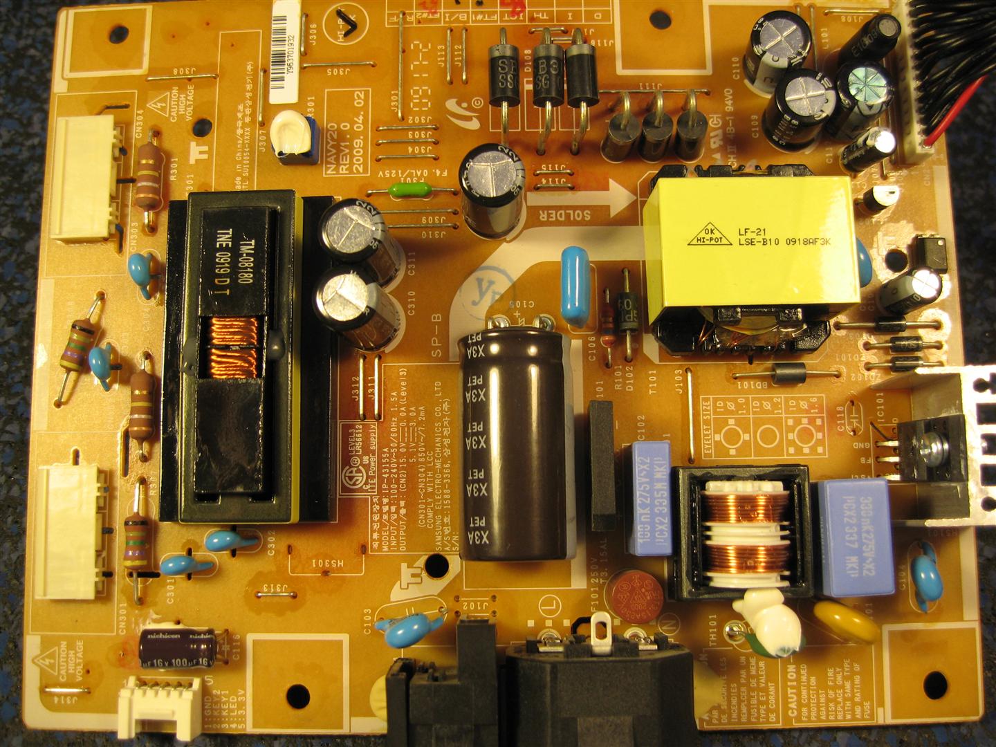

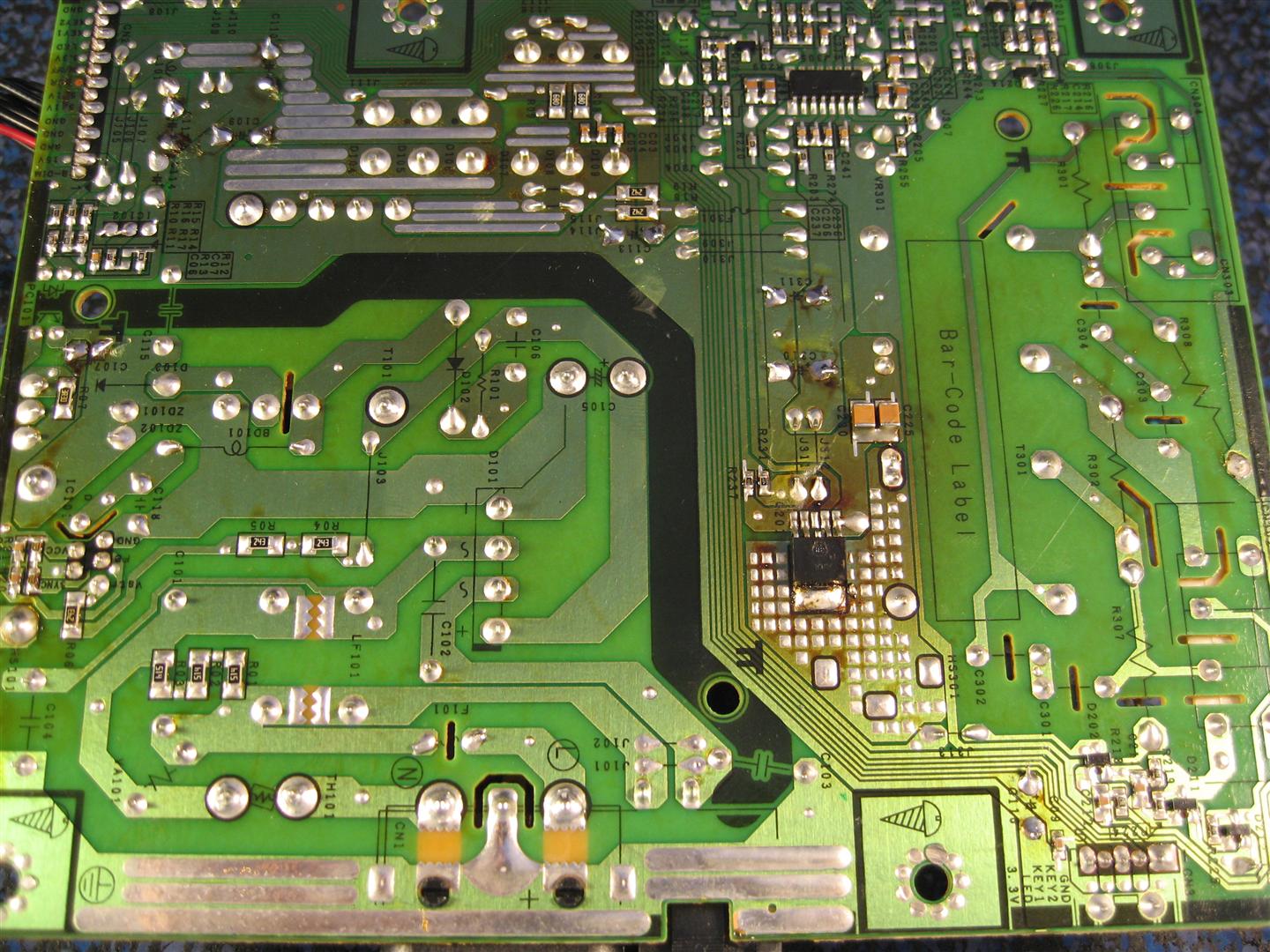

    I have a Samsung Syncmaster F2080 monitor that powers on for about 5 seconds and then shuts off. I have replaced all the capacitors on the power supply board...at least all the "can" caps, and it still does the exact same thing. I used Nichicon caps for all of them. None of the ceramic disk caps look burnt (like I had on a Vizio LP2626 recently).
    Does anyone have an familiarity with this monitor/board? It still seems like a capacitor problem, to my minimally-knowing brain. Can the disk caps be bad without being burnt? Pics are attached.
    I'm more than happy to do some diagnosing, I could just use some help.
    Thanks.
    Re: Samsung Syncmaster F2080 on for 5 sec
    sounds like 2 seconds to black:
    https://www.badcaps.net/forum/showthread.php?t=10419
    Possible causes include bad capacitors, bad ccfl's, bad ccfl wiring, shorted transistors, bad transformer, among others.

      Thanks. I missed that thread. I'll check it out.
        Start with posts #19 and #20 for the latest revision.
