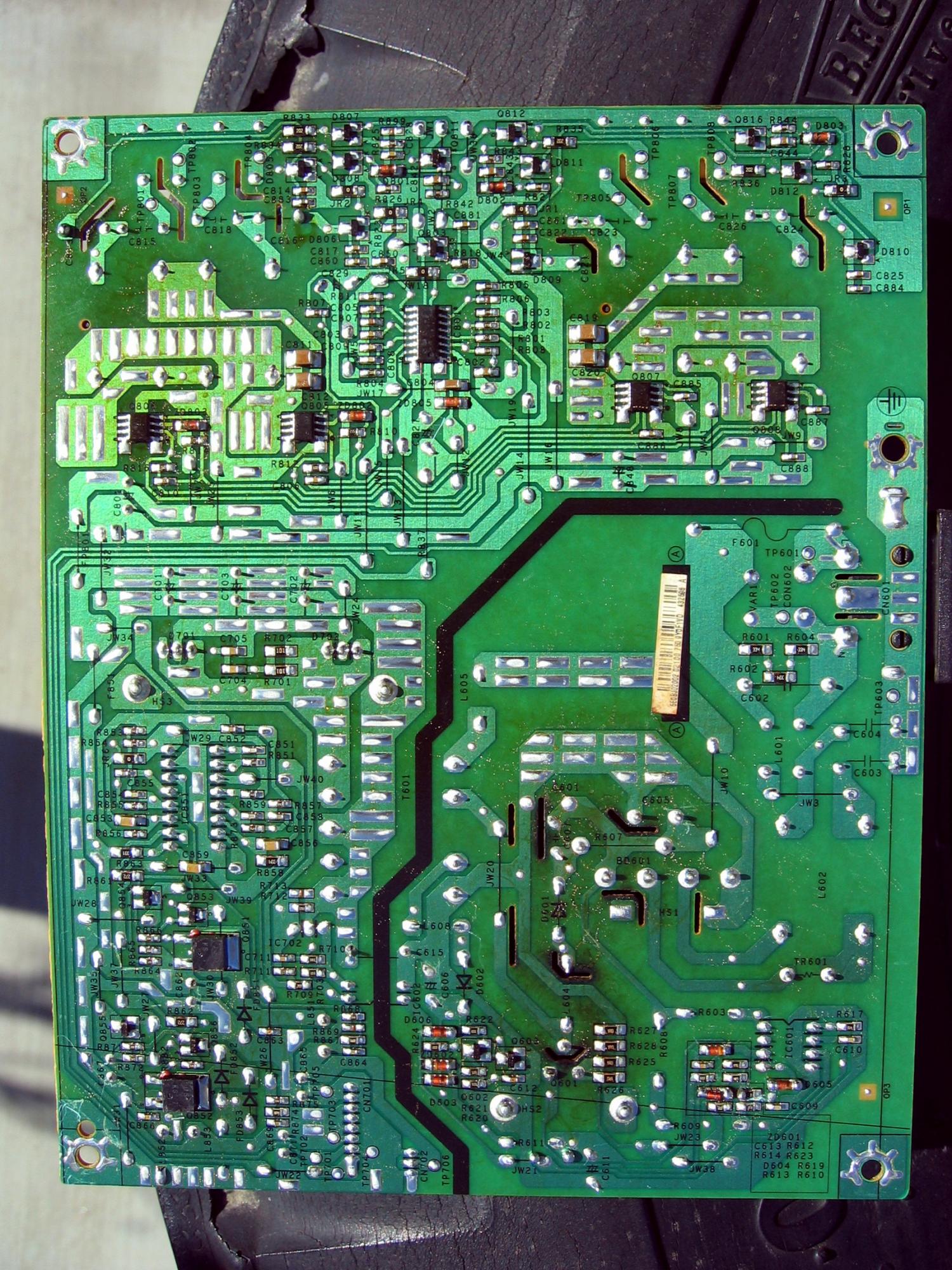

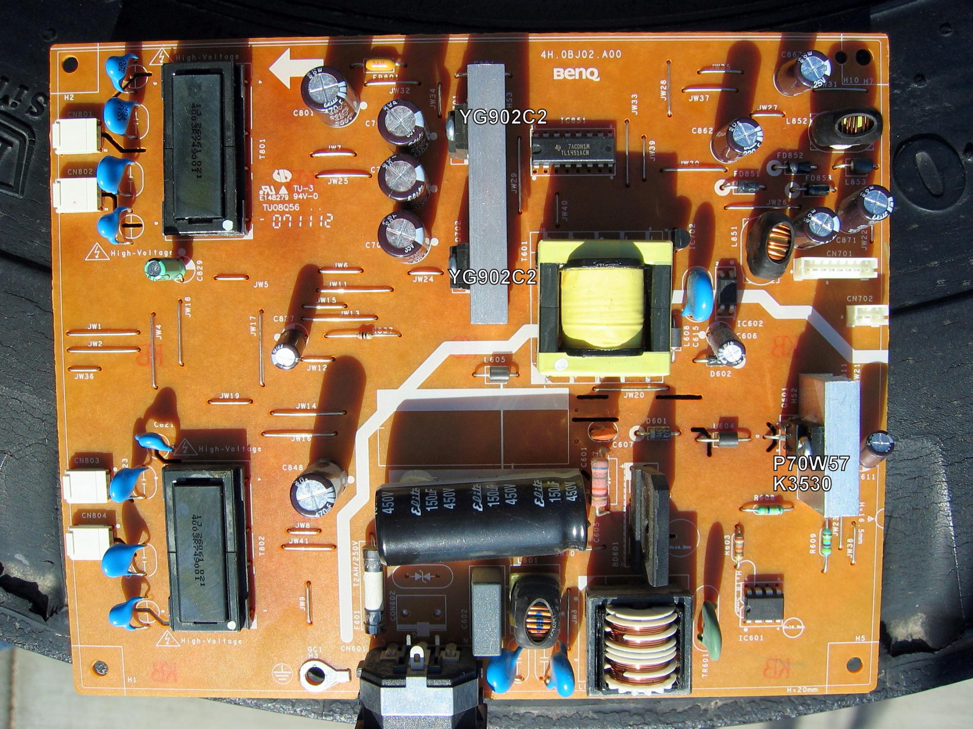

    Recently my Benq g2400w started exhibiting the "2 second to black" symptom. When I turn it on, the display will work fine for about 2 seconds before turning off to black.
    I can switch inputs to VGA, DVI, or HDMI, but the symptom persists.
    I suspected perhaps it was bad caps, but they all look fine from an external view. I also used my cheap multimeter to see if they charged up, and they do. I also tested all the diodes I could find, and they read approximately right values 0.6-0.8 volts
    I looked at all the solder joints, and even reflowed a few that looked potentially weak, but it hasn't helped.
    I checked the fuse, it reads .3 ohms.
    I did see this thread,
    https://www.badcaps.net/forum/showthread.php?t=10419
    but it wasn't specific to my monitor's power supply. Perhaps you could help point out some components I should look at.
    Here's the full quality jpegs, because this site resized and shrank them:
    http://ordorica.org/system/misc/benq...ly%20front.JPG
    http://ordorica.org/system/misc/benq...ply%20back.JPG
    Any help would be appreciated. I do like this monitor and it would be a shame to throw it away because of this. Unfortunately, all I have is a basic soldering iron and multi-meter.

    Re: Benq G2400W 2 second to black problem
    2 seconds to black can be
    a) bad caps
    b) bad inverter transformer
    c) bad ccfl
    d) bad ccfl wiring
    Since you already found the guide, test for a bad inverter transformer.
    Refer to
    http://www.lcdparts.net/TransformerD...ProductID=2731
    for the secondary pins. Measure the resistance between S1-S2 and S3-S4 for both transformers.
    All 4 readings should be within 3% of each other.
      1st Transformer:
      S1-S2: 1.03K
      P1-P2: 0.3
      P3-P4: 0.3
      S3-S4: 1.03K
      2nd Transformer:
      S1-S2: 1.04K
      P1-P2: 0.3
      P3-P4: 0.3
      S3-S4: 1.02K

        1) Your transformer readings are good.
        2) This is low probability, but on the back of the pcb are 4 mosfets: Q805, Q806, Q807, and Q808. In the guide, there is a procedure on how to identify and test those mosfets for shorts. Post your findings.
        3) If the mosfets are fine, then the next step is to check your ccfls.
        4) PS. Great photos with good focus and composition. I don't think we have seen one on a tire yet though.

          I checked out the mosfets you asked for. It's hard knowing whats the source, drain, and gate, but with the continuity tester I found the drain is all connected on the left side. So I guess it looks something like this although the source and gate may be in different pin locations.
          http://www.datasheetdir.com/MTN4410Q8+N-Channel-MOSFETs
          Anyways, none of the combinations of results in a reading lower than 200 ohms for
          a) black on pin S1- red on pin G1 - record ohms
          b) black on pin S1- red on pin D1 - record ohms
          c) black on pin G1- red on pin D1 - record ohms.
          I was able to also test the internal diodes of the mosfets, and they read right (0.5-0.6 volts).
          The photo was on top of a tire swing. Taken with my old but good Canon S400.
