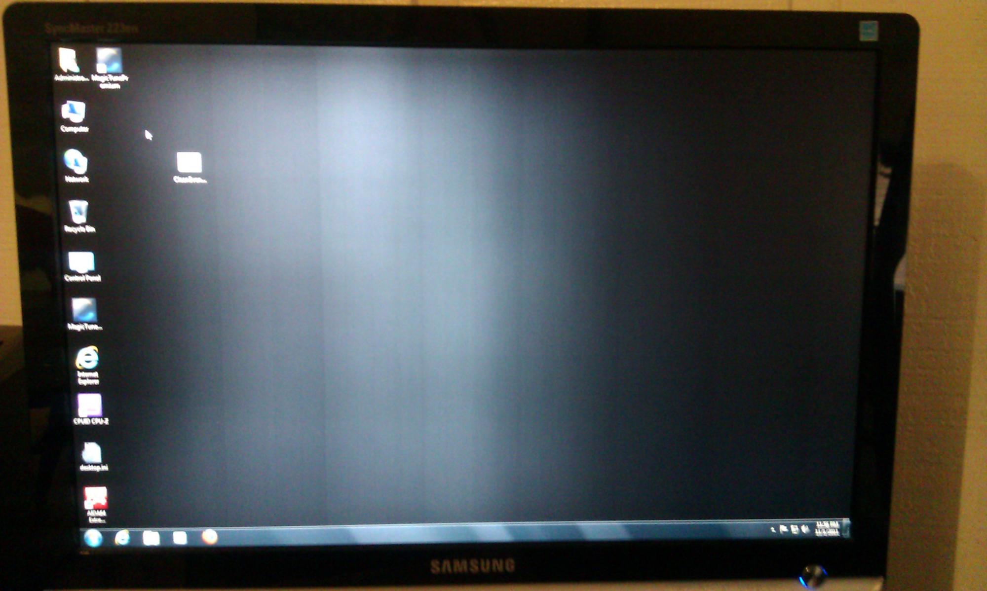

    I'm fishing for an opinion before I get too far into this.
    The white area has a fast flicker, almost a roll from down to up.
    The far right side looks good. Can anyone hazard a quick guess before I look at the boards?
    Thanks.

    Re: SyncMaster 223BW White Flickering Area
    Thanks.
    Bad cap or caps; by the description, some ripple is getting through. I'd suspect either the mains filter cap or the startup cap. If I'm right, you owe me 100 Quatloos; If I'm wrong, you owe me pictures of the power supply and signal boards.
        Syncmasters are well known for bad caps. Samsung quality shines through again. But it could also be a bad LDO or a bad LCD panel.
        I had a similar problem with a Xerox LCD, except the entire display was affected. A good picture would show for 1-2 seconds, but it would then freeze and slowly fade to white. It had 7 bad caps...!
