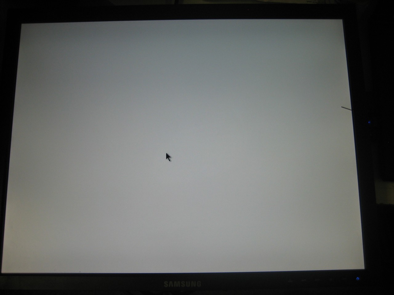

        I have my eye on a Samsung 204B but the screen has this little diagonal line visible in the right hand corner. Does it look familiar to anyone?
        • shovenose
          Send Doge Memes
          • Aug 2010
          • 6575
          Re: Looking For a Project Monitor
          Looks like a piece of wire from the CCFLs or something. Should be an easy enough fix.
