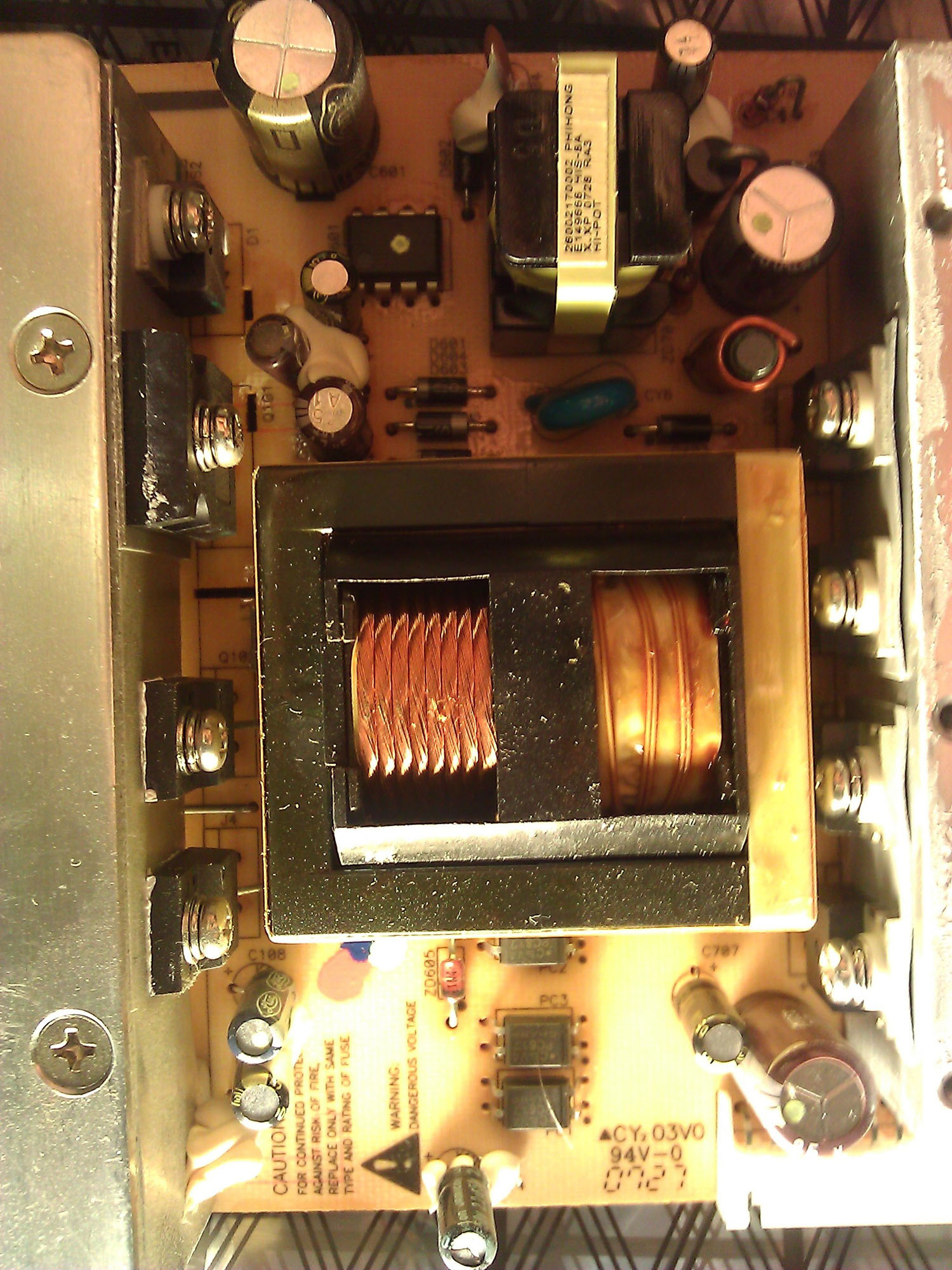

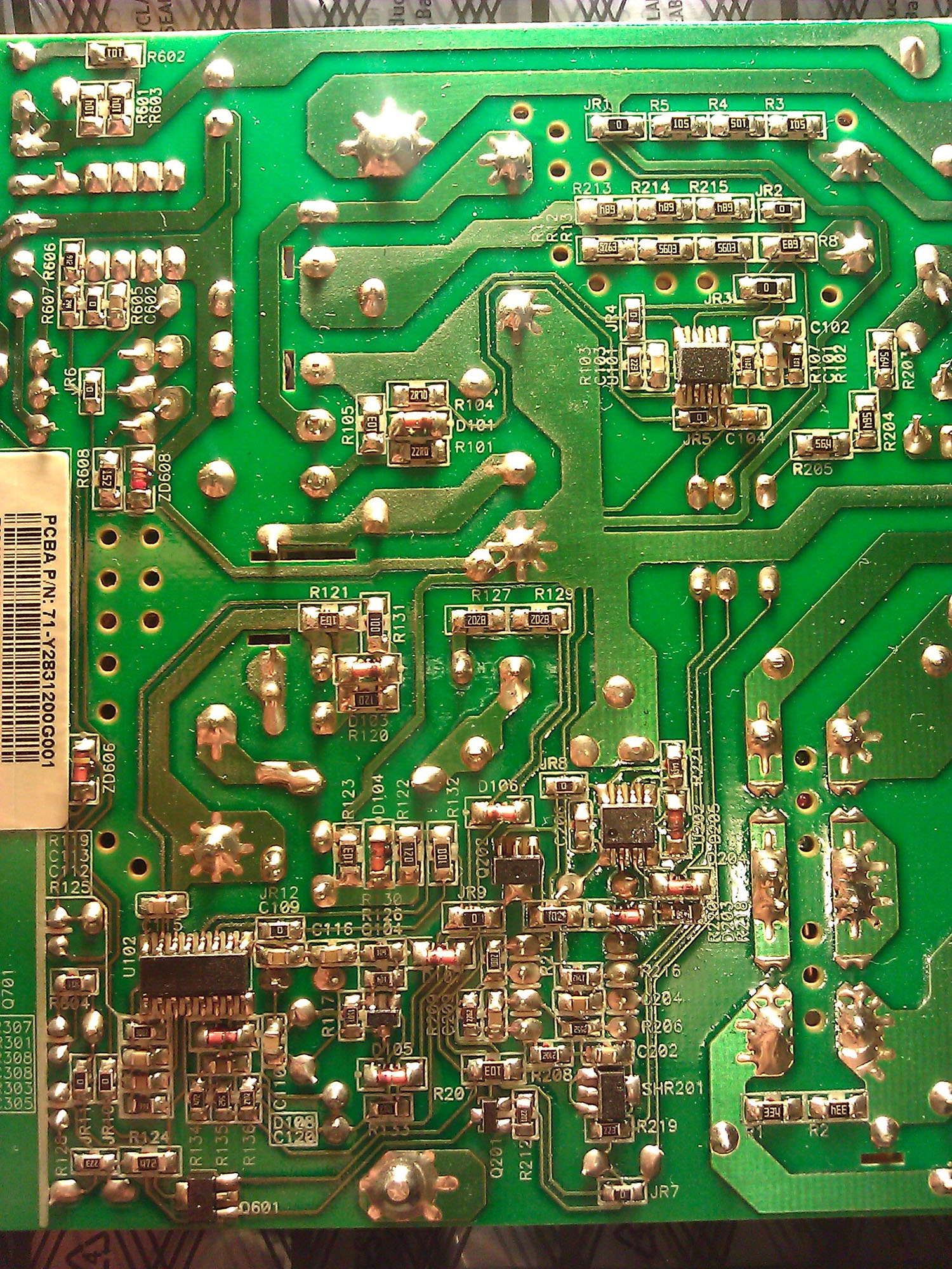

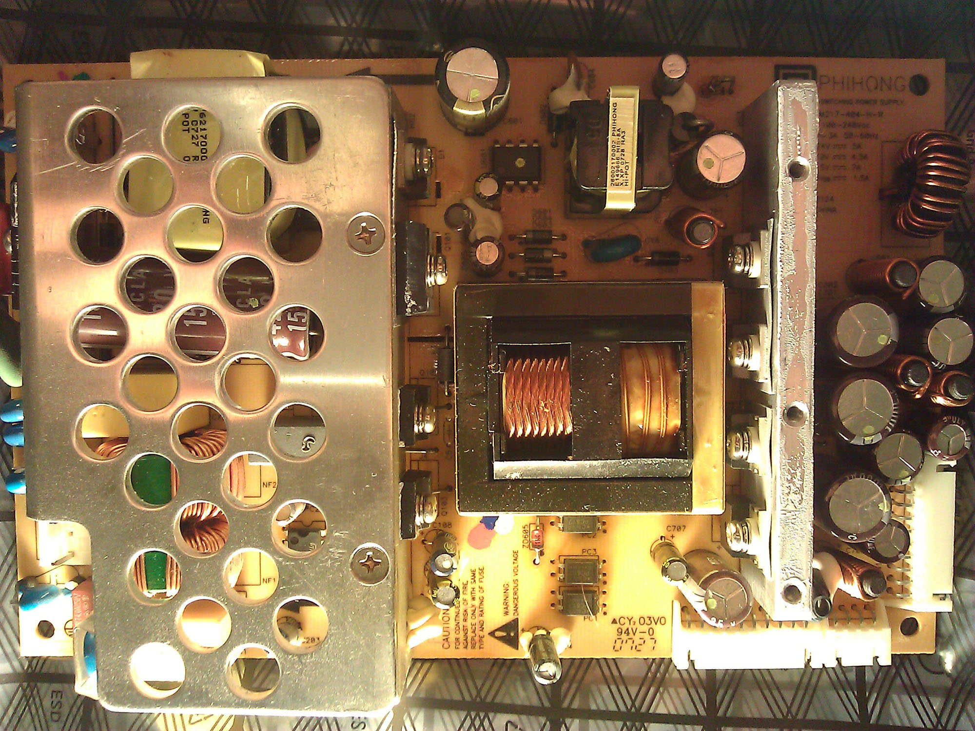

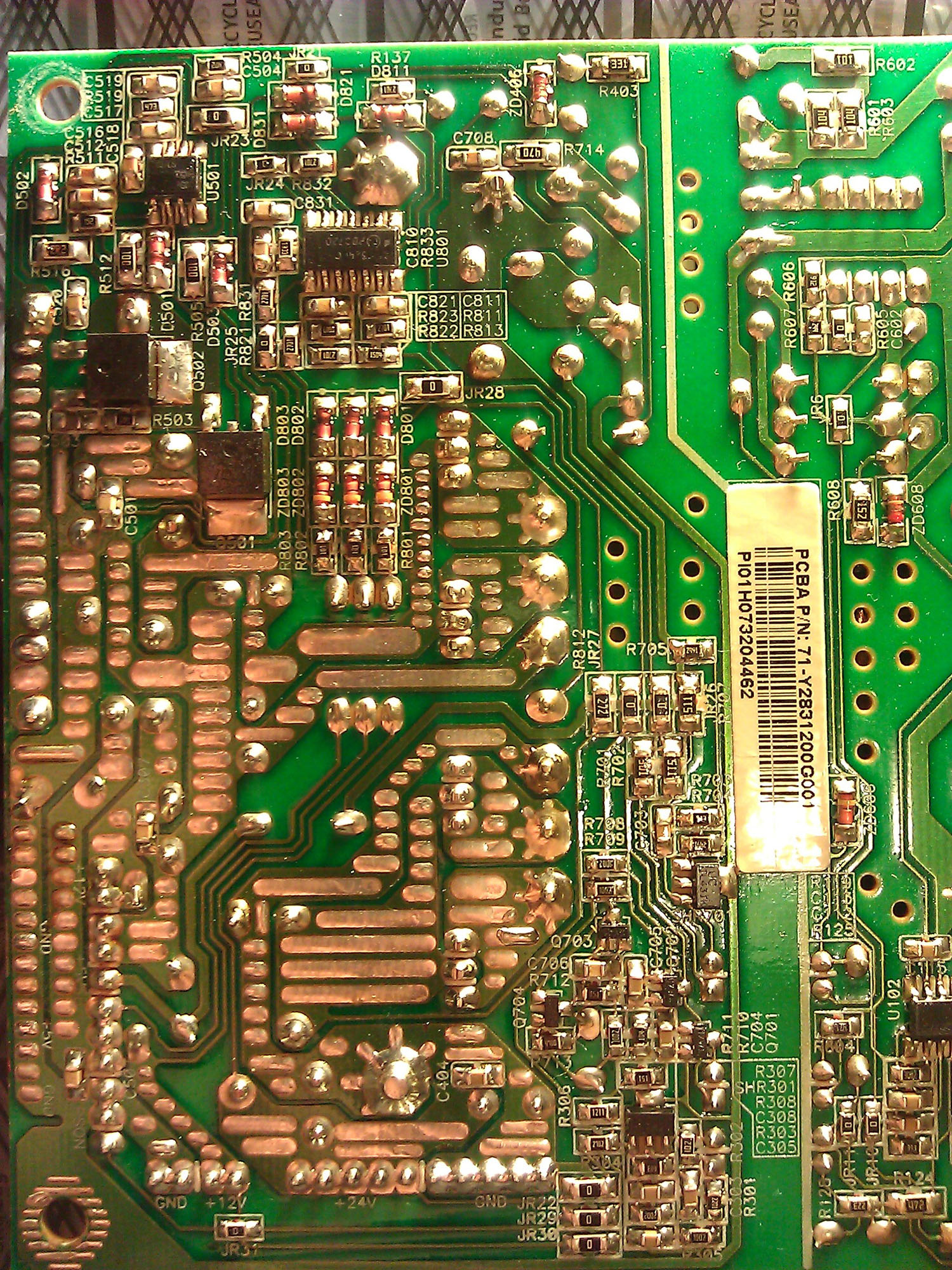

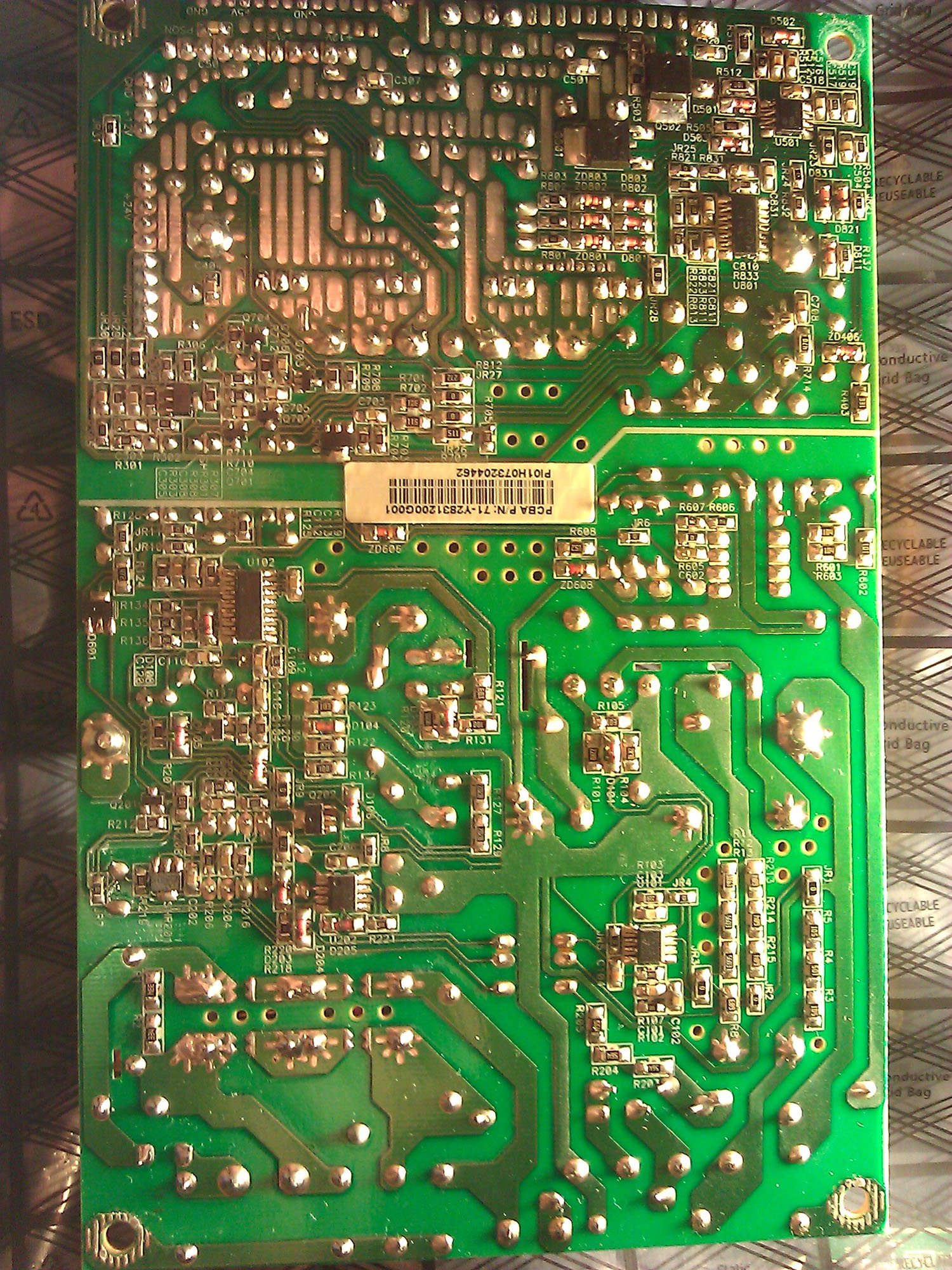

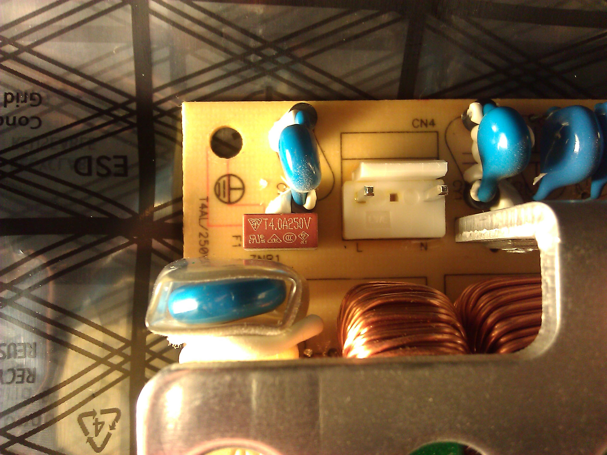

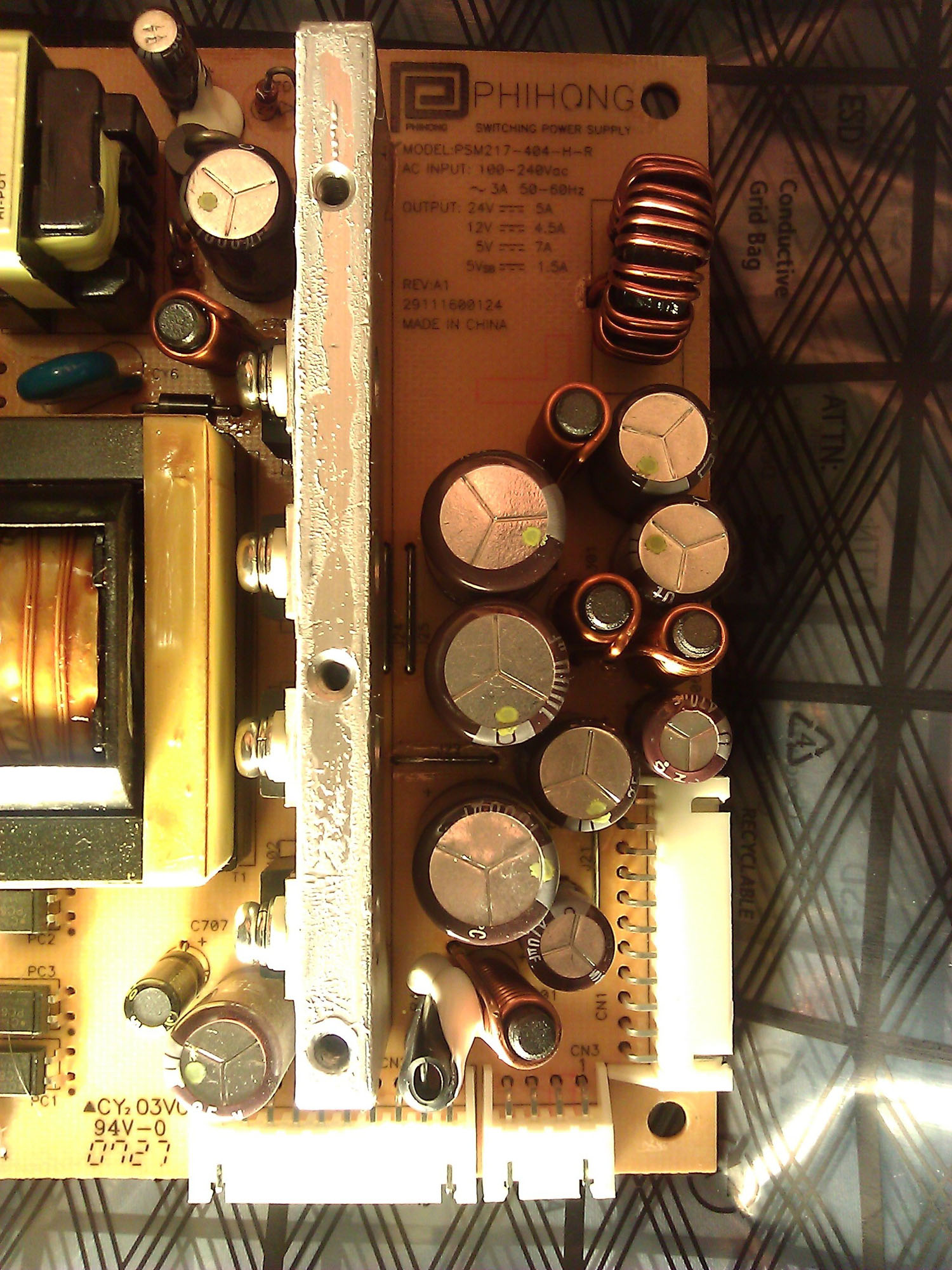

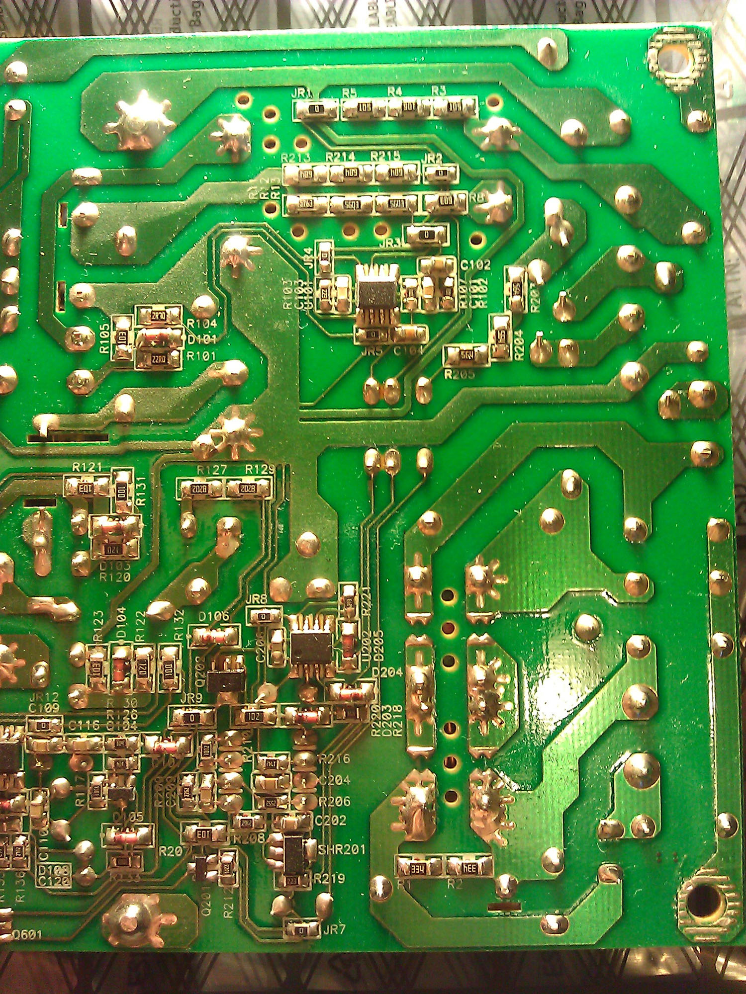

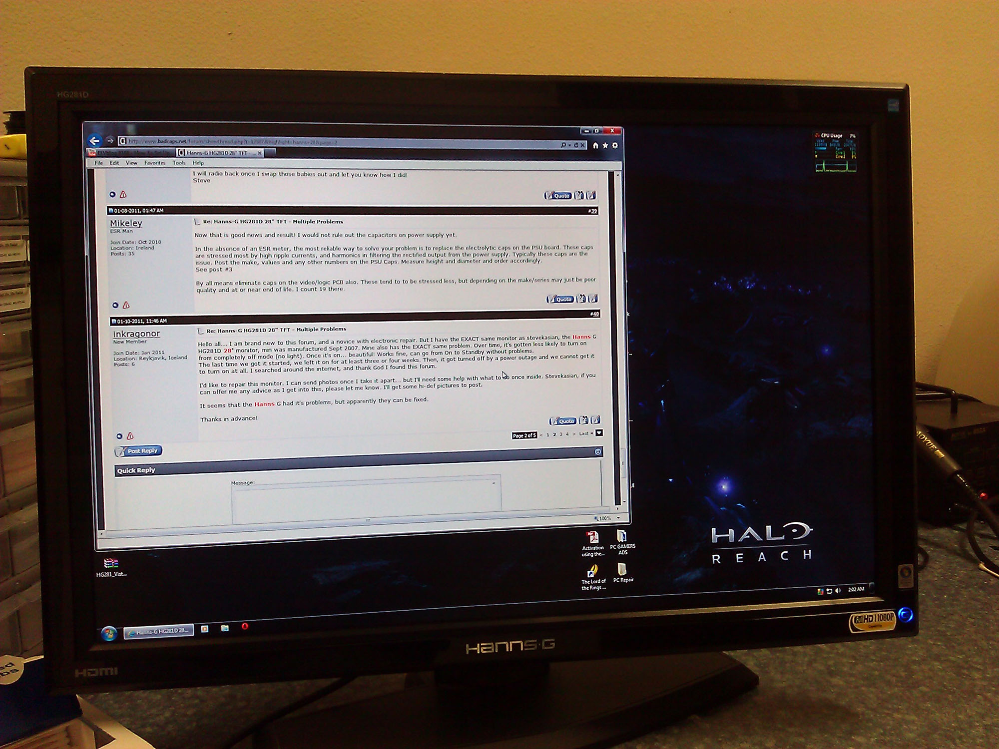

I have a hanns g HG281D monitor that started having problems awhile ago. It started much like others on this forums have. The power button wouldnt turn the monitor on, having to press it 20-30 times before it would finally come on. Once it did come on artifacting could be seen randomly on the screen.
Eventually it stopped powering on all together and I let it sit and used my tv as a monitor. Well yesterday I finally decided to fix it. I took it all the way apart and completely replaced all the capacitors on both the psu and main board (all except the filter cap). When I was done the monitor powered up and started working fine (after I took it apart and found a loose cable causing the video to be grainy). Everything seemed fine and so I decided to watch some youtube videos to let it burn in.
Well I didnt even get 30 seconds into the video when the monitors backlights started shuting off then coming back on. It did this about 4-5 times before the backlight shut off and did not turn back on.
Turning the monitor off and waiting for about 5 minutes and turning it back on it came right back up again. Then after 4-5 minutes the backlights turned back off again.
I do not have a multimeter at the moment. I ordered one from amazon but I havent recieved it yet.
I was just wondering if anybody with experience could point me to some possible items to check?
I plan on double checking all of my solder points but I was wondering if anything else could be causing this?
It seems to me that when the components heat up there must be some kind of expansion happening? Causing some kind of short or improper connection?
I have some pictures of the PSU below, before I changed the capacitors. Sorry for the picture quality, I only have a 5mp camera on my cell phone.Plus having to reduce the size and quality in order to upload them didnt help either. Also one picture I took after getting it up and running, before the backlights went out. I thought I had taken pictures of the Mainboard but I guess I didnt! I will get a few snaps of that soon!
All the replacement capacitors are Panasonic and Nichicons.
I hope you guys can help me! and sorry for the long post
