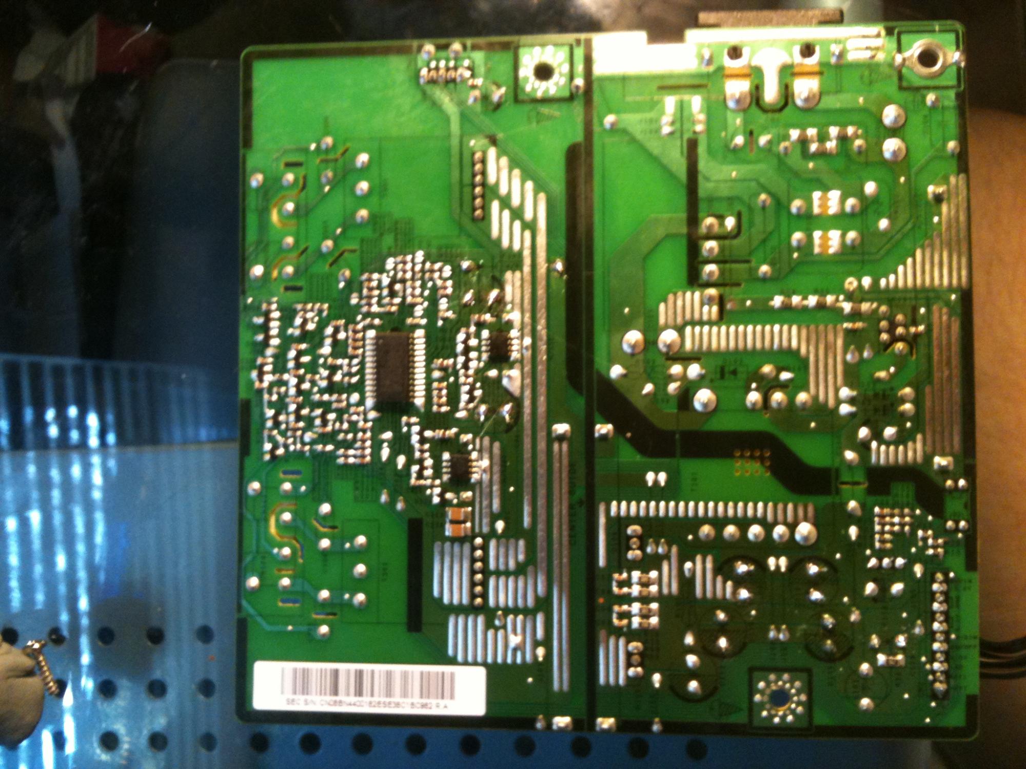

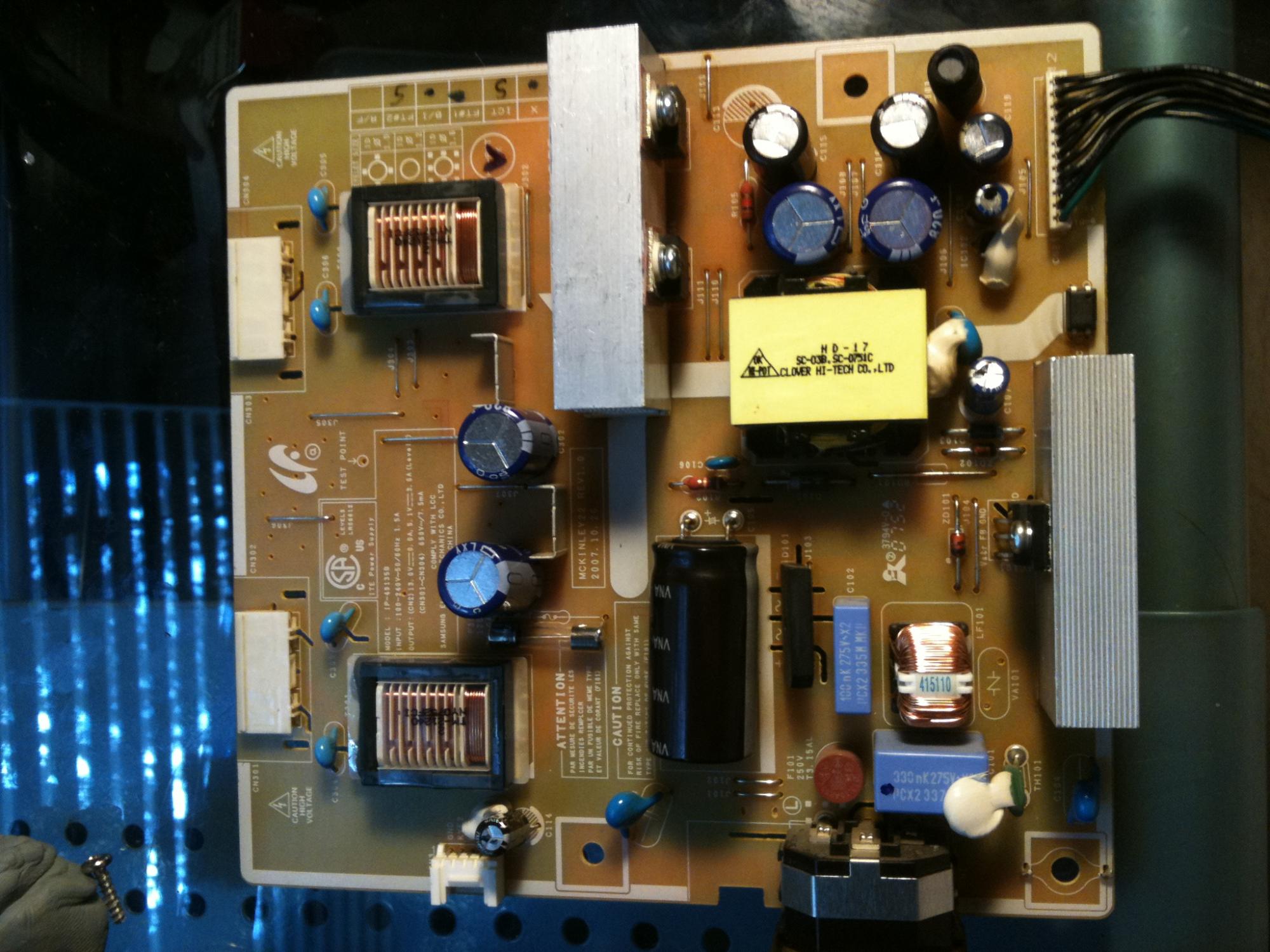

          Here are some pictures Im not sure where the dc outputs would be is that where the 4 cables to the backlights connect? and I Would just test the resistance to ground? I am a bit confused but im going to pullt he fuse now just wanted to get some pictures up

            Pictures

              Ok so with the fuse removed as soon as i plug it in a hear a feint high pitch whining. When I push the power button the light comes on and the noise goes goes away (this is all with the 4 leads to the lights removed). That start-up cap maybe?

                ok so i replaced the start-up cap with another one from a new power supply ( I have a ton of them and most are outdated and have low output) and I put back the fuse. now I am getting a much faster clicking from the board and the power button does nothing like before. Sorry for posting so much im not impatient or anything just trying to be as informative as possible

                  Re: Samsung 2253BW replaced caps and fuse still broken
                  Well, the results from lifting the fuse is pretty definitive. The problem lies in the inverter. The picture of the top is quite good, but the one of the bottom of the board isn't, so I will have to improvise.
                  The inverter controller is the 24 pin IC; the drivers are the two 8 pin ICs. What are the part numbers of the drivers?
                  You might as well put the original starup cap back in; it's not the cause of your problems.

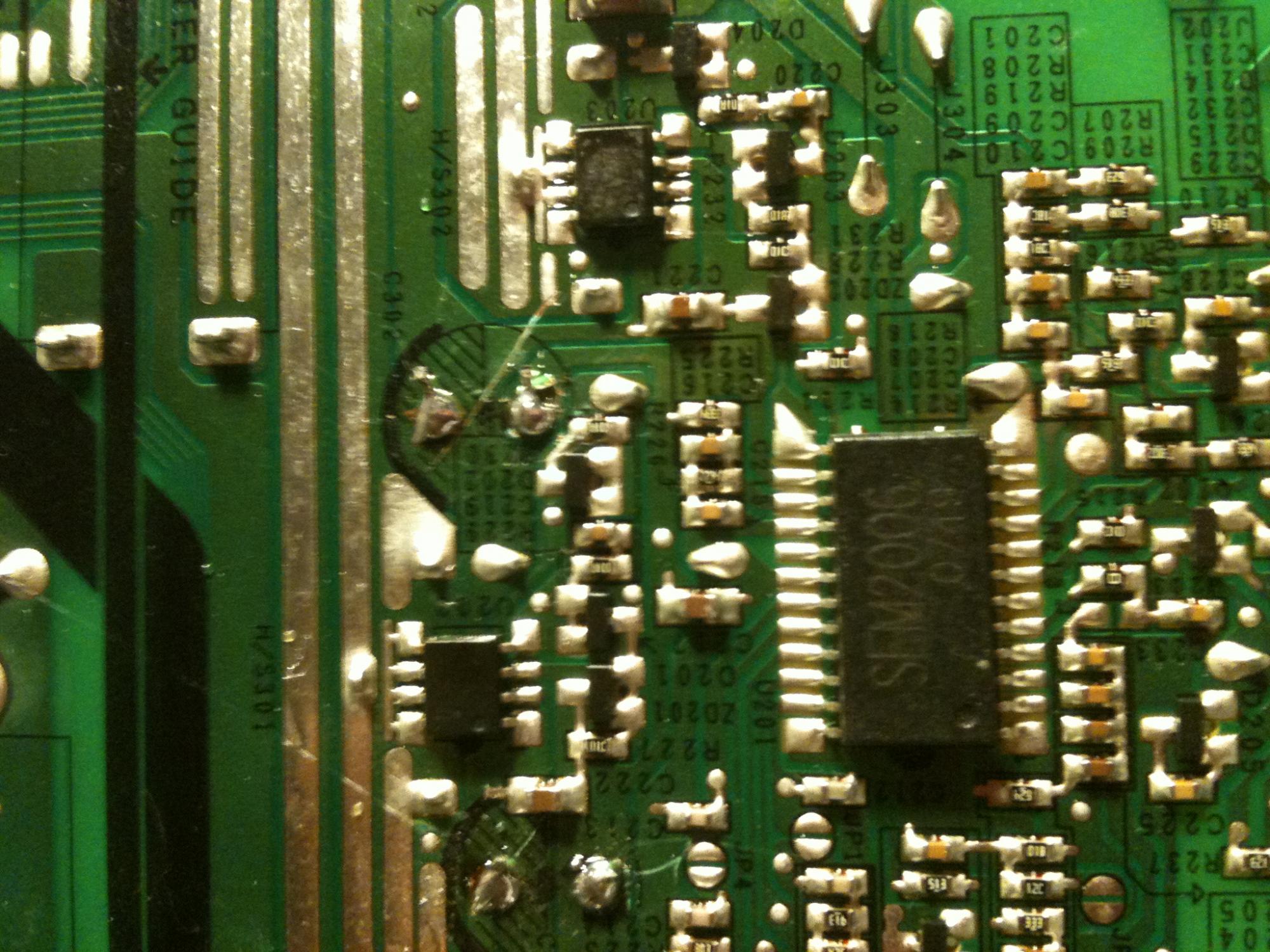

                    no writting on the small chips or maybe it burned off big IC is sem2006 0749
                    • darkphreekquency
                      • Aug 2011
                      • 16
                      here is a closer pic. There is a scratch on the pcb. I was really concerned but it didn't destroy the trace. I have a crazy cat that likes to jump on my shoulders when im doing things that are important lol.
                        https://www.badcaps.net/forum/showth...ghlight=2253bw
                        Wonder if the 8 pin ICs are the same as in the above thread post # 12
                          Explain to the cat that such behavior is unacceptable. Then lock it in another room.
                          Alexanna's suggestion seems to be correct - these ICs (dual transistors) are very probably STM8309 or equivalent. But rather than just ordering, let's test them.
                          Since you are the type of person who puts up with a disruptive cat, I'll assume the worst. Wikipedia has the numbering for the package. The package contains two transistors. Pins 1, 2, and 7&8 are one transistor; pins 3, 4, and 5&6 are the other. Set your DMM on the 200 ohms range and measure the resistance between pins 1 and 2; between 1 and 7&8; and between 7&8 and 2 (& means you can use either pin 7 or 8). Do the same for pins 3, 4, and 5&6. Then do the same for the other package.
                          The criteria are simple - if you measure less than 20 ohms between any pin combination I listed, the IC is bad. If one is bad, replace both. As mentioned in the other thread, they are available on eBay, but I suspect equivalent packages are available from other vendors.
                          Now go let the cat out.
                          PlainBill
