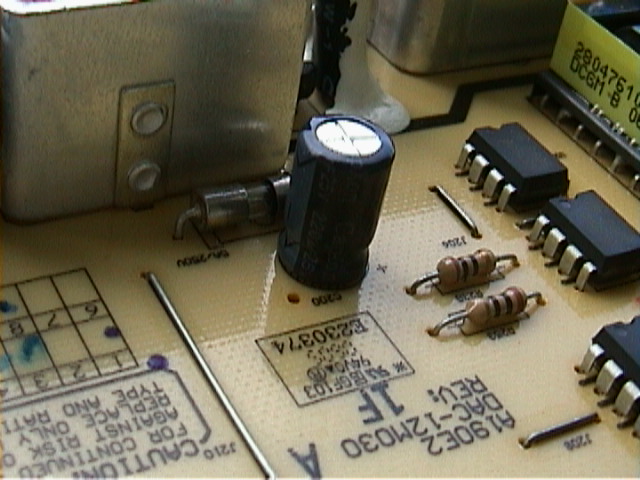

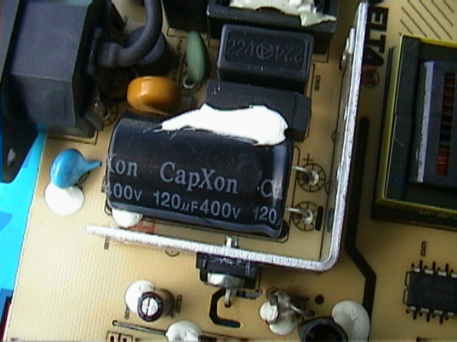

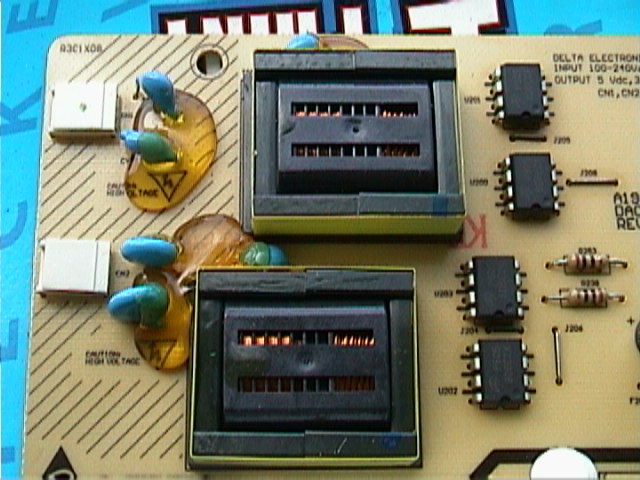

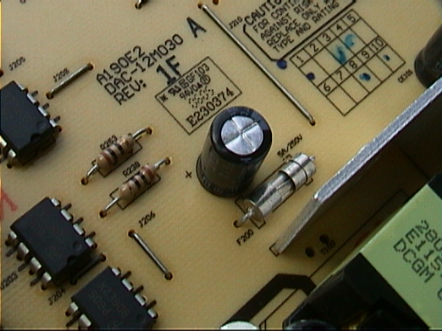

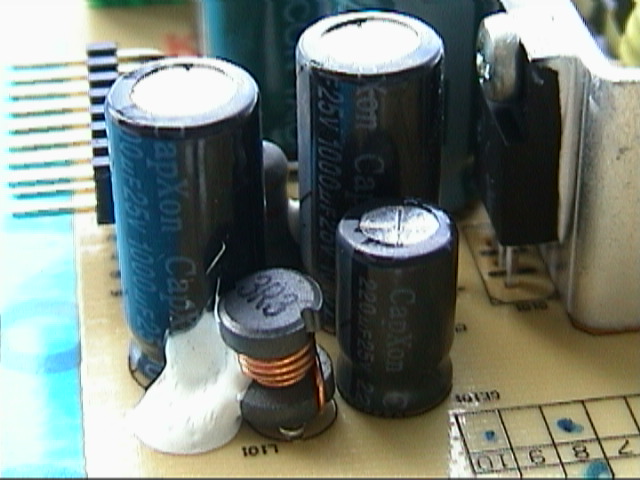

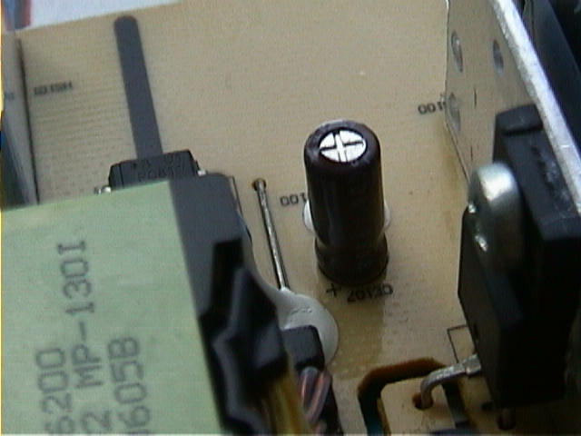

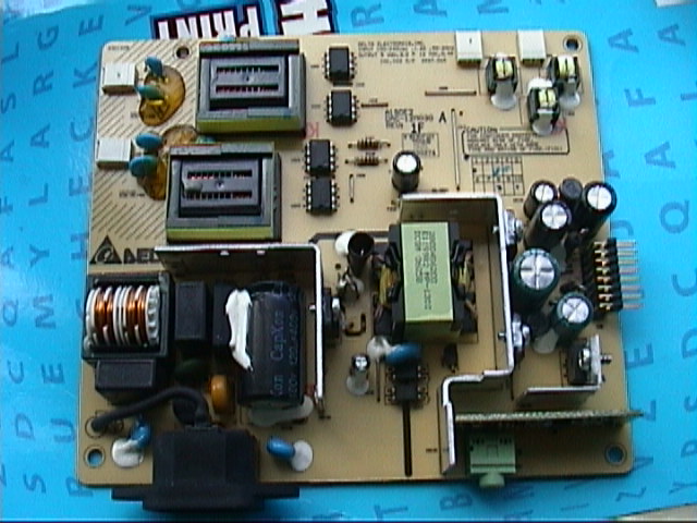

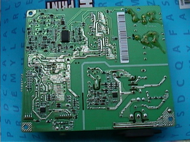

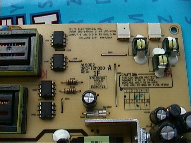

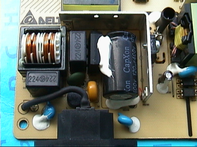

    Hi again my monitor did have a blinking green light now its a steady amber light i push the power button an no change its connected to computer and its a black screen here are sum pics of board could anyone give me the p/n`s on DigiKey for all 8 caps on this board if u think i should replace them thanks in advance

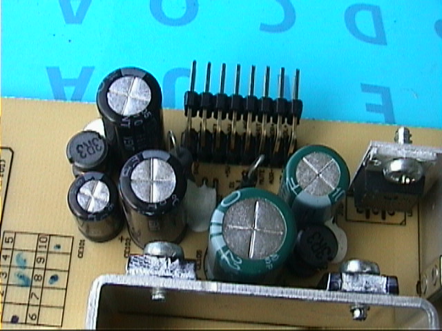

    more pics

      I have a simple suggestion. I believe this is about the third or fourth request you have made for this information, and I'm getting a little bored with it. Instead of spamming the forum with requests for a list of stock numbers, how about YOU doing a little work?
      Make a list of the electrolytic capacitors on the power supply. For each one, show the capacity, voltage, and the diameter. Also show the height of the tallest capacitor.
      Then go to this post, follow the directions, and make up your own list of appropriate replacements.
      Now, if you are properly apologetic, and you post the initial list and your proposed replacements, someone may confirm your selected replacements are correct.

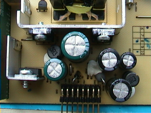

        hi thanks again i`ve tried but couldn`t locate a 2200uf 10v 105degree 12mm dia.x20mm height radial can n 5mm spacing thru hole cap
          http://search.digikey.com/scripts/Dk...me=565-1510-ND

            Re: ViewSonic VA1912wb
            Digikey has 2200uf 10v Panasonic FC and FM. Nominally 12.5mm in diameter.
