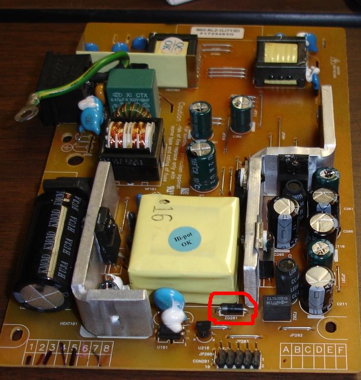

    In addition to bad caps, I have a gateway 900w or FPD1975W Rev. J that fried the zener right under the caps labeled ZD201 on the board. No markings are legible on it since it got so hot it cracked.
    Power supply is the 860-ALZ-GJ712D which is common on a bunch of gateway 17-19" LCDs including some 700g and 900g models.

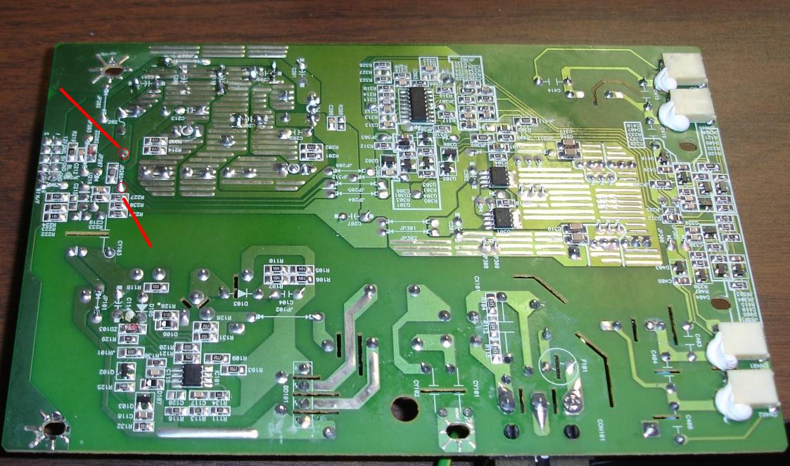

    ZD201 is located right above the pin header to the other board. Attached pic is not my board but has a clear picture of where the zener is and I have highlighted it in red.
    Any info would help, either the markings on yours or checking the voltage across yours would work too.

    Check where that zener is connected. By any chance is it from the 12V output to the 5V output?
      PlainBill
      I am going by pictures since I do not have the board in front of me.
      One side appears to go straight down to the header and 5v and the other appears to go back to the top of the Cap stack and into one of the heat synced 3 legged power transistors(regulator?) the other side of which appears to come back down to 12v. It is not directly connected 5v-12v as far as I can tell.
      And obviously other components are tied to those paths as well, but that is the most direct path I can find 5v-12v relative to it.

        I am going by pictures since I do not have the board in front of me. One side appears to go straight down to the header and 5v and the other appears to go back to the top of the Cap stack and into one of the heat synced 3 legged power transistors(Regulator maybe?) the other side of which appears to come back down to 12v. It is not directly connected 5v-12v as far as I can tell.
        In the pic, it is the trans on the middle of the Z bend facing the camera above the cap forest.

          Those three legged devices are schottky diodes used to rectify the outputs of the 5V and 12V windings on the transformer. One design I've seen links the 12V output to the 5V output through a 8-10 volt Zener diode. If you can confirm the hookup (or post pictures) I'll dig through my collection of schematics and se if I can come up with something better than a wild guess.

            There are a ton of pictures of the PS from different angles in this thread. Every picture on page 1 is of the same model and they are in much less "Tanned" condition than mine.
            I marked up one of them on the trace side for the location of ZD201.
