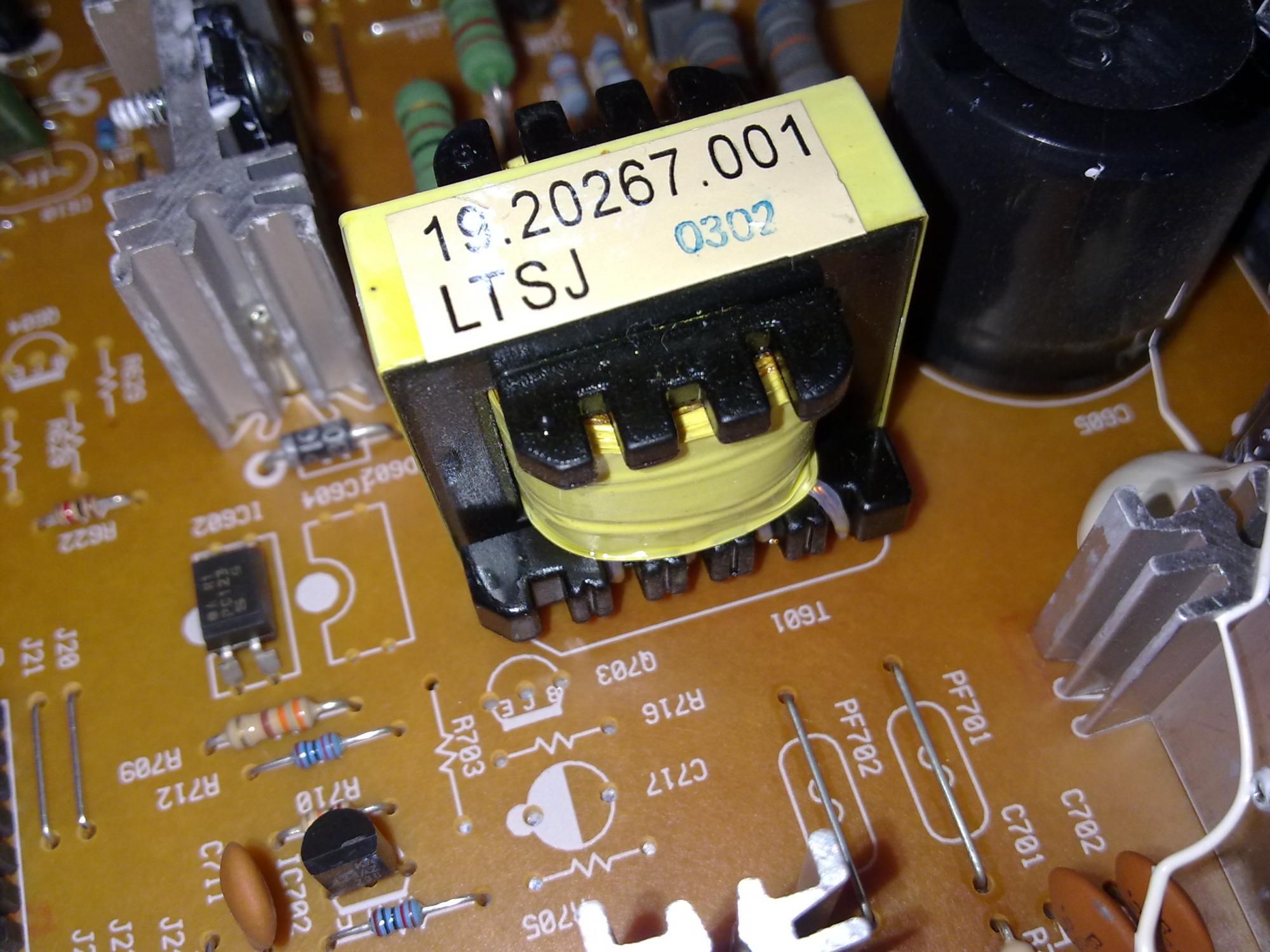

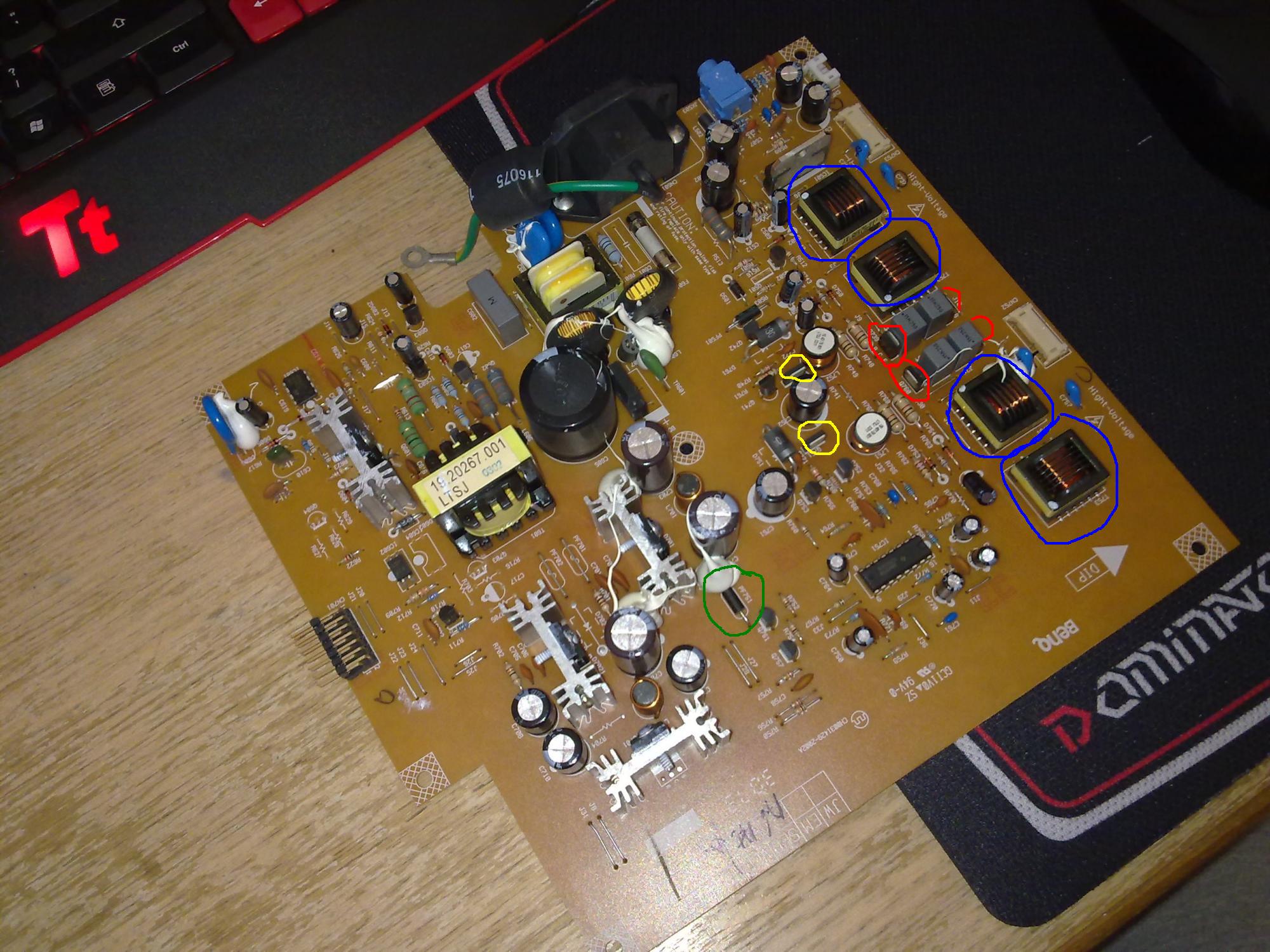

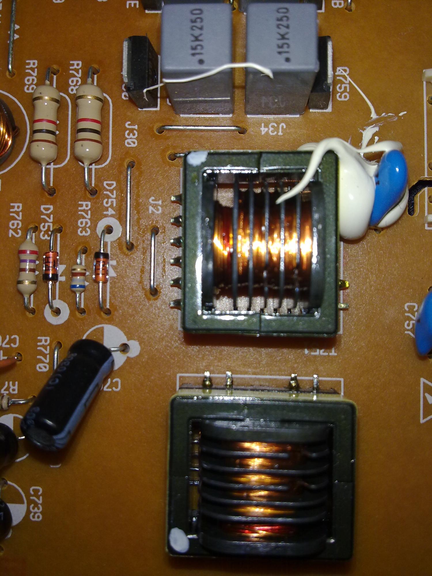

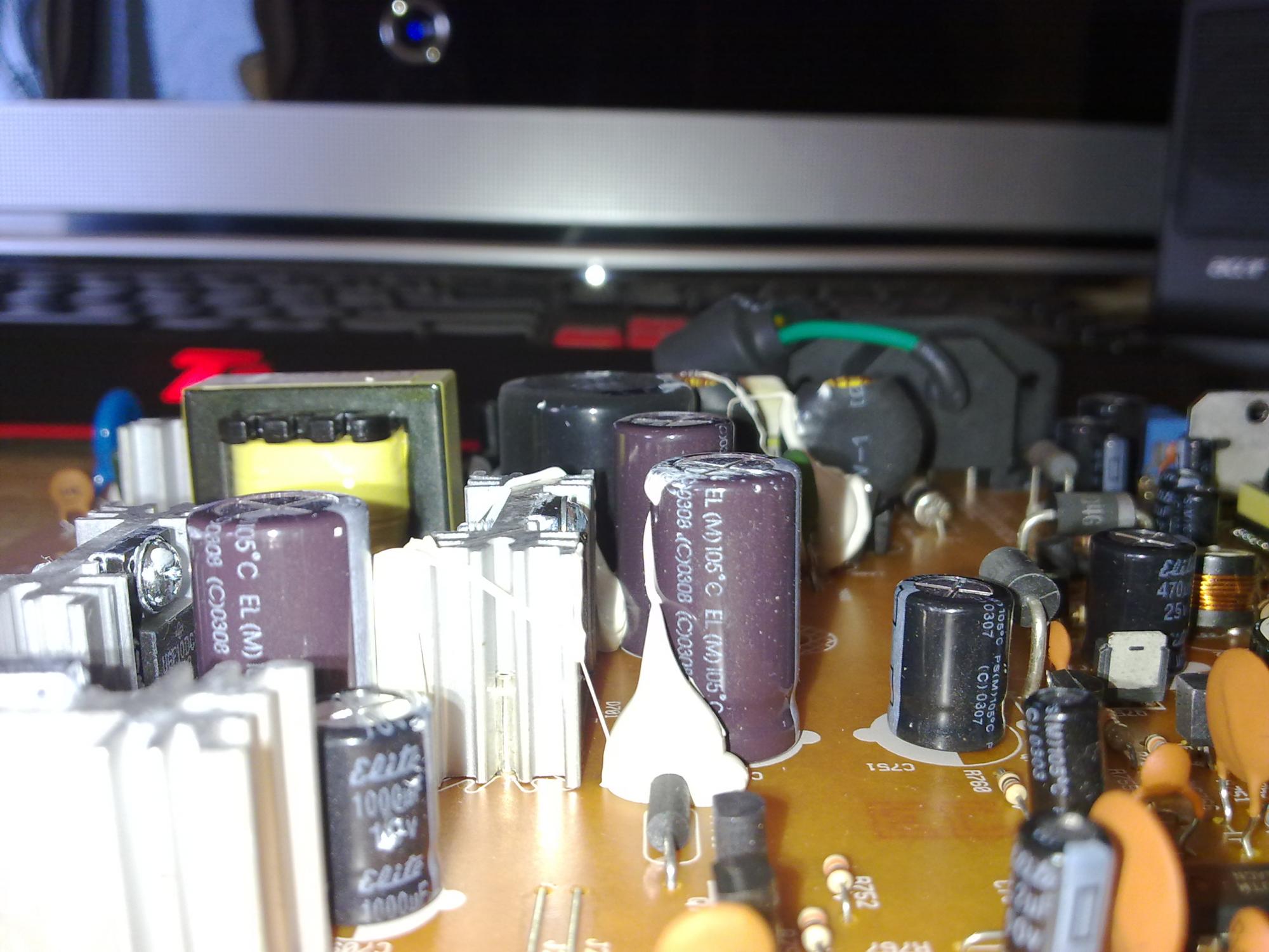

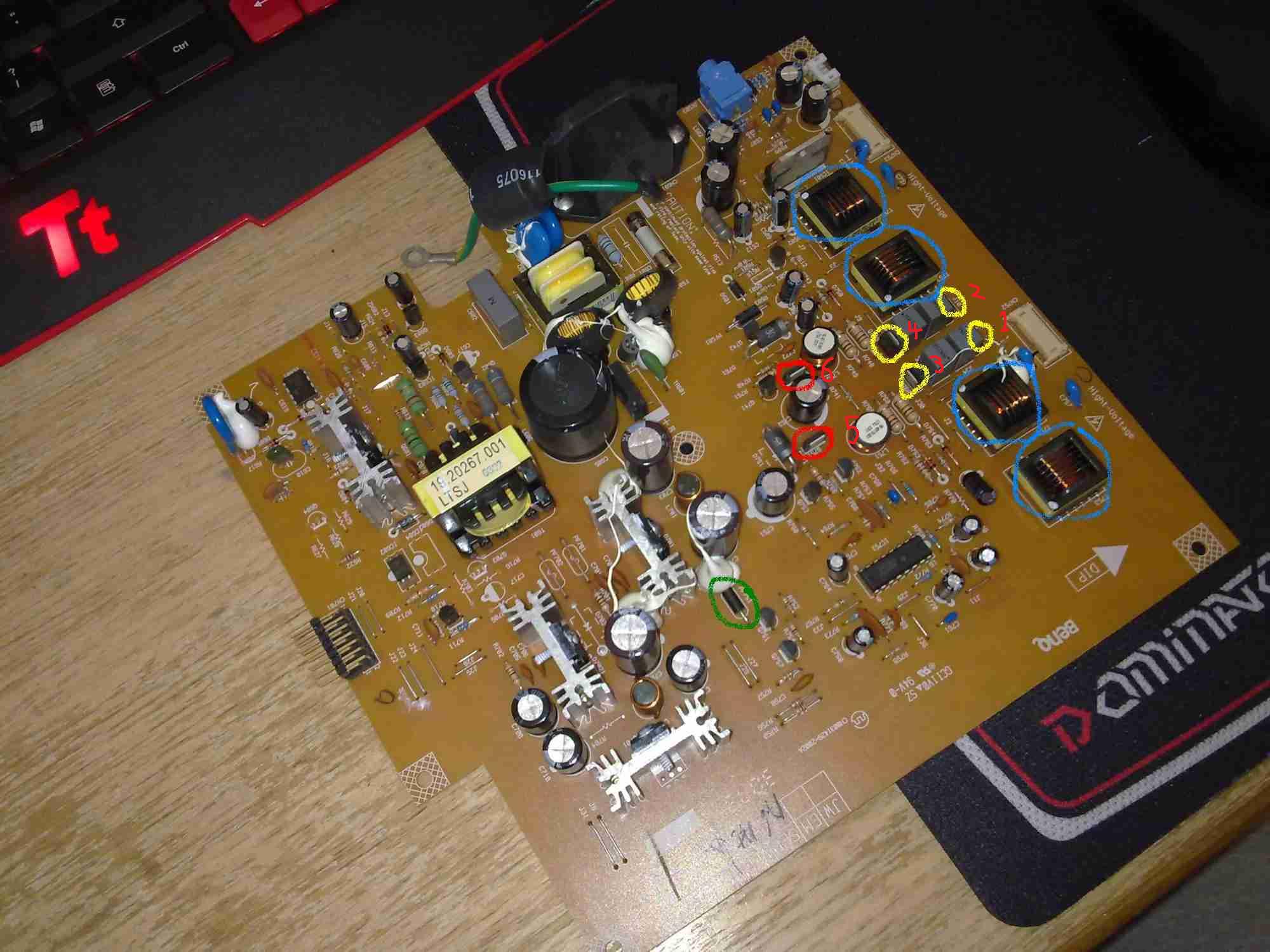

          attached is 1. the whole board
          2. just some caps, they look fine? no bulging.
          3. i'm not sure what this is? i'm a newb.
          4. not sure
          5. not sure (i just thought they looked important

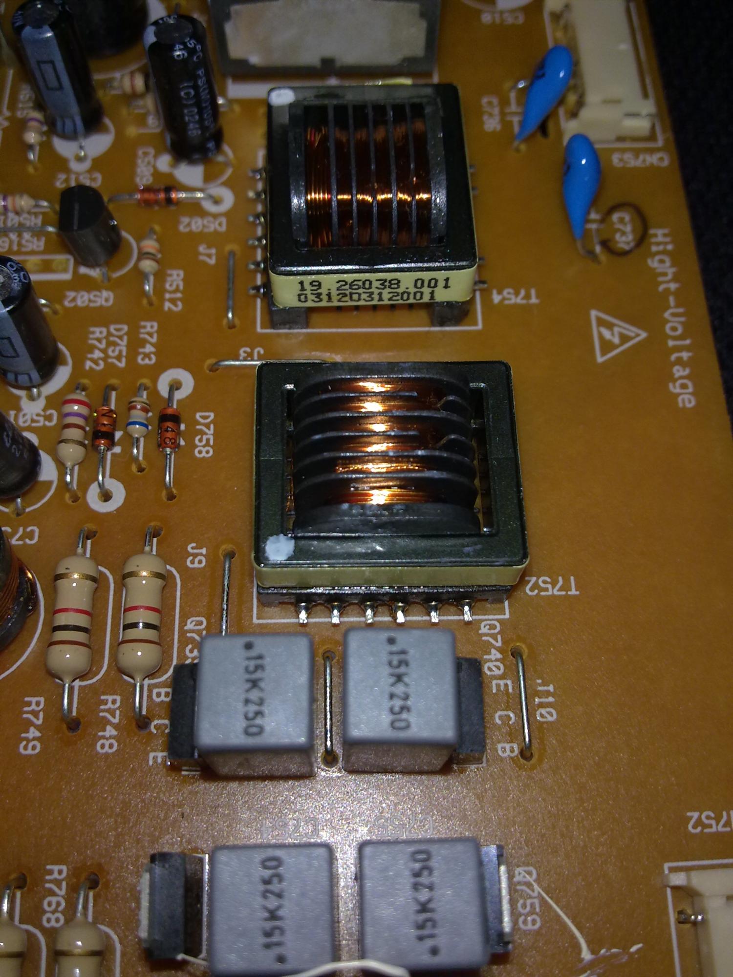

            1) We prefer photos not at an angle like your first one. Just straight top down is fine.
            2) The yellow circled components are the c5707 transistors. They have B C E marked on the board for base, collector, and emitter.
            You want to see if they are shorted. Instructions are at section #2
            https://www.badcaps.net/forum/showpo...0&postcount=13
            If you are new to using a multimeter, see the section entitled multimeter just above in the same link
            3) The red circled components are likely to be FU9024. You also want to test to see if they are shorted.
            4) The green circled component is the picofuse. It is good, but likely to blow if you do not resolder all the inverter transformer pins.
            5) The blue circled components are the inverter transformers. You MUST resolder all the pins with fresh solder otherwise you will have problems in the future.
            6) All the other things that PlainBill mentioned about 2 seconds to black are also in posts #13 and #14 at the same link above.

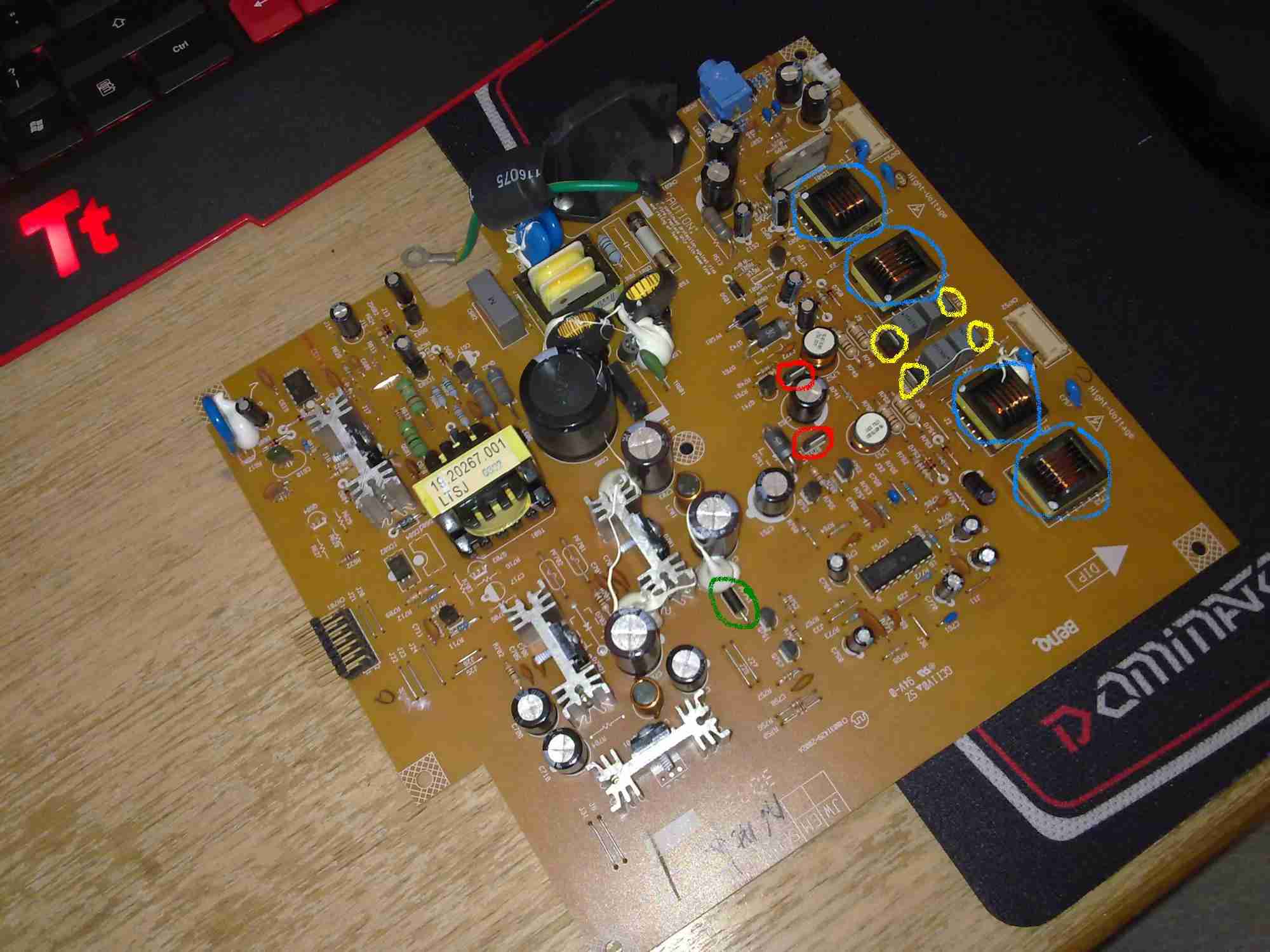

              Re: BenQ FP767 monitor goes black after 2 seconds.
              2sc5705 i have circled in red (may have 5706 on them)
              yellow should be fu9024n (confirm maybe another type)
              Both these items need testing for shorts
              green should be pico fuse (pf701 ) test
              Blue reflow solder to all transformer legs
                Poo sorry Retiredcaps beat me to it
                Almost same color scheme too
                  Half a world apart, but we almost use the same color scheme and have the exact same thought process!!

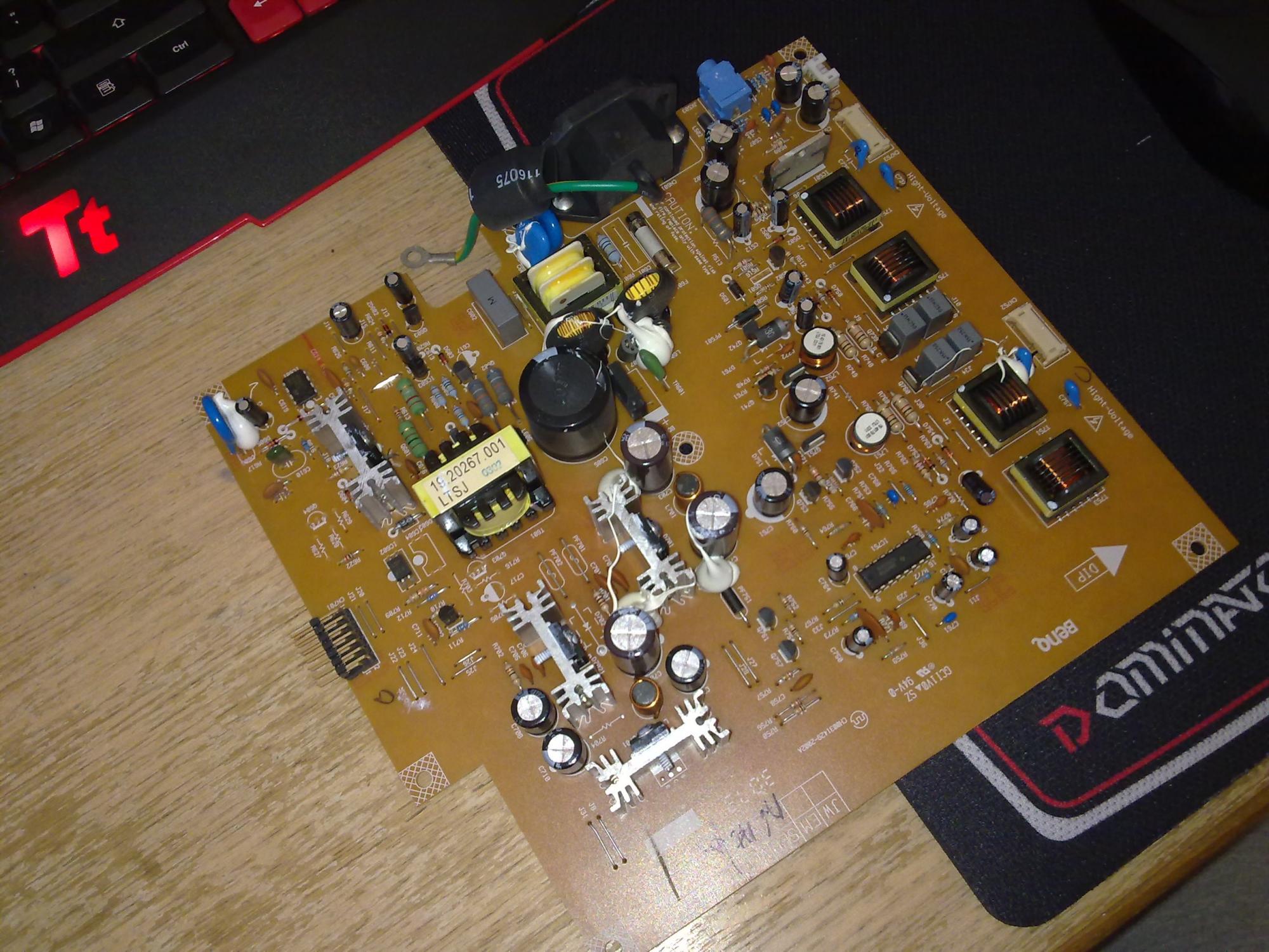

                        whoops, forgot to add the picture labeling what number capacitor i was referring too

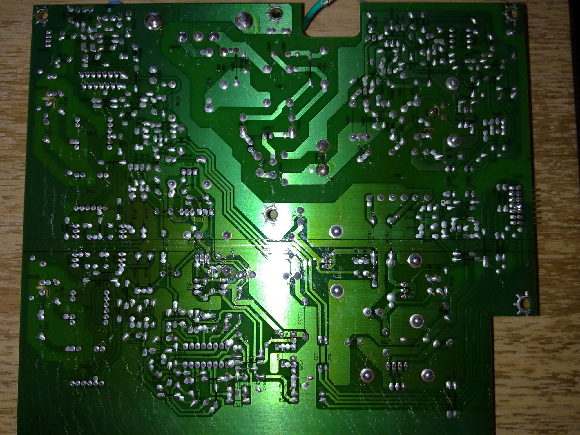

                            BTW, we will probably need a clear focused picture of the back side of the power board.
                                sorry about the reflection and the shitty image quality

                                  While the c5707s measure a bit lower than what I expected, none of the measurements show an obvious short. The fu9024s are good.
                                      On the back side, each inverter transformer has 10 pins. It isn't obvious to me from the photo which are the secondary pins.
                                      So you will have to measure all the possible combinations. This should take about 10 minutes total.
                                      See
                                      https://www.badcaps.net/forum/showpo...1&postcount=14
                                      for instructions. So you will be numbering the pins 1-10. It doesn't matter how you number the pins since all combinations will be measured.
                                      Report all readings for all transformers.
