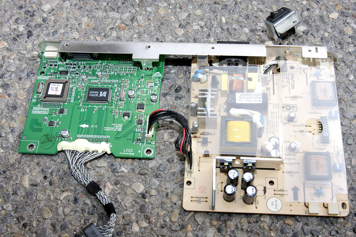

Today's special, a decent looking 19" Samsung 192N
I swapped a working 15" NEC Multisync for it.
Owner said the backlights come on but no image displayed.
I tested first, I get power led but no backlights. Hmmm.

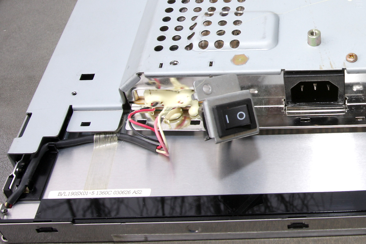

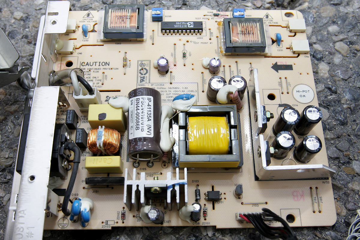

Disassembled, holy crap what a pain. CCFL connectors are covered in glue, as is the panel connector. Once I get that off and get the PS/inverter board out, it has one of those plastic protectors on it, took 3 hands and several 4 letter words to get it off.
I spot 2 slightly bloated Capxons right off the bat, otherwise nothing obvious.
There's some white crud on a SMD zener, but it wipes off and the zener looks ok.
I'm pretty sure it's gonna be more than caps, but it's gonna need at least 2.
I have the boards out of a 172n, looks very similar, so I'll have some parts including inverter transformers if needed.
I replace the 4 1000 uf caps measure the transformers, and SMD fuse, reconnect and test.
Looks good!
Will do a full recap before re-assembly.
Cap measurements:
1000 @ 25 945uf .04ohm ESR
1000 @25 960uf .03 ohm ESR
1000@10 28uf 6.6ohm ESR
1000@10 262uf 3.0ohm ESR
