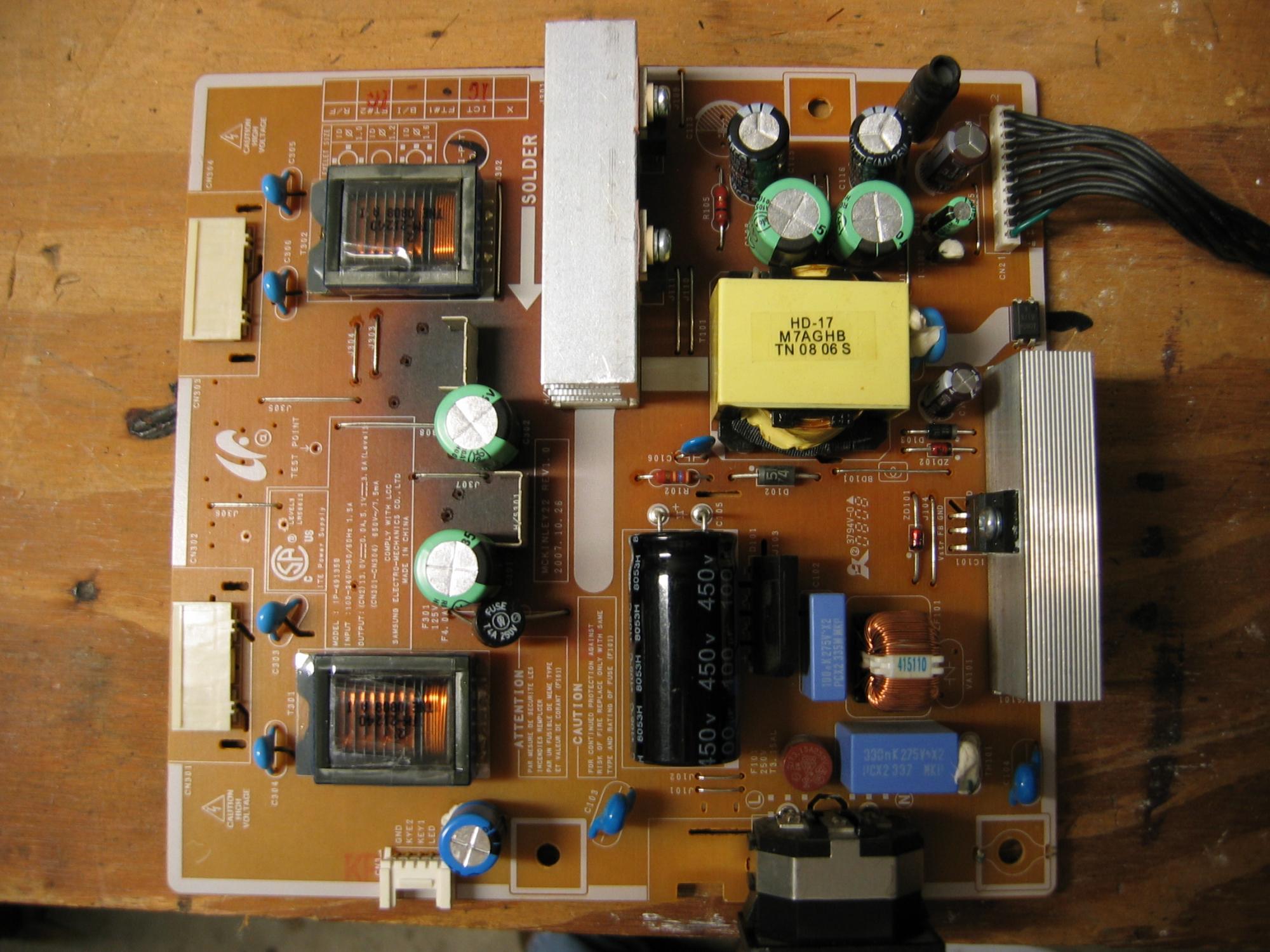

    Hi, first time post. First of all, this is an awesome forum. I've used the information here to repair several LCD monitors. However, I'm stumped on this latest one (2253bw). It has the familiar problem of coming on for a second and then going dim. I've already recapped it but there's no change in behavior. What should I check next? Transistors? Xfmrs? CCFL? I searched the forum but couldn't find a service manual or schematic. It has the SEM2006 inverter. The blue power light stays lit steady.
    The picture looks good for the second or so that it's on.
    Thanks,
    Scott

          On the component side of the power supply board there is some discoloration like something got hot. It was like that when I got it. I'll post a pic later.

            Please post some photos of the entire power board front and back per PlainBill's links above. Power boards from different suppliers are used on Samsung monitors and your voltage readings are nice, but with no photos, we're all going to spend (waste) time second guessing each other. With photos, members can direct you to test specific items.

              Best pics I could get of it...

                Okay, it looks like you're using some Lelon caps that are not the low-esr caps that are usually recommended here. Don't know the brand of the other ones that are being used. This can cause possible problems.
                Sounds like you're getting 5V because of the solid power light. And it sounds like the CCFL's are trying to light.
                At this point you might have one of the following problems:
                1) Bad CCFL lamp(s).
                2) Bad/damaged CCFL wiring from power board to CCFL lamps.
                3) Bad inverter transformer.
                4) Failed part in the CCFL error sense circuit causing the supply to shut down.
                Do you have a spare CCFL lamp or LCD panel that you can use? You have 4 CCFL lamps, with power off, connect them all except for one and substitue a known good lamp. Turn the power on and see what happens. If the one you substitute causes all lamps to light, then you've found the bad lamp. When you disconnect and reconnect the CCFL connectors, make sure you power the monitor OFF because of the HIGH VOLTAGES!
                I can't make it out on you second photo, but with power off, you will have to measure the secondary resistance of each inverter secodary. The secondary is what feeds the CCFL lamps. The difference between the two inverters should be 3% or less.

                    I substituted a good backlight in each of the 4 backlight connectors (with the remaining 3 backlights still connected) and it lit up for 2 secs in each position.
                    I removed the 2 transistors and ohmed them and they were both the same:
                    pin 1 to 2: open
                    pin 1 to 3: open
                    pin 2 to 3: 5.1 kOhms
                    From the enclosed pic it looks like one of the stm8309 ICs smoked. It's the 8 pin IC on the right.

                      Your test has effectively eliminated the CCLFs as the cause.
                      What caps did you use as replacements? jetadm123 refers to them as Lelon, I suspect they are Xicon. In either case, they are the most likely suspect. Replace them with low ESR caps such as Panasonic FR, FM, or FC series.

                        Looks like the STM8309 overheated. Should be replaced in pairs. Only place I see them is on eBay.

                          black ones -> EPCOS (a.k.a. Siemens)
                          green ones -> Lelon
                          one brown one next to the wire harness -> chemicon
                          startup cap (to the right of the yellow transformer) -> *?*
                          blue one at the bottom also looks like a lelon

                            I circled what I think are the secondary inverter transformer pins. Set your multimeter to 2000 ohms (if manual). Measure the resistance between the yellow dots. Report readings. Do the same for the red dots.

                              I got 900 ohms for both transformers.
                              Looks like I can get a pair of stm8309 ICs for $11.90 on eBay or the entire board for $24.50.

                                Those readings suggest the inverter transformer is likely okay.
