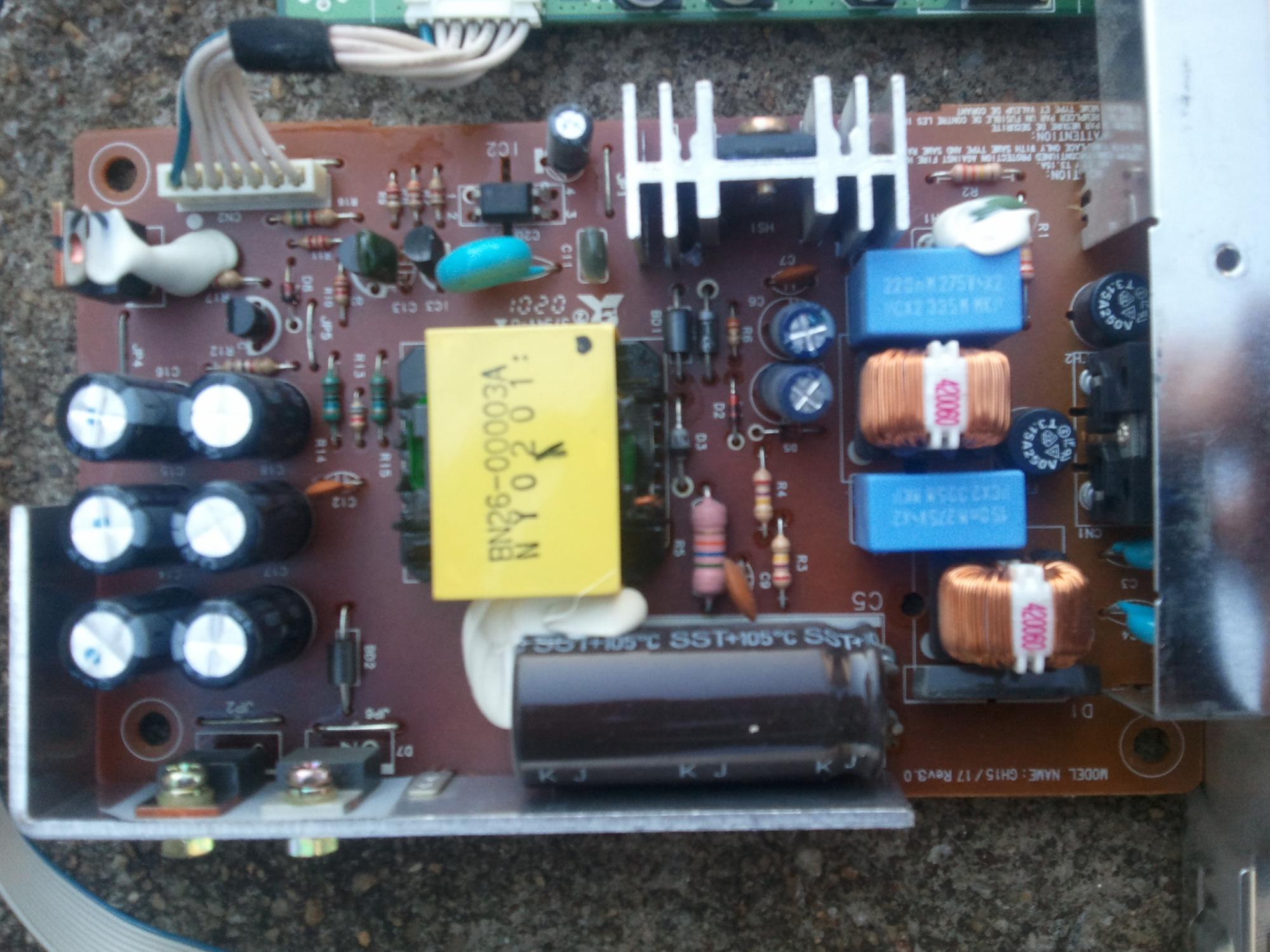

    i wont on this monitors every so often and i have never successfully repaired one. the problem i have is that it shows no activity what so ever when i plug it in. the power light doesnt flash or anything. any suggestions?

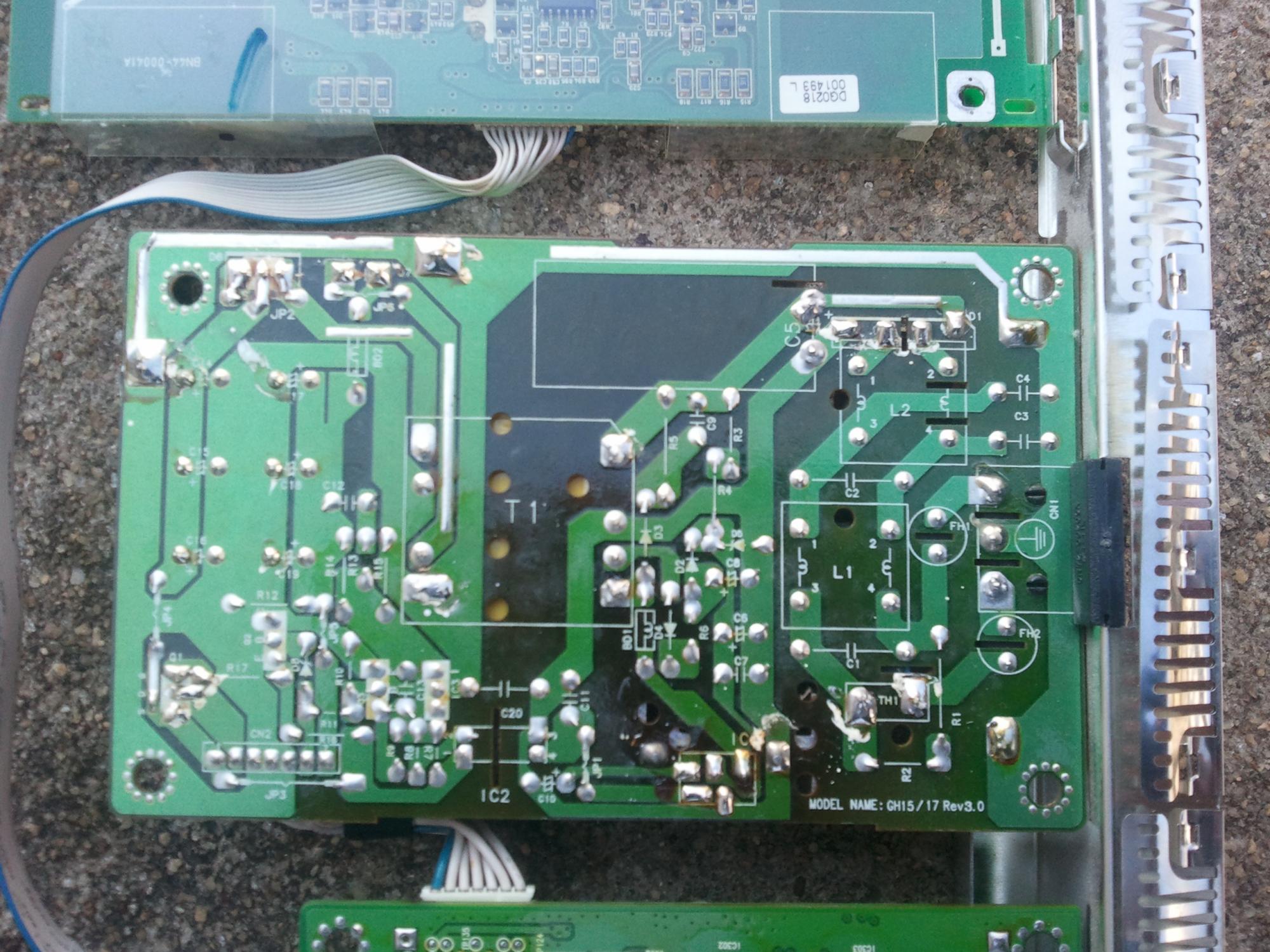

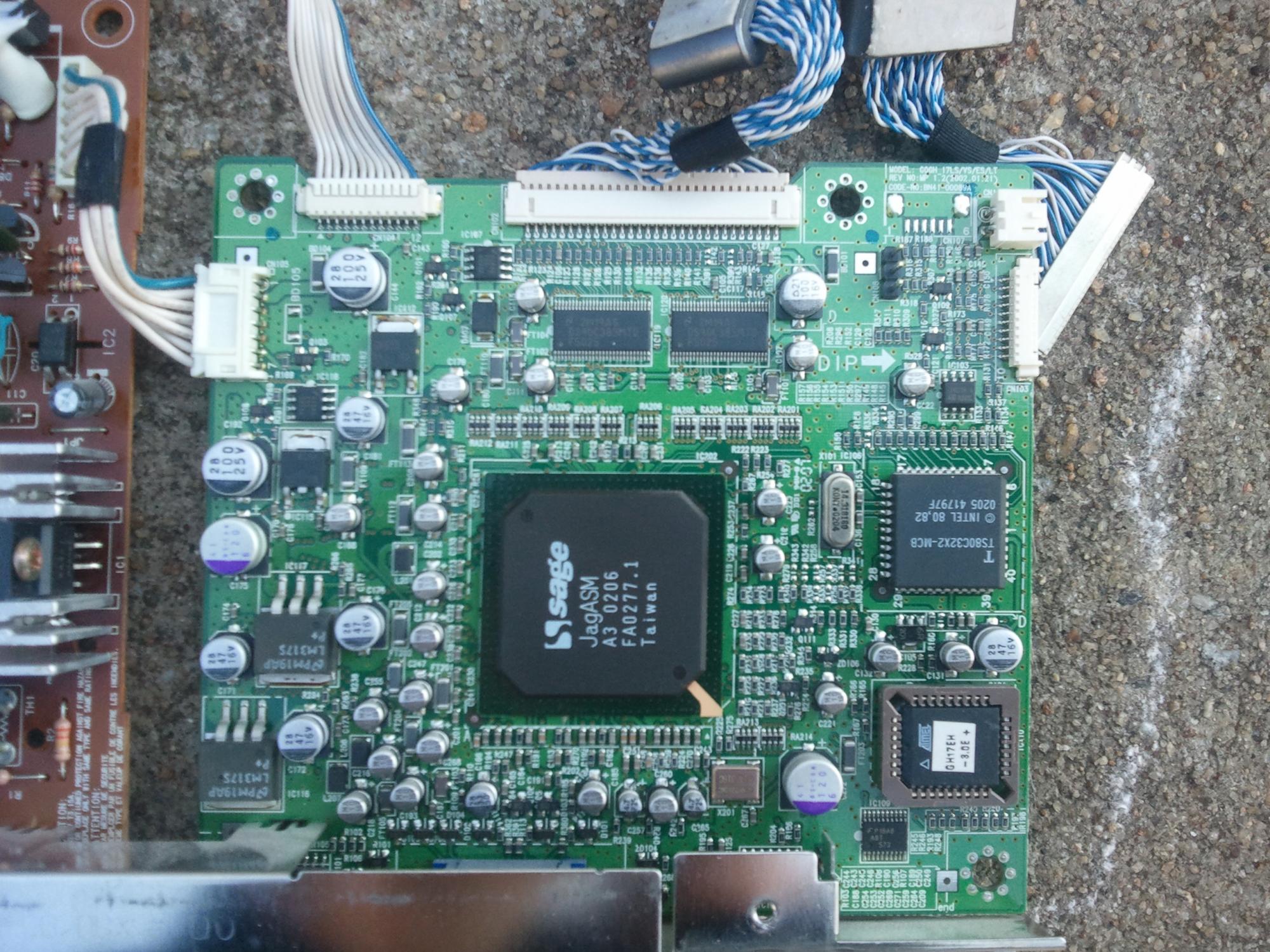

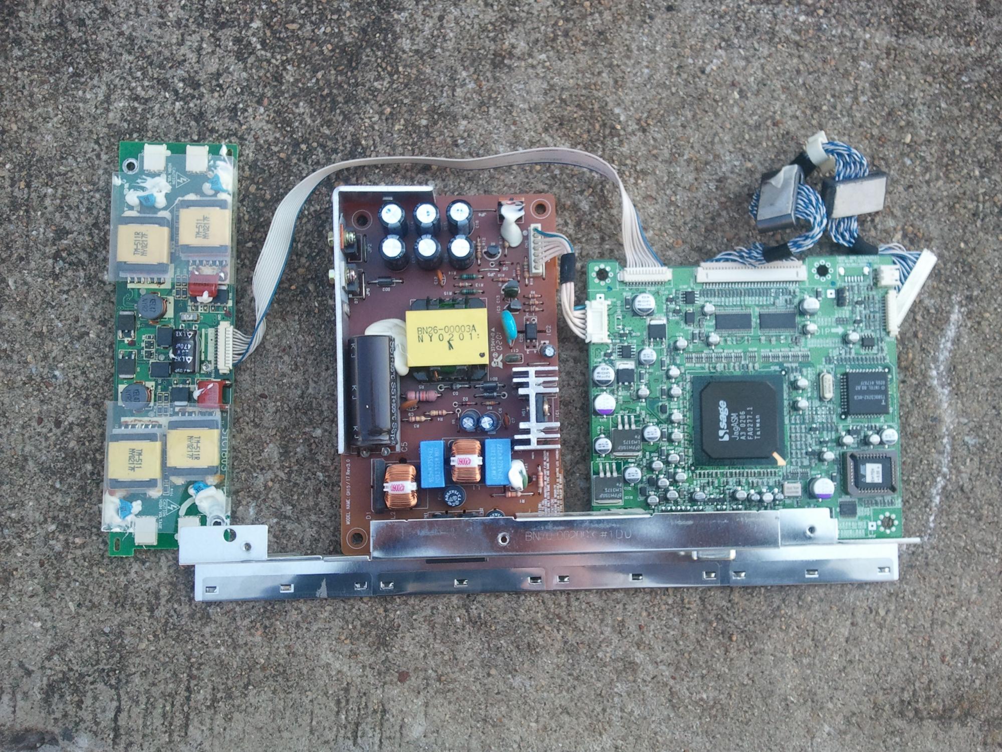

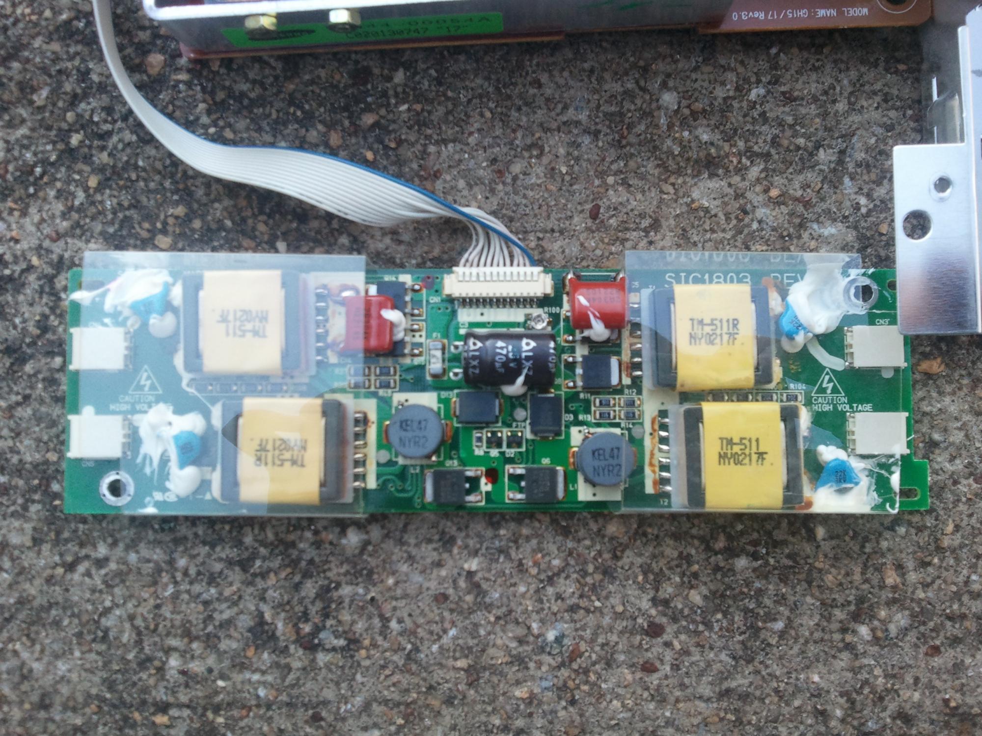

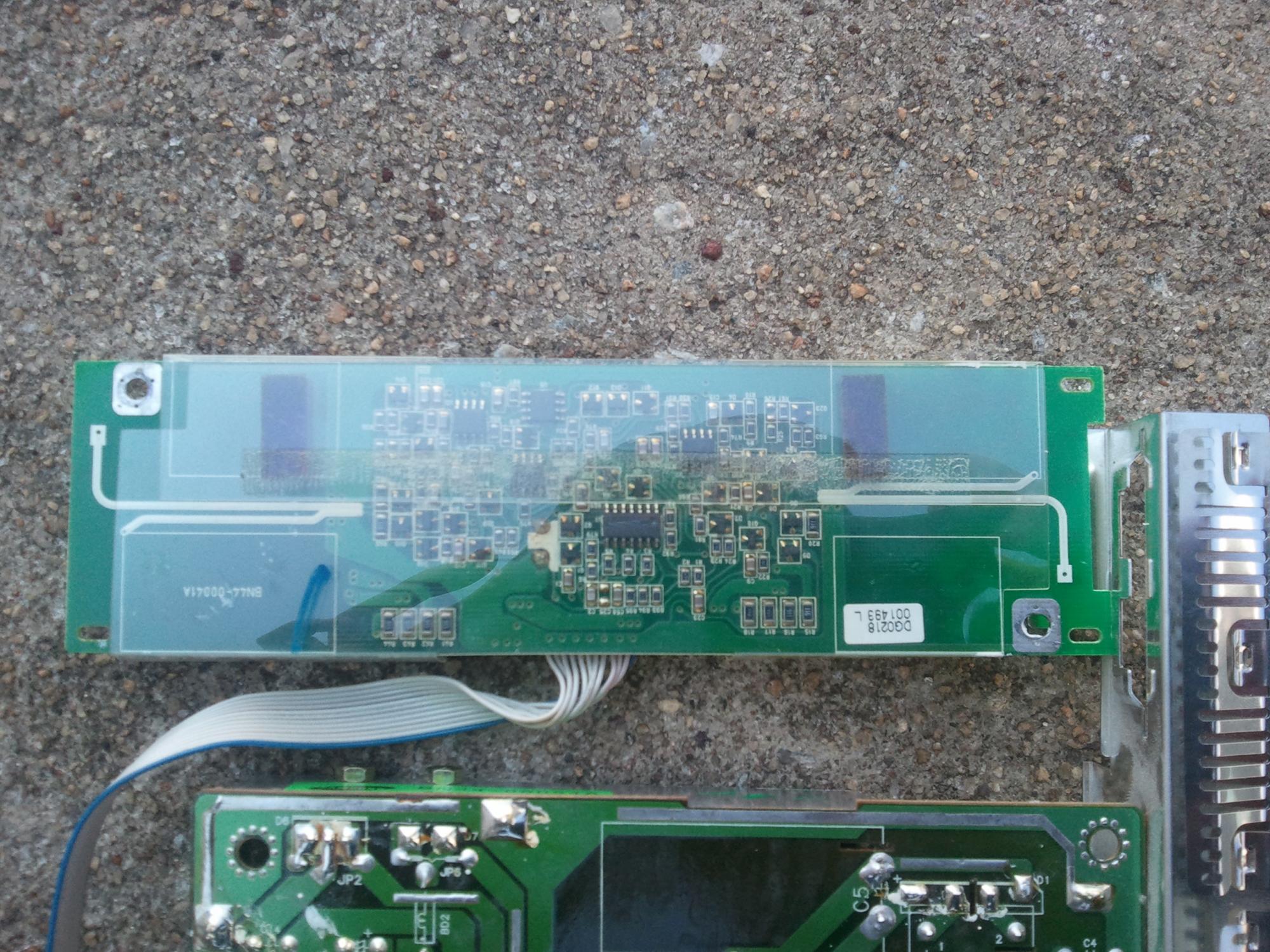

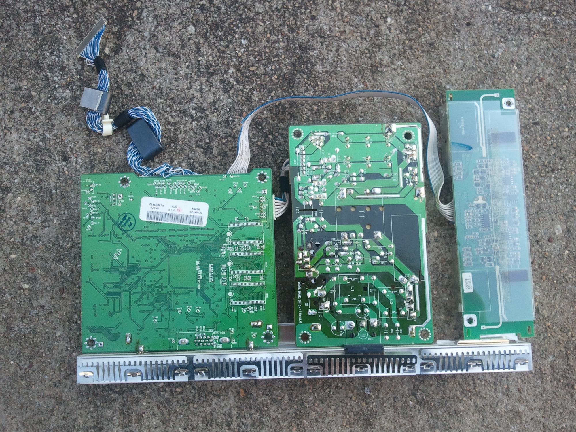

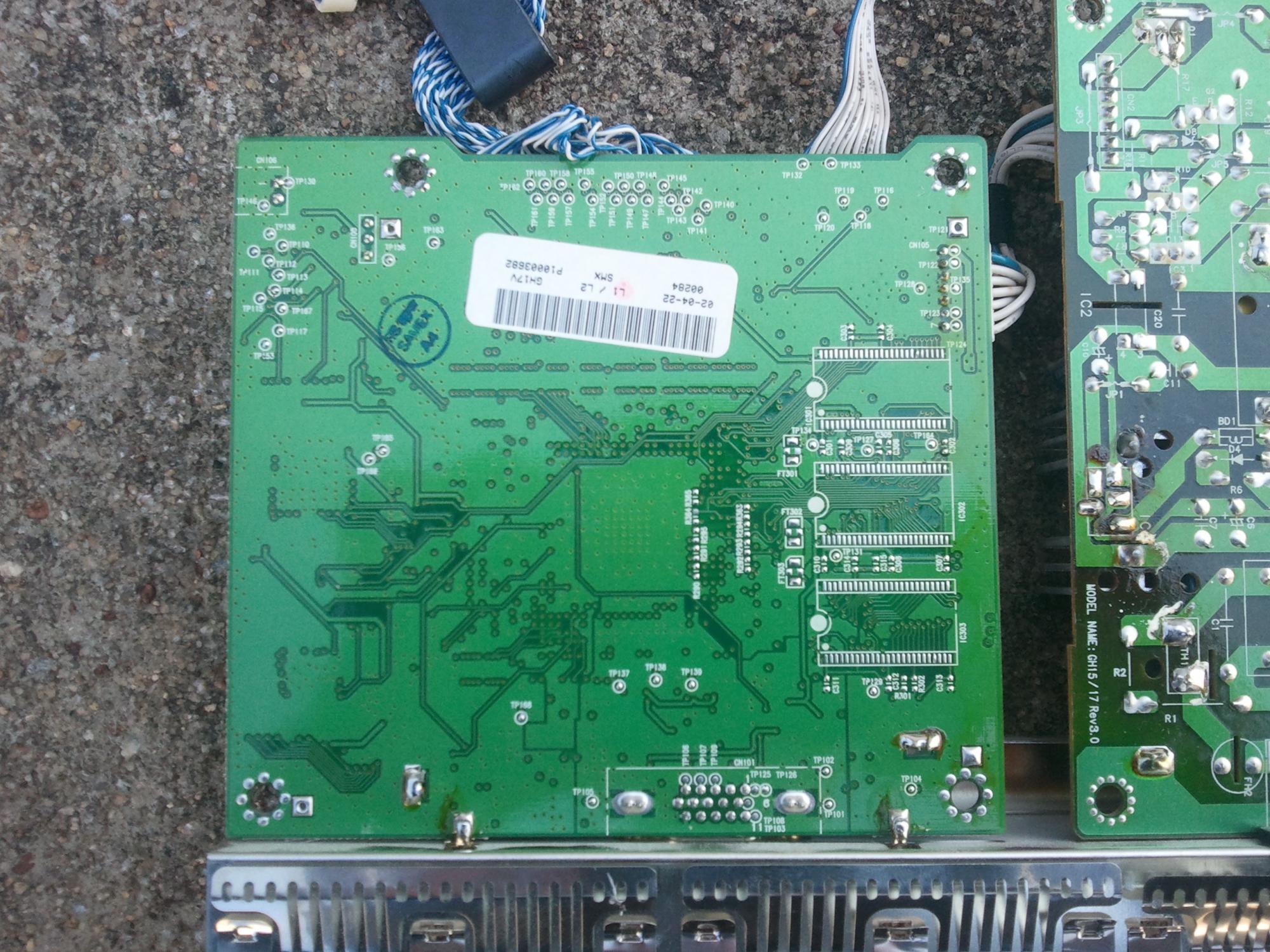

      Re: Samsung Syncmaster 171s and 151s
      these are the pictures of the 171s boards. and yes. i have a multimeter.
        That PSU Board looks very similar (if not identical) to my 151BM's one.
        Have you checked both primary fuses? (the black cylinders next to the AC socket)
        It also looks like it got pretty damn hot in there. So even if the fuses check out fine, the caps may be baked dry. if the startup cap(s) are affected (the 2 tiny ones pretty much in the center), it would prevent the PSU from starting up..
          On the power board, measure the DC voltage on all the pins on connector CN2. Post the results.
            i checked the 2 small ones with my meter and they read 7.2 uf when they were spoosedd to be 33uf. i ordered some and hopefully thatll do the job. thank you.
                he checked the small caps pretty much in the center of the 3rd pic.
                no word about the fuses..
                  Okay, that makes sense. I wasn't sure what he meant by the "the 2 small ones".
                  And for all the newbies reading, this is ANOTHER reason why we always ask for pictures of YOUR board. Scenic noticed that from the pictures that heat discolors the board pretty good. If you use generic pictures or someone else's pictures, Scenic would have never noticed that and which led to the suggestion about the small startup caps.
