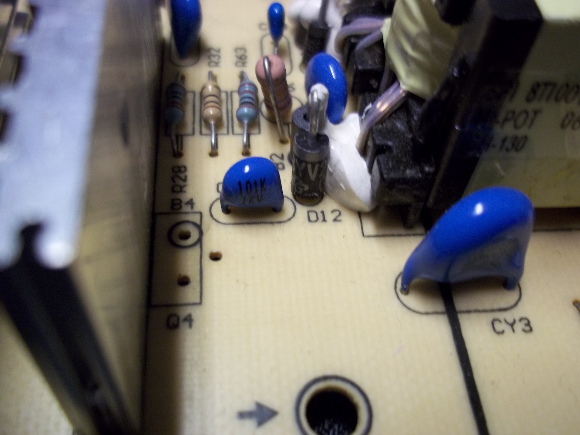

          • Mad_Professor
            A Mech Warrior
            • Feb 2011
            • 1587
            #45
            Re: Westinghouse 37" LVM37w3 troubleshooting.
            I'll buy FR for the rubycon, just in case and hold off on replacing them. FC for the small caps.
            should I replace D11 and D12 diodes?
            D11 is on the first leg of the transistor circuit after ZD1 and D12 is on the second leg of the transistor circuit. Since I'm already replacing zeners, would it be good idea to replace the D11 and D12 too? Or wait and see?
            Just want to make sure, because I don't want to pay for second shipment if I don't need too.
            d12 is BYV2, but glue is blocking the rest, it's hard to remove, below the 2 is a zero.

              #46
              Use the diode test function on your DMM. Test the diode by touching the leads to the ends of the diode - red to the banded end. Now reverse them - black to the banded end. If you get a reading of less than 1 (typically .5) when the black lead is on the banded end and a reading of OL when the red lead is on the banded end, the diode is probably good. If it reads 0 in both directions you will have to remove the diode and retest. If they test good, there is no need to replace them.
              PlainBill

                #47
                D12 tested ok, D11 on the hand is getting interference from being in circuit. I could remove it but it's glass diode that is glued. I could destroy it during the extraction process.
                In one of previous picture band color is Black followed by Pink. If I look at it, I can't tell if it's brown or pink. So how can I identify this?

                  #48
                  What resistance do you read across D11? if it's 120 ohms, the diode is probably good. It's probably a high speed switching diode like a 1N4148. I'll do some research.
                  Awww, crap!!! I just spent 20 minutes searching various schematics for a possible ID of that diode. Most of them didn't show a resistor-diode pair like that. Those that did either didn't ID it, didn't have a parts list, or said 'not used'. Then I FINALLY did find one. It's a 1N4148
                  Digikey 1N4148WXTPMSCT-ND should work for you.
                  PlainBill

                    #49
                    .120 both ways, not sure if it suppose to be like that since it is in parallel with the resistor above.
