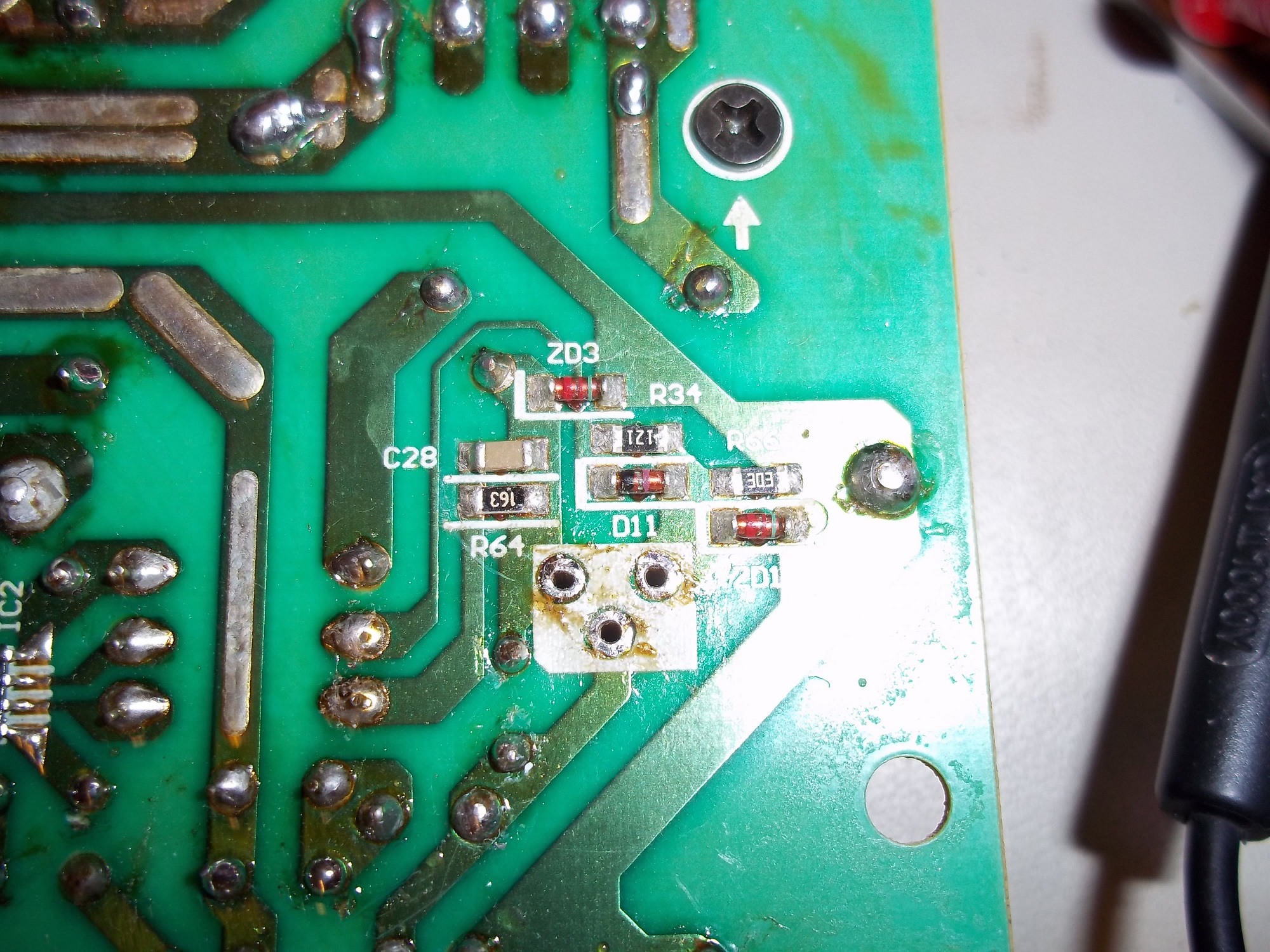

    That certainly sounds like ZD1/ZD3 are shorted. The reading you got on ZD4 (380 ohms) is reasonable.
    PlainBill
    I think R66 which is 303 resistor is shorted because another 303 at R9 read exactly 303 ohms on 2k setting. Also R34 is shorted too but no matching 121 resistor. 163 is ok, read 15.7 on the 20k setting.
    It seems to me everything on the grounded side was damaged. so ZD3, R34, R66, and ZD1 was damaged but D11, R64, and C28 survived. Even the CY3 polymer cap on the other side survived.
    Wonders if this board is worth saving?

      Note that ZD1 and R66 are in parallel. If ZD1 is shorted R66 will also read shorted. Also, a resistor labeled 303 is not a 303 ohm resistor, it's a 30Kohm resistor. The fact that one somewhere else on the board reads 303 ohms is coincidence.
      There are a couple of issues here.
      First, in my opinion you are fixating on testing the components while ignoring the circuit.
      Second, you seem to be unfamiliar with the standards for labeling parts. A 303 ohm resistor, for example would be labeled 301.
      Third, there exists a probability tree for likelyhood of damage. Transistors, diodes and zener diodes are likely to short. Resistors are unlikely to short, they might change in value or go open. Most capacitors will give clear physical signs if they short.

        "In circuit" readings can be misleading because of surrounding components. If one component is shorted, it can affect readings in the surrounding area.
        The only way to know for sure is to desolder them and measure them "out of circuit".
        edit: I suggest waiting to see what PlainBill suggests before desoldering these components.

          OK, I've reviewed the thread. The drop of sweat on the power FET could have done a fair amount of damage.
          As retiredcaps said, remove any apparently shorted components. At a guess, ZD1 is clamping the gate voltage on the FET. If ZD1 shorts the SMPS won't operate. There could be other damage.
          If you are going to continue, Chip-Quik would be useful. It allows removing SMD components easily.
          As far as replacing the power supply, I have mixed feelings. Every day I see TVs listed on Craigslist with the comment 'needs a power supply' or 'probably just a fuse' or 'I'm sure it's something simple'. In most cases, it's something more involved.
          Have you checked for availability of the power supply? If I had the TV in my hands I would repair the power supply, but I have the tools, test equipment, and experience to do that. In your case, replacement may be the best option.

                      What is the part number for ZD1? OK, let's do a little circuit analysis. ZD1 limits the maximum gate voltage, ZD3 appears to do the same for the source voltage. By the datasheet for Q4, the FET switches on fully at a gate voltage above 5-6 volts, and the gate can tolerate any voltage up to 30V.
                      Googling, I found this page. Using the color codes you mentioned earlier, that says the zeners are either 13 or 16 Volt. They appear to be a match for Rohm RLZ series (500 mw, glass package). The closest match I could find quickly is KDZTR13BCT-ND from Digikey at $.41 each. That still leaves the issue of the FET itself. By the way, what is the part number of IC2 (the SMPS controller)?

                        ZD1 component has no writing on it unless it's on the bottom side of the zener, which I would have to remove and look. I can do it but not today, I have to help a friend put the lower control arm back on his 1970 olds 98. Also I ran out of desoldering braid and waiting patiently for UPS to deliver my order from digikey.
                        Also the band colors are RED RED GREEN.
                        The chip at ic2 is inorder, topdown.
                        EA1532A <-- TEA1532AT GreenChipII SMPS control IC
                        M1E002
                        inS5511 <--- this last one is bit hard to read not engraved as well as others, if I shine the light from the side it could be S55, SSS, or 555. If I shine it directly down it shows 355, or G55, hard to determine if "S" are "5"

                          Sorry, I wasn't clear. The identity of ZD1/ZD3 was the question I was attempting to answer. There are three approaches - look at the specs on the part being driven (Q4), which placed the maximum voltage of ZD1 at 30 Volts, try to identify the value by interpreting the color bands (Red, Red, Green is 15 volts), or look at the specs on the driving circuit. Strangely enough, the application note for IC2 (TEA1532A) does not indicate any such zener is required!! Still, I'm comfortable with the results.

                              I'd remove both ZD1 and ZD3 and verify they are shorted. If they are, the next step would be to replace them. After that I think I would replace the input fuse with a 40 watt light bulb, disconnect the output cables, and apply power. If everything is working correctly the light bulb will glow briefly and you will see the proper voltage (5V) out of the standby supply. At that point, reinstall the fuse, hook up the output cables, and start testing.
                              Usually on one of the output connectors is a pin labeled On/Off or PS_ON, or something like that. Once the standby supply is working check the voltage on that pin. If it is 3 volts or higher, the main board is trying to turn on the supply.

                                SO I destroyed ZD1 with my pliers, I squeezed little too hard and crush it, it was glued. ZD3 on other hand I was successful in the extraction, but testing it with my meter, I get a reading before going no continuity on *started low* the highest ohm setting. So that leaves the Q4 and D11 and ZD1.
                                I think I'm going to replace both zeners, since it looks like I either removed the paint or fracture ZD3, because some of it is still glued to the board except I have the whole ZD3 intact including contact end points. This thing is tiny. Would have chip quick work better?
                                The 40 watt bulb sounds OLD SCHOOL!
                                But how is a 40watt bulb going to act as a fuse? I assume it suppose to be indicator that circuit is complete? I assume incandescent bulb is needed?
                                I have screw in incandescent socket, an electrical box and some 14awg solid copper wire, all I need is some alligator clips and I would have a safe way of attaching it to the input fuse holders.

                                  There are various methods for removing SMD components. I've see a variety of heated tweezers, special tips for soldering irons, hot air rework stations, etc. The best seems to be a hot air 'wand' with various tips to match the components. The station runs over $100, tips run about $5. This can represent a major investment for a hobbyist, but is reasonable for someone doing this professionally.
                                  Chip-Quick is a low melt alloy (Woods metal) in wire form. It blends with the solder, as a result solder at both ends of the part stays molten, making removing the part easy. It has two chief disadvantages. 1. It is somewhat messy; you have to remove the left over Chip-Quick with solder braid before installing the new component. 2. It is expensive, a small coil costs $15. Fortunately that can last years.
                                  The point of using a light bulb is it represents a fairly high resistance on the AC line. Few things are quite as disconcerting as spending several hours troubleshooting a power supply, being certain you have found the problem, replacing the defective parts, then watching your work go up in smoke when you plug in the power cord. I speak from experience. A light bulb will limit the current. If the bulb glow brightly for a fraction of a second, then gets dimmer there is an excellent chance it is working. Voltage measurements will confirm that. If it continues to glow brightly, at least you can make voltage measurements to locate the problem. I've been known to use a variac, a light bulb, and an isolation transformer when I don't have any confidence that I have identified the problem. I've noticed when I do this the item decides to cooperate and work properly. Crossing my fingers and just plugging in the power cord sometimes results in the odor of burnt plastic.
