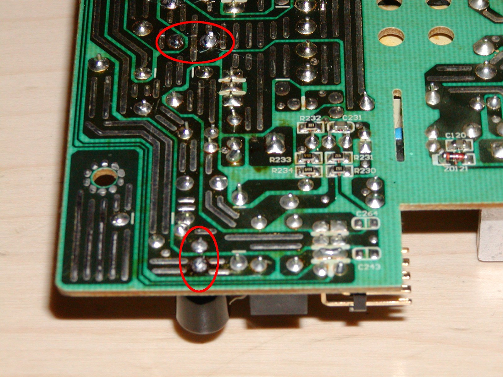

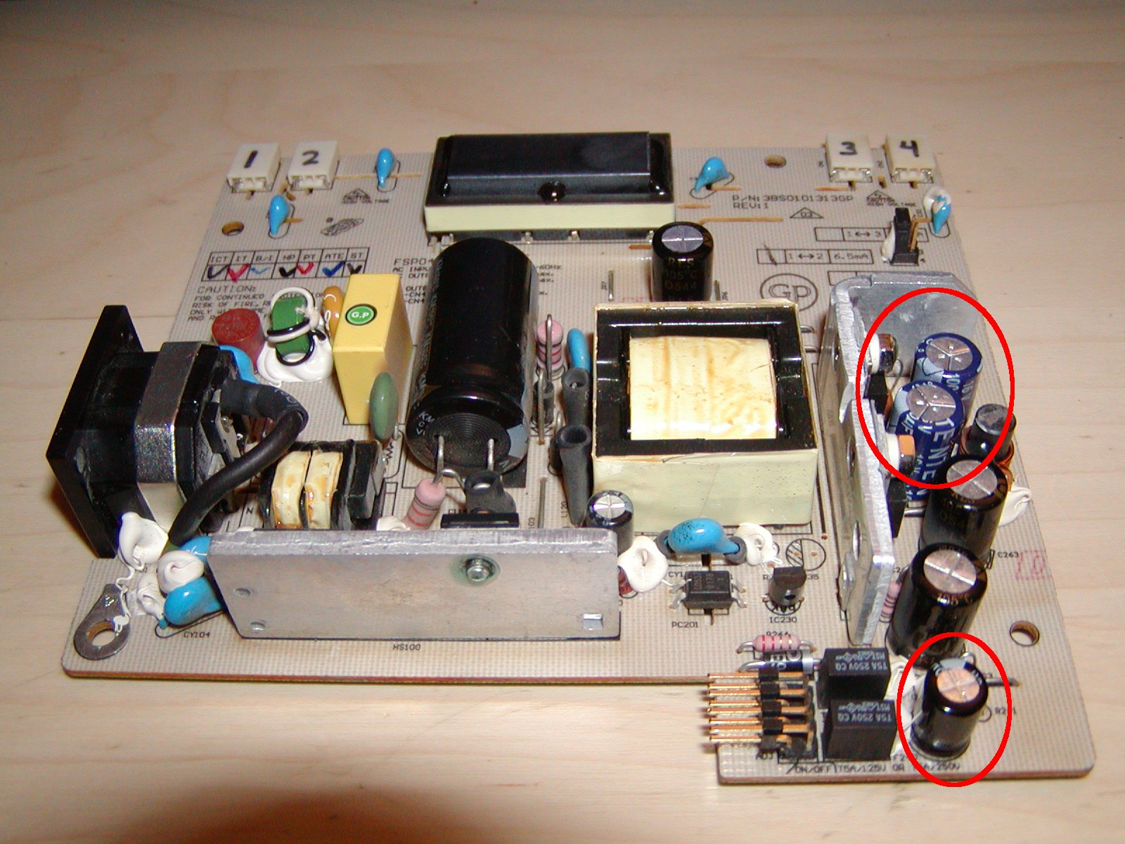

Replaced bulging caps, and pop... nothing
  • Trinite
    replied
    Re: Replaced bulging caps, and pop... nothing
    Show us a picture of the switchers and the diodes. Those are the other things that tend to go "pop". Also a complete pic of the underside of the board would help too, as there are a lot of SMD components on that side.
    Leave a comment:
  • Karstedt
    replied
    Re: Replaced bulging caps, and pop... nothing
    Now with pics of my masterless work. I circled the new caps, and the only joint that rally concerns me is the bottom one with the slight scorching around it (that was there before I got to it). I struggled with that joint.
    Leave a comment:
  • Karstedt
    started a topic Replaced bulging caps, and pop... nothing
    Replaced bulging caps, and pop... nothing
    I have one of those va912b's with a bad power supply. I replaced 3 of the caps that were bulging, and when I plugged it pack in, I heard a pop (not an exploding cap) and nothing happened. Did I fry it with a bad joint or something? Or should I just replace the other caps too (except the big one).
    by momaka
    03-15-2023, 10:17 PM
  • zlr8r
    HP Probook 640 G5 - replaced blown components, getting power led, fan full, 5-flashes on CAPS Lock and NUM lock, black screen
    by zlr8r
    Hey guys, bit stumped with this laptop after replacing 2 blown components i.e., MP86493, MP2979A.
    To begin with, this laptop was dead-dead.
    Now with replaced (visibly) blown components, i do get some progress; after connecting battery or main cable;
    • am getting white power led
    • 5-long-flashes on CAPS Lock and NUM lock
    • then, fan full speed
    • CPU heats up some (smaller die PCH, does not)
    • always constant black screen no matter what's tried
    • no USB recognition
    • no HDMI output
    this is as far as I can get with it and not sure where to inspect next ?
    I tried...
    03-27-2024, 03:13 PM
  • cmlewis89
    LG 47LB5DF blown power supply board
    by cmlewis89
    Hi folks,
    I'm new to this forum. So my trusty 17-year-old LG 47" LCD recently died. As I was booting it up, I heard a hum followed by a loud bang, sounds of pieces flying around, and loss of power to the unit. Inspecting the PSU, I saw two obvious problems: a blown thermistor (bang + flung pieces) and a visibly bulging main cap. Inspecting as many components as I could with my Fluke MM, I diagnosed that the following components on the "hot side" of the board were also bad: one of the 2 main MOSFETs, main 8A fuse, small cap (25V 47uF) connected to main caps, and a blown...
    09-03-2024, 07:50 PM
  • bcstedt
    LG 42LB5D, 42LB5DF-UL, 2008-01, Power On Issue, Replaced PS Caps
    by bcstedt
    LG 42LB5D (42LB5DF-UL) from 2008-01, unit is in good shape and no obvious heat damage or cracked solder on the boards.
    Problem:
    On first power-up the power LED flashes green about 18x and then stays solid. No backlight or image is present. Click power button, wait 10s for a click and the LED turns red. Wait 1-2s and hit power again and maybe it'll power up fully after 6 green flashes. If it doesn't light up on the sixth flash then the cycle repeats.
    It seems that if the mainboard power is left on for a few minutes (solid green power, no backlight, no image)...
    01-18-2024, 01:03 PM
  • eryjus
    by eryjus
    05-10-2023, 11:21 AM
