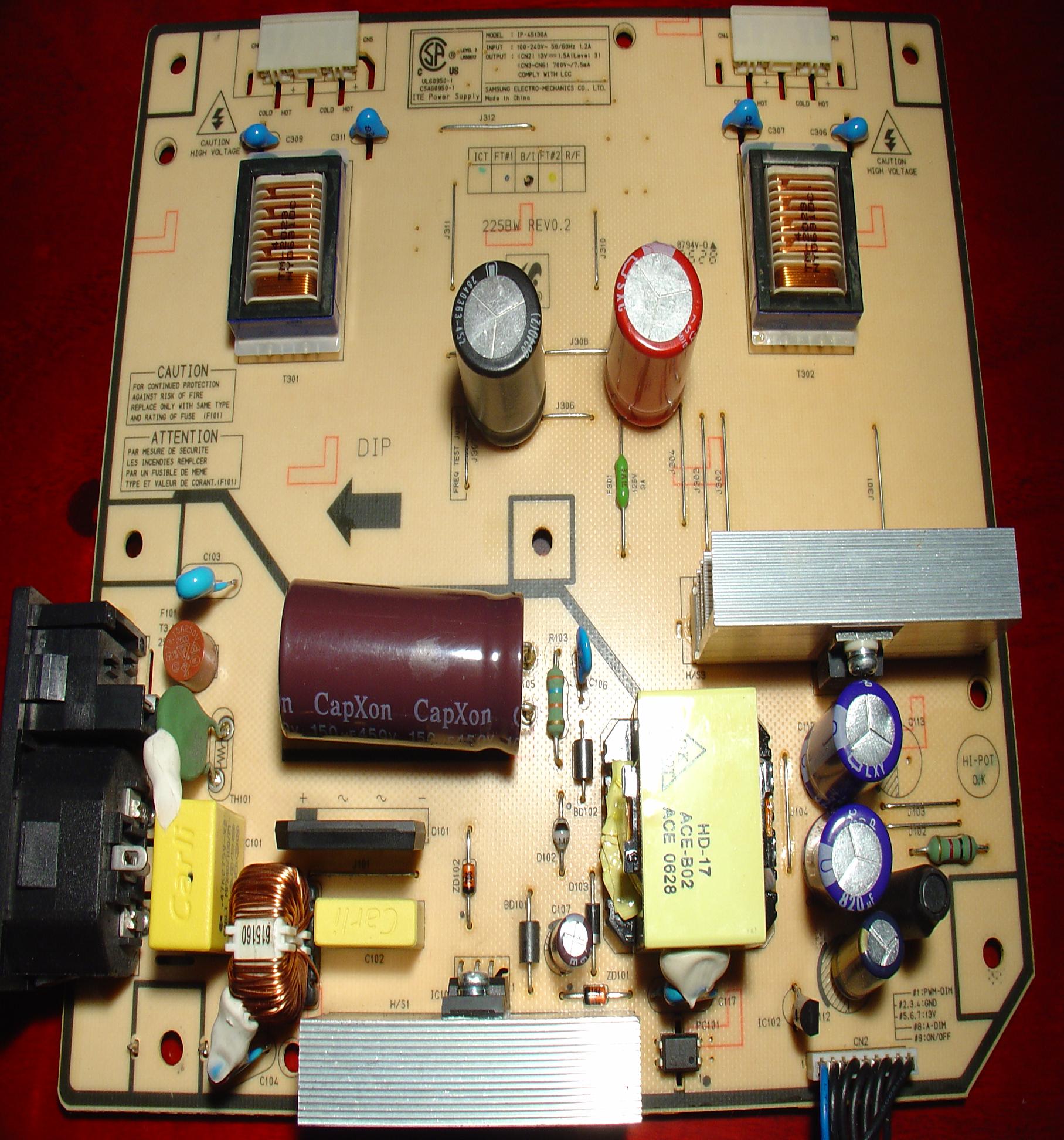

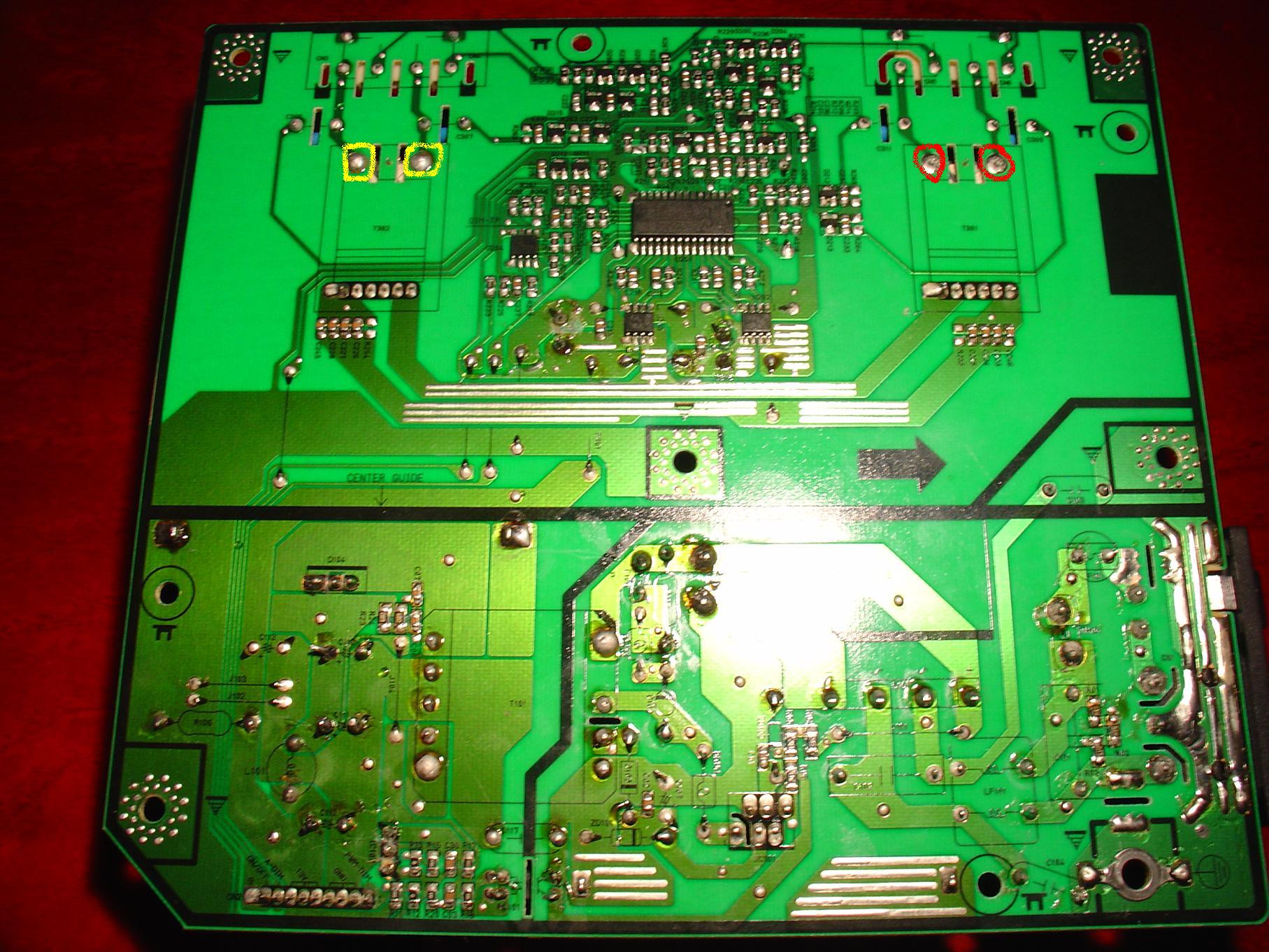

    so i have read through this post:
    https://www.badcaps.net/forum/showth...230#post144230
    and hope that my problem is a bit different since i have already replaced the big three caps
    the Monitor will turn on but will turn off within 5 mins.
    if you can help me with part numbers for the rest of the caps or any other suggestions, it would be much appreciated
    thanks so much in advance

    Re: Samsung Syncmaster 225BW
    1) We always ask people to post pictures of their own monitors because it is not uncommon for manufacturers to make revisions or even complete board changes and use the same model number. Even the smallest revision makes a huge difference.
    2) Post pictures using the manage attachments feature and please do not post pictures inline as they slow down the loading of pages.
    3) For best picture quality and clarity take your boards to a window on a sunny day, turn flash off, and use macro mode. Take a top down view of all your boards (front and back). Make sure the photo is legible so that we can read the PCB printing clearly. A shutter speed of 1/125 or faster will produce nice clear focused pictures. Try to get a photo that is 2000x2000 resolution or as close as possible.
    4) Here is an example of the pictures we want.
    https://www.badcaps.net/forum/showpo...94&postcount=1

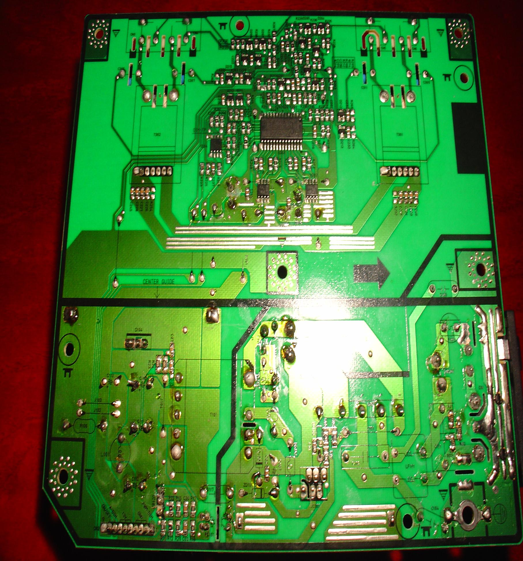

      thanks so much for your help

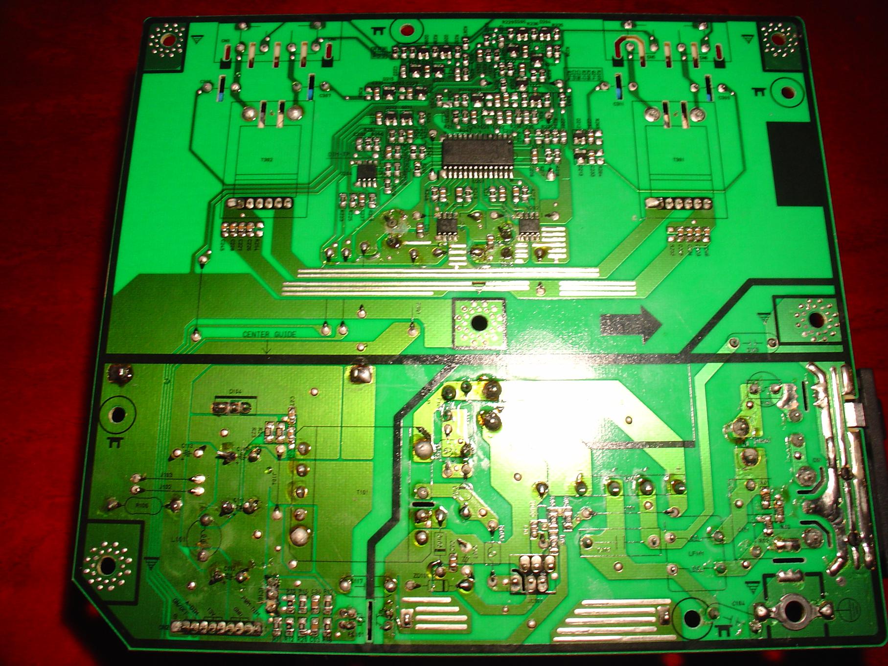

      i uploaded the best pic of a few i took of the back side and if a better one needs to be taken, will do that asap

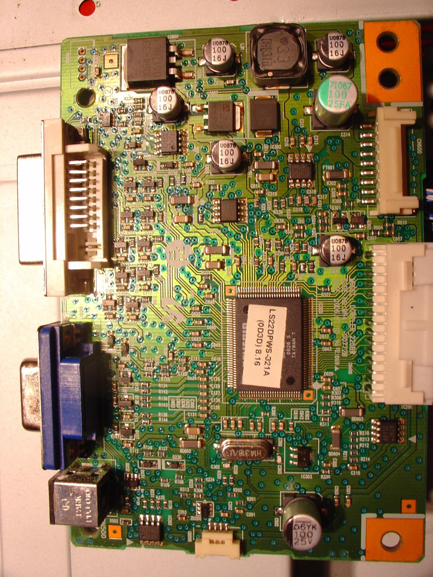

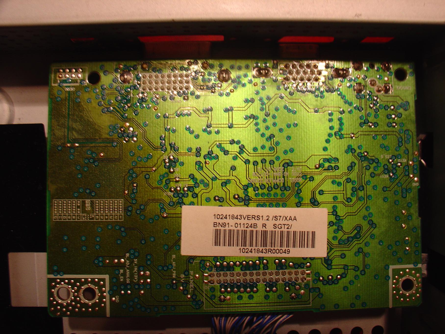

        We will need a picture of the logic board as well.
        Does the lcd stay on loger than 5 min if the back cover is off?
        Do you have a multimeter?
          I don't want to sound this like I am beating this to death, but double check the soldering on the capacitors you have installed. Gently wiggle or rock the capacitors back and forth watch for any movement on their solder pads.
          If you can try to take your pictures without a flash,It causes to much glare. The shape of the capacitors is interesting!
          I guess it's your photo editor causing it?
            I noticed you replaced them with UCC "SXC", "LXY" and a Panasonic. Did you keep the old capacitors? We need to see if you used the proper replacements. I can tell you right away that "SXC" is probably some old general purpose capacitor and is inadequate for this application.
            Also, snap a picture of the logic board.

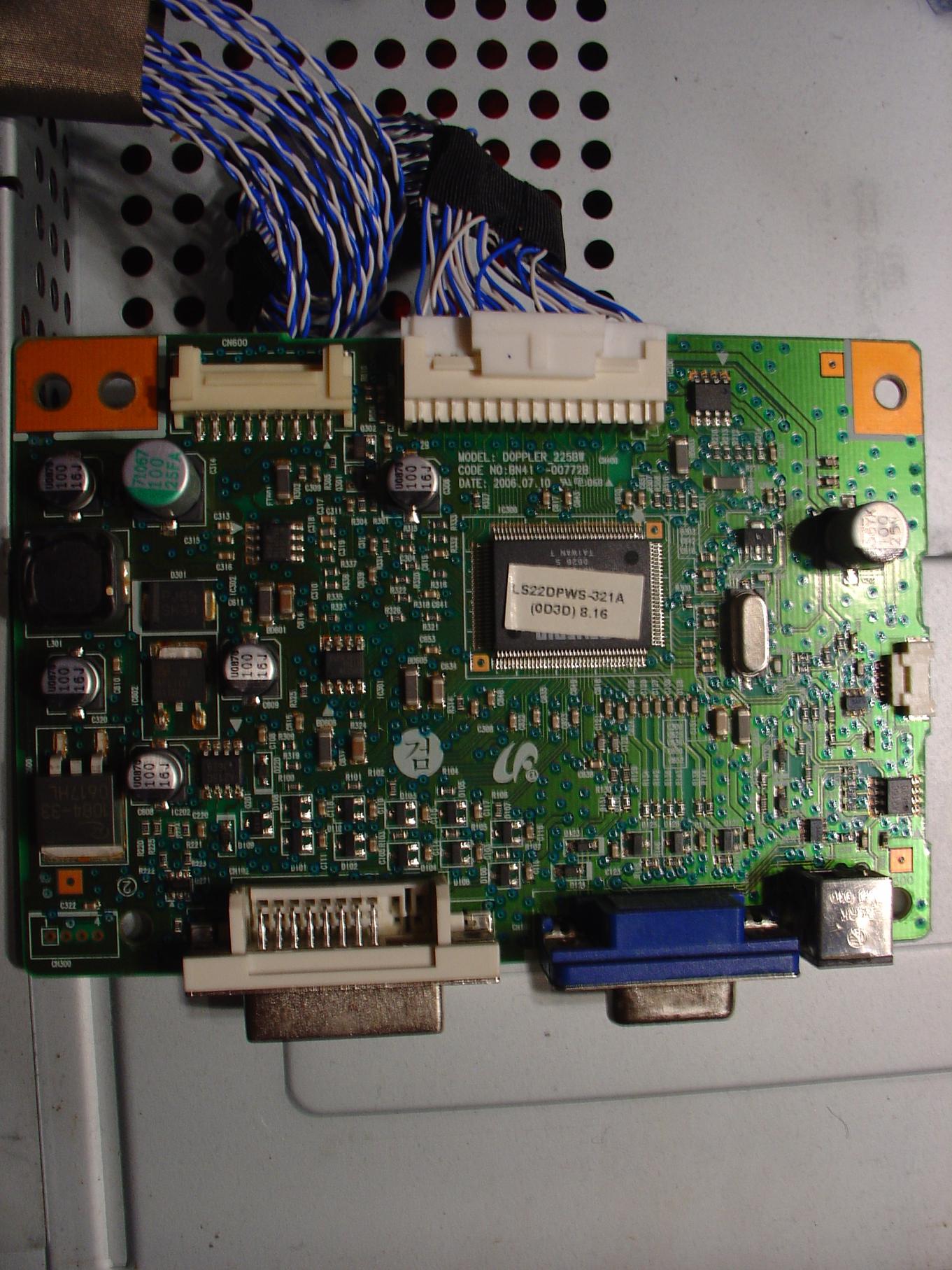

              retook the pics and hopefully they are better
              oddly enough, when i laid it down on a flat surface, it would stay on a bit longer but would eventually turn off
              my Dad would and he was a Electrican for many many years, he did the soldering work for me
              yeah, i gave it back to my Dad and pretty sure he double checked it
              yes, sorry if the pics look odd but i'm resizing them in MS Paint to fit attachment reqs.
              i didn't keep them
              what is the SXC?, please lmk if i need to re-take any pics for better viewing

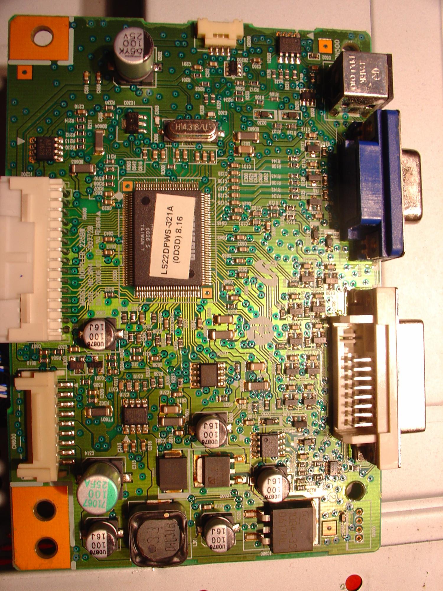

              • GR3Y5H3ART
                • Jan 2011
                • 146
                last pic was upside down? anyways, re-positioned it
                  I have found that the 2 second to black can be shorter and a lot longer than 2 seconds.
                  The fact that with the panel laying flat it will stay on longer may be a clue. If you have any spare ccfls it would be worth a try to see if substitution of known good ones cures the problem. Measuring the inverter transformers is also important, the problem I have is I am not good enough to look at a picture and tell you what pins to measure.
                  I also cannot tell you the quality of the caps you used.
                    With power off and lcd unplugged, measure the resistance (ohms) between the 2 yellow dots. Do the same for red yellow dots. Report both.
                      Greyheart, your logic board looks fine. No need to change the capacitors on it, they're all polymer.
                      But your power board, when I said "SXC" look at the big red cap, it says "SXC" on it. Now look at the capacitors you replaced, we need the name and series of those capacitors to see if you got the right type.
                          i see what your talking about and went around town looking to replace the Red one and the one next to it...unfortunately, neither Radio Shack nor Micro Center carry the Cap i need
                          can someone help me choose the right one from digi-key or somewhere else?
                          thanks guys and hope to get this thing running soon
                            Post the uF and voltage of the cap. Also, list the diameter and height of the cap in millimeters.
                              How can we tell you the right one if we don't know what was there before? You need to ask someone who has this board to tell you what comes there from the factory.
                                ordered three Replacement caps for the Two big (Red & Black) and the last small cap
                                got the parts numbers from the original thread about 225BW
                                checked with Multi-Meter and my Dad said voltage is fine
                                hopefully the caps will fix the prob *crosses fingers*
                                  What about the resistance test as per post #10?
                                    its alive!
                                    my Dad replaced the other 3 Caps and it turns on...gotta see for how long but so far so good
                                    thanks guys for all the advice and helpful suggestions
                                    the color is a bit off (maybe a bulb issue?) but it is on and working
