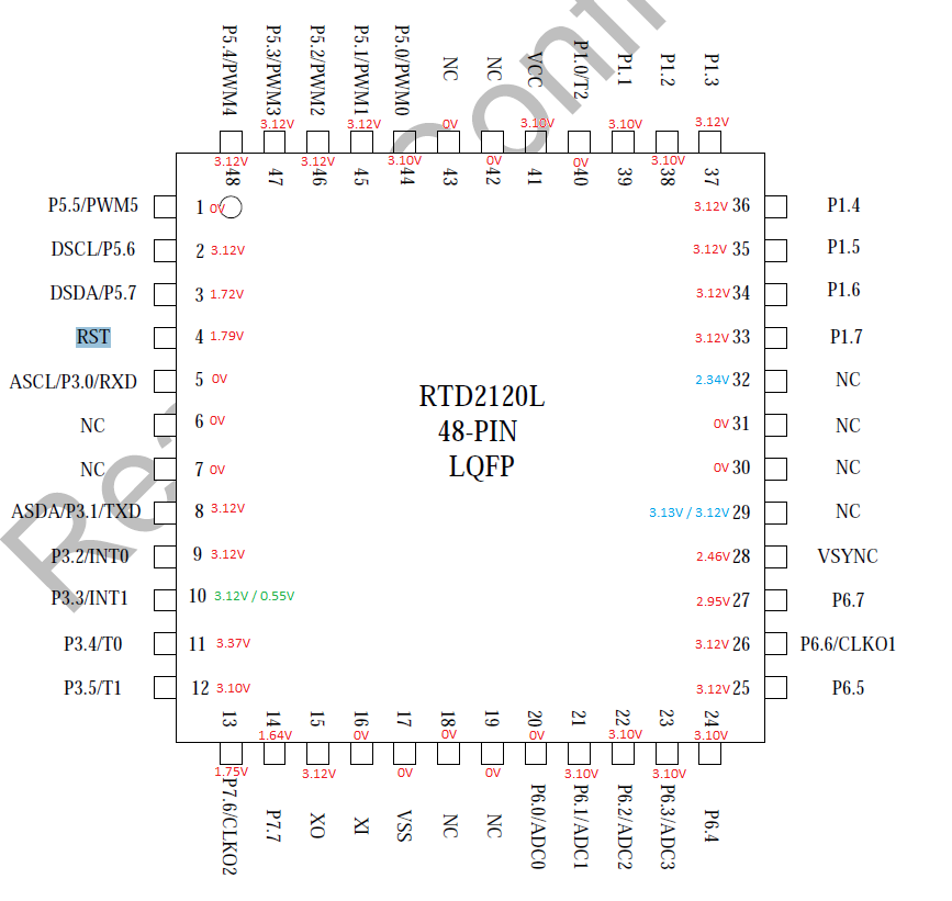

    Is anyone able to get any meaning out of the measurements I've made? Does it tell you anything?
    You have to take a two pronged approach at this point. Trace the line from the power button to the main chip on the logic board. Does the input pin toggle? Similarly, trace the BL_ON pin from the connector to the power supply back to the output pin of the main chip on the logic board. Does the output pin toggle? (This would be easier if a schematic were available). Unfortunately, the most likely problem is the main chip.

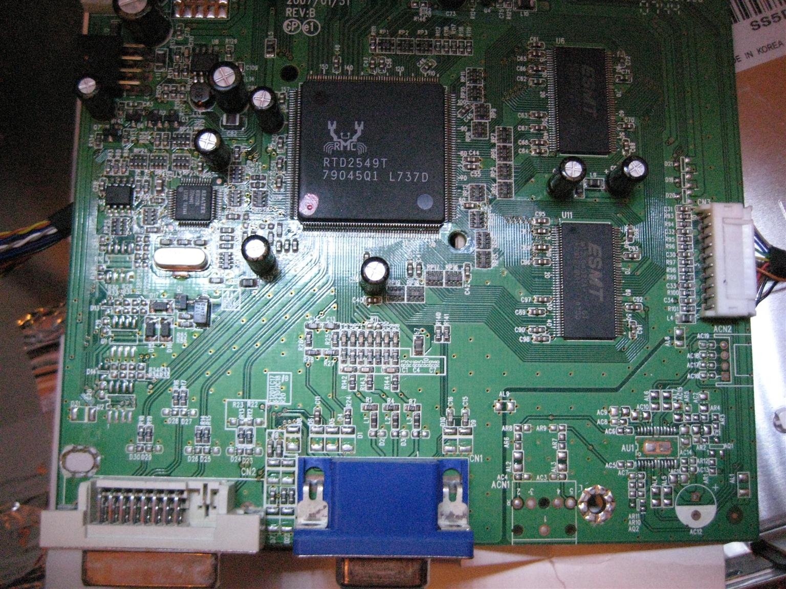

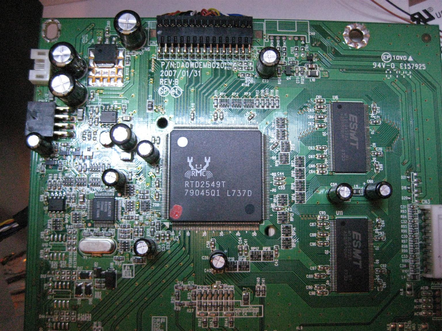

        Re: Sun 24.1" LCD monitor (Samsung LTM240M2 L02 panel)
        One more thing - better pictures of the top and bottom of the logic card would be helpful.
        Also what is the part number of the square chip to the left of the large processor (U3?). That MIGHT actually be the standby controller.
        OK, that's two things.

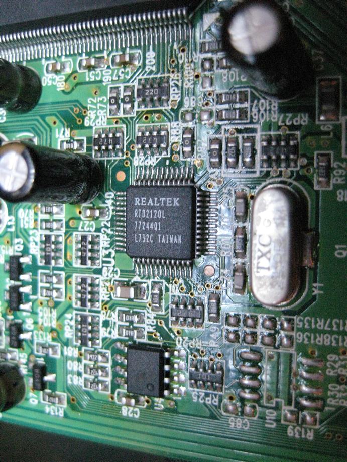

          Thank you for your replies!
          PlainBill, do you mean the IC I've taken a macro shot of? It's a Realtek RTD2120L. I found the data sheet and have attached it. The main IC is a Realtek RTD2549T. I couldn't find any data sheet on it, but I managed to find one for a RTD2523. I thought it would be better than nothing as they do look similiar. The data sheet is available here: http://cnpdf.alldatasheet.com/datash...2/RTD2523.html
          The two IC's to the right of the main IC is SDRAM. The part number is ESMT M12L64322A. I found the data sheet in case it's of any help and attached it.
          About tracing the pins, I'll get on it but it'll probably take some time for me. Also I'm not really sure how to trace the power signal from the power button. When I look at the diagram I made, where does the signal from the power button go? Please excuse my ignorance here, but I don't understand where the signal goes out when all the pins are connected to eachother through resistors.

            Bingo!!! It seems very likely the RTD2120L is the standby controller. I'm not going to have the free time to assist you for a few days, but here is the approach I would take. Examine the datasheet and identify which package you have. Verify you have Vcc at the power pins of the IC. Verify the voltage on the reset input. Then see if you can identify which of the 44 pins on the IC changes level when you push the power button.

              I measured the voltage on all of the pins on the IC (Whew! Glad I had a magnifying glass!) and wrote down my results. I wrote them on the diagram of the IC from the data sheet. The only pins that changed voltage when I pressed the power button was pin 10 and (maybe) pin 29. It seems pin 10 is the one receiving the input from the power button. When I'm not touching the power button, the voltage was 3.12V and when I pressed the power button, the voltage decreased to 0.55V.
              Pin 29 had 3.13V when I was not touching the power button, but when I pressed the power button it decreased to 3.12V (Difference is 0.01V). However, I'm not 100% certain because of the error margin, but the voltage did seem to react when I pressed the power button.
              But I'm a bit puzzled as the data sheet says that pin 29 and pin 32 is "NC" and should not be connected to anything other than ground. So there shouldn't be any voltage, should there?
              Regarding the RESET pin (Pin 4) the measured voltage was 1.79V. I don't know if that's enough or if it should be 3.12V? And what is the RESET pin used for? (Well, for resetting obviously, but what does that mean in this context?)

                Try tracing what's connected to the reset pin (pin 4). It may be fed by 3.3V through diodes, resistors, transistors, etc. Test these components for shorts.
                  #48
                  A few comments:
                  1. Reset appears to be generated internally, still the voltage is strange. I'd expect either less than .4 volts or more than 2.5 volts.
                  2. Pins marked 'NC' are often connected internally.
                  3. This chip contains internal flash memory. If that is corrupted the chip will not work.
                  While additional testing can be done, I'm not optimistic about having any success.
                  PlainBill
                    #49
                    reneg: It looks like you have been very thorough in your work. The front panel buttons and circuitry is probably good. Hard to say if the RTD2120 is working properly, but in my opinion this type of digital logic chip is unlikely to fail.
                    I'm guessing there is some major fault somewhere. To narrow this down I would try disconnecting the major circuit assemblies. For example, what happens if you disconnect the LCD panel from the video/logic board. Does it power on and light the backlight? What if you disconnect the backlight and leave the LCD panel connected? Can it display a very dim image on the LCD? Do the front panel LEDs stay on? What if you disconnect the backlight and LCD panel? (If you disconnect the backlights, unplug the low voltage input cable only.) Powering the monitor with these circuits disconnected should be safe. I've done it on monitors before. But it is an unusual thing to do.
                    Also. It might be worth mapping out the power supply circuitry. Like, which supply powers each circuit block? I think you found the voltage regulator U7 was working, with an output of 3.3 volts. The DC-DC converter U8 AOZ1010 should be investigated further. Also, I noticed some small transistors Q4 and Q5 on the video/logic board. These *might* be power supply switching transistors.
                    Once you understand all of the main power wiring you can start to test the main component blocks. Are they getting power? Do they get power at the right time? Do they get power when you press the power-on? Are they getting power intermittently? Of course if the manufacturer could send you a schematic........

                                      In any case, I also noticed that the pictures of the logic board uploaded here by reneg and others indicate that the board has CapXon capacitors. In which case, I recommend doing a recap of the logic board, even if this may not seem to have anything to do with the issue. I've seen too many CapXon caps go bad over the years that I just don't allow myself to leave them anymore - they almost always fail.
