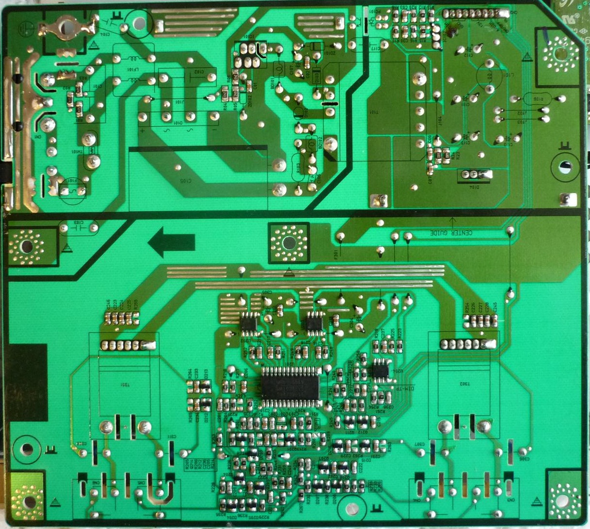

    Defiantly need some photos, Use managed attachments a good overall high quality shots straight down with no flash of the front and back of the boards, as close to the 2000x2000 pixel limit as possible
    It defiantly sounds like a capacitor problem, don't forget about the small usually around 50v and under 100uf caps that are in the area of the SMPS coil

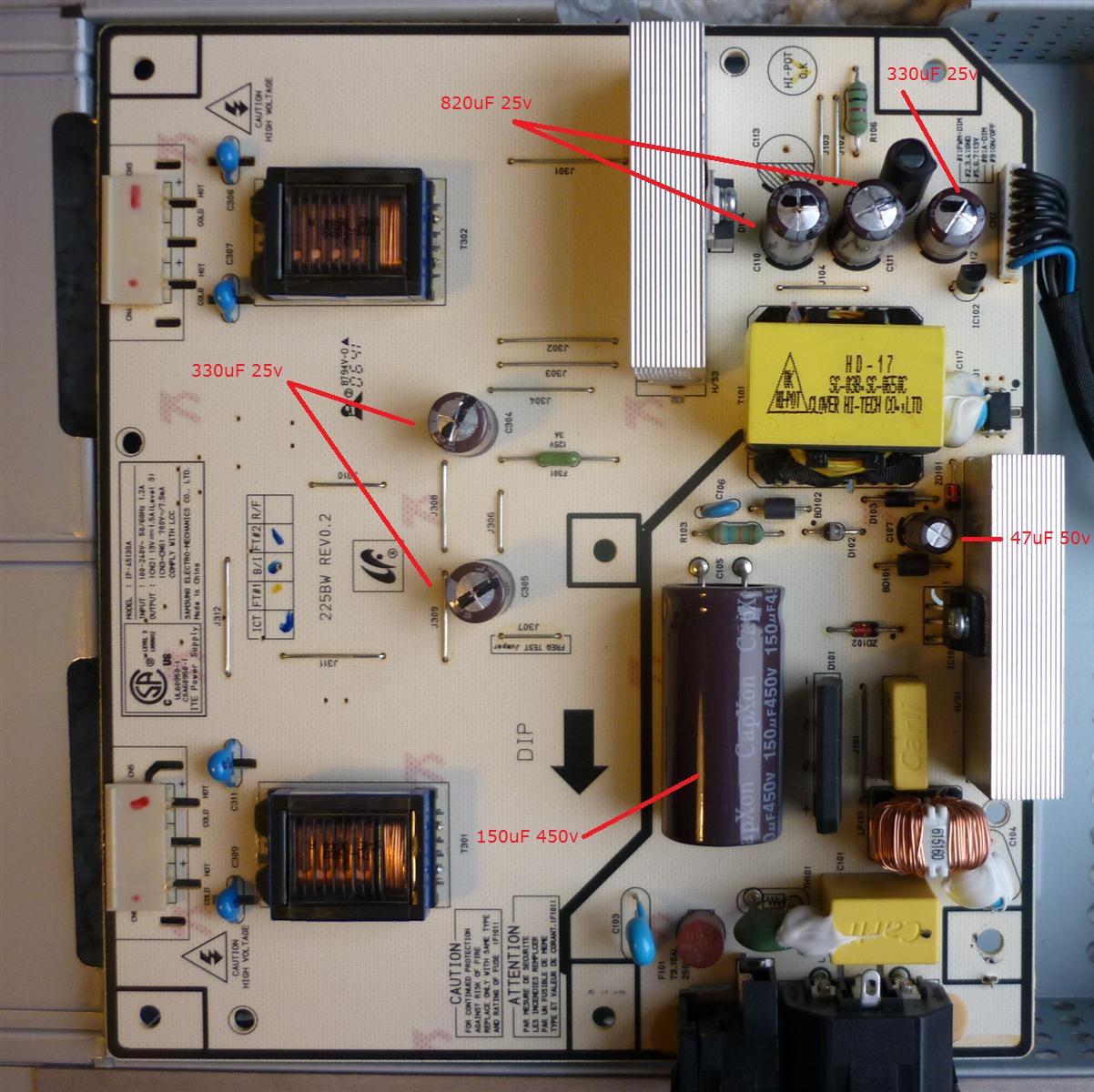

      Hi Alexanna,

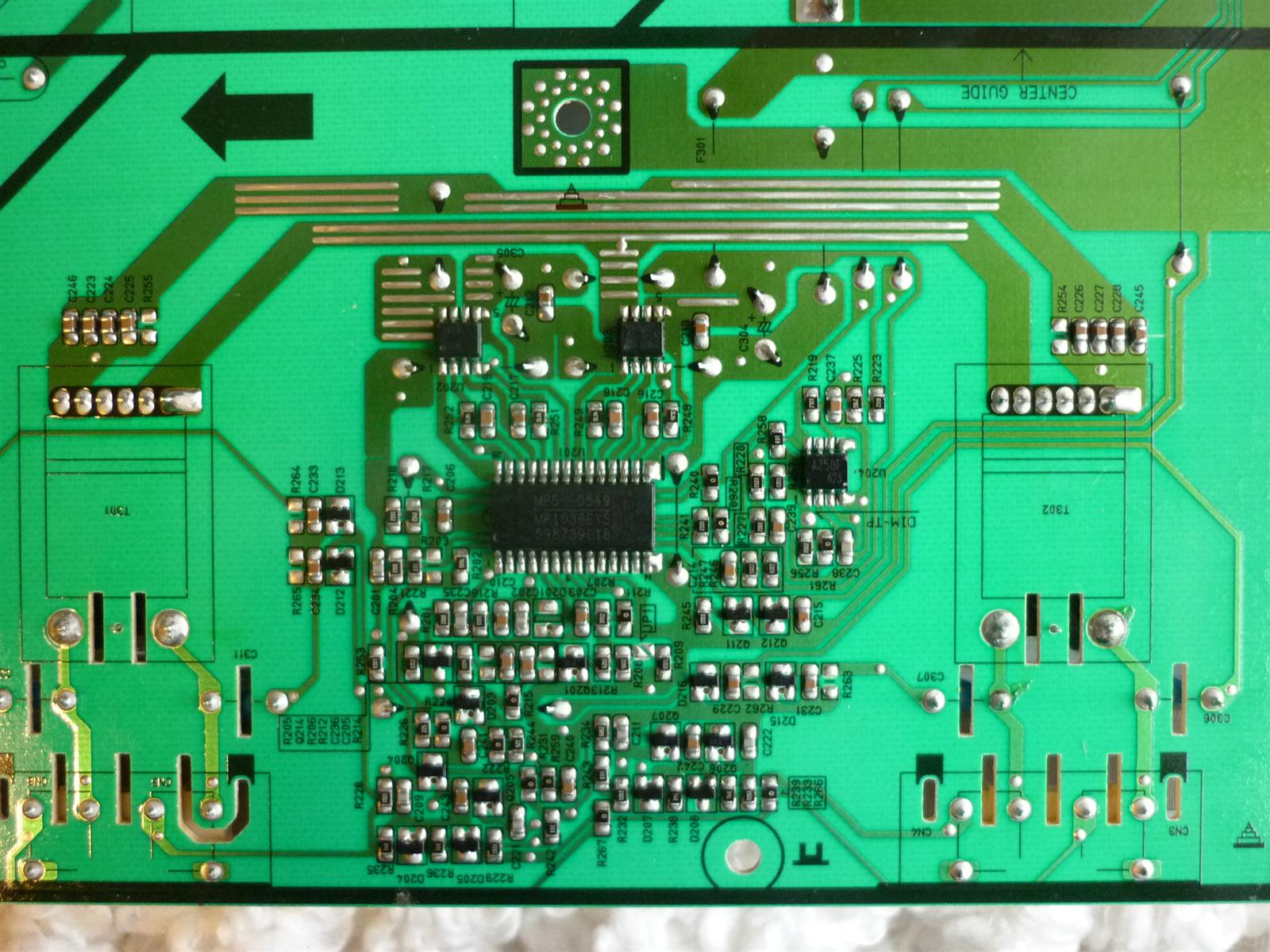

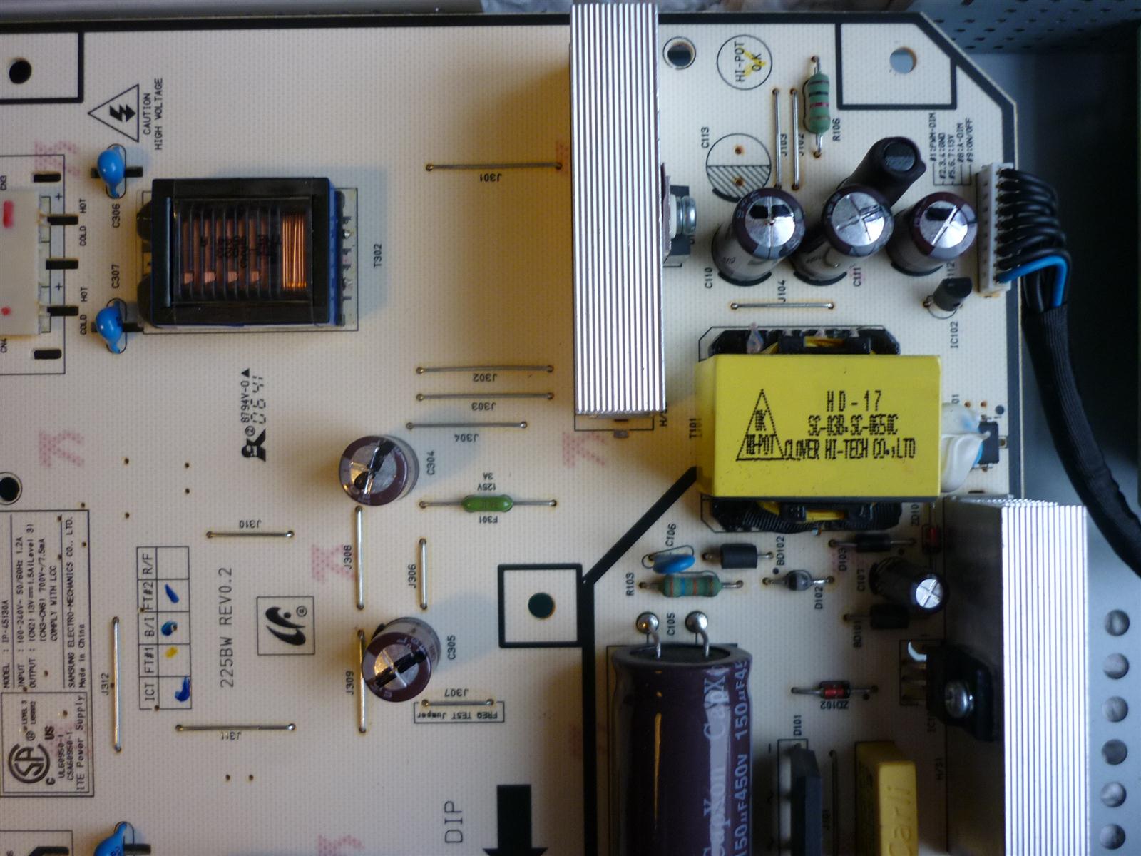

      Thanks for your reply, see the screenshots attached. Here's some more info on the caps I found:
      3 x capxon 330uF 25v p640 vent GL 105° 12mm x 10mm (height x diameter).
      2 x capxon 820uF 25v c650 vent GL 105° 20mm x 10mm
      1 x capxon 47uF 50v c646 vent GL 105° 10mm x 5mm
      1 x capxon 150uF 450v c640 vent GL 105° 40mm x 20mm
      I understand that last one doesn't break that easily, so should I replace the rest?

        I prefer 'fail' to 'break', but you are correct. The 450Volt caps are usually good. Replace the other six with name brand, low ESR, 105°C caps such as Panasonic FMs.
