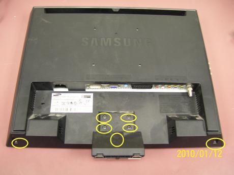

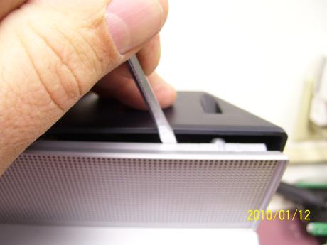

    i have 2 samsung syncmaster 940bx lcd monitors that i would like to swap parts between. one has a damaged panel, the other has a defective circuit board inside.
    how do i get the housing of these monitors apart so that i can swap parts between them?

    Re: samsung 940bx how to open?
    https://www.badcaps.net/forum/showpo...39&postcount=3
      This may help but not sure if yours is the same
        thanks for the help. i got the cases open and made one good working monitor.
        one of the monitors had a hannstar panel in it, the other had a samsung panel in it. but the power & logic boards swapped between them with no problems.
