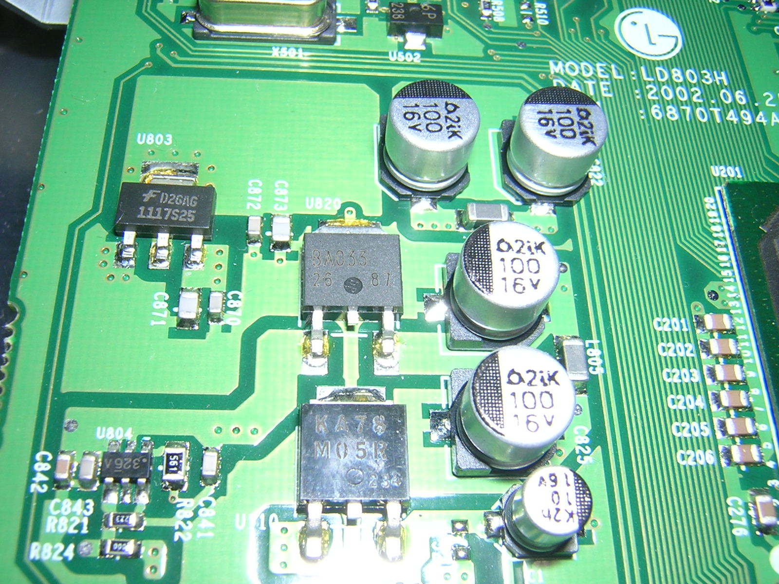

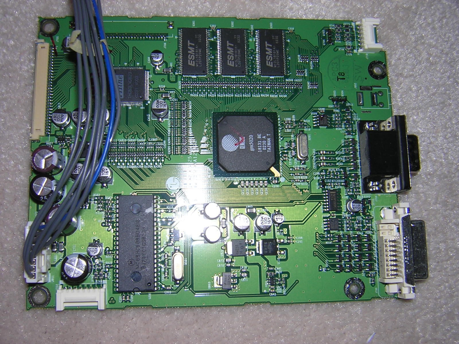

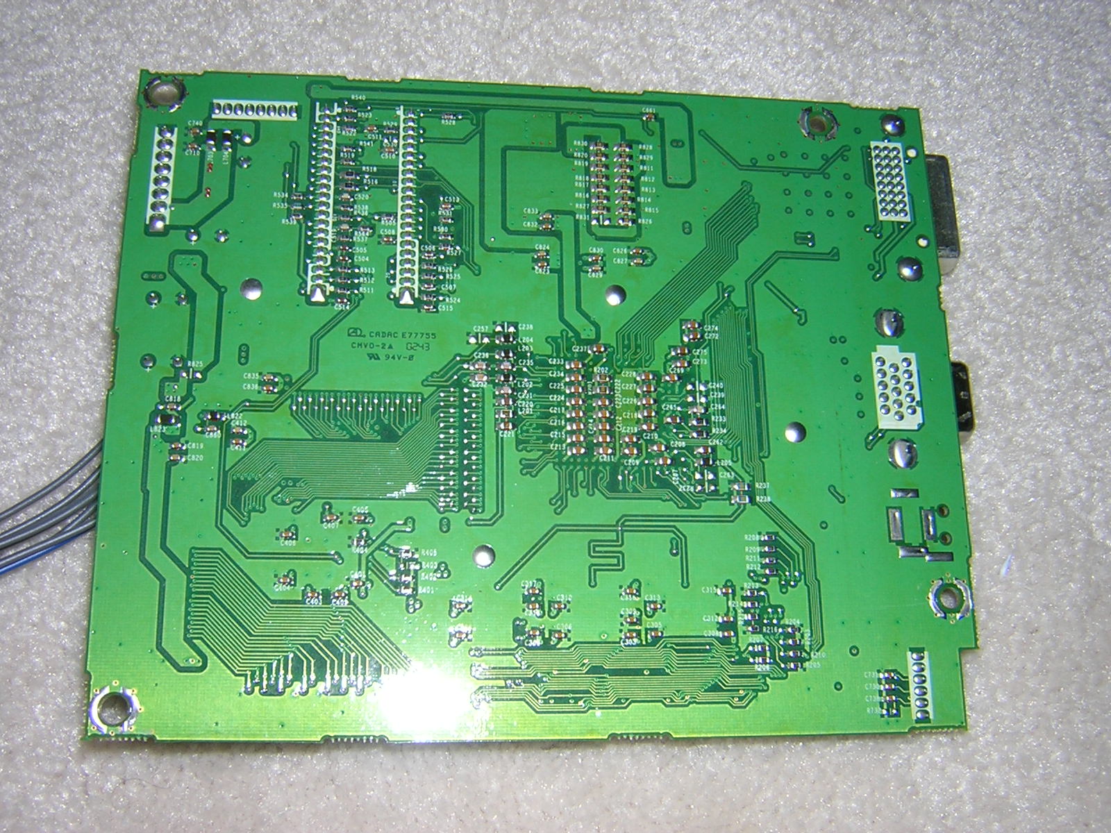

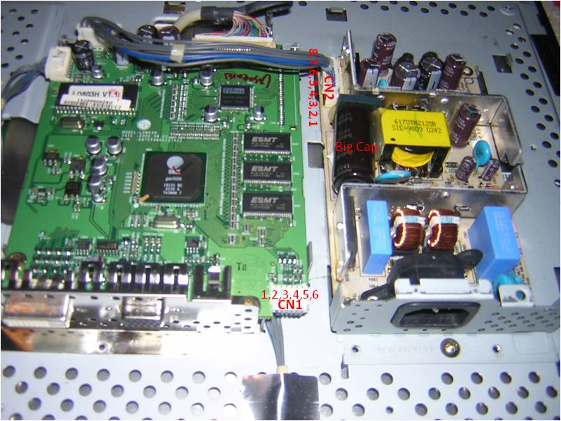

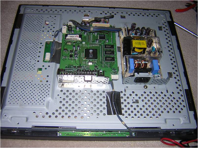

Hi, I have a dell ultrasharp 1800 that i am trying to fix.
Note: I have read numerous posts on this type of monitor failing due to the ICE2AS01 chip failing. Apparently from VCC to GND there is a short of about 13ohms. For THIS monitor the GND to VCC reading is in the MEG-ohms so my first reaction is the ICE2AS01 chip is ok.
Symptoms of this monitor:
1-WHen i plug in the power......nothing happens. The LED light does not come on.
2-I did measure the voltages at the connectors 1 and 2 (CN1 and CN2 respectively) see enclosed pics.
For CN1: (DC voltages)
Pin1: 5.09V
Pin2: 0V
Pin3: 0.24V
Pin4: 0.26V
Pin5: 5.08V
Pin6: 5.08V
For CN2: (DC voltages)
Pin1: 12.09V
Pin2: 12.09V
Pin3: 0V
Pin4: 0V
Pin5: 5.09V
Pin6: 5.09V
Pin7: 0V
Pin8: 0V
3-I also measured the DC voltage across the big cap: I measured 167.9V
I have no idea as to what to try next. If its the logic board that is "bad" then i dont think its worth replacing.....but i dont even know how to determine this.
Can someone help? Any ideas on what to try would be appreciated.
