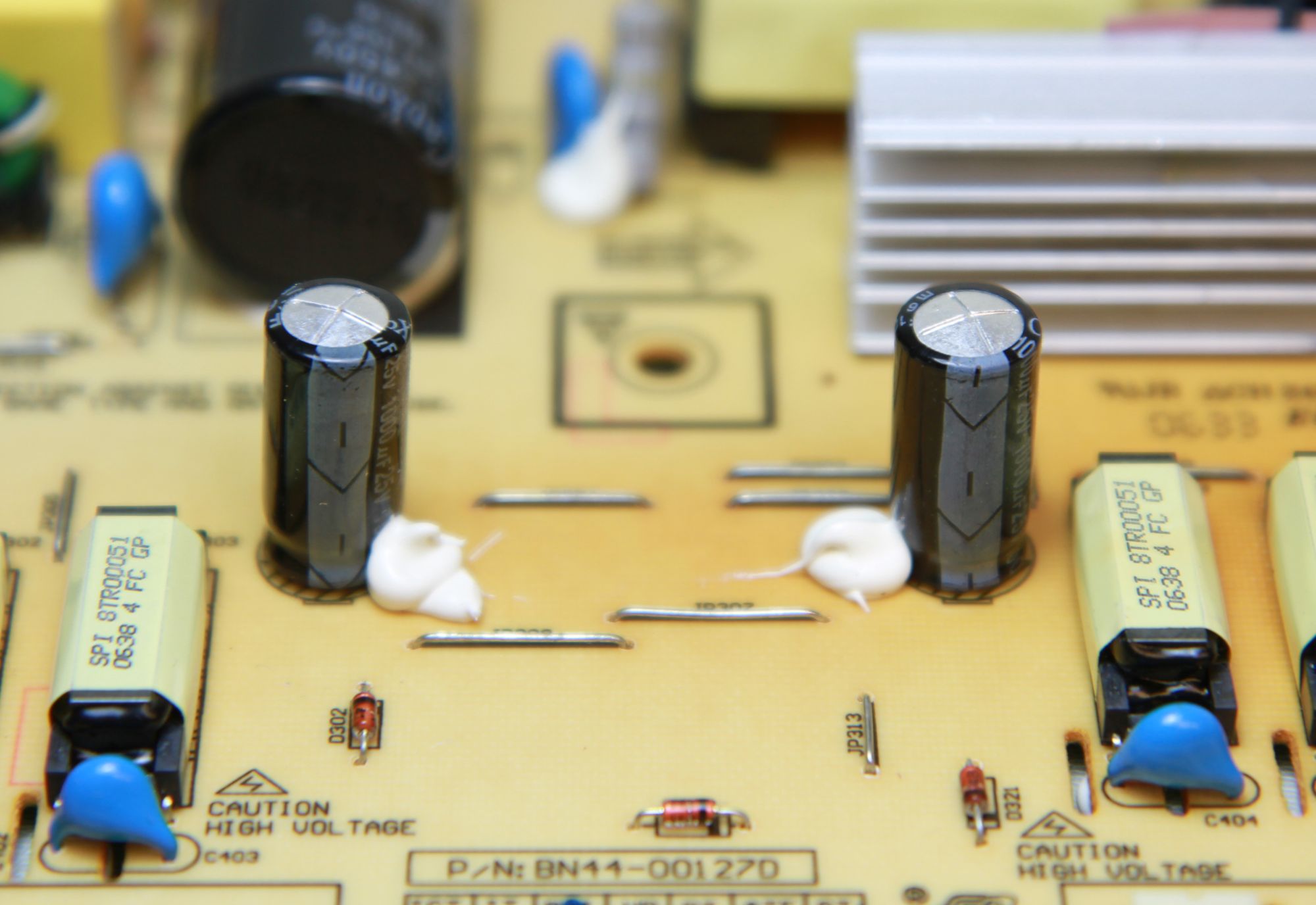

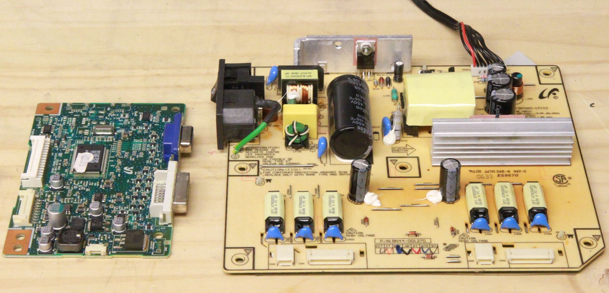

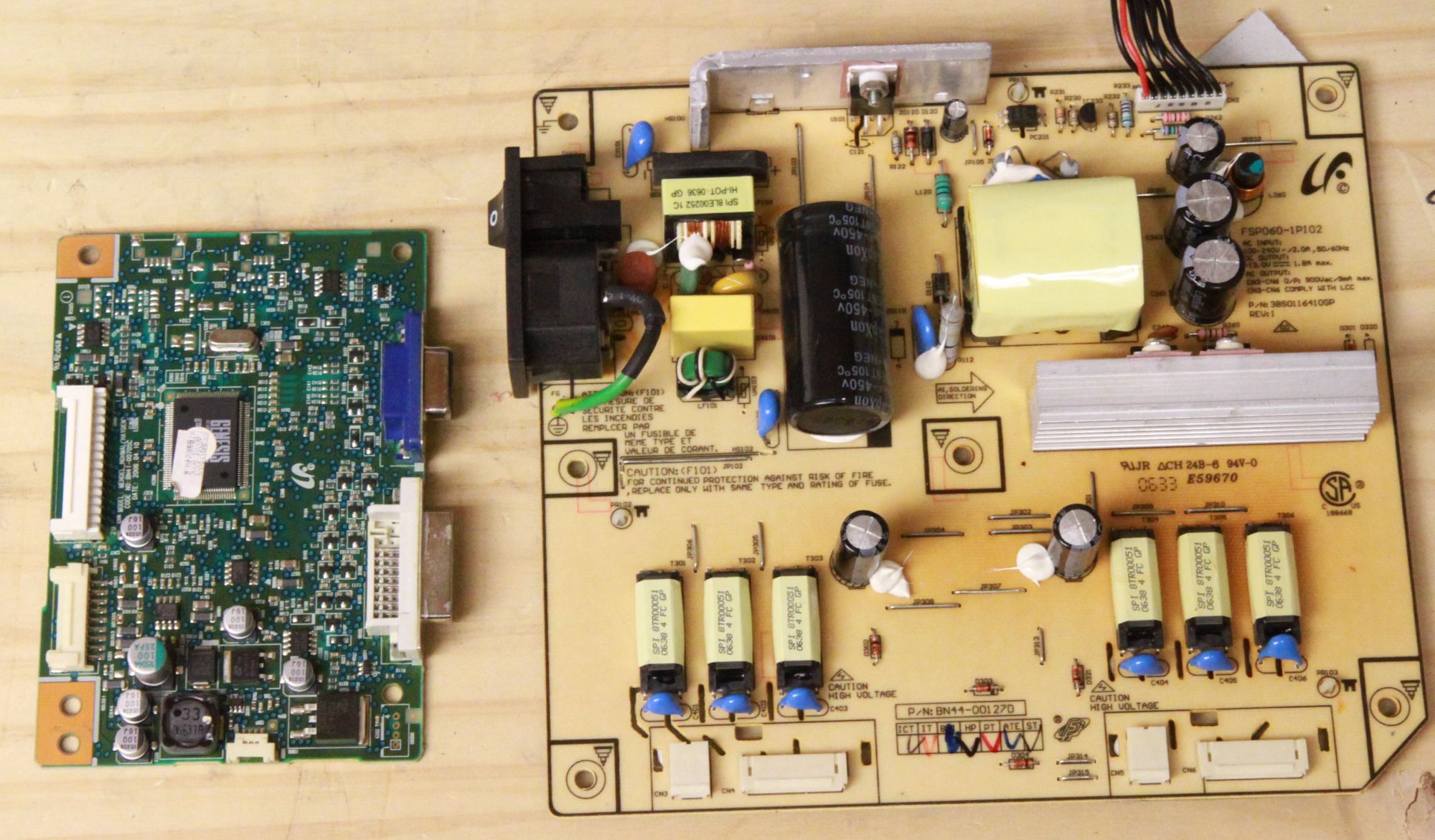

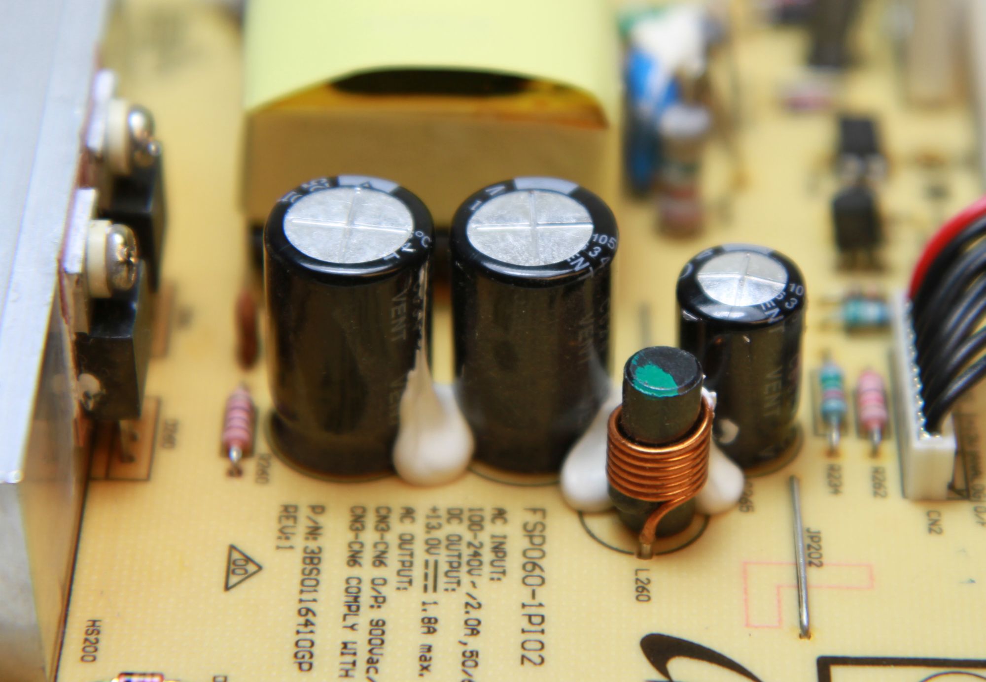

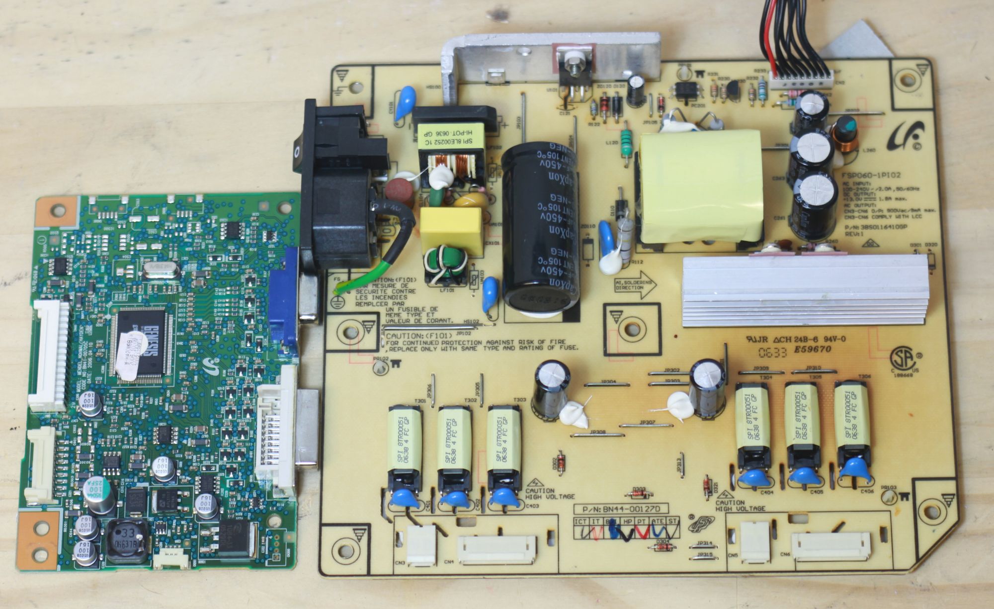

        I think I just be a victim of the Caps as well. I uploaded 3 pictures here. my eyes tell me that C328,C327, C265 might be bad. What a surprise.
        Picture 4 and 5 are close-ups.
        C328 and C327 are the two big ones. I see 1000uf 25V.
        C265 is the tiny one besides the two big ones. It says 475uf 25V.
          Re: Samsung 205BW bad connection problem?
          I count 7 caps (including the big one on its side).
          Since 3 out of 7 are bad, it is not a stretch to think they all may be bad. The exception might be the big one. It rarely, but not never, fails.
          With an almost 50% cap failure rate, most here will recommend that you replace them ALL (except the big one). Caps are cheap so replace them all.
          If you live in the USA, follow PlainBill's instructions to choose Panasonic low ESR FM or FC caps.
          https://www.badcaps.net/forum/showpo...33&postcount=2
          PS. Great focused pics.
