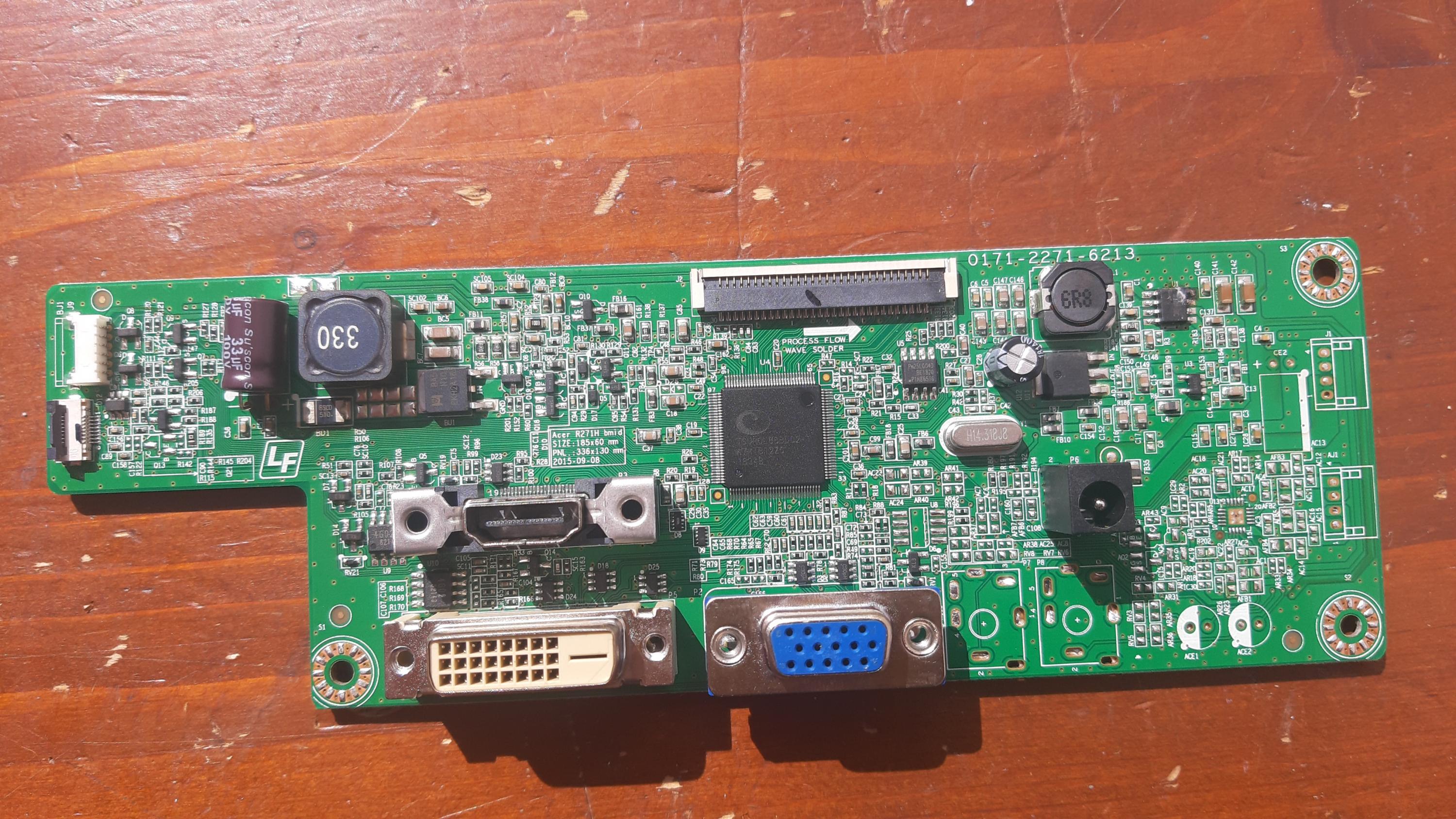

    Acer SA240Y - bad chip U1
    board 0171-2271-6213 (Acer SA240Y).
    I can not see the mark on U1 ic (totally burned).
    Any schematic or identify?
    Two last letter is "RC"
    On the board is on the right side of 6R8 inductor.
    Thank you for your help.

    Re: Acer SA240Y - bad chip U1
    Sy8205fcc
      Thank you very much for your quick answer!
