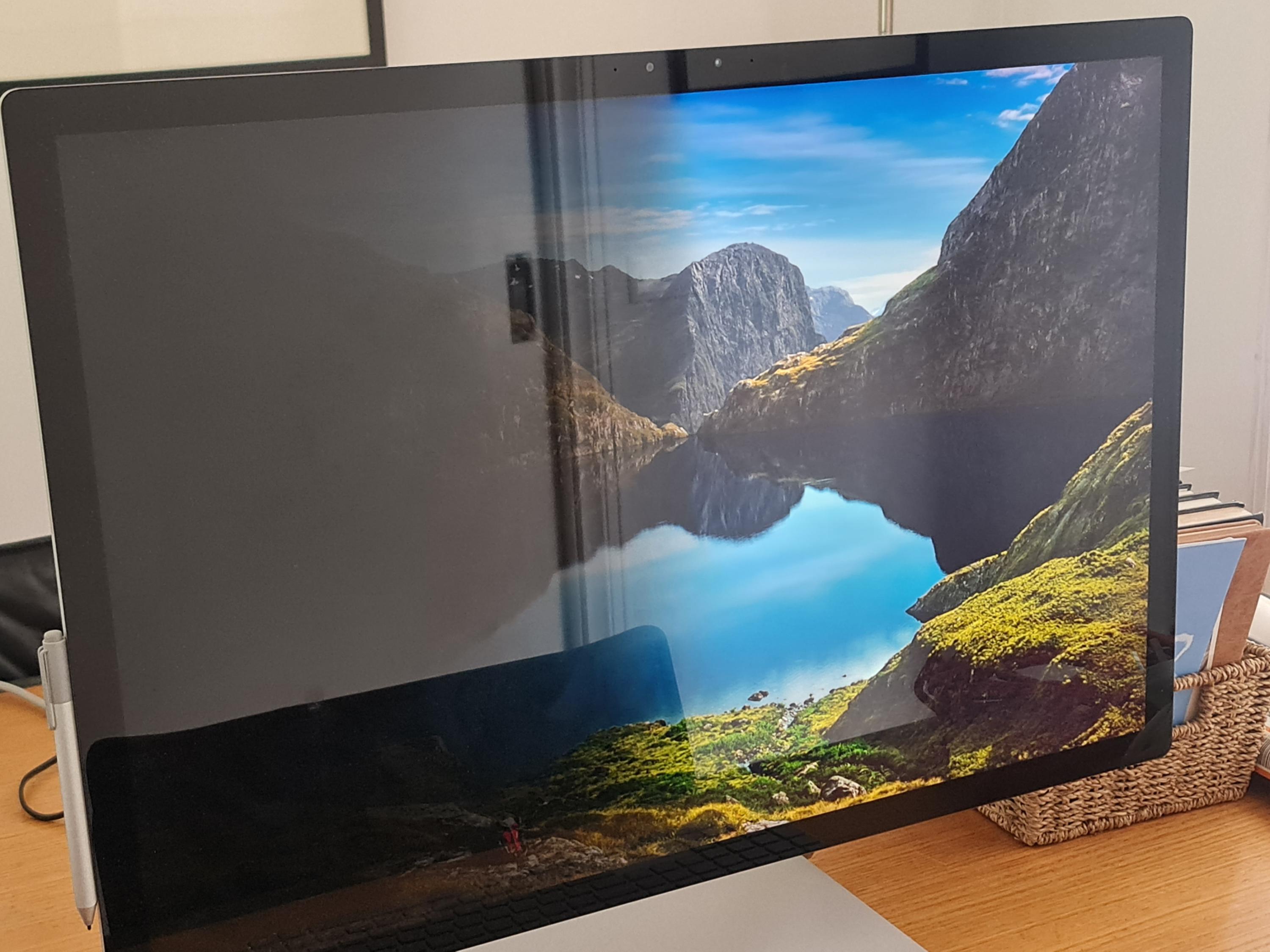

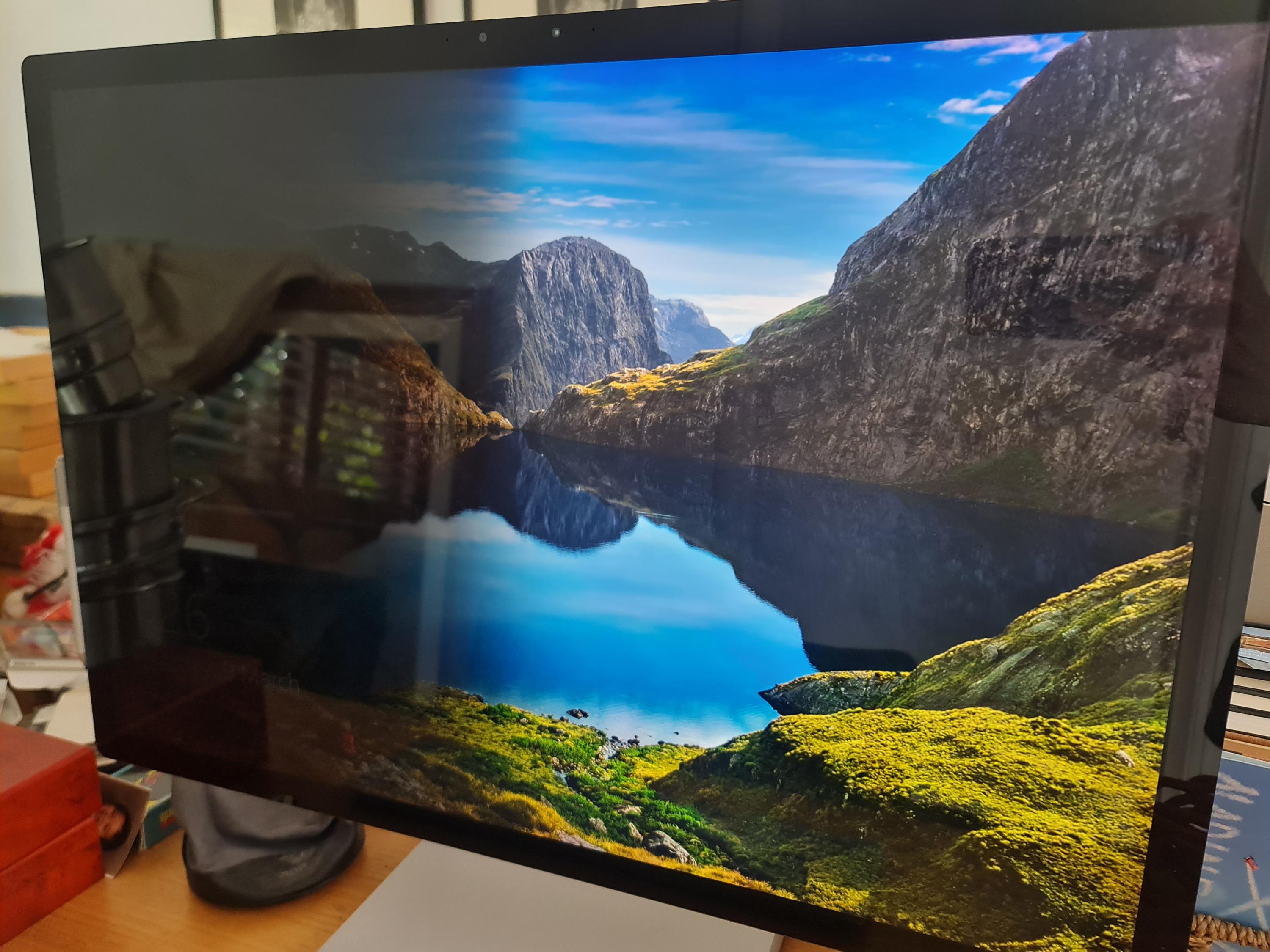

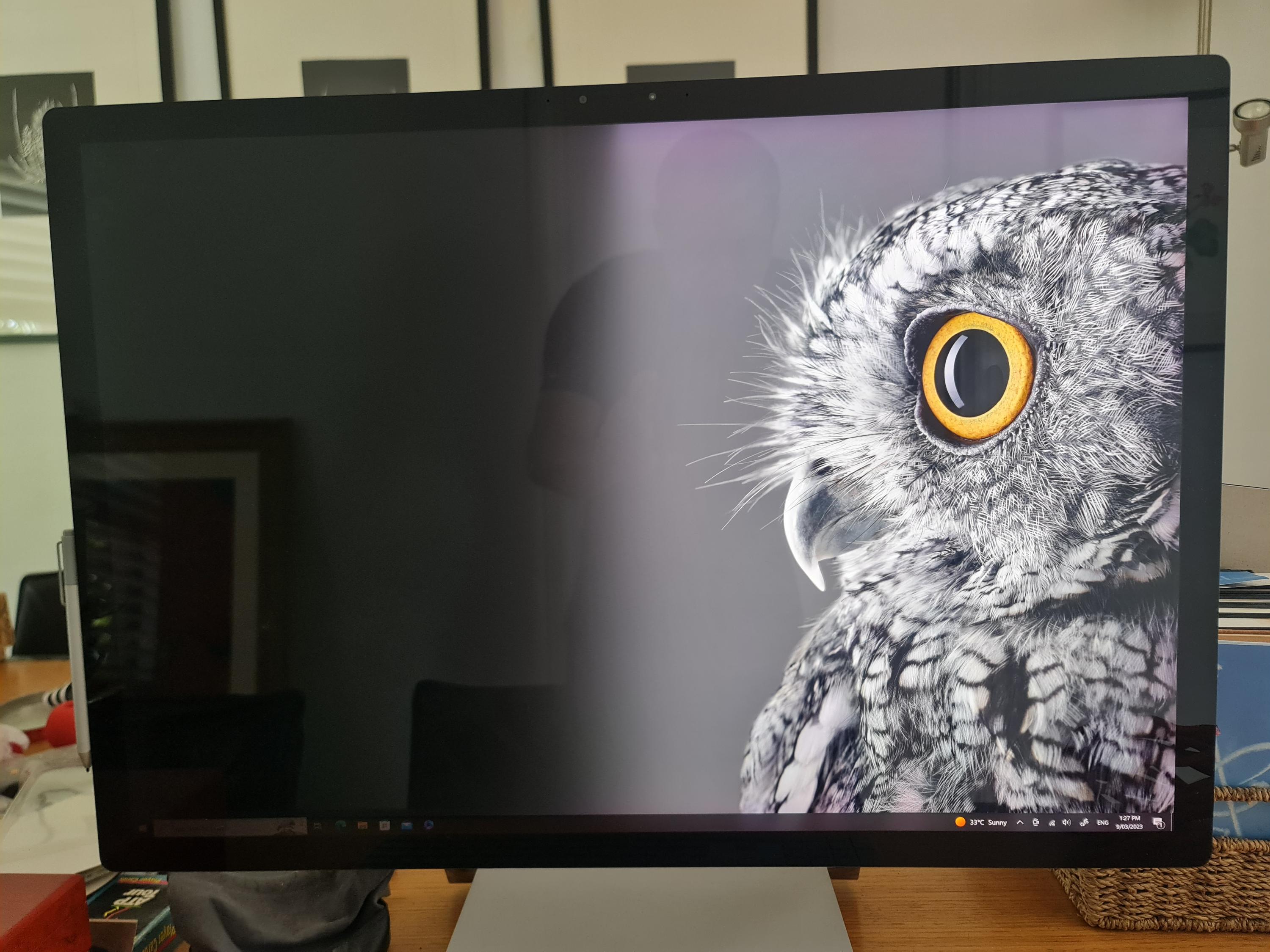

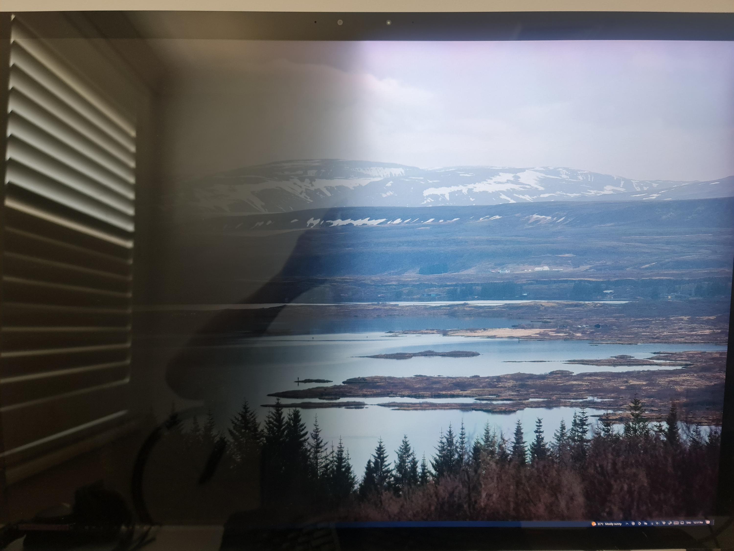

What could be the issue? Thanks!
Surface Studio 1 Screen Half Dark

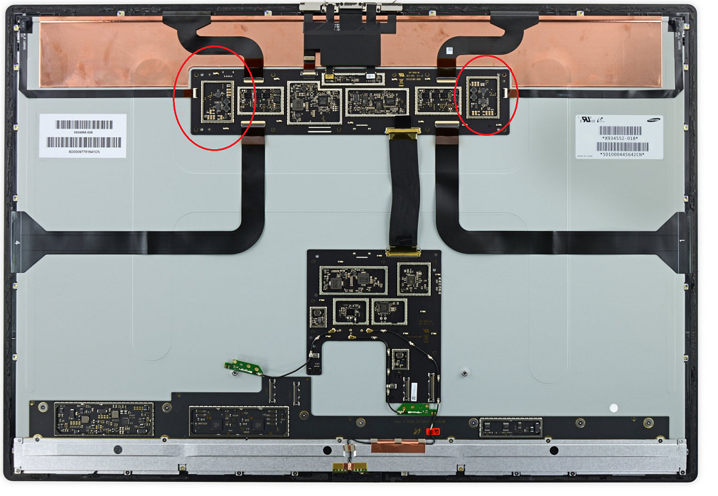

Based on the looks of the LCD control circuitry each half has a dedicated step up converter:
https://www.ifixit.com/Teardown/Micr...Teardown/74448
I would very carefully open the screen and inspect the non working one against the working one. Might be an easy fix.
