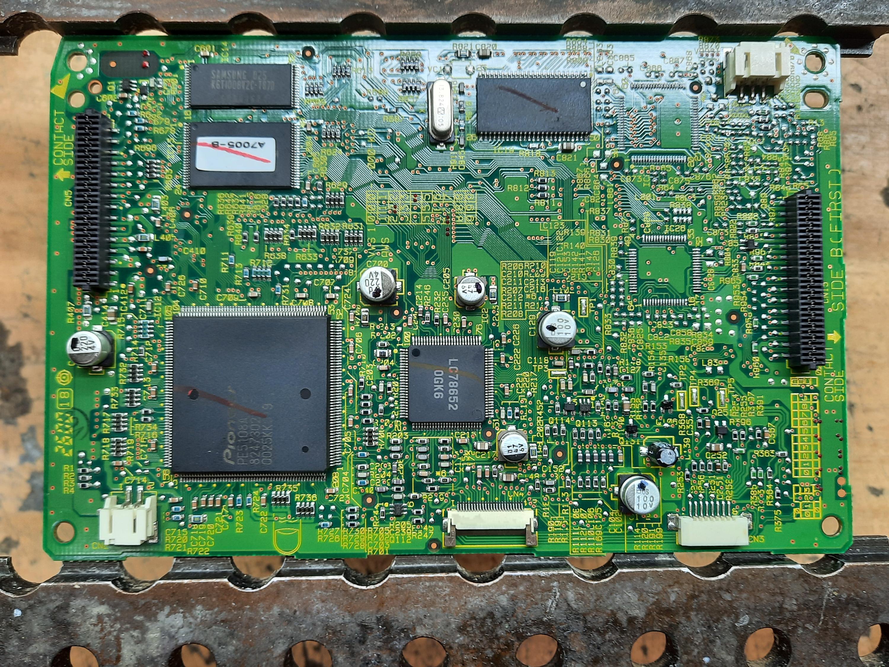

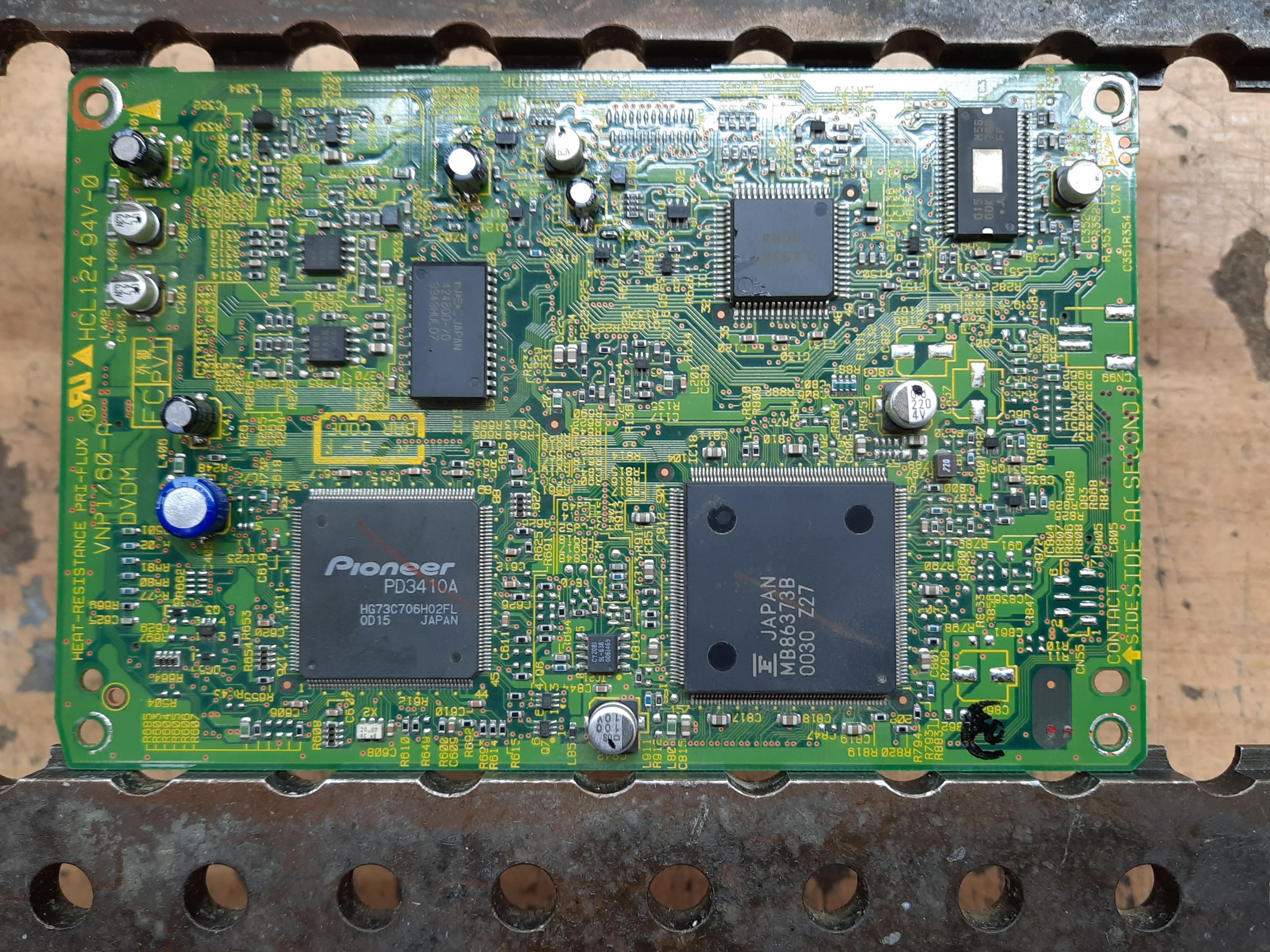

    CD reader arrived , but thought before i fit ,will check caps on the servo board .
    Replaced several with poor readings .
    Now for the reader .

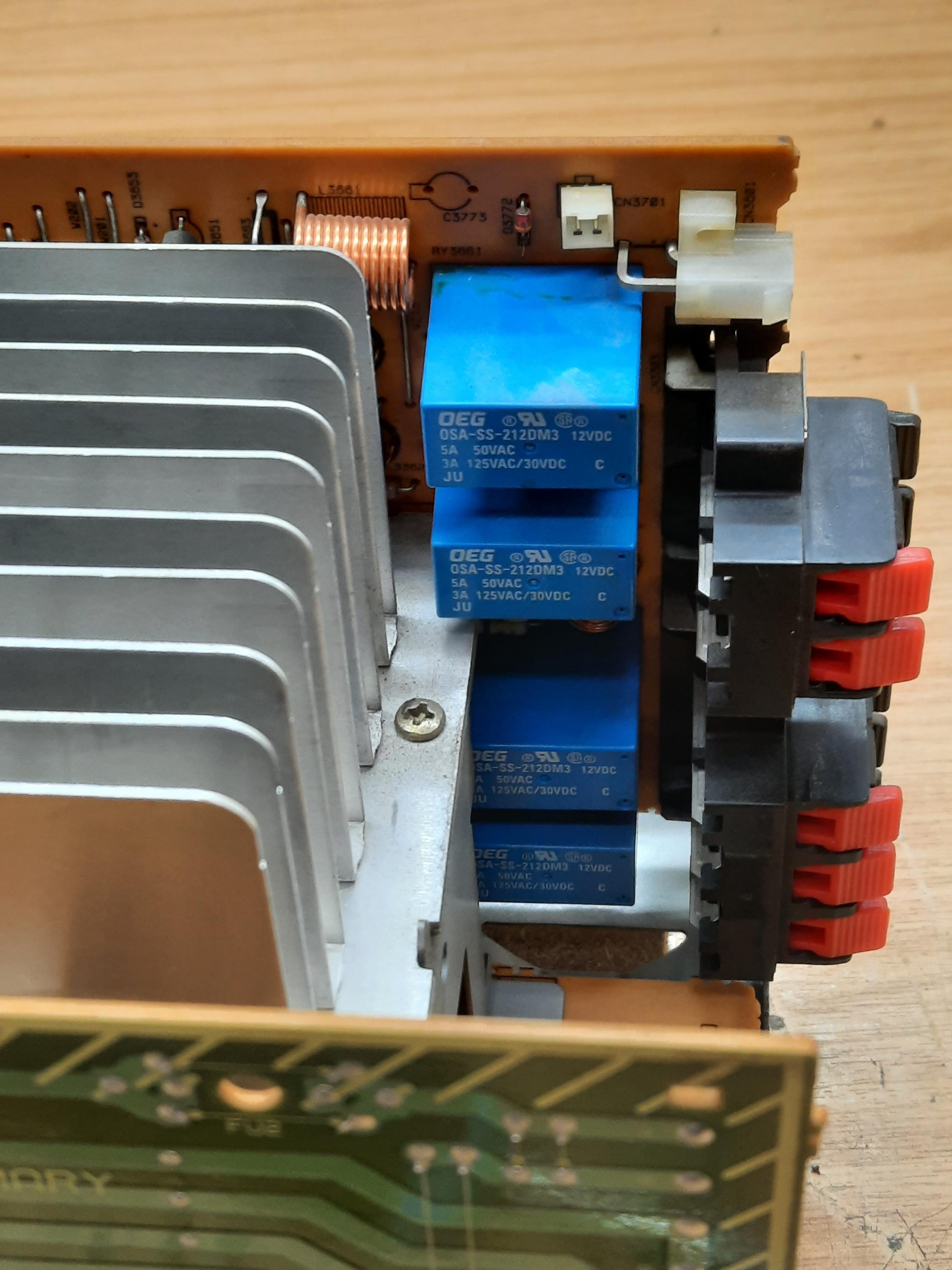

        Also the FRONT speaker audio would cut out intermittently .
        Discovered the top 2 speaker protect relays corresponding to FRONT were dry jointed at the coil side .

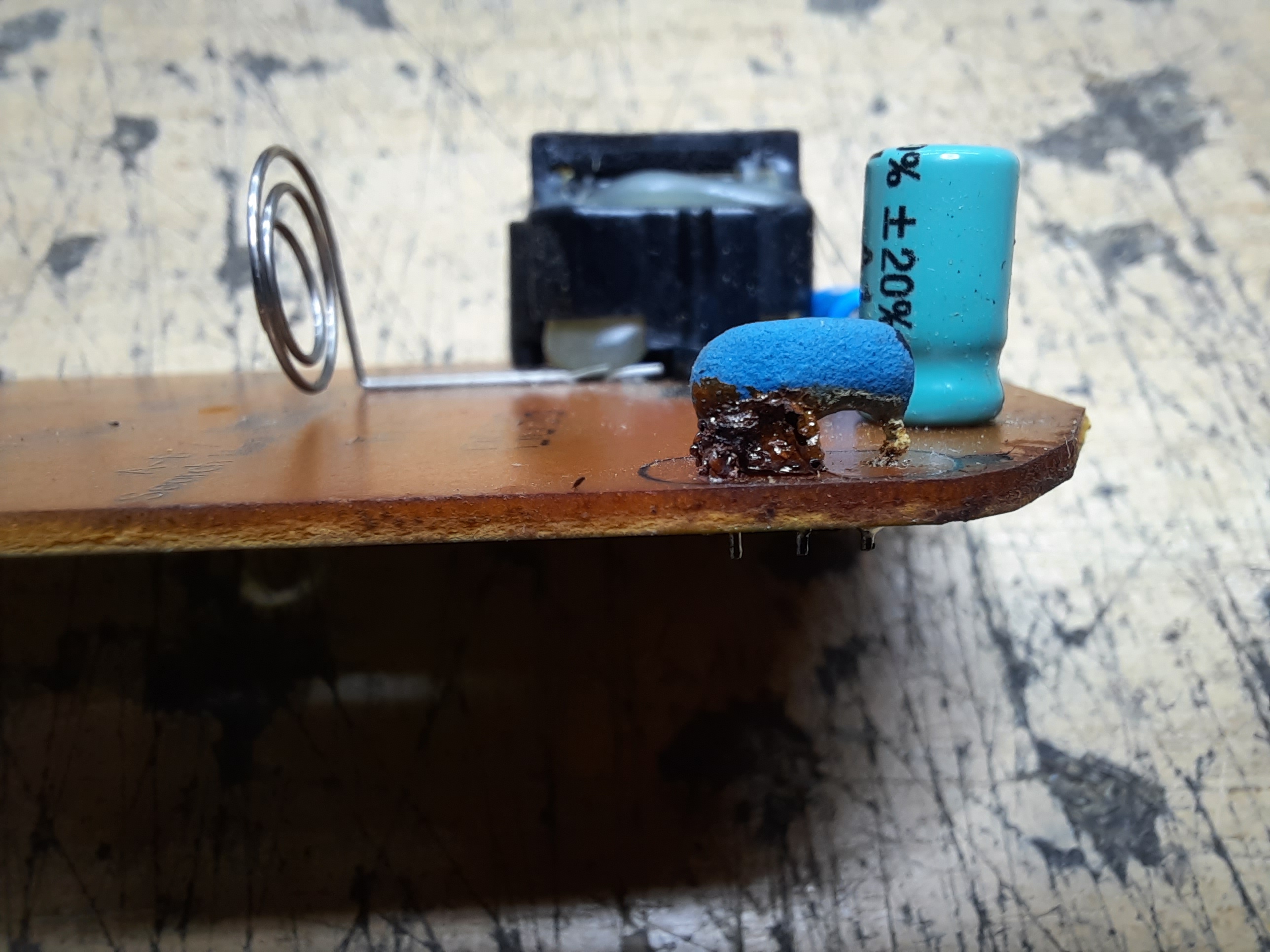

          Once stripped down issue was self evident .
          Glue once used to secure the 8MHZ oscillator had become corrosive .
          A replacement restored operation .

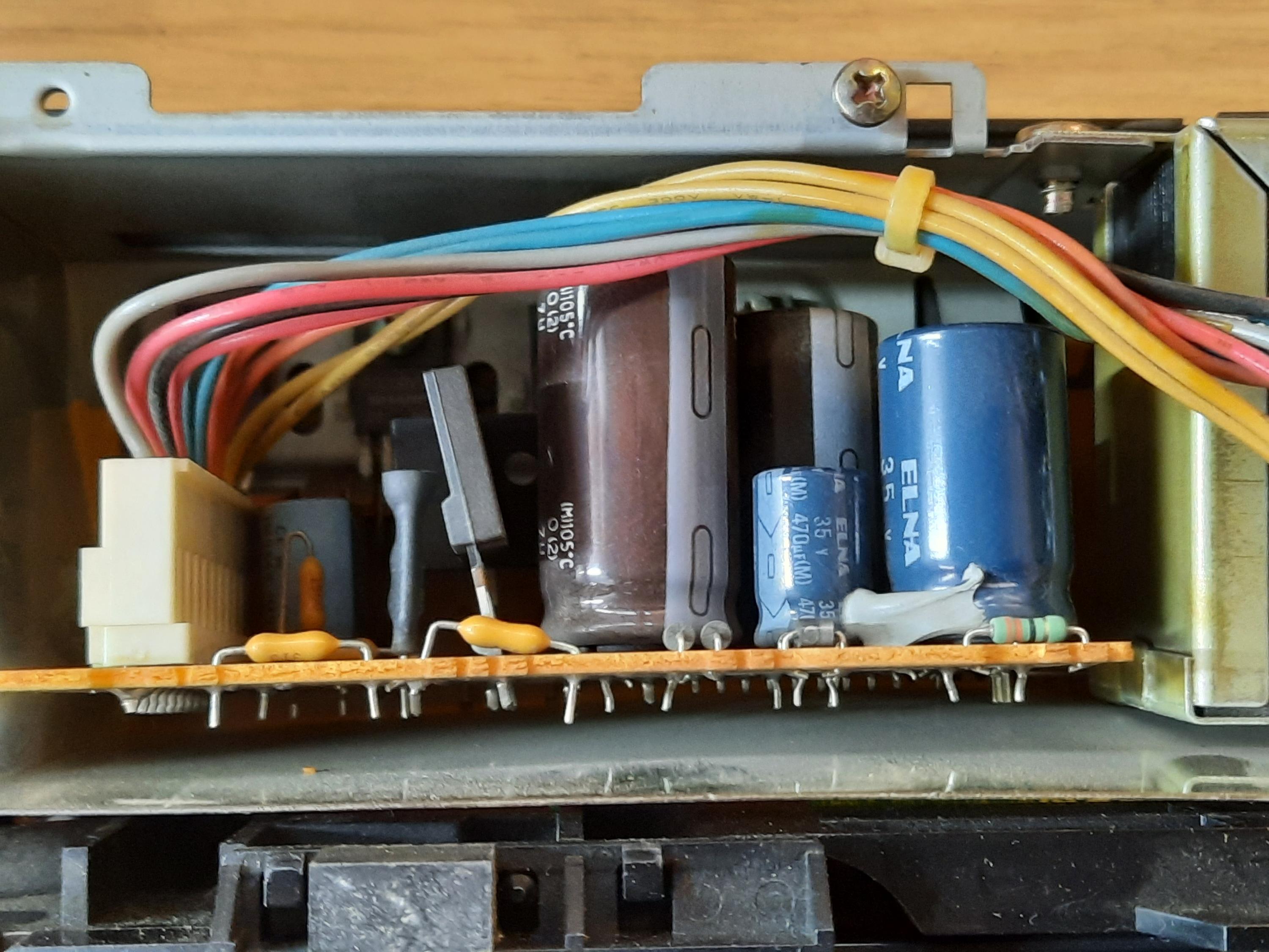

              Yet again from a cold start , after being off for a day , it wouldn't play .
              Took a hair drier to the PSU module , then sprang into life again .
              Time for more cap replacements i think .

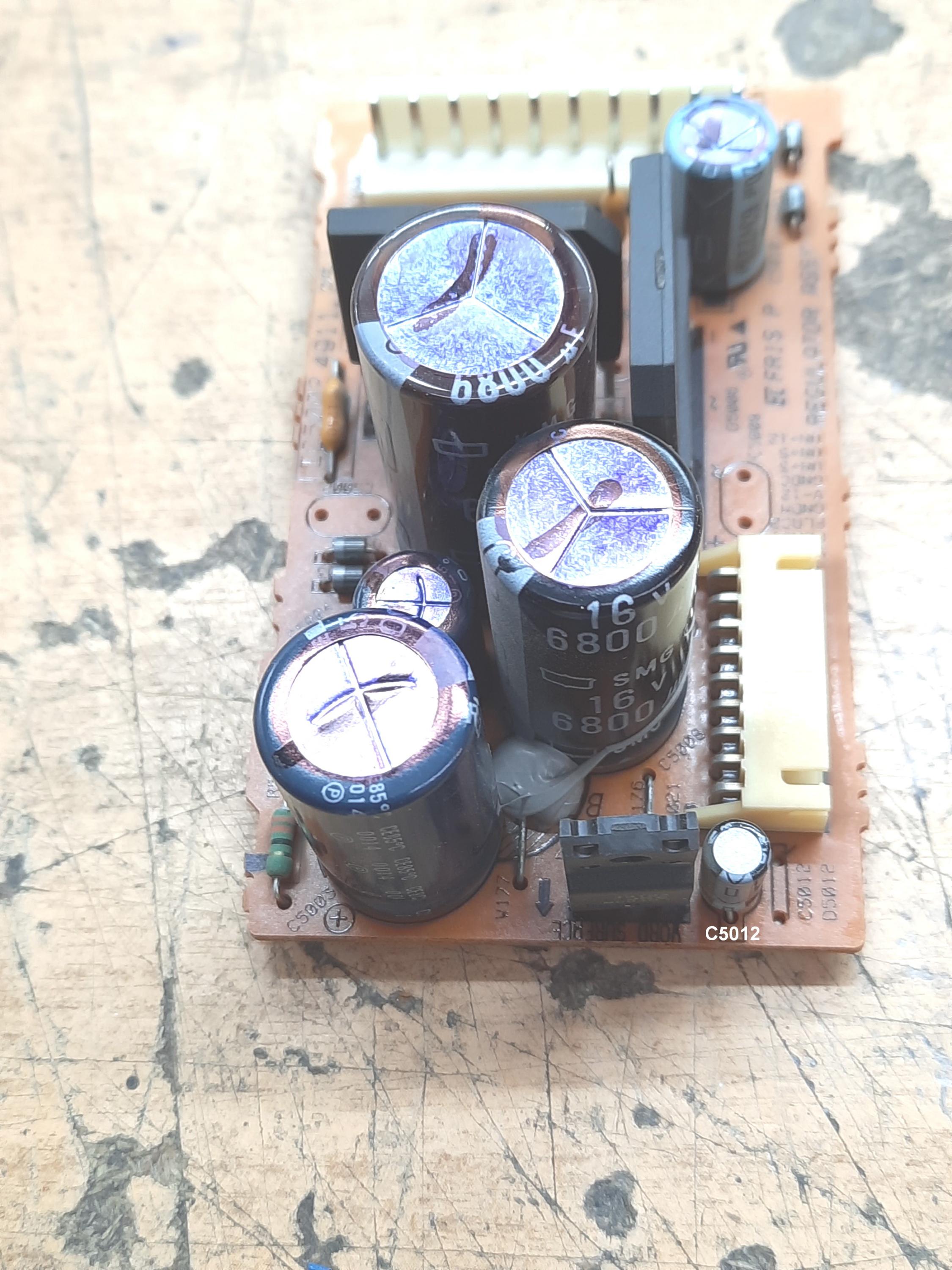

                Re: XVDV55 Pioneer , no disc play
                One cap found with a very poor ESR reading , C5012 ( 10MF , 50V )
                Hopefully this is the cause .
