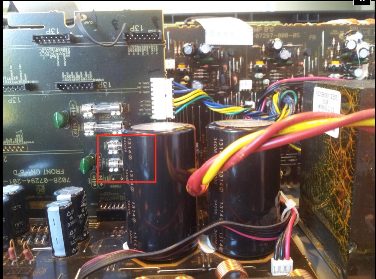

    Hi everyone,
    I have a problem with my denon x2000.
    After doing the speaker setup wizard, no sound is coming out of the speakers.
    I checked the settings and they are correct.
    Taking it apart I found these two blown fuses.
    Now I have to change them, but what can it be due to? Do I need to do any other checks before changing them?
    Thanks to all

    Depends what the fuses protect. Are they in the power supply? Or do they protect the speaker outputs? Or what? Hard to tell from the photo.

      The fuses are for the +5v and -5v, they connect to CN4002 and are the inputs to the +/- 5volt regulators that supply various circuits. Get the service manual. https://www.manualslib.com/manual/10...-Avr-E400.html

        this fuses blown due the 1 of 4 diodes,or more shorted.I found 2 diodes shorted on botom board. 1 diode shorted and if we don't find it ,it's and avr to garbage...
