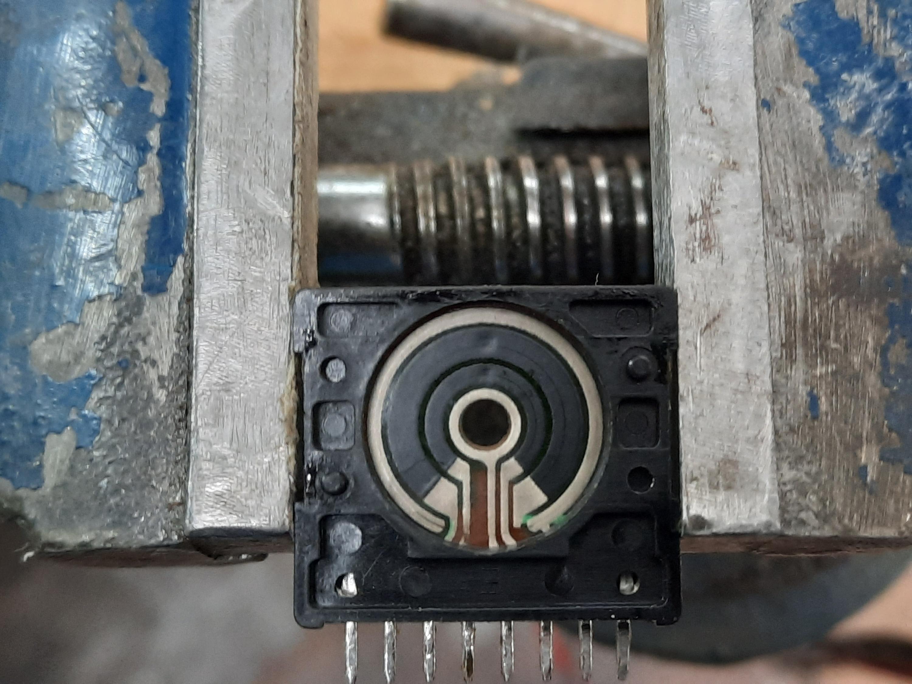

Managed to acquire another amp .
Swapped out the volume control , to prove beyond any doubt that's the cause of the problem.
Stripped down the control again & this time discovered the issue .
There's a break in some of the tracks , which i didn't notice before ,as they are at the very bottom end where the plastic frame is .
tried to to link , but solder won't take & to be honest wouldn't have worked correctly anyway .
Now need to source correct control .
Can anyone help ?

17B503 printed on casing , therefore seems to be 50K

Been doing some detective work of my own.
ALPS RK16812MG seem to cover this range of motor driven potentiometers .
From there i found adding 04YA at the end brings up a 50K type on E BAY .
Ali Express is cheaper though.
Only issue might be is if potentiometer track differs , but at that price , worth a pop.

i have in the past changed just the tracks from a parts unit . also have bought or sent to me for free from the manufacturer .

no it wasn't but was same sort of pot .well the one i used from scrap unit was the same . others were different .

I suspect Onkyo are quite tight on supplying part to non agents .
Here's the Ali link
https://www.aliexpress.com/item/32805658474.html

Yes worked a treat
