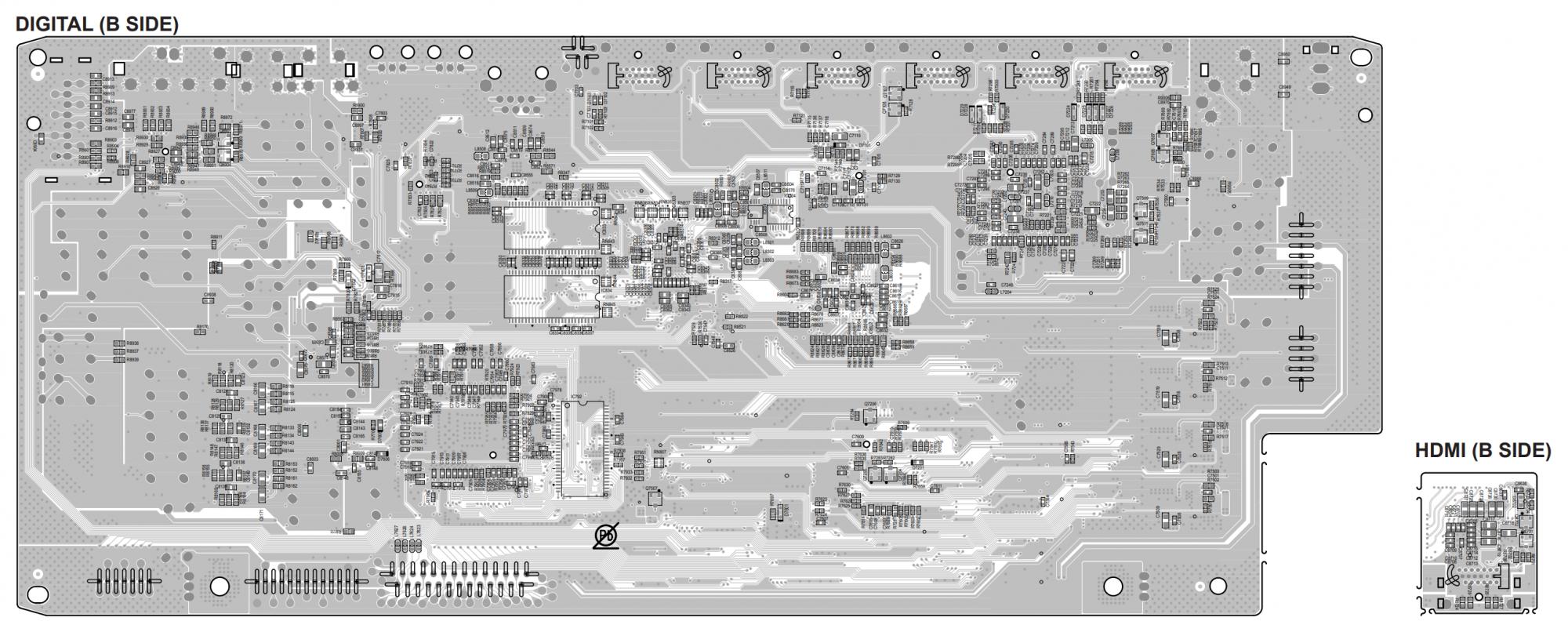

    Hello, I would like to convert my powered Denon AVR-E300 to a pre-amp (line level source) by eliminating the power amplifiers.
    Reason: I use active speakers that are already amplified. I don't want to run an amplified signal into my active speakers.
    I know. But the cost of buying an AVR with pre-outs is wildly expensive and I wouldn't use any of the features other than 5.1Ch decoding.
    My audio/video signal source is an Amazon Fire Cube with HDMI out. I need to get that digital signal out to my speakers. With passive speakers it's a piece of cake. Active speakers, not so much. Trying to find an audio signal path from the Amazon Cube to 5.1 active speakers has been rough. I wish I could buy just a unit to extract the audio from the Amazon cube and then convert it to separate line level analogue sources via RCA, 3.5mm, or even screw terminals. Actually, I think screw terminals would be my first choice.

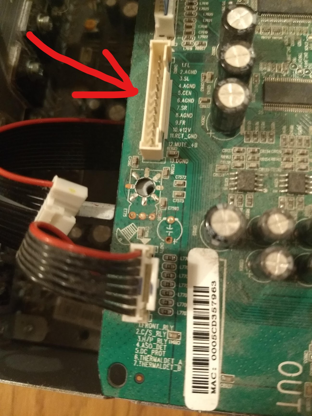

    I opened up the AVR and saw a connection from the signal processing portion to the amplification portion. Can I take those pins and use them as pre-amp sources? Just bypass the connection to the amplification board.

    Re: Convert AV Receiver to Pre-amp
    looks like you could do that but will need to look where the coupling capacitors are .if on main amp board then you need to add them .if before main amp you are fine .

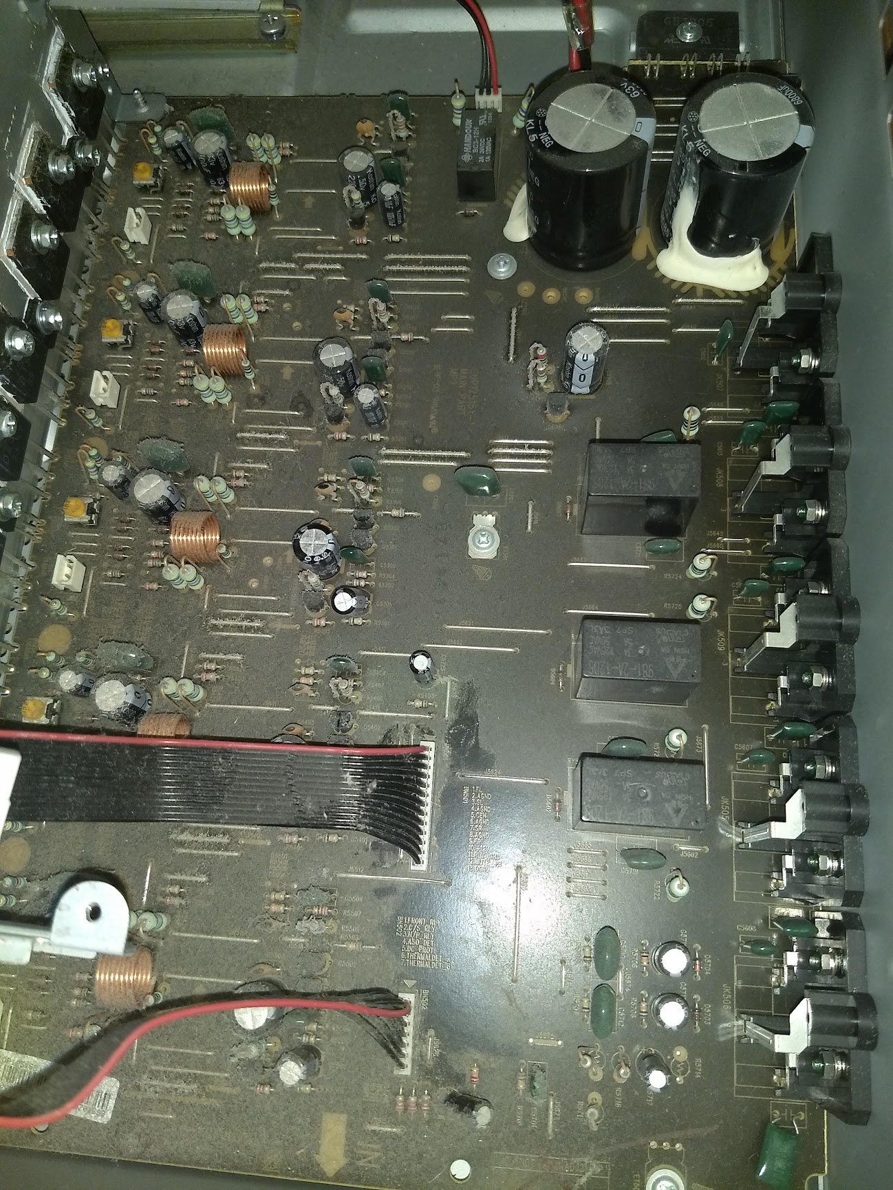

      Do these images show where the capacitor is located on the boards, or should I look for a wiring diagram?

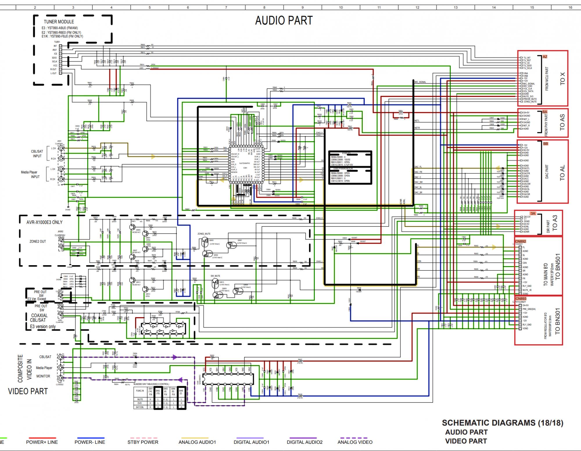

          i need to see the schematic .
          • NewbieB
            • Sep 2020
            • 15
            Here's the audio part schematic. Not sure if this is what's needed so I'll look for other schematics that look relevant.

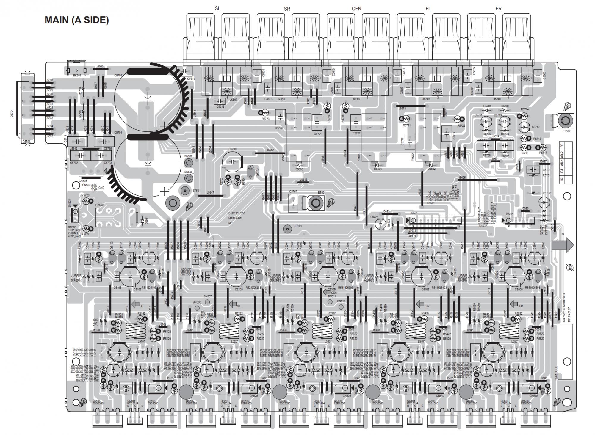

                Here's the Main Board (amplifier) schematic.
                      coupling caps are there on main amp board on all 5 channels .
                      you could use pre outs if you wish ..you would be better doing this .
                            those white connectors are for test points when adjusting the main amp channels .DO NOT connect anything to those .

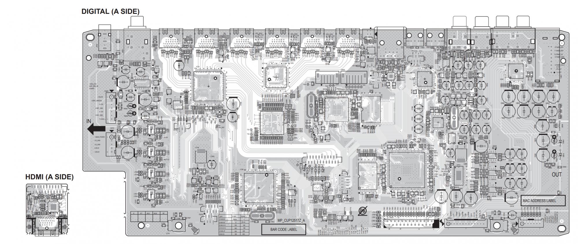

                                Ok, now I need to figure out how to add coupling capacitors to the 12 pin connector from the digital board.
                                It looks like the capacitors are 100v/10uf and 63v/100uf. Also, 50V/220uf and 100V/10uf.
                                I have no idea which ones I'd use to create pre-outs. Have to keep digging to see what I can find.
                                  i see . so the pic is wrong then ?
                                  thinking about coupling capacitors some more you wont need them if the amp you are plugging into already has them .. most do so i guess you could pull the plug off amp board then use front left front right wires and agnd .
                                    Yes, the active speakers contain amplifiers. Those amplifiers have capacitors. Specifically, 35V 330uf capacitors.
                                    If I can use the socket on the digital board to extract a line level signal -- totally bypassing the amplifier board -- then send that directly to my active speakers then we're back to having an easy solution again.
                                      coupling capacitors are small ones . 2.2uf approx are used mostly ..
                                      • NewbieB
                                        • Sep 2020
                                        • 15

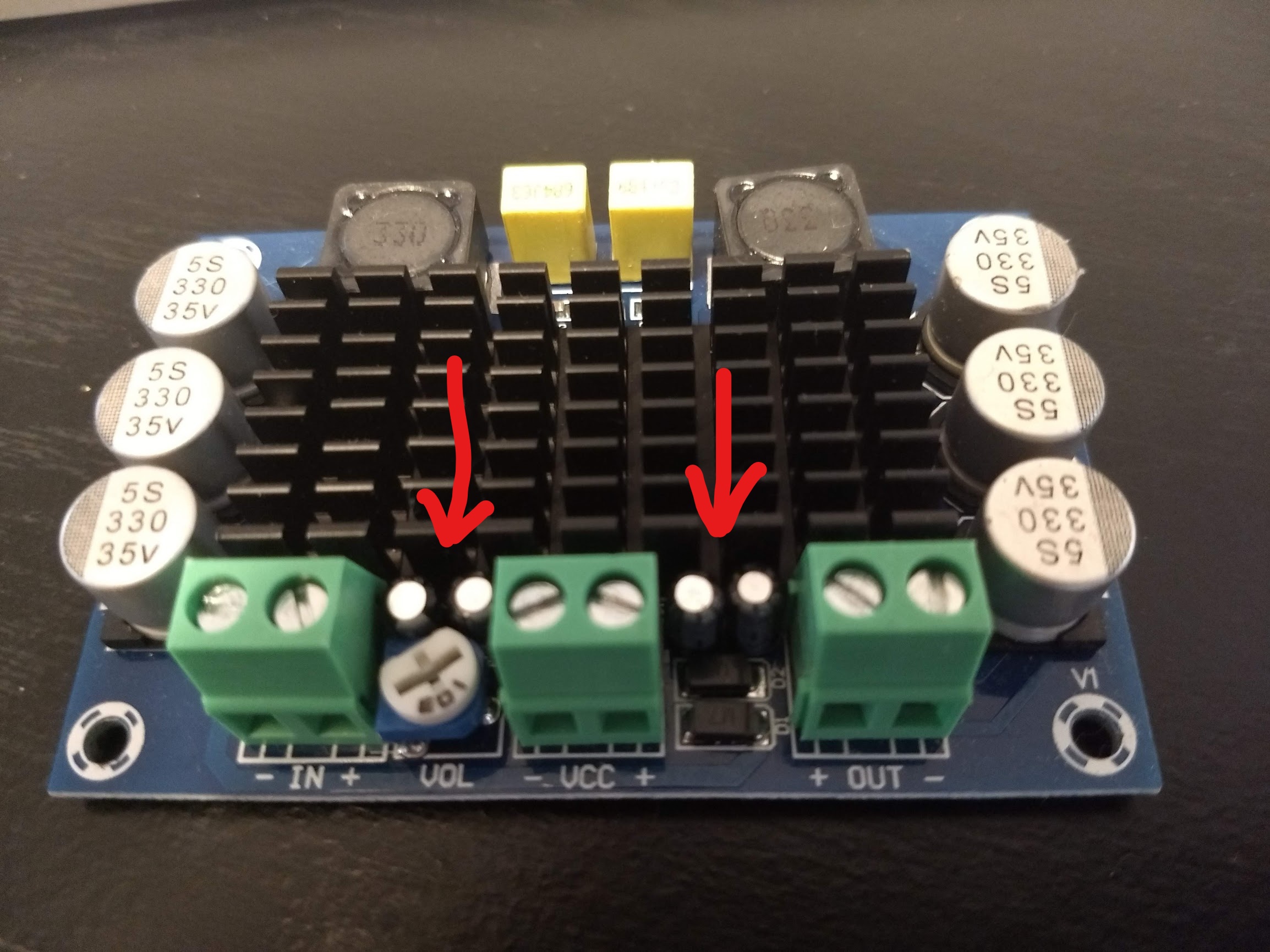

                                        In that case it looks like it might be these four 50V 2.2uf capacitors on the amplifier.
