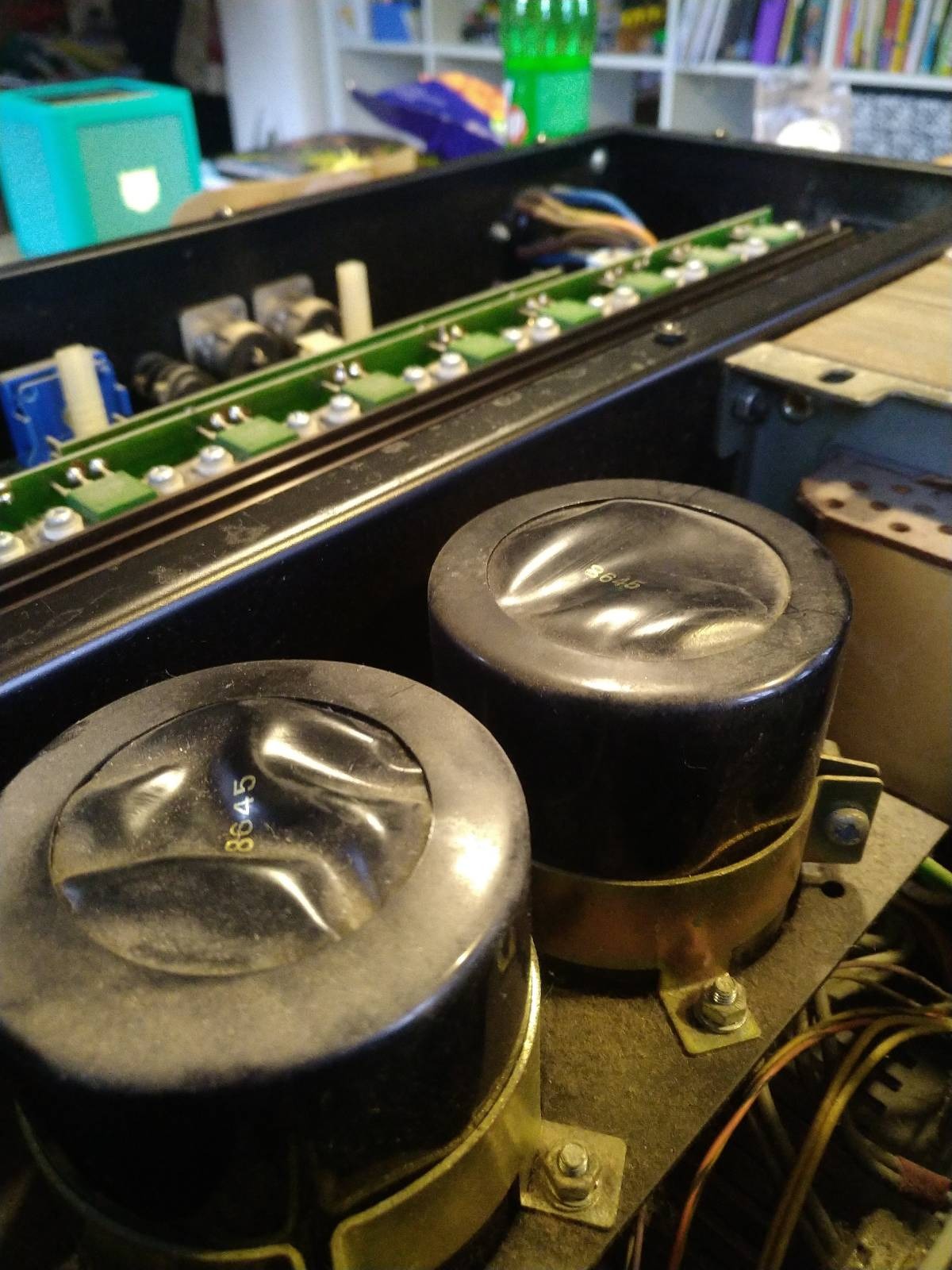

      There seem to be at least two revisions of the cv1000, mine looks like this:
      The ?caps? seem pretty wrinkled, but I have no idea about their ratings, so getting a replacement seems futile.

        Re: Cloud cv1000
        Added pic of ?caps?.

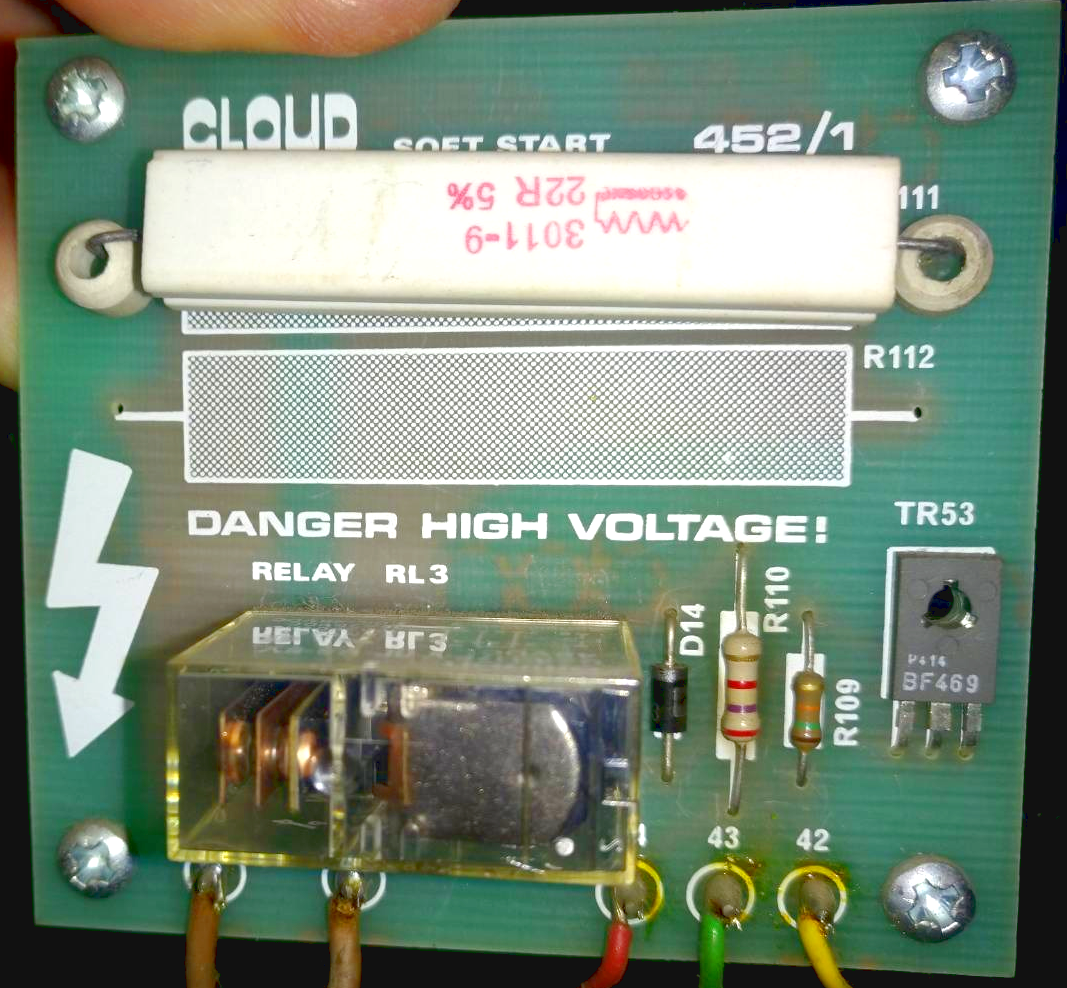

          Re: Cloud cv1000
          The power resistor on the soft start board seems to have opened, I'll swap it with a new one and replace the relais next to it.

            Re: Cloud cv1000
            Their rating will be printed on the sides.
            That said if there really is no printing it can be estimated from the size of the capacitor and referencing the size chart of any capacitor datasheet...
            But you will need to know voltage, that can of course be measured...
            The wrinkles could be completely normal, feel the top and if it is flat they are probably ok.

              Re: Cloud cv1000
              The tops feel flat, I suspect/hope it's *just* the soft starter. I'm currently ordering the parts (22ohm 10w power resistor + 48v 16a relay) and hope that this fixes it

                Re: Cloud cv1000
                Post a picture of the soft start, I'm curious how they implemented it.
                Here is one I designed if it might be of any help:
                https://www.eevblog.com/forum/beginn...72/#msg3978872

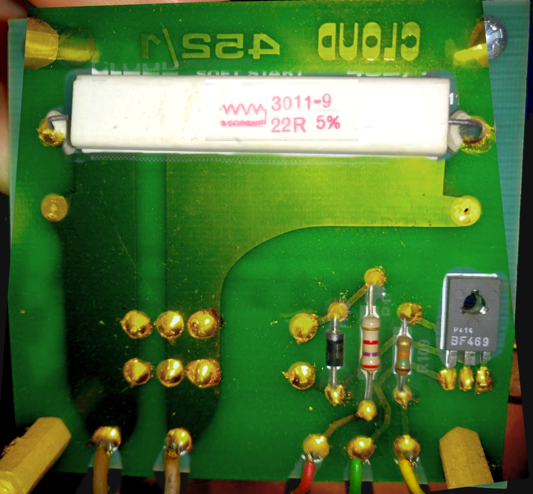

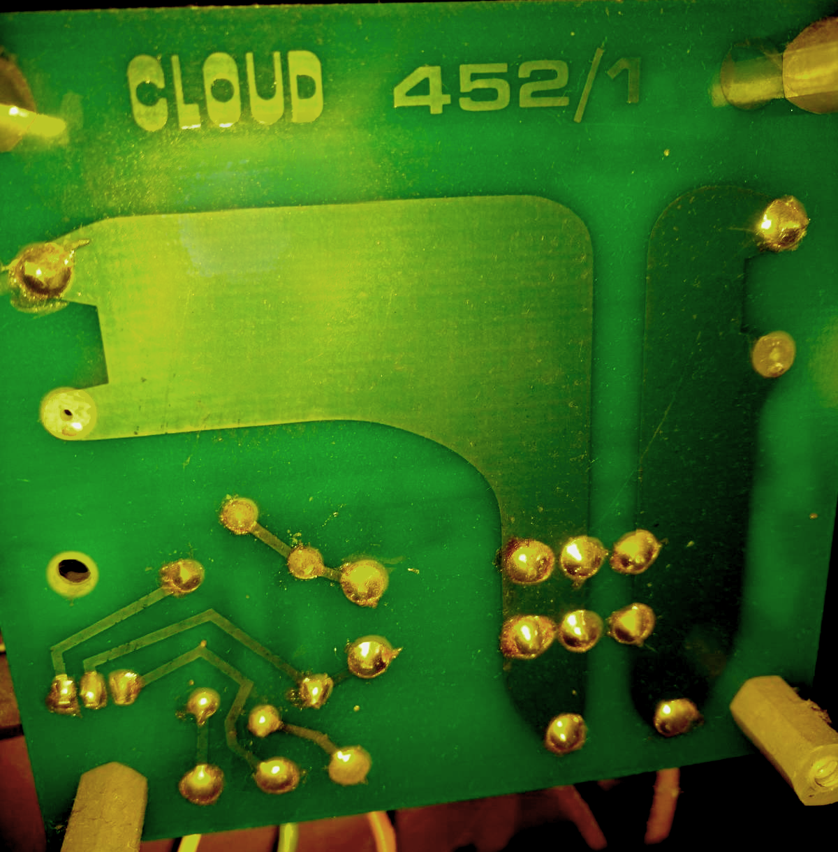

                    Re: Cloud cv1000
                    I had to look whether I need a 8 or 6 pin relay, so there are pictures of front+back+a merged version for easier reversing hth

                      Re: Cloud CV1000
                      Thanks, that's humorously close to the design in my first post on eevblog.
                      Probably with all the caveats I mention in my post at paragraph three there.
                      So if you want to make it better you can loan some ideas from that thread.
                      But if the datecode on your capacitors (week 45, 1986) is anything to go by it's good enough already!

                        Re: Cloud CV1000
                        I've replaced the power-resistor and the relais. But as soon as I connect the amp to mains and turn it on the power-resistor opens again :'(
                        Any ideas how to further debug this?

                          Re: Cloud CV1000
                          Check the thread I linked on eevblog, it might have some details for use.
                          I would use an incandescent light bulb in series with the unit.
                          The problem on mine was that at a higher voltage the main filter cap was shorted.
                          If you blow the power resistor it could be something similar...
